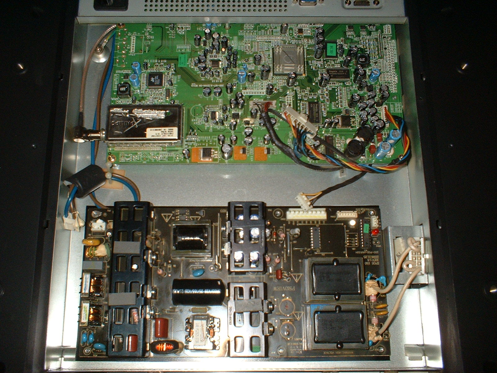

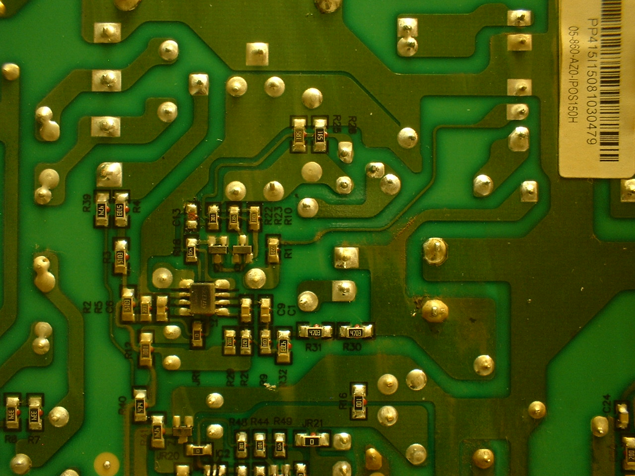

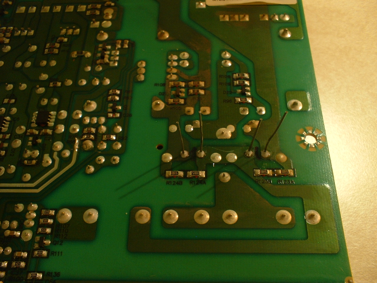

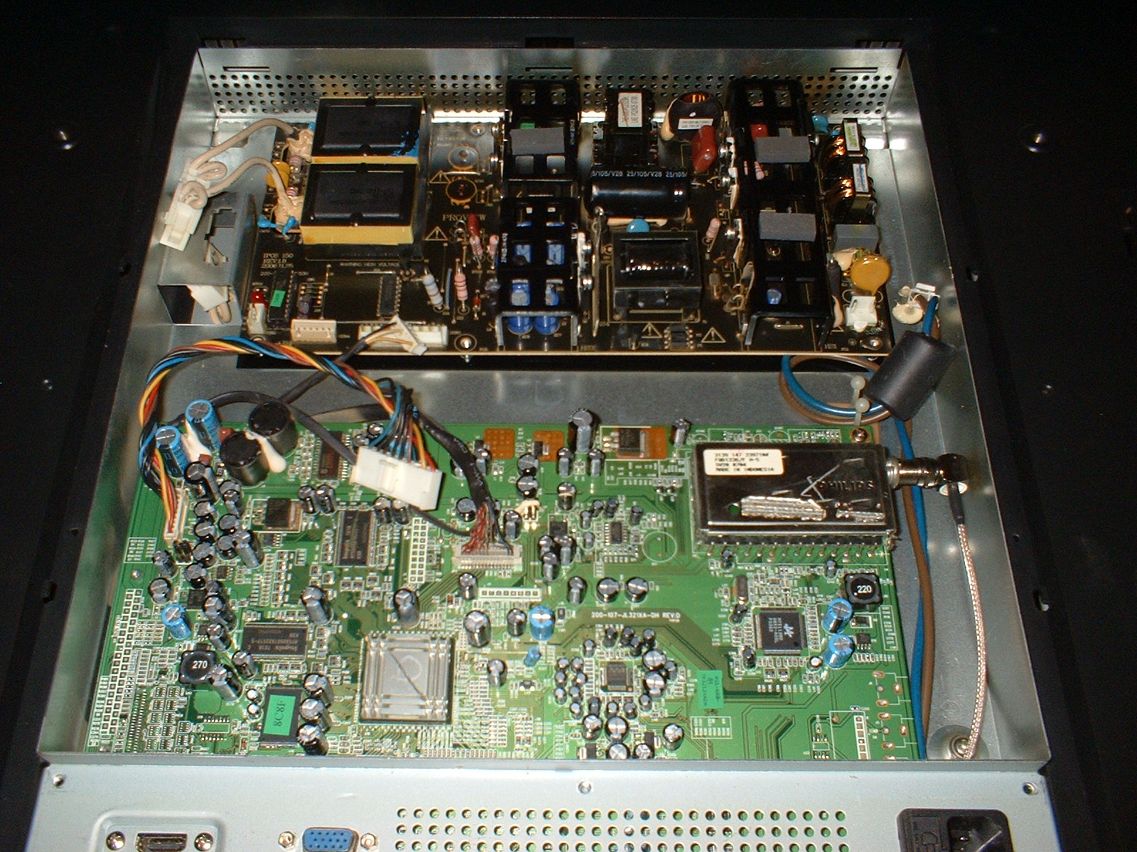

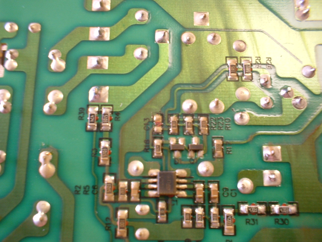

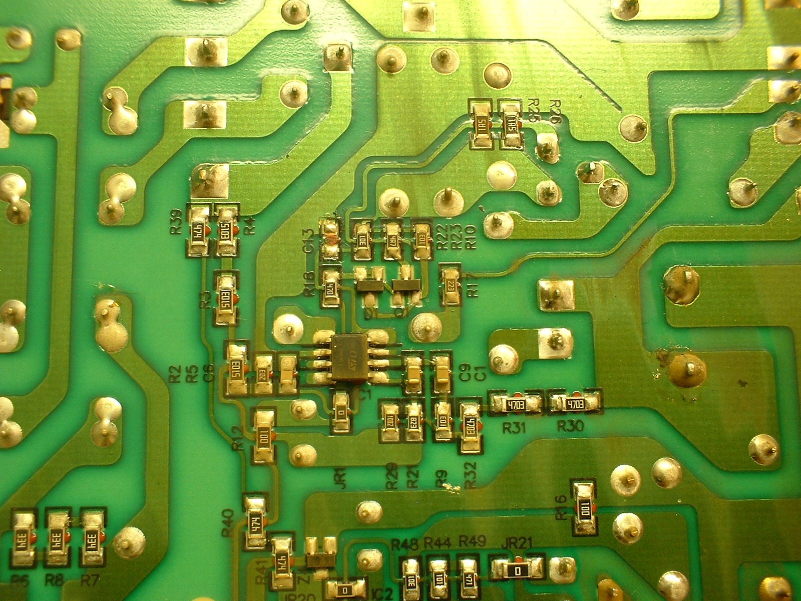

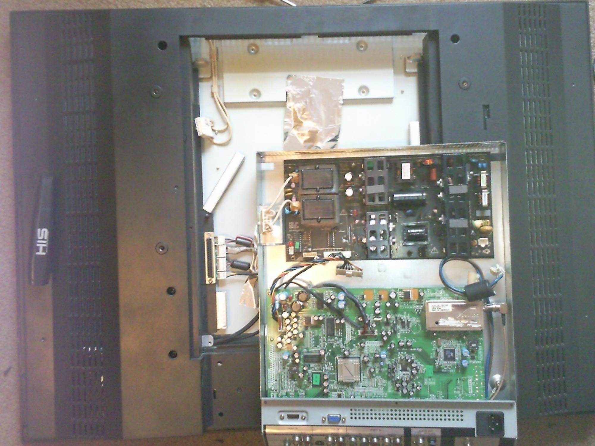

I have a element FLX-3211B LCD (Similar to Polaroid 3211TLXB) that went out on me. It lights up for a couple seconds when you turn it on then the picture fades out and it's done. There is a red led inside on the board that flashes.
What it does basically.

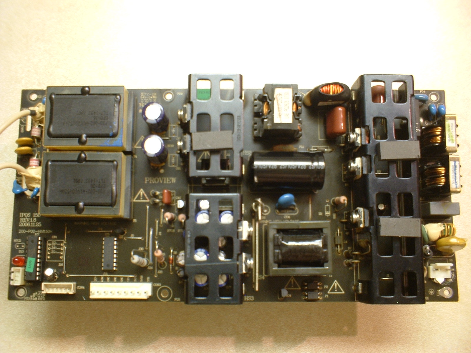

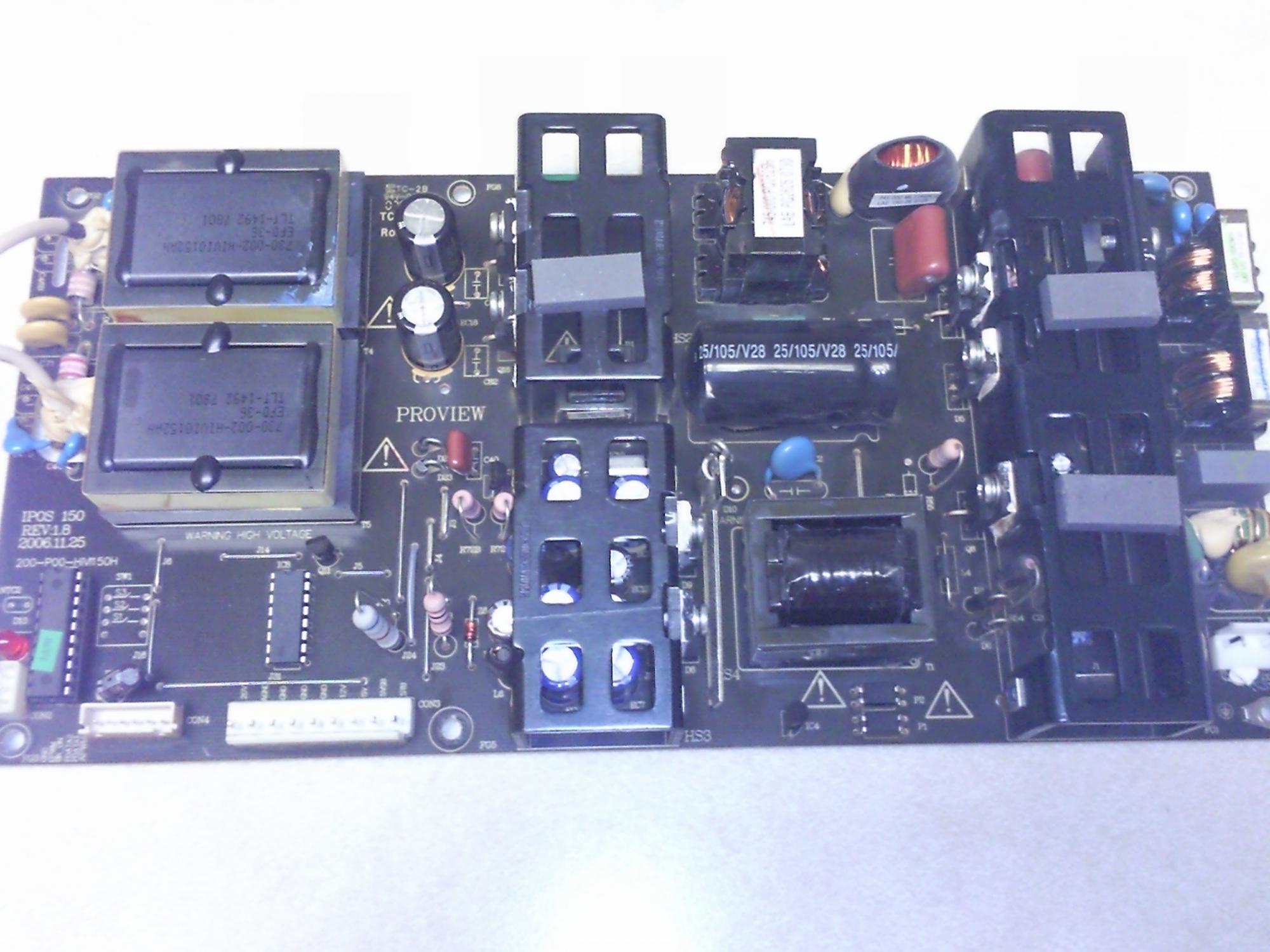

From reading a previous thread it suggest these caps for replacing the bulged HEC 10uf 450v cap i took out. Well i pulled both but one still looks good. Is this the correct one i need?
http://search.digikey.com/scripts/Dk...2W100&x=31&y=8
If you notice in my pics the large cap on the right of the power board is bulging also.I t's a little different though since it has a plastic cover on the top so i'm not sure if this is normal or if it could be bad also. Should i go ahead and replace it also? The only thing i can see on it are the numbers 25/105/v28.
Another question i have is they talk about adding a fan and i'm wondering how i would get power to it. I have some pc fans laying around from 40-120mm i'm just not sure where to tap in for power or if i would need to get a 120v fan and solder to the plug.
Thanks and sorry for the bad pics.
