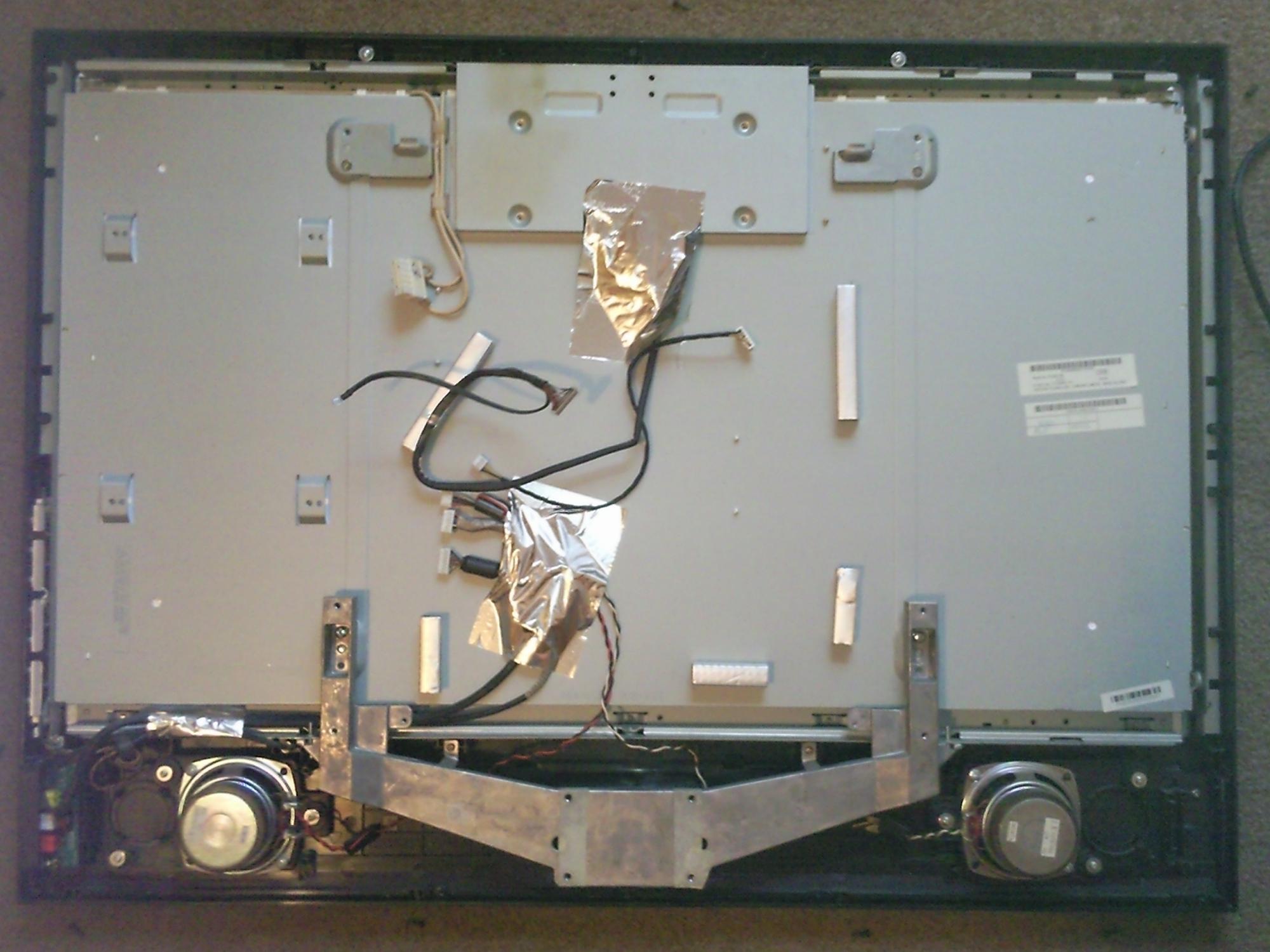

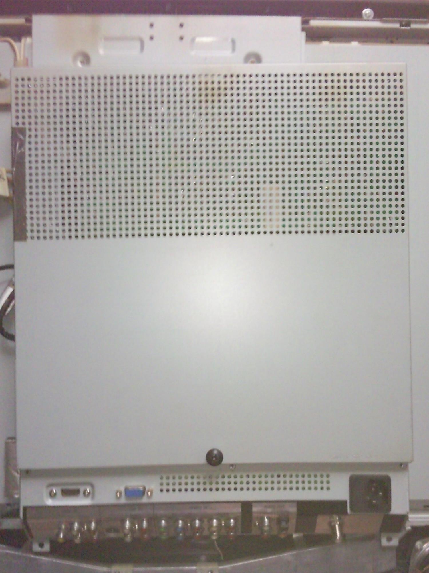

        There is no board on the left. Here i popped the case off real quick even though i didn't want to because it might cause other connection problems. It's some pics for the site though.
        Here is what is below the panel at the top.
        The case really is perforated well with more on top and bottom that you can't see. As for noise the other dozen and a half pc fans spinning in here would drown out one lowly fan.
          Re: Element FLX-3211B no picture
          Well, this has me baffled?
          I'm guessing the two white cables go to the inverter but I've never seen a complete shield over it.
          If you can remove the shield, you should find an inverter and the LCD panel. The panel itself is encased in a metal shield; it comes as a full assembly with inverter, bulbs and display surface.
          Is this an LCD CCFL TV or an LCD LED TV?
            It's a element FLX-3211B purchased 4/08 from circuit city not long before they went tits up. It is very similar to the polaroids but even cheaper and share the same chassis with similar boards. I do see walmart is selling this brand now.
            I'd say ccfl since it is cheap and leds were just showing up.
            I'm hoping some others have some insight into my problem before i go pulling anything else apart. I've fixed this once and a couple lcds thanks to this forum but i haven't pulled a screen apart yet. If i must and it works again pulling the panel apart would be good since it wasn't sealed very well at the factory and has gotten dust in the screen layers.
                    Well it looks like the inverter is part of the power board in this tv, and its a little different then the one tom was working on.
                    That post by lucky 19 looks like exactly what you need to do, or buy a fixed board on ebay since there are lots of them listed.

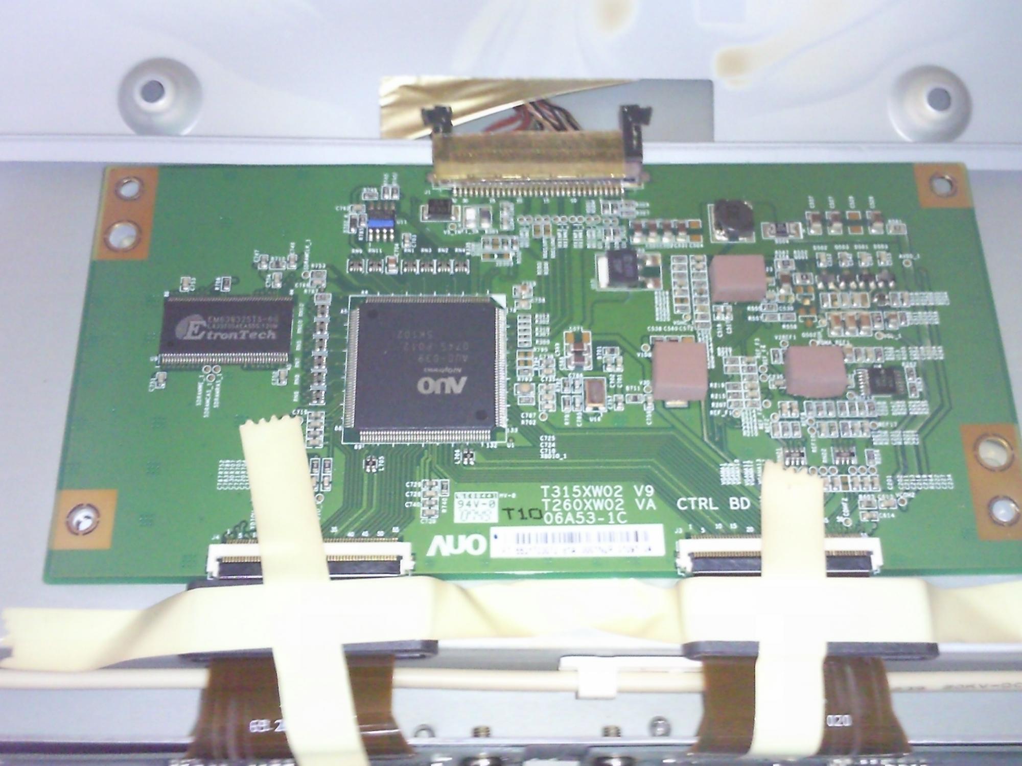

                              is it possible to replace the ribbon cables at the top of the TV that come from the T board to the TV

                                Just to add to what's already here, I just had one of these which I'd fixed and sold a couple months ago come back. Previously I'd replaced the two 10µf 450v caps and the big PFC cap. It came back with an intermittent problem where it would work for about five to ten minutes then flicker and lose the backlights. I found the problem to be one of the ceramic disk capacitors (C45) on the output side of the inverter transformers. I'd add C44, C45, and C47 to the list of parts to check when there's sound but no backlights.
