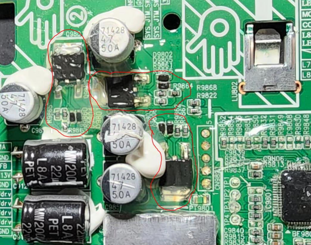

    What is the general resistance between 1(3.3v) and 4(GND), is it not low?

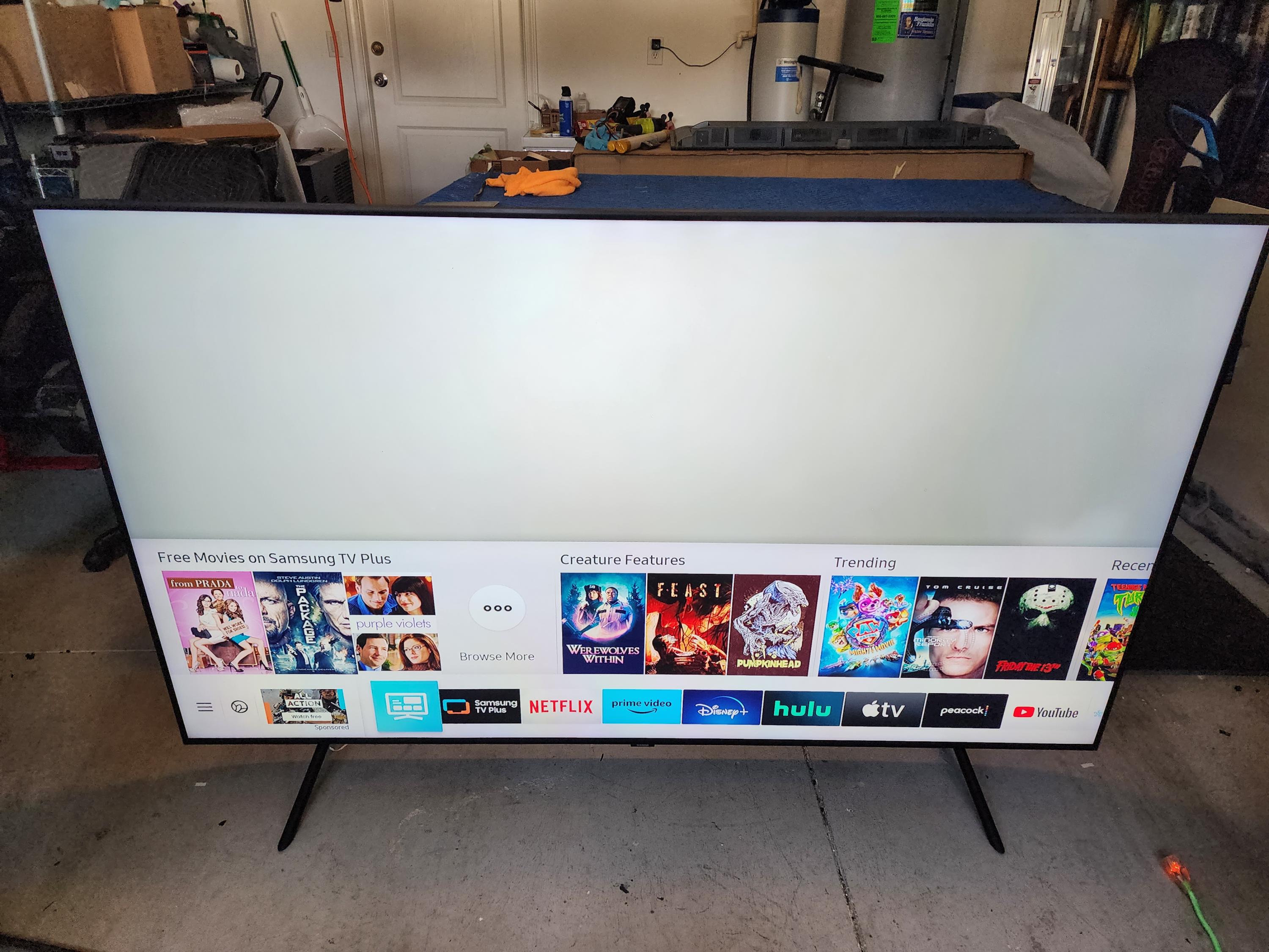

      Bl doesn't come on at all anymore, not even 30 sec.
      What would I try to freeze?
      Lotas 2.4kohm 1 and 4

        Pt9801

          or try by pass it with short circuit..

            You need to determine how and what is assembled on these three channels, what voltages they have at their terminals, and what transistors they are.

                one things more.. if PT9801 (a PTC Thermistor as we thought ) and there swollen at the middle of the surface it will be in cutoff always.

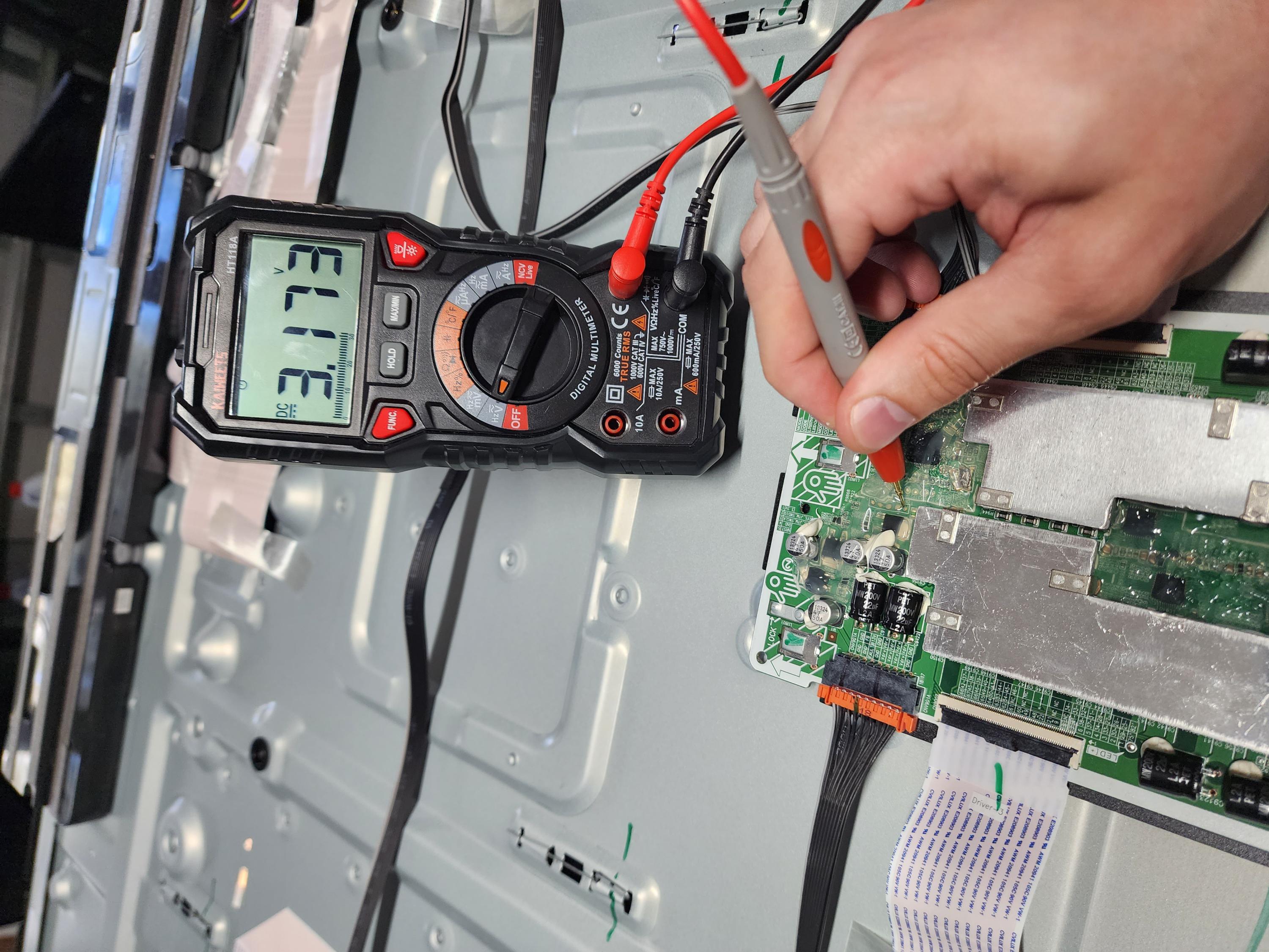

                  Pt9801 has 3 ohms resistance so multi meter shows short because almost no resistance
                  There is 1.408 v coming in and 1.408v leaving

                    1.408v you have also on pin 1 9802 ?

                      Yup
                      Pin 1 shows continuity to both right and left side of pt9801 it shows no resistance continuity on right side on left side it shows 3 ohm resistance so almost continuity just low resistance. All 3 points show 1.408 v

                        you need to free one leg of PT9801... to let Pin 1 zero V. and then we feed Pin 1 with 3.3V... i wrote an example... but you can use any source on TV like power on.... but in this case need to connect it via R 1K

                          So can I just pull pt9801 off the board then feed pin 1 the 3.3v? I don't know how to free it otherwise. And I will need to buy some resistors I see you say jump 3.3v with 1k all the time but I don't have one. Maybe scrap board. Okay will try tonight

                            sure you can take it out... but dont lost it..lol... after take it out u need to test to see the v you read before on which side in and if pin 1 ready to be 0v.

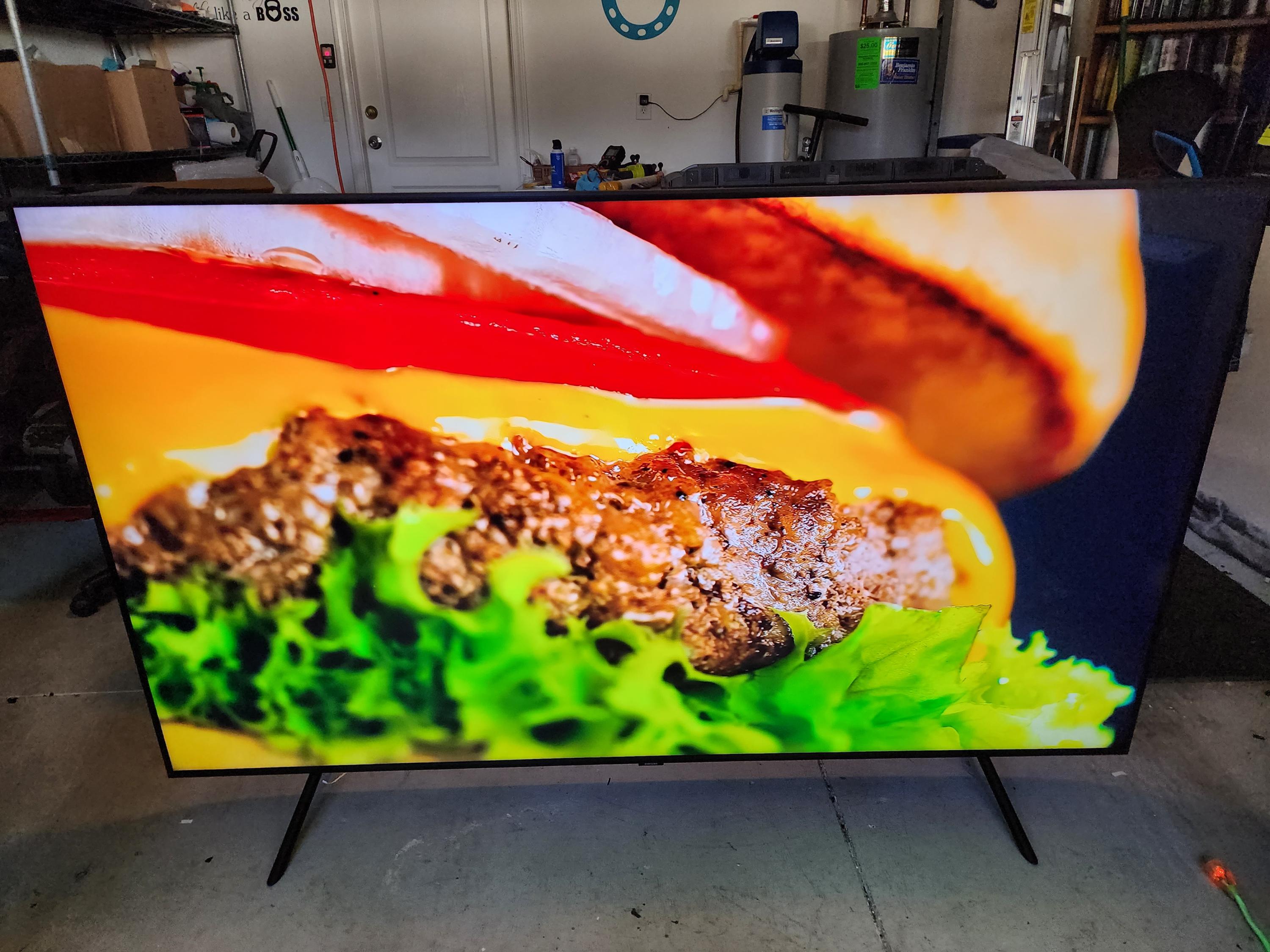

                              Okay I didn't get into all the exactness of it but installed new led driver board and it's working fine. Points 1 and 2 as established run at 3.1v as picture shows.
                              Thx story, lotas and diah and anyone I may of missed.
