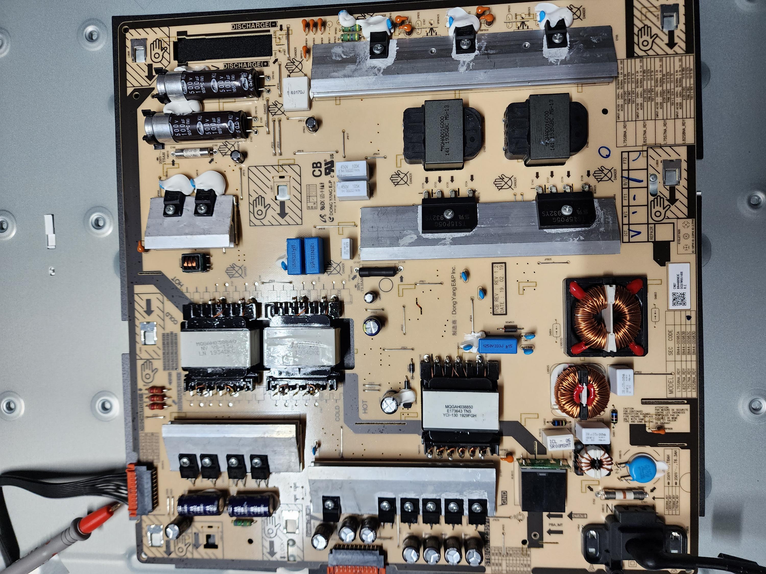

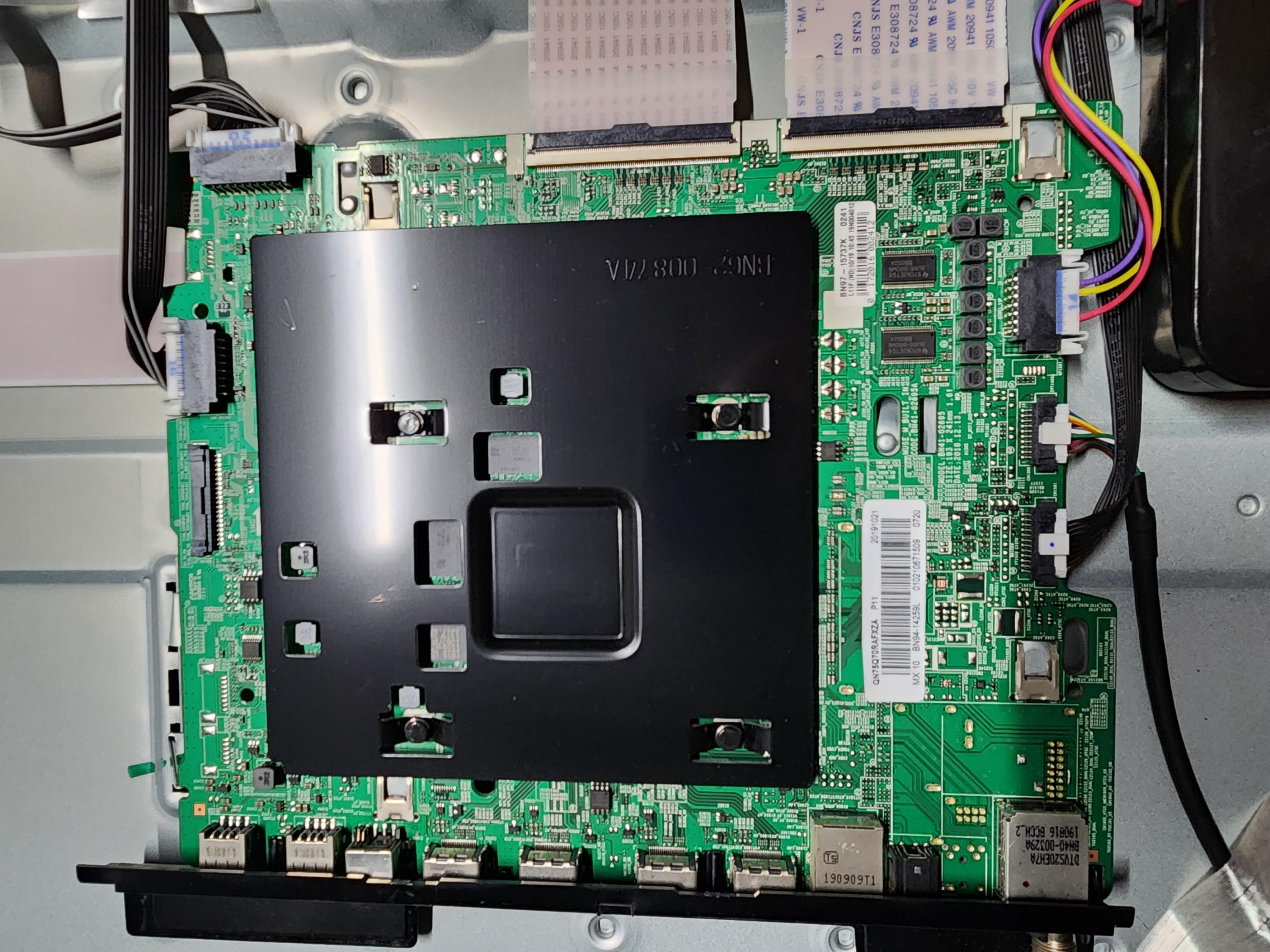

    These seem to always kill themselves lol.
    Okay, I have picture but no backlight. Sort of, backlight randomly comes on for about 30 seconds then shuts off. Right when I turn TV on BL does not come on. I waited and eventually boom backlight on. Then shut off, few minutes later, backlight on boom. Then backlight doesn't come on, but person said if you wait a bit BL and picture comes back and on.

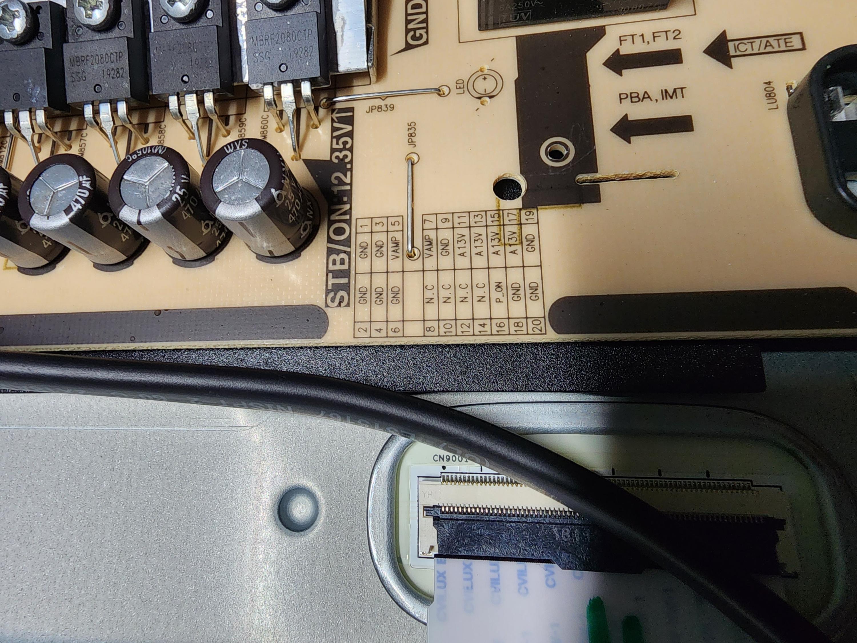

    I checked power board, voltages as follows
    From PSU to main
    PSON 3.4
    Vamps 18v
    13v 13v
    All seem correct.
    From PSU to LED driver

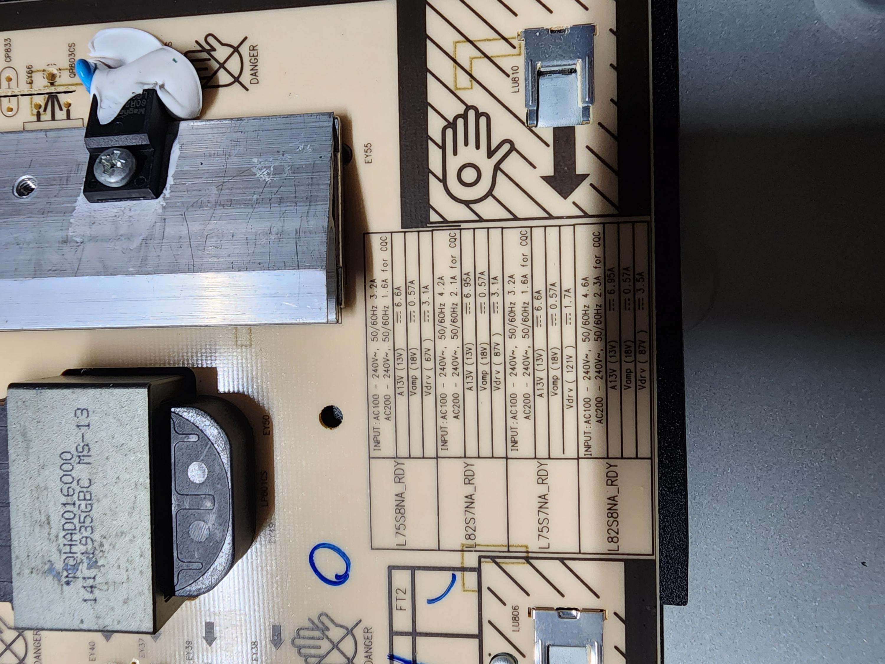

    All vdrv are 112v steady, as board says for stby (when BL came on this tested at 122 on all pints and all caps on LED driver as well, PSU says this is correct voltage also)
    13v 12.87
    FB 2.48 (don't know what this is)
    Fault .061

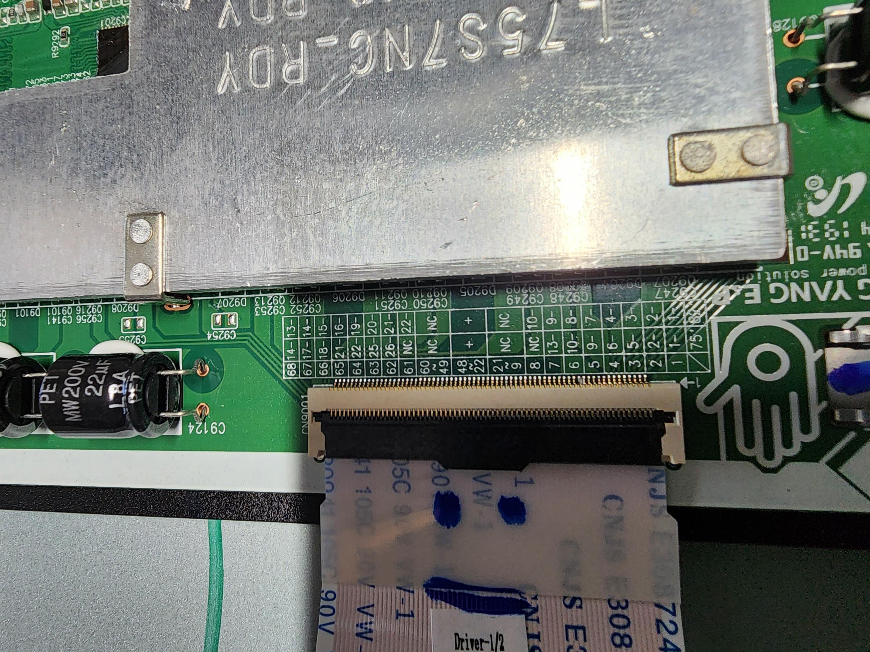

    From LED driver to main.
    16 .015. 15 0
    14 0. 13 .142
    12 1.32. 11 .169
    10 .006. 9 1.407
    8 0. 7 2.76
    6 1.407. 5 3.2
    4 2.76. 3 0
    2 .045. 1 0
    So I could assume that the BLs work and there isn't a problem since the seem to turn on for a bit and turn off, but maybe that's wrong. Anyone have a clue where I should be doing next.
    Feels like PSU is ruled out (correct me if I'm wrong) since voltages seem correct BUT I don't know what FB or fault is, and what would be correct voltage for them.
    Thanks all!
    Edit ALSO I disconnect main board from PSU and plug in, BL doesn't come on, BUT I'm assuming the main board is needed to send a signal or something. Just an observation. Maybe they should come on?

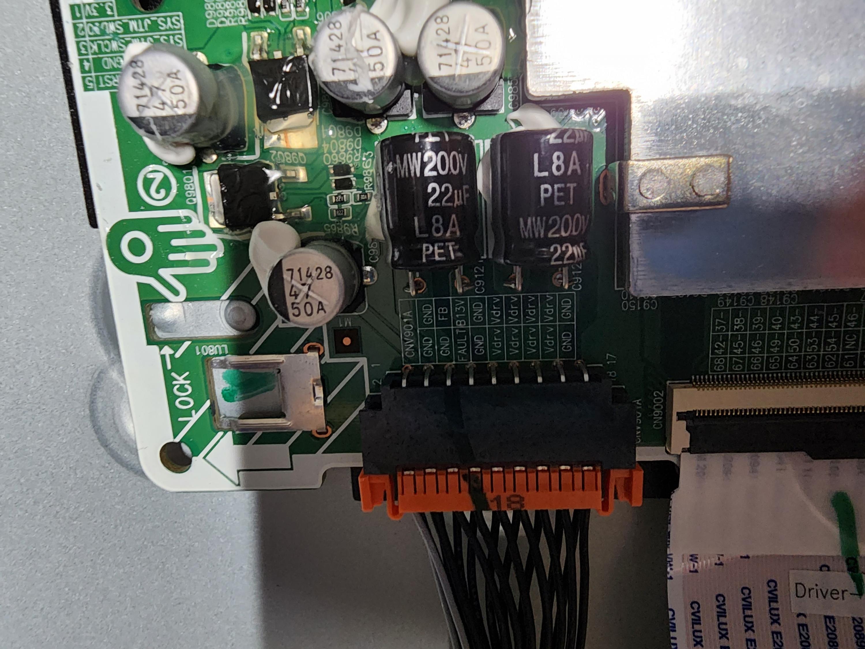

                  @ diah, I have turned down the backlight which was pretty low to begin no change
                  As a note I disconnected the PSU to LED driver and the fault pin reads 4.5v at plug in. I reconnect the PSU to LED driver and then it reads .058 to 0 and goes back and forth. Is fault similar to BL ERR on Sony?
                  @story, any combination of disconnect ribbons and clips all combos tried BL doesn't turn on.
                  @anyone, does anyone know if the LEDs are blue on this TV?
                  Anyone know how I can test the LEDs with a LED tester?
                  Edit, I have found how to test them I believe using ribbons. Will put results
                  • EazyBone
                    • Jun 2023
                    • 1347
                    • United states
                    Re: qn75q70rafxza suiciding samsungs
                    So I measure each ribbon has 14 LED test points on each each one lights up to 131v per tester.
                    All seem to be working, yes I know the whole sometimes it's not enough current deal,
                    So when psu not connected to LED driver fault is at 4.5v and when connected fault is at .056, is there something here? Hints? Thanks

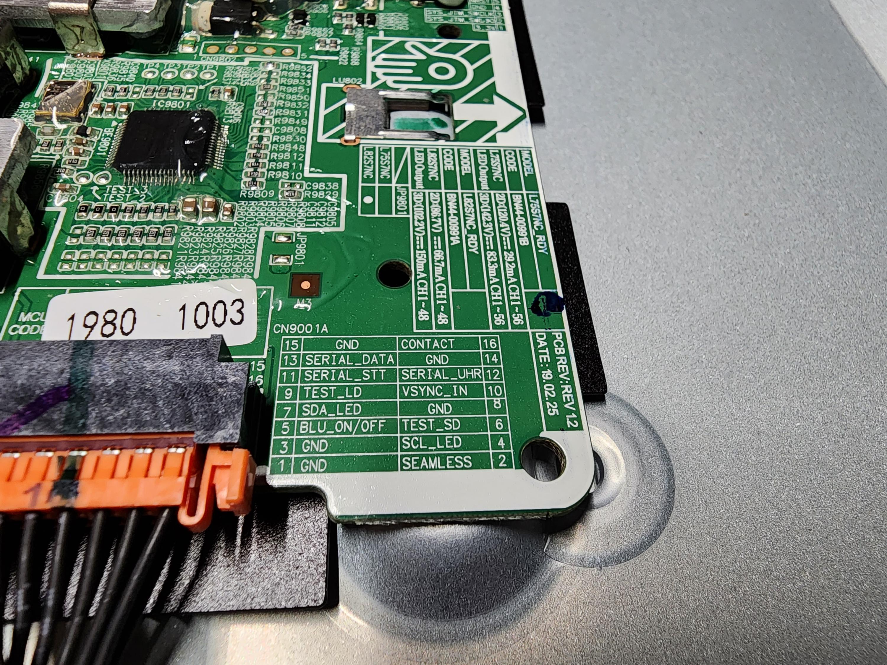

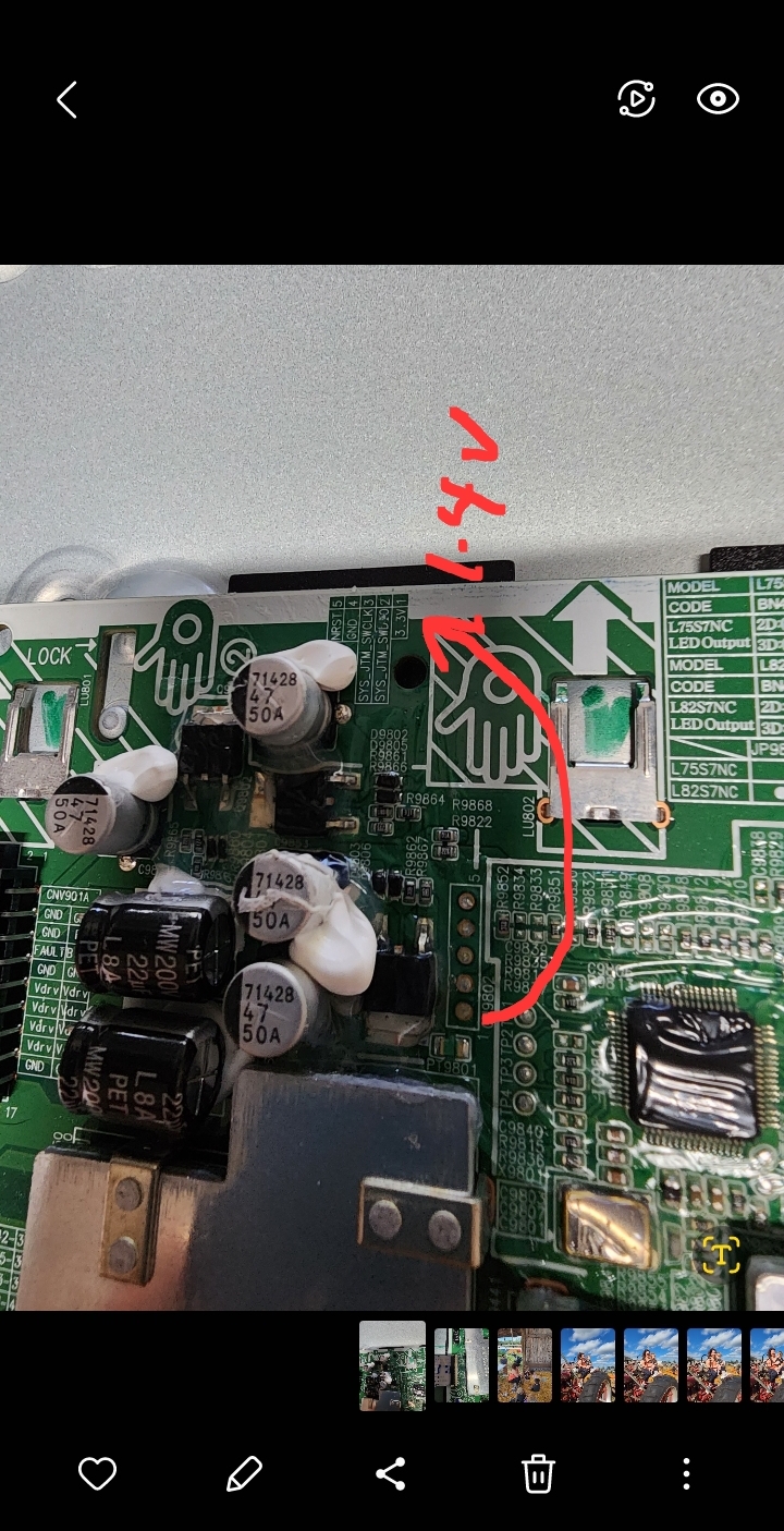

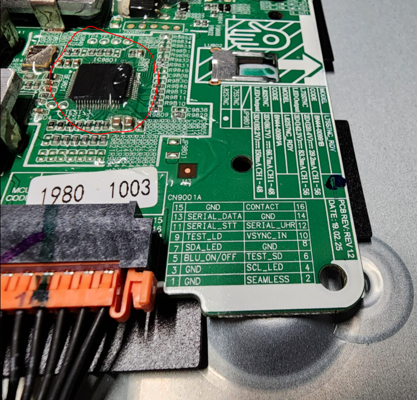

                      I also found this on LED driver board. Says should be 3.3v and its 1.408 with everything connected tv on
                      They are all zero TV off stby. Maybe I'm onto something here?
                      1 1.408
                      2 .002
                      3 .001
                      4 0
                      5 0
                          1 1.408
                          2 .002
                          3 .001
                          4 0
                          5 0
                          This is a connector, control points for connecting the programmer so that you can program micom, and there should be between 1 and 4 pin 3.3 v.
                          And if the power is too low, the controller will not work, and therefore nothing will work.

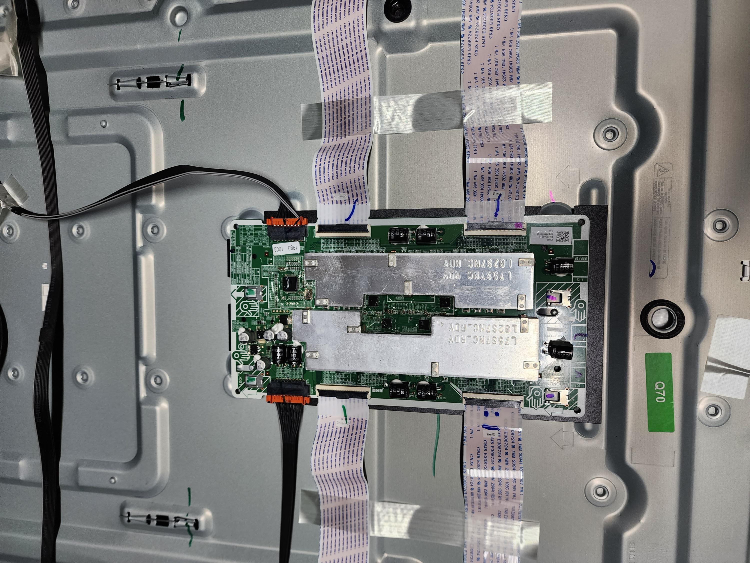

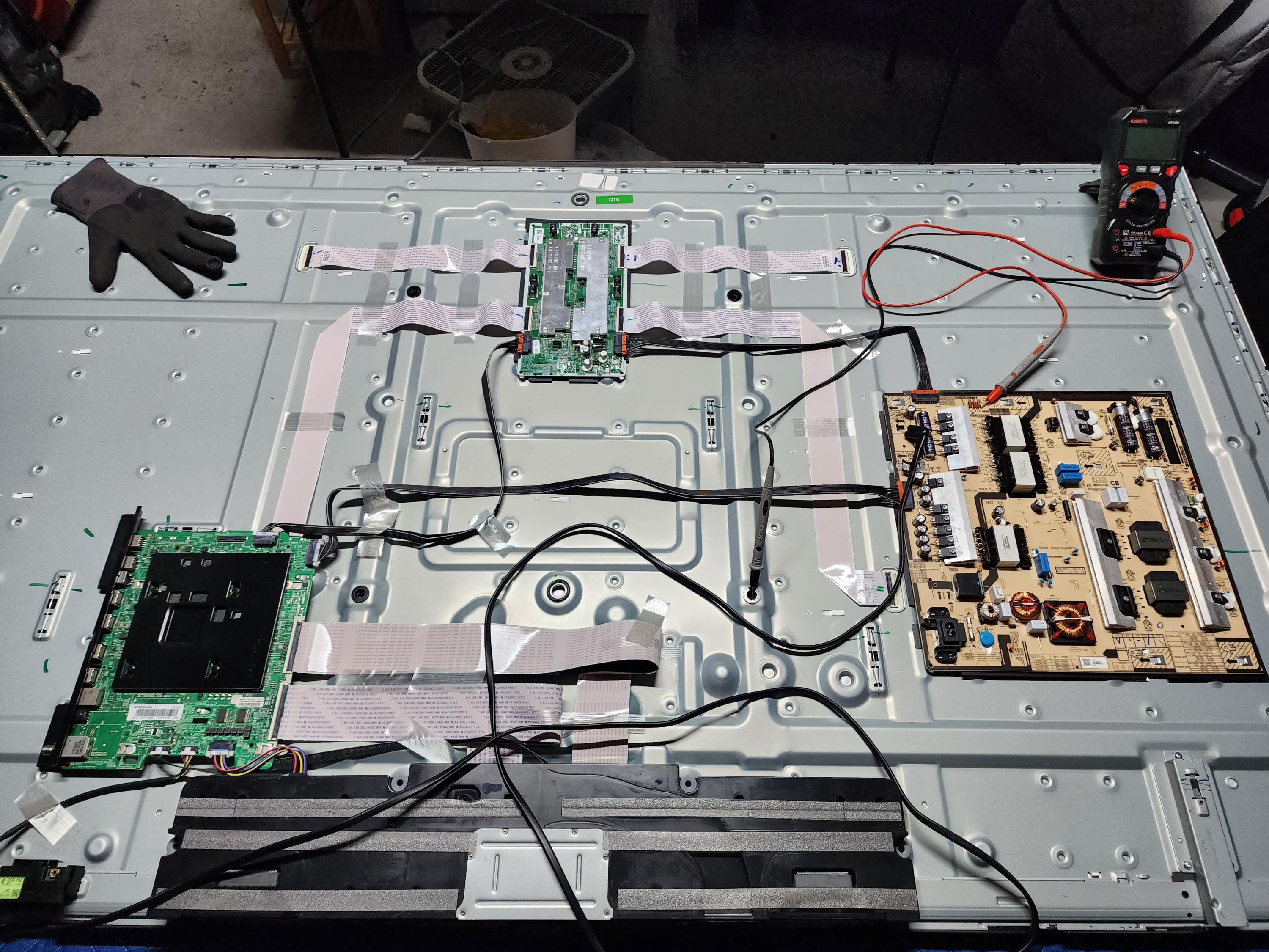

                            Haha diah I took the boards out now lol I don't see anything wrong.
                            I'm gonna see how I can do service menu as I don't have Samsung service remote.
                            Lotas, oh so shouldn't be any concern then I assume?
                            Diah I don't know what I'm connecting with 2 point above lvds. Like 2 points on the MB? Jump them?
                              To power the controller you need 3.3v, it is greatly underestimated, which means 1. the DC/DC converter is not working well (not fixed) 2. At the output of the converter (3.3v) there is a short or low resistance, this can be a diode, zener diode, ceramic capacitors or The controller itself runs out of power (then it should get very hot).
                                    13v comes to the board, in order to power the controller there must be a dc/dc converter whose output should be 3.3v.
                                    There is also a controller on the motherboard and they communicate with each other and give commands to each other.
