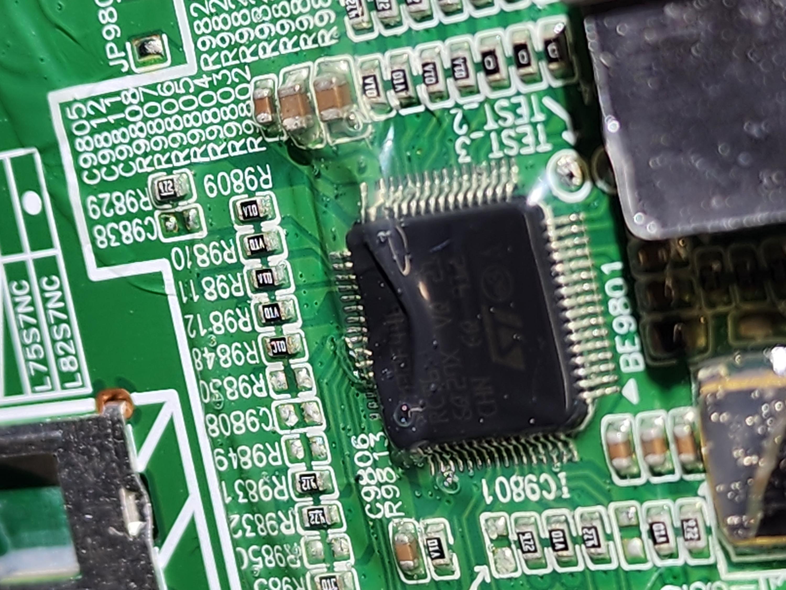

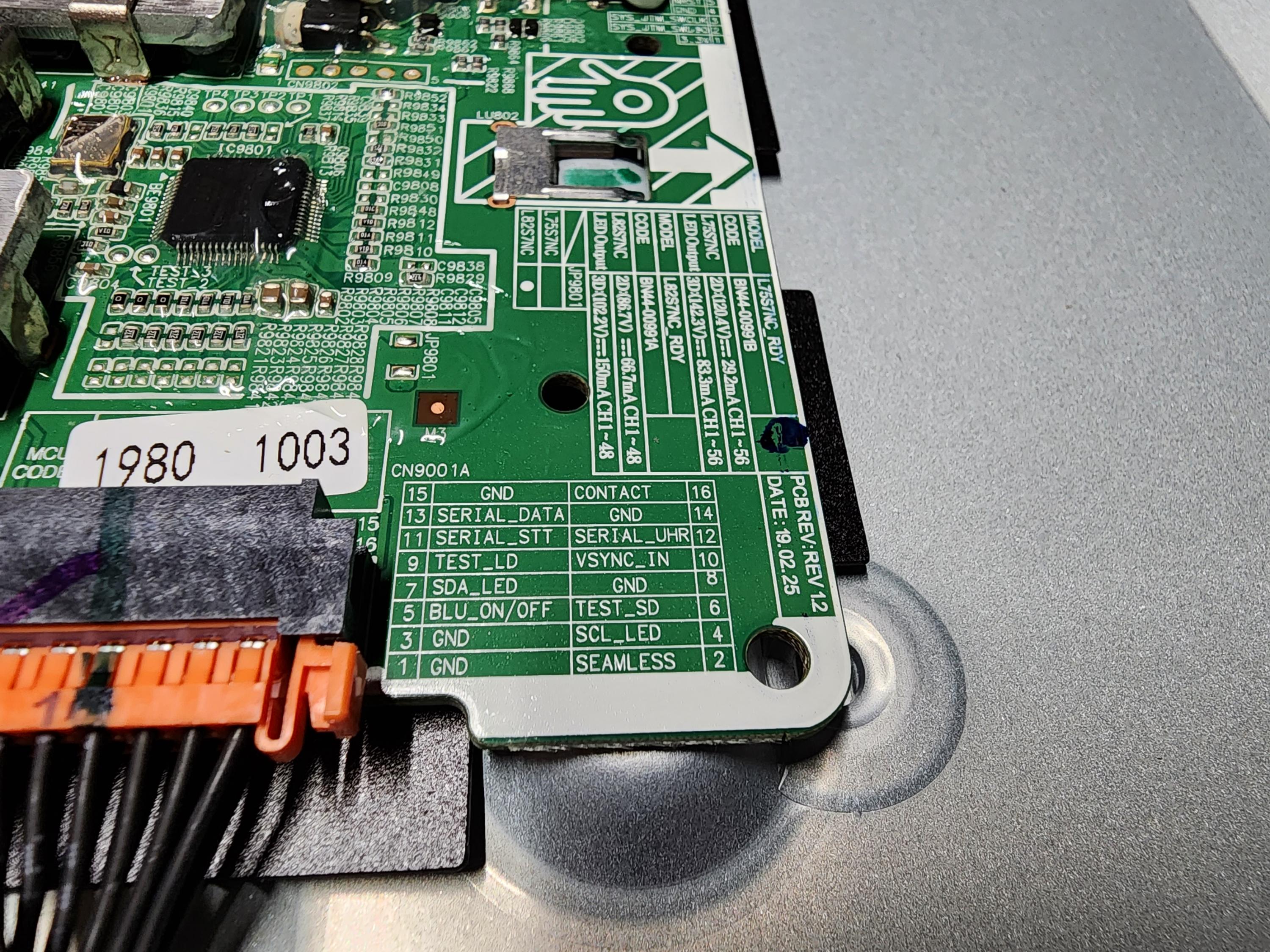

      Well, let him clean off the sealant from micom and read what kind of chip it is, most likely it's Renesas, st32, pic, where its own firmware is located.
      And this is the bus through which communication takes place between them.

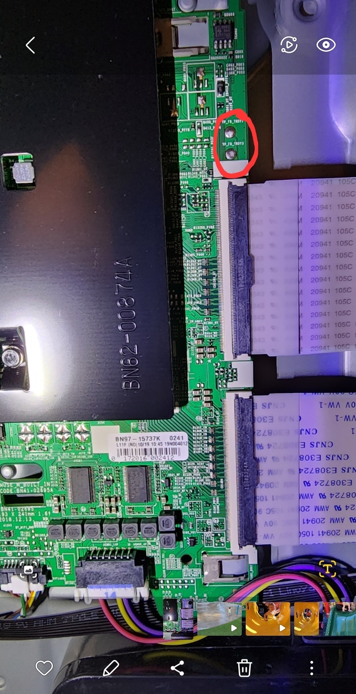

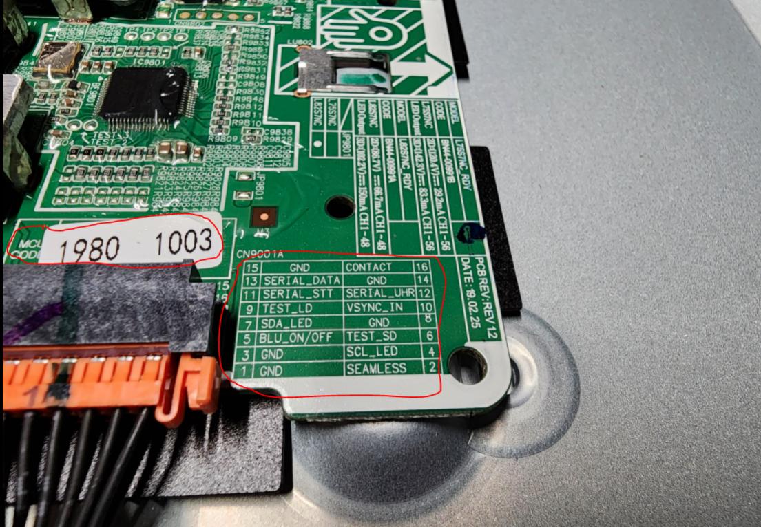

                @diah factory reset done I figured it out. No change, I'm still trying to find out what 2 things you are asking me to connect as I don't know what you are talking about. I'm taking a closer picture
                In picture I have circled. Are you saying plug TV in onto standby and just stick a jumper on those two points and hold them there? Or turn TV on and then jumper them? Not gonna do anything until confirm. Also both those test points show 3.3v
                The full picture and sound works still, so are we testing panel? Cause everything looks perfect on panel. Thanks
                @ lotas here is a picture without scraping anything off, should be readable. So far I have tested many points on the board and cannot find 3.3v anywhere on it. I find many 1.4v around that chip just like the test points 1 and I found 2.6 at a gate. So I see no signs of 3.3 anywhere on driver board

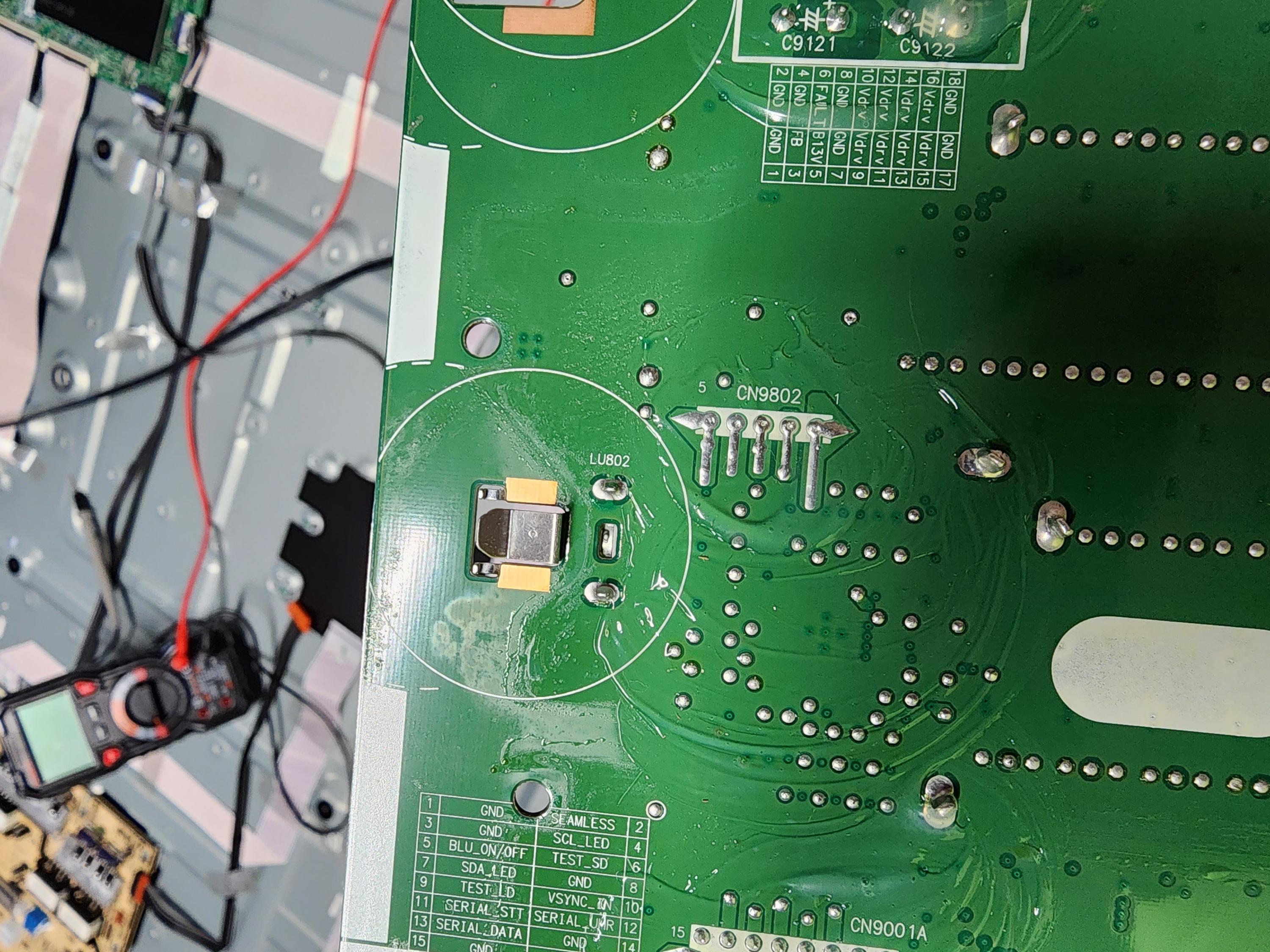

                  @ lotas so here is what I get from main board to LED driver when disconnected. All test coming @main
                  15 0
                  13 .110
                  11.220
                  9 0
                  7 3.3
                  5 5.1
                  3 0
                  1 0
                  16 .004
                  14 .002
                  12 1.67
                  10.006
                  8.002
                  6 .002
                  4 3.3
                  2 .006
                  Compared to when plugged into LED driver
                  16 .015. 15 0
                  14 0. 13 .142
                  12 1.32. 11 .169
                  10 .006. 9 1.407
                  8 0. 7 2.76
                  6 1.407. 5 3.2
                  4 2.76. 3 0
                  2 .045. 1 0
                  So I see an absence of 3.3v all over the LED driver but it seems MB is sending 3.3v in 2 different places. Also lotas, the chip you pointed out only showed the 1.4v as I stated at that test point there was no 3.3v on it at all.
                  So as storyteller seems to infer and lotas I think maybe LED driver has gone bad. Gonna wait for some consensus before I try and order one. Cause maybe my thoughts are wrong lol.
                  Thanks y'all! Picked this TV up for $50 to take a chance on it. Night!

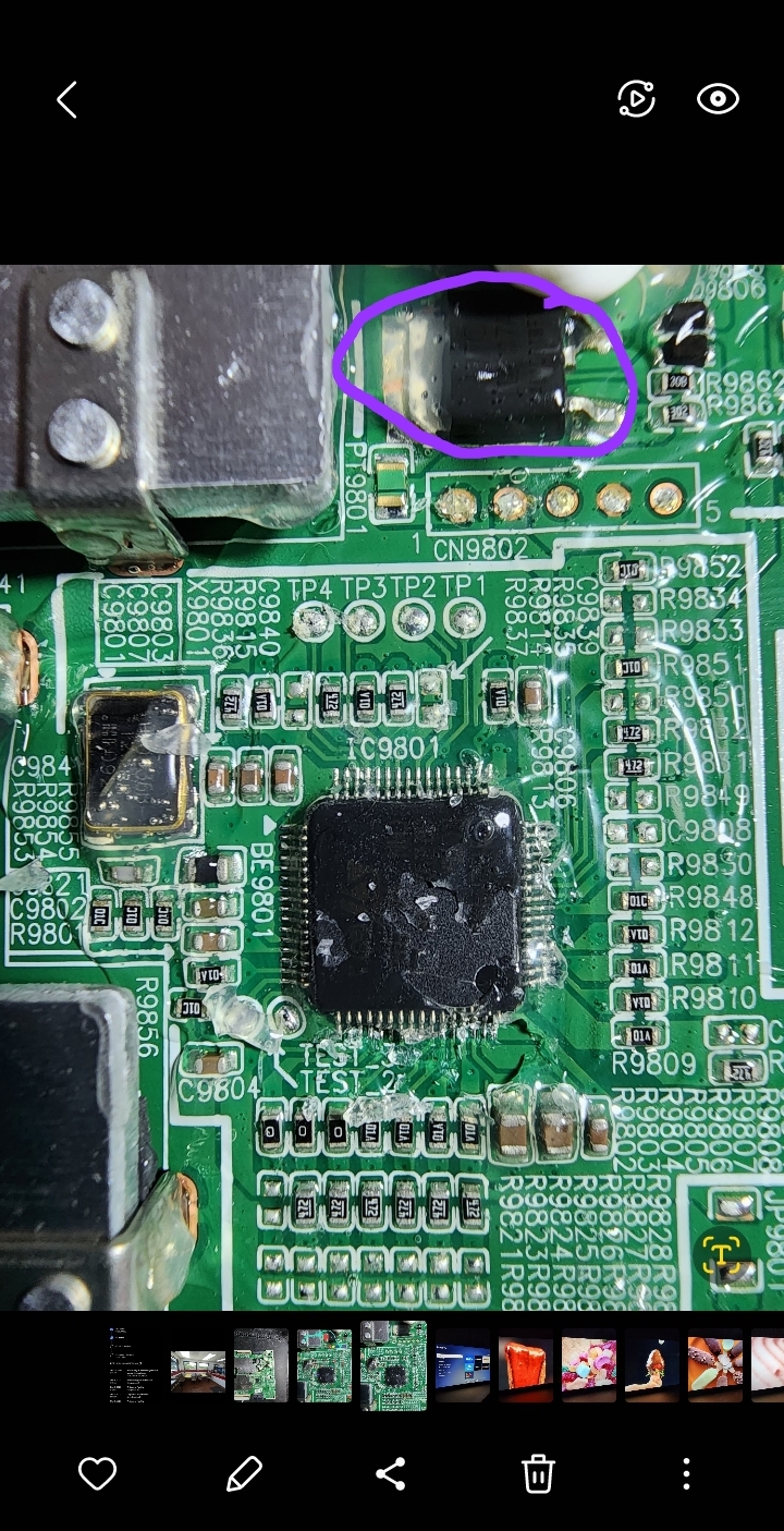

                    Yes, you have an STM32F446 controller, as I wrote above, it is powered by 3.3v.

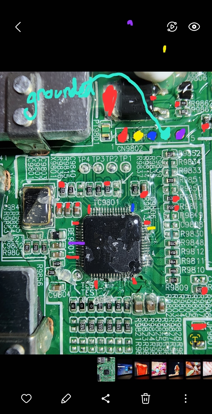

                      no need to do the other test.... your reset from S.M enough... work on the LED driver to the testing points (9802 ( No 1 read less as 3.3V ..
                      i think its feed rail belong to IC 9801, but you need to follow it after take out the boards... check if this test point had any direct points to any of sockets like FB or from MB.. if not then it mean you have DC to DC on the boards supply this 3.3V... and if t goes as 1 thought to IC 9801, then mean the IC drops it.. so it should be warming..
                        I can't exactly find where it goes yet. But nothing on board gets warm at all

                          you have on the boards many Regulator... with beep ton check the PIN 1 with them.... one by one
                            This is connections I have

                              read the resistance of PT9801. then left one legs out of PT9801 and check if the V increase on the Regulator to 3.3V

                                Ohms is 3.2 pt9801
                                And is this the regulator in the picture? If so there is no increase to 3.3. I dont know if that's the regulator. Like a mosfet

                                  can you read whats written on the one like Mosfet ?
                                  PT9801 from the sign black line look like zener diode 3.3V .. but i am not sure,,, this why i asked you to free on legs of it... then see the PIN 1 will be zero V. if this case we can DiY Regulator 3.3V .. can be find easily if you have programmer CH341A ( had one. just we feed it with 5V or less and take out 3,3V to feed pins 1..

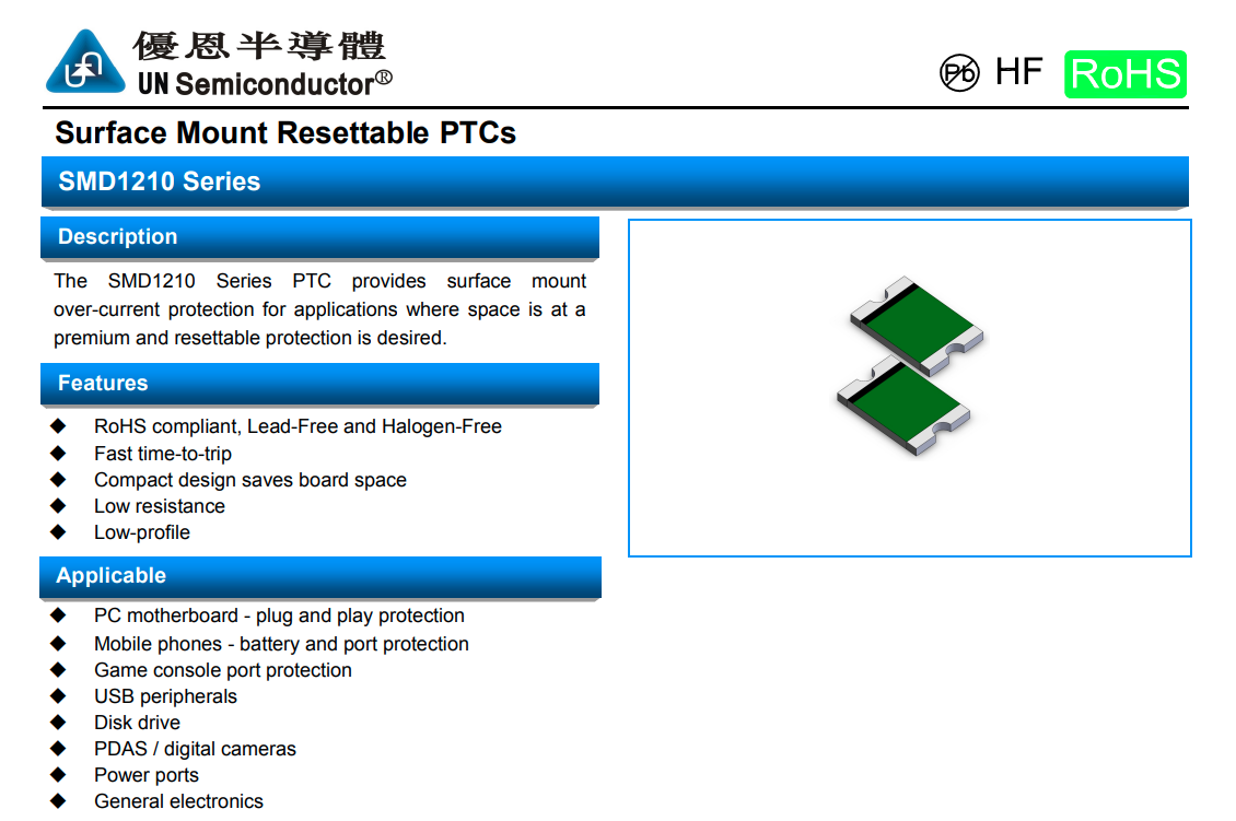

                                    PT9801 - It could be Surface Mount Resettable PTCs.
                                      you mean a PTC Thermistor ?
                                        Yes, anything can happen, and the designation on the board is “PT”.
