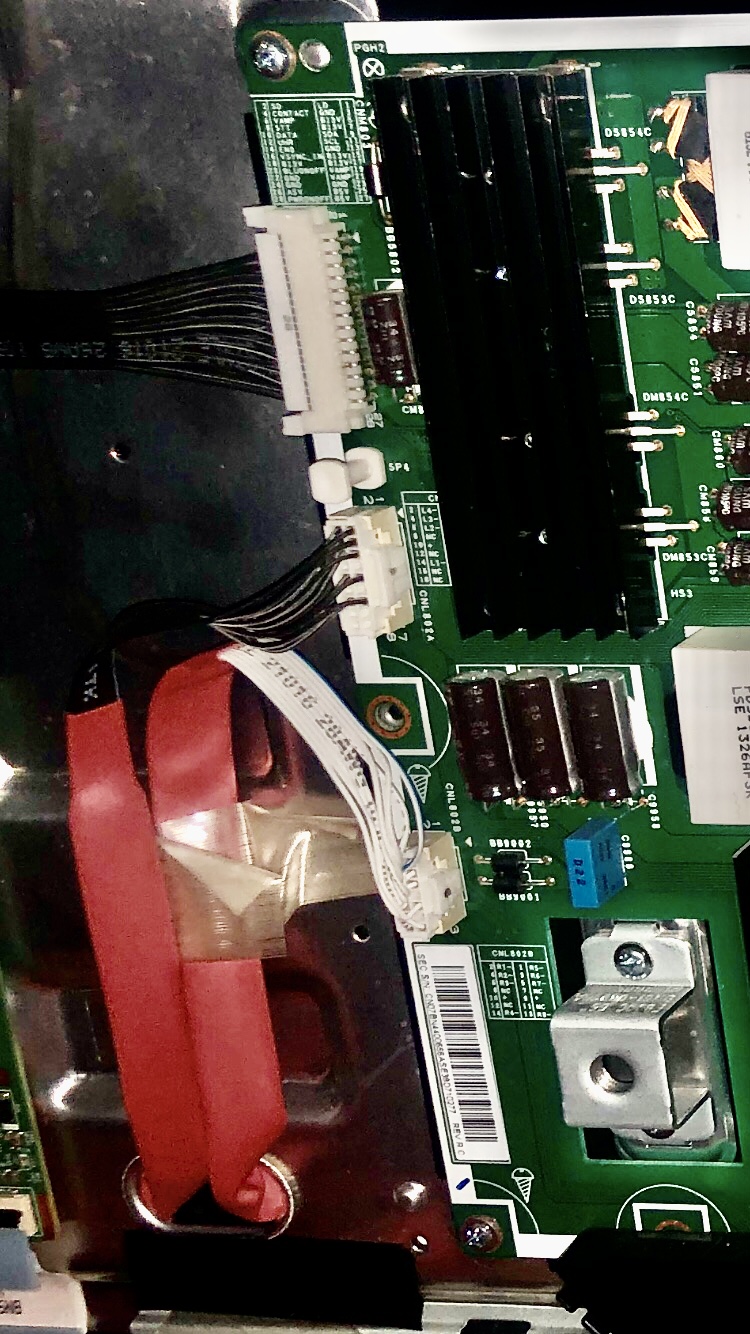

        Re: Samsung UN60F8000BFXZA ~ No Picture or Sound - 5 Res Light Blinks
        Given the pictures I posted earlier, does anyone know how I can safely force the backlights on re: this particular model Samsung tv?
        I would like to prove or disprove that the backlights are still functional. What would be the exact steps that it would take to jump them on?

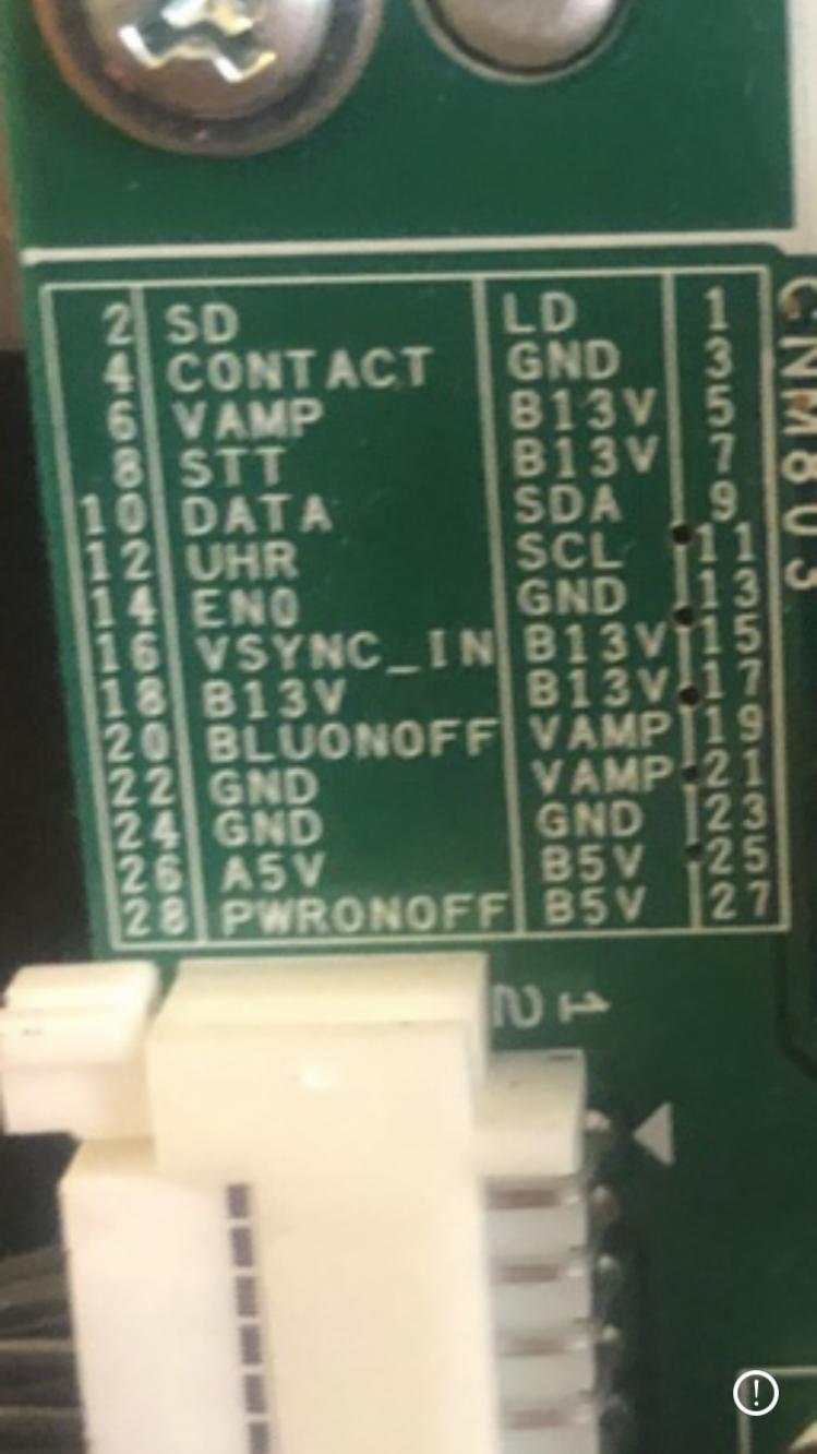

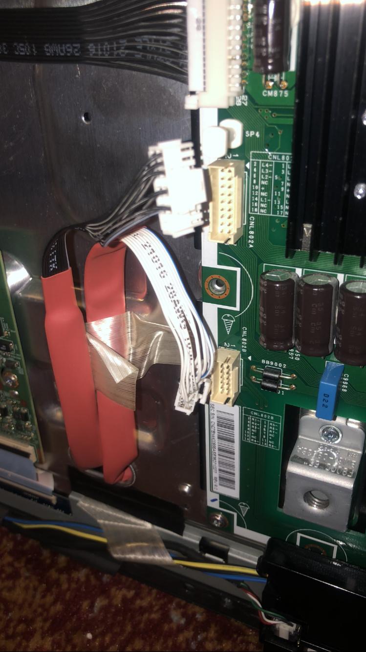

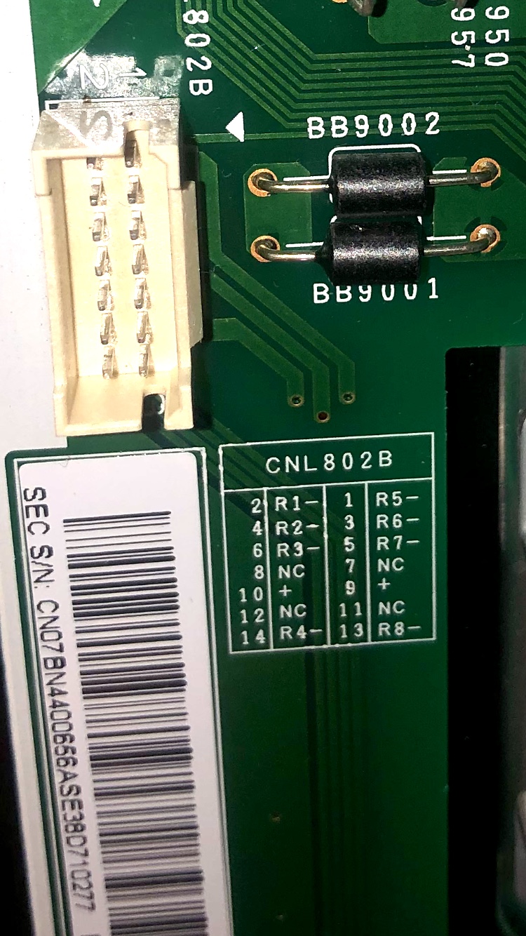

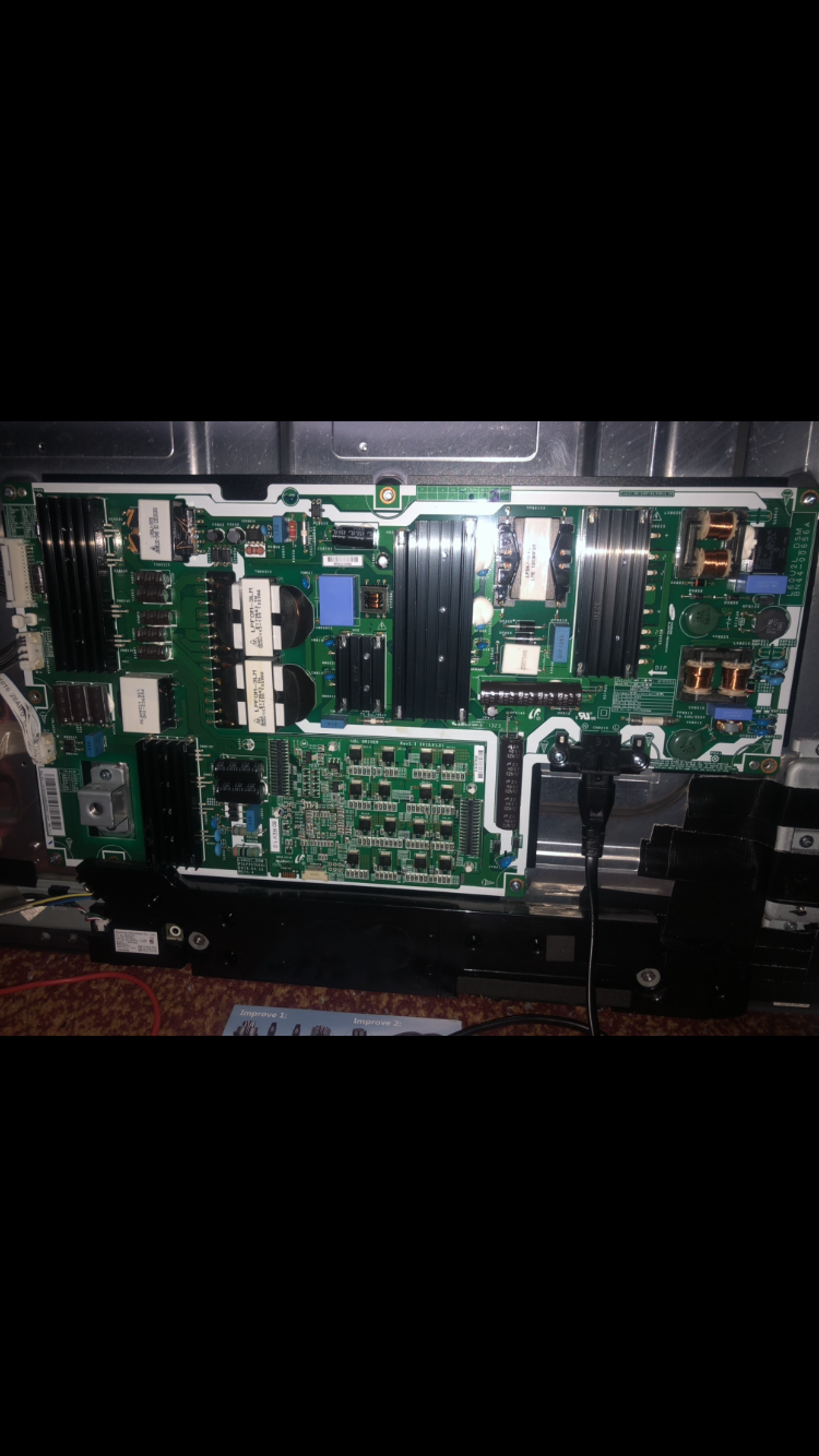

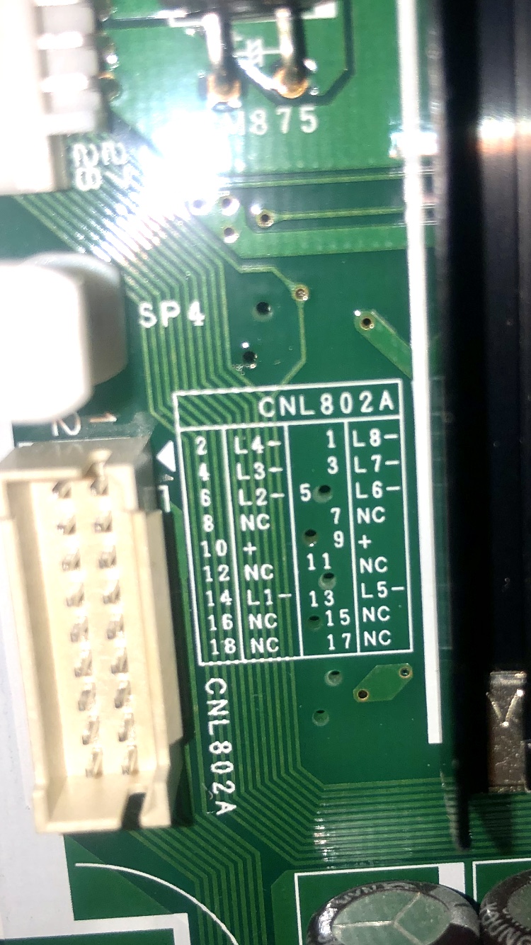

                            Here are the pertinent images of the PS board we're discussing:
                            Photo #1 = Entire PS
                            #2 = top left (primary) connector voltage chart
                            #3 = middle left connector chart (heads out directly to one of two LED cables)
                            #4 = bottom left connector chart (heads out directly to the other LED cable)
                            #5 = image of the two “twin” LED cables themselves

                              Ok, take it slow, #2 with cable from powerboard to mainboard unhooked, check the pins voltage 1-27 can skip grounds, which pins have voltage and how much.

                                Yes, it appears this model’s PS is designed to supply voltage directly to these dual LED cables via the two connectors. As I mentioned in an earlier post, the readings on both the middle left LED connector and the bottom left LED connector are 0.0 on all of those pins.
                                In other words, it appears that the PS is failing to supply these LED connectors and cables with the necessary voltages. But, could it also be that the failure of the backlights themselves might cause the voltages to be denied to these two LED connectors because the tv recognizes the backlights are not functioning (or not functioning properly) and it therefore denies voltage to the LED cables because it’s attempting to protect itself from further damage?
                                This is why I’m trying to fire up the backlights in any other, logical way to prove to myself that the backlights are not the problem and that the PSU, definitively, is the issue.
