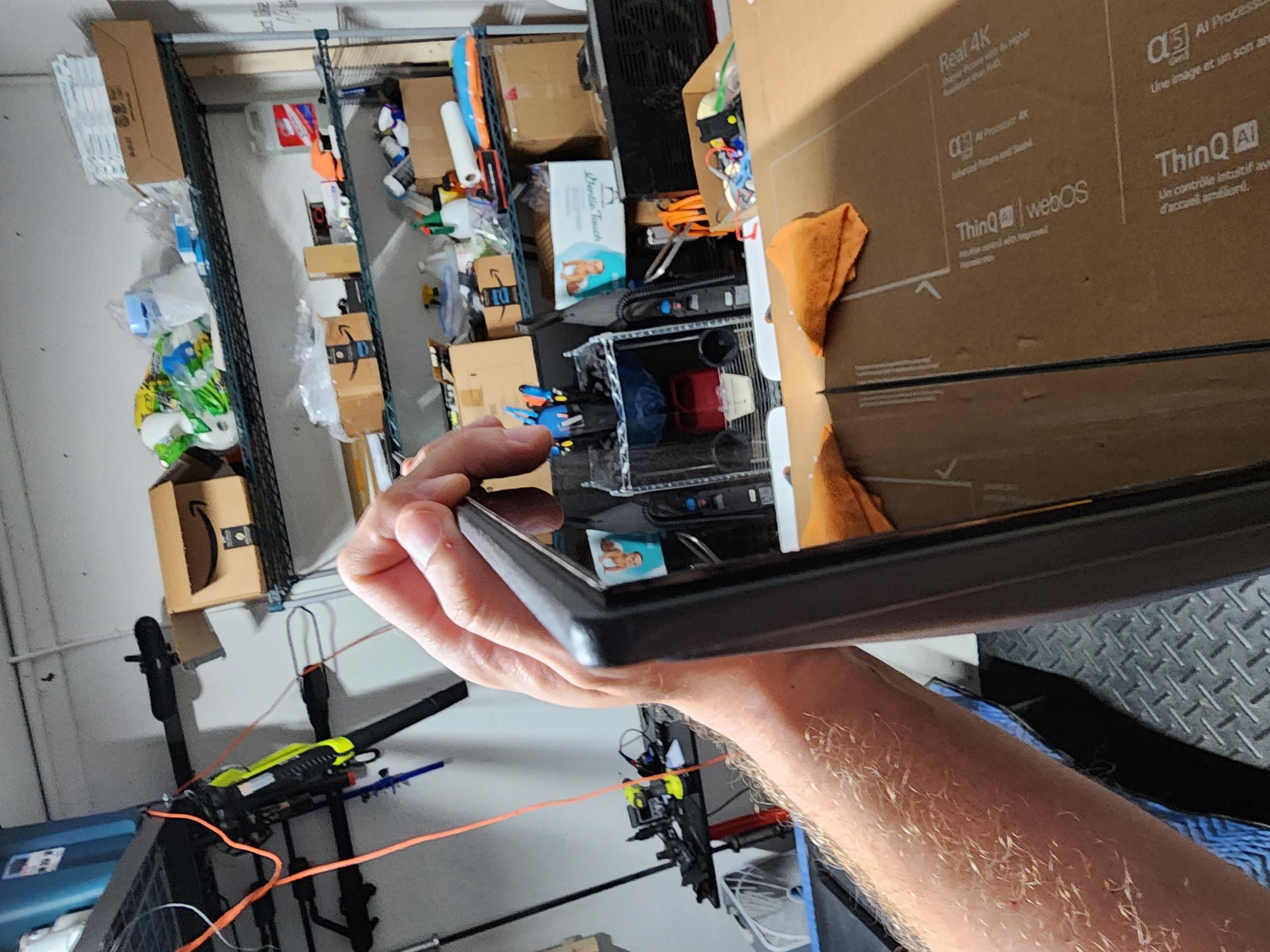

    I got this 55r6095g5 picked it up free. Considering changing the backlights but these things don't have a bezel that holds the screen on. It's just like double sided foam tape holding it on and nothing else.
    How does one replace this? Inevitably when I use something to cut the screen out it's going to leave crap on both sides, and do you scrape it with a razor blade or something?
    How does one do this? Picture shows it

    Prolly similar to this one, looks like a pain in the ass but isn't it all, lol: https://www.youtube.com/watch?v=Sq4XQBWzaCc

      Yes I didn't know if there was a better way. Seems ghetto but alright. I've done this once already but maybe there was another way

        heating pad/ heat gun ( with controlable heat setting )
        And use end of a ribbon cable to slowly pick it away
        slow job

          Pulling it off is no problem, but what's the method of putting it back on.

            You need some black double sided tape. Don't use clear ... I did on my first fix on one of these and the light comes through around the edges of the screen. Use black only.
            Here's a link on Aliexpress.com ... Amazon probly has it to but more expensive.
            https://www.aliexpress.com/item/1005002050734745.html
            I used 5mm but is very hard to work with ... so thin. the 10mm would be better to work with.
            Heres a youtube video tooo .. https://www.youtube.com/watch?v=PN3vp1RtiL0
