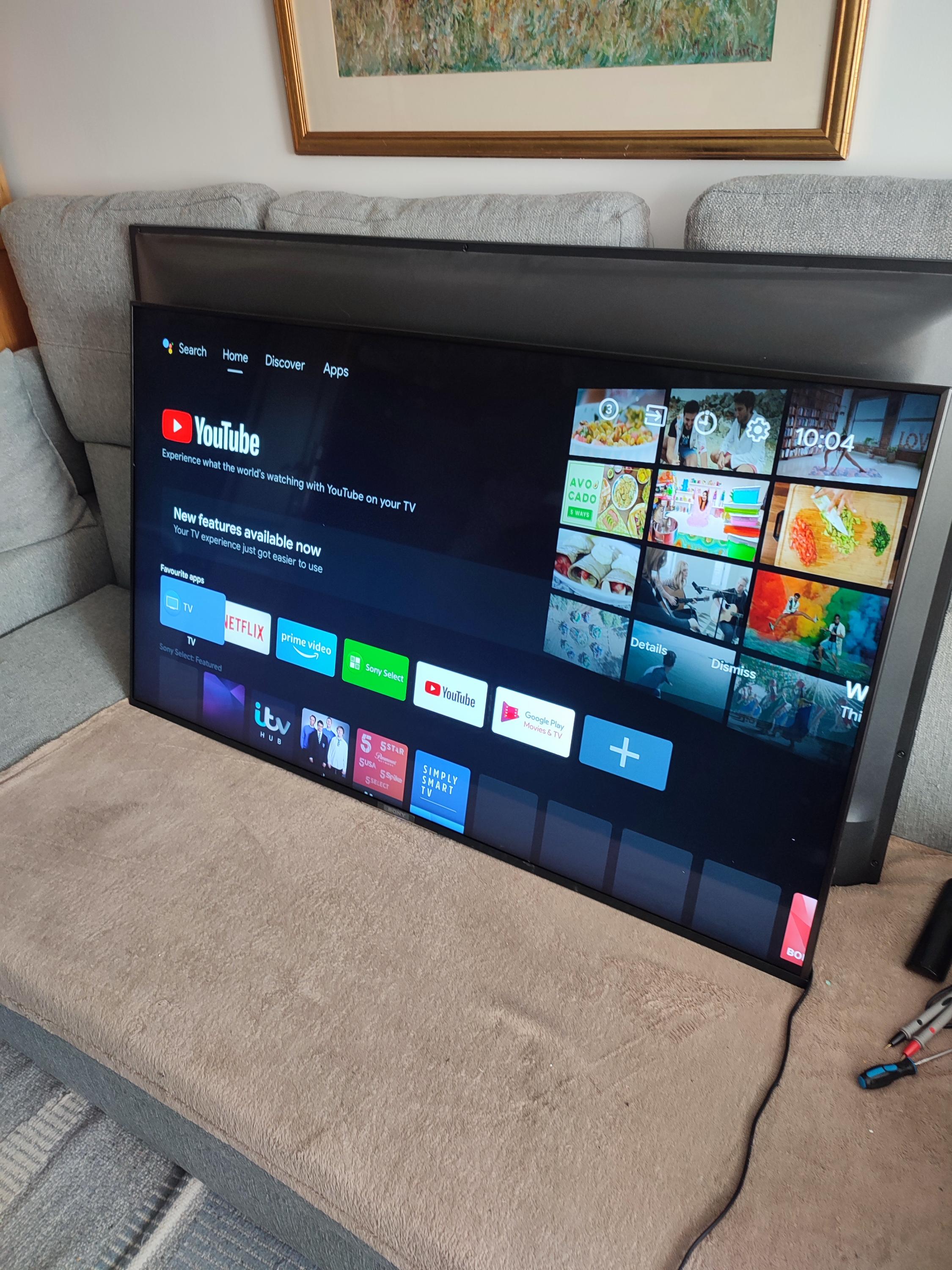

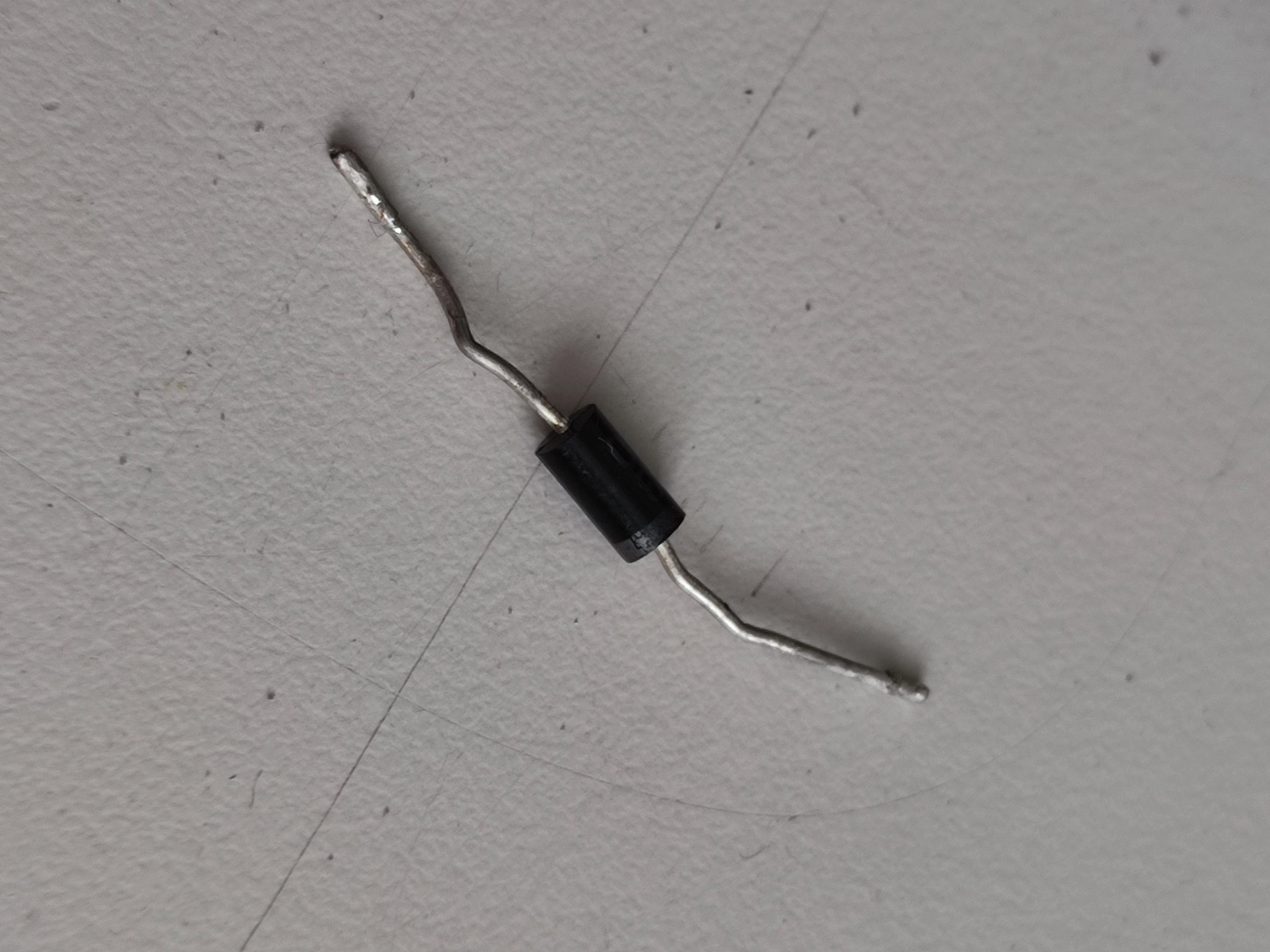

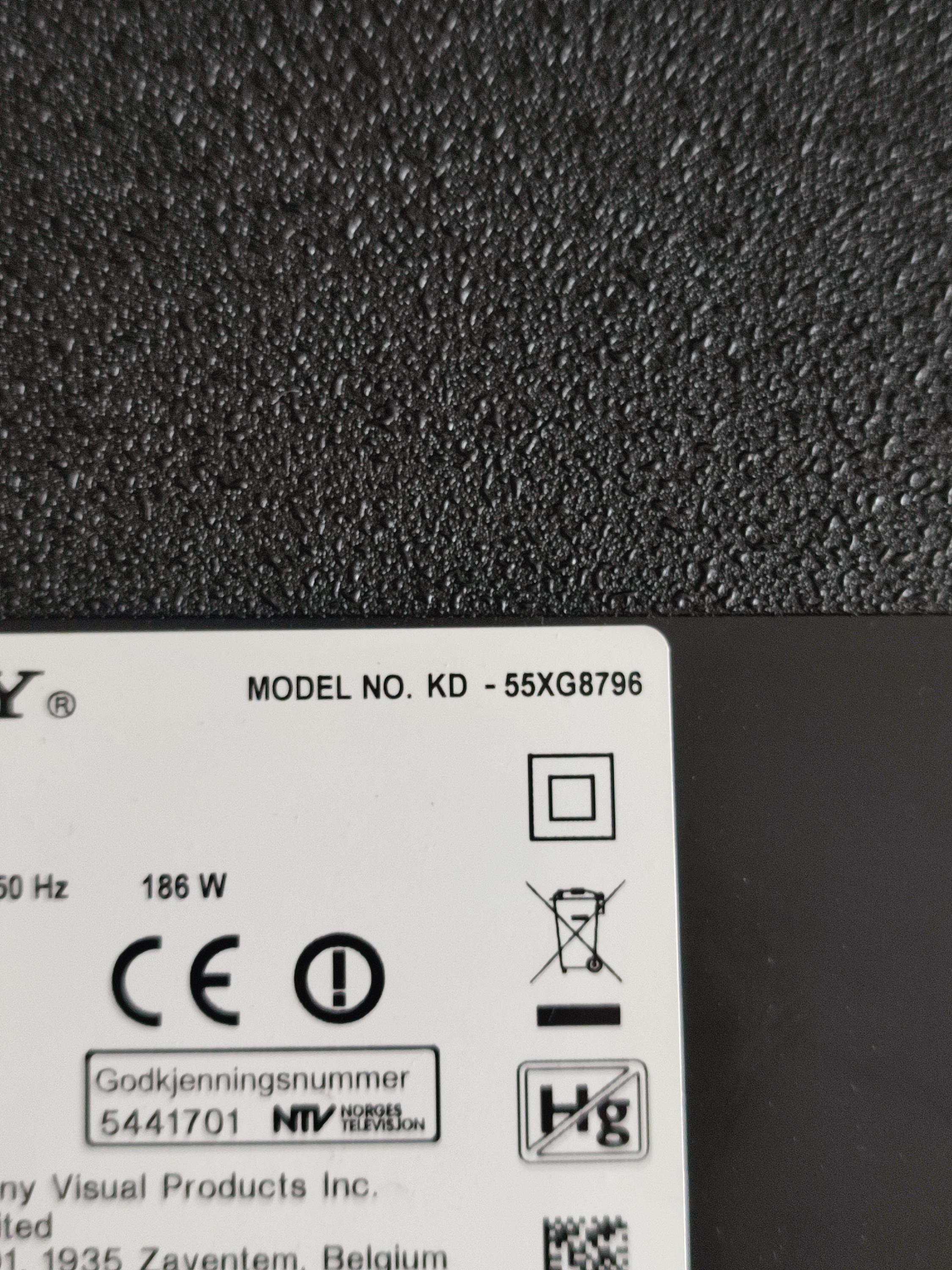

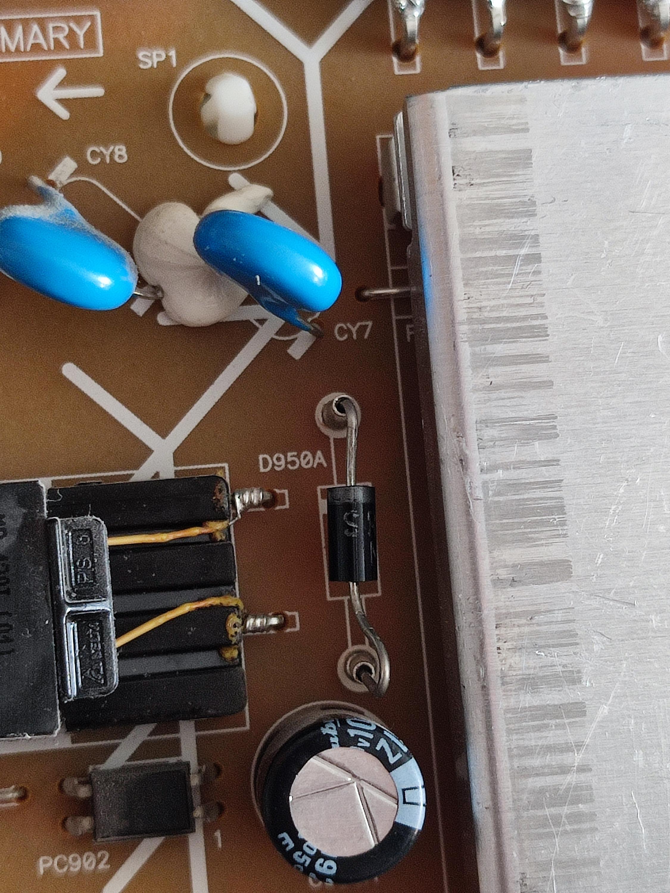

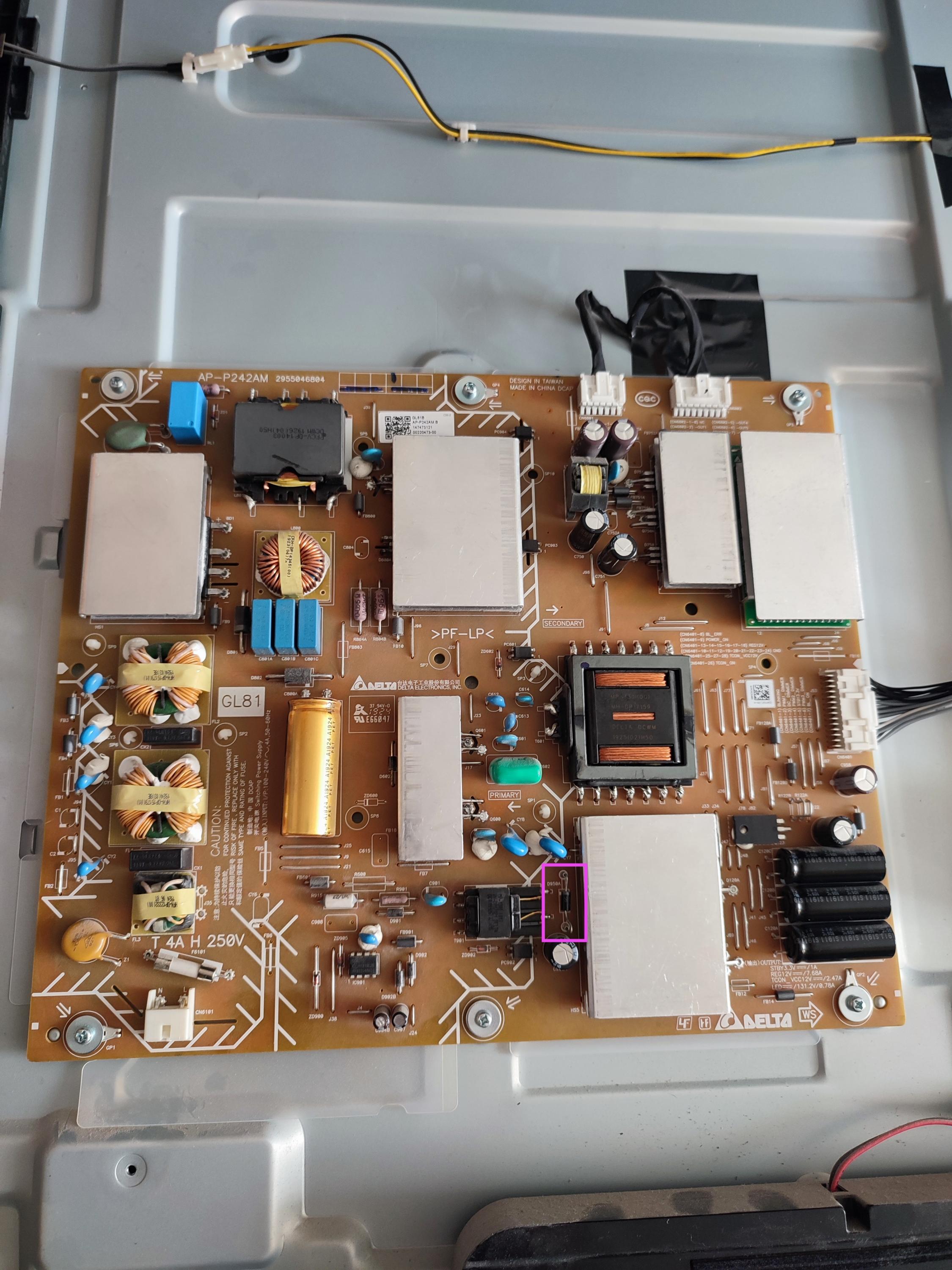

    I have been given a Sony KD-55XG8796 with no power no lights. I have done some measurements and I found diode SB260 shorted D950A position on the board.
    I have replaced with SR260 and TV came up to life.
