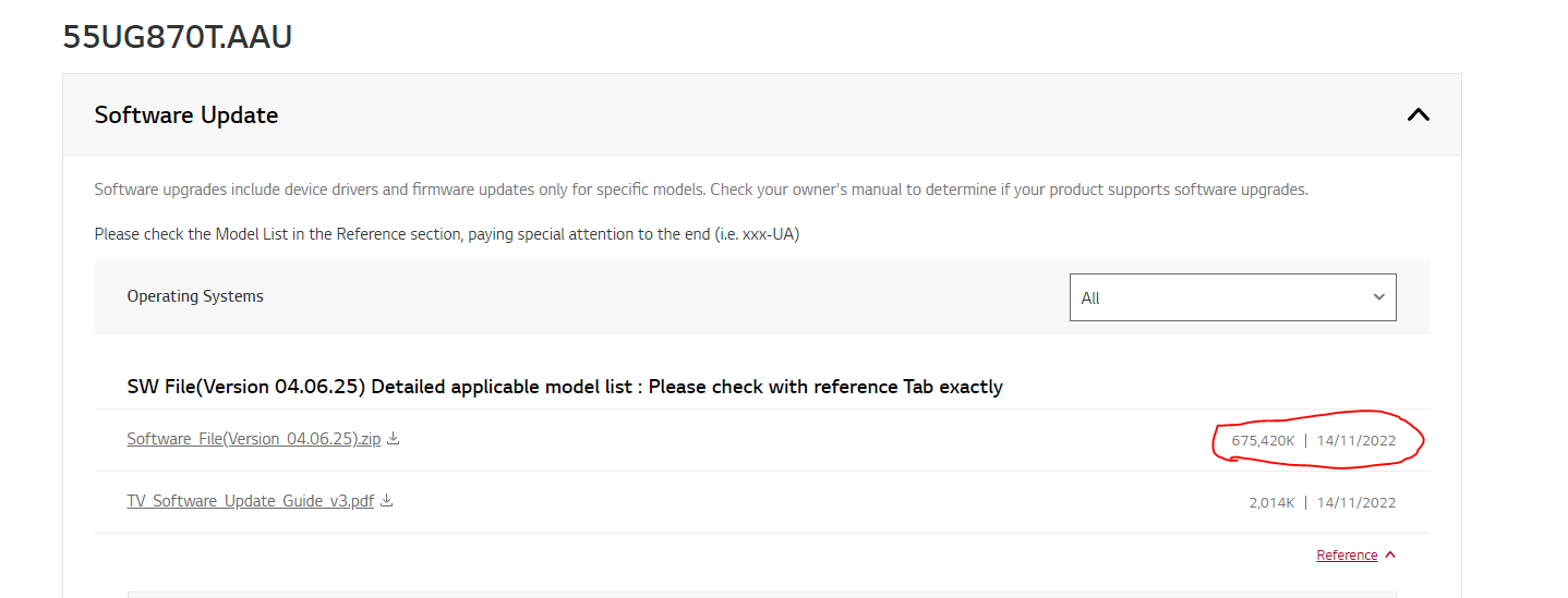

                                  An Update.
                                  Replacing this very expensive mother board got this tv fixed. The kicker, none of the smart functions work because the tv is 8 years old and not supported by LG anymore. Nice hey?

                                      Re: LG 55" Curved Model 55UG870T - No picture
                                      Originally posted by angelos
                                      An Update.
                                      The firmware most likely needs to be updated; it was released only a year ago.
                                      Or you bought a motherboard with a different region and it does not support your region.
                                        Now that you mention it, i did have a region code issue. The LG tech's told me to change the region code. I did so but none of the smart functions worked. Youtube would just show loading. The browser was out of date and would not display HTML pages correctly etc. They simply said i must get a firestick or android box to continue.
                                        This set has gone out to the client. The TV is 8 years old apparently.
                                          Yep, I believe they were on the 2.5 version of the OS back then.
