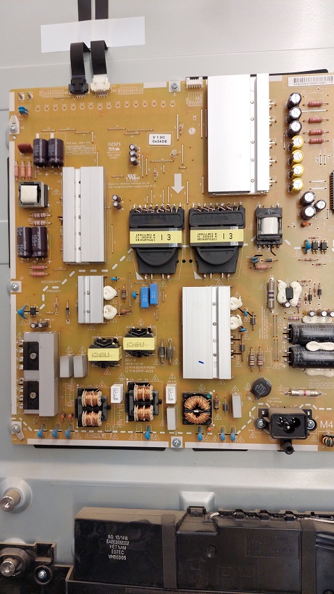

    Hi Guys,

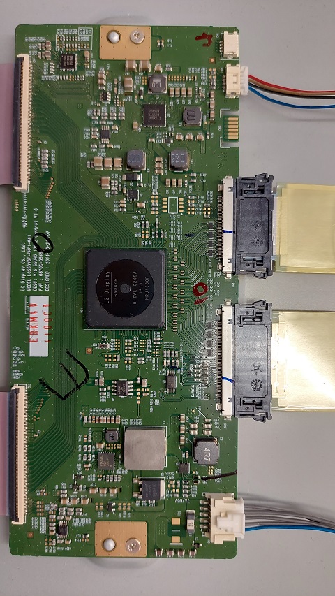

    I got in this set that has no image but the back lights are running. I tested all the usual issues relating to panel faults and there were none. On the TCON, the two LVDS cables were unplugged coming from the main board and then when i started the TV i got the burn in mode (green, blue red , white etc cycling). This tells me that the panel is ok. The only thing i am not 100% sure of is that i dont know if my TCON, head end is being processed. But i doubt its that. The LVDS cable looks clean. No water damage in TV and not much dust.
    I measured all the power supply voltages and they were spot on.

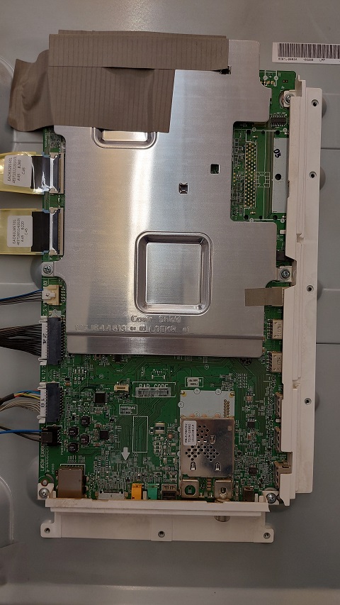

    The only thing remaining is the main board. I know LG have issues with the processor balls (BGA) going dry joint but what i want to know is how to be 100% sure that the fault is the main board and not something else.
    When plugging in HDMI1 i do get audio from the movie i am playing so that part is ok.
    I added some photos to jog your minds if you now the set and its common faults.

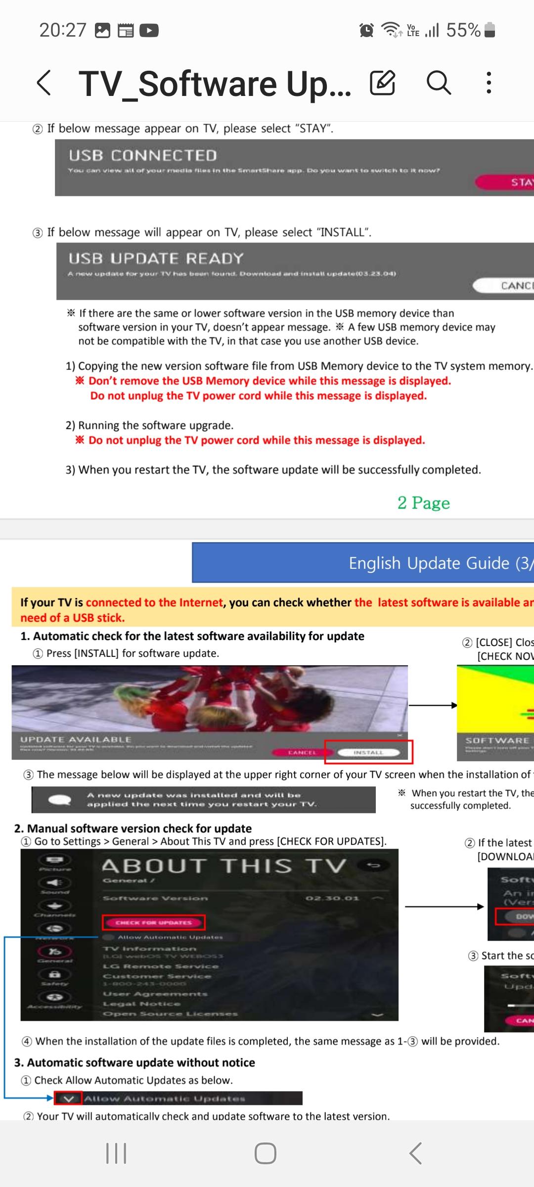

      Nope. I have never asked LG for support. I will try it. Over the courier of next week I will try find out who can supply me the firmware.

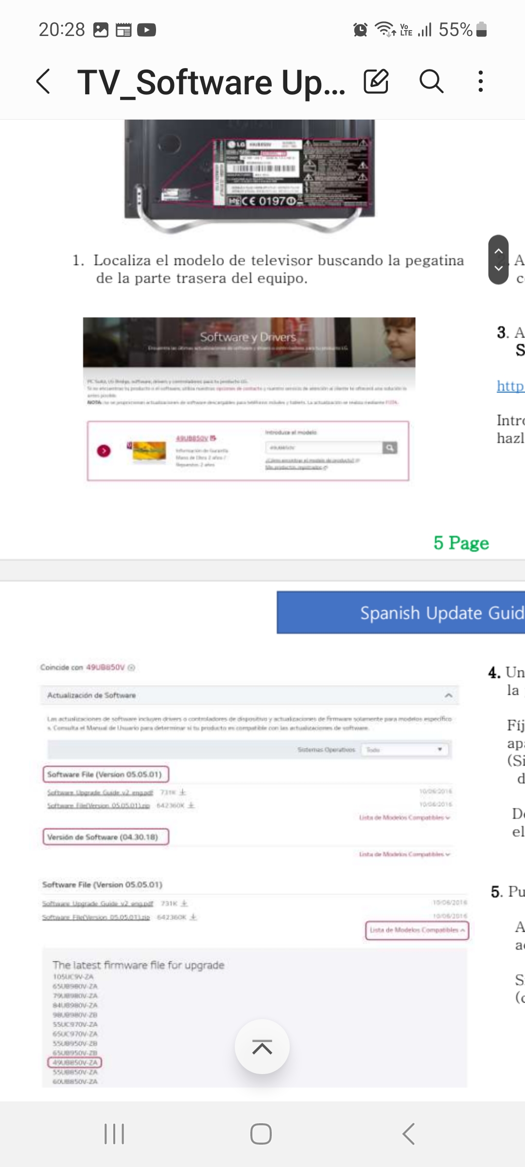

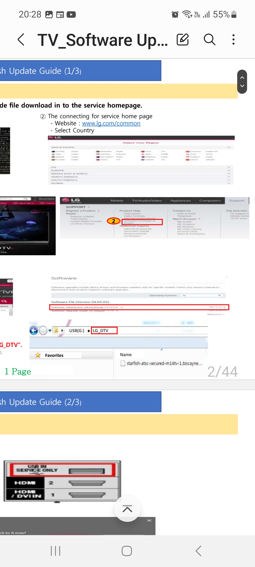

        Hi Nomoresonys,
        I just found the LG site that can supply me with the software update. If you look at the procedure. It prompts you to make a choice so now I am in the blind. I can't see what is happening. The procedure does not say if you must have the tv unplugged and then insert usb stick into the tv. I am going to post some screen shots of the "How to upgrade" file.

          Sorry, I used my cell phone to screen grab the manual. How would I go about doing the firmware update in the blind?

                  I was told by a colleague that if you have a blank screen but look at the screen at an oblique angle and you see a purplish hue then that means the panel is good but we are not getting any video. So that would mean the video processor is faulty on the main board. The cost of the main board is 41% of the cost of a new tv. Nice Hey, What a waste. To the rubbish bin.

                    Need to check the tcon, check vgh, vgl etc, there's probably 100 videos on youtube for fully checking tcons.

                      If the tcon readings are not what they should be, unhook tcon ribbons going to panel on tcon side and retest.

                          Sometimes one of the little mlc caps responsible for vgh will go bad on tcon, resulting in no picture.

                            All the Voltages are correct.
                            VGH = 28V
                            VGL = -6V
                            AVDD = 17V
                            HAVDD = 8.5V
                            Remember that i said i one of my previous posts that when i unplugged the LVDS cables but left in the other two cables (refer to photo tcon.jpg) and i started up the tv like that. The LED panel started showing, Green, blue, red, white, black and repeated it indefinately. This is ageing mode. This tells me the panel and its voltages are fine.

                                  Wouldn't this mean theres a problem in the panel, ribbon cable or one of the panel driver/address boards?
