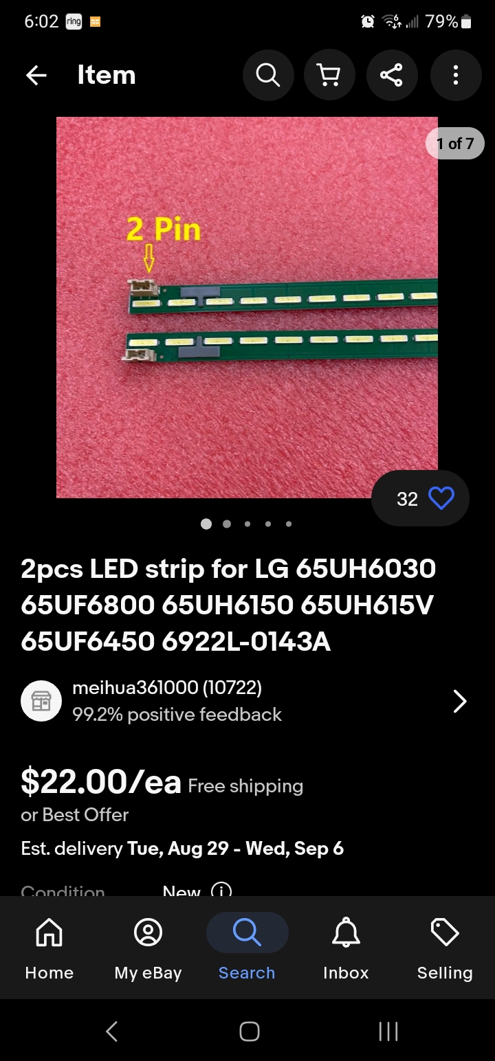

    65uh6150 backlight. Looking to replace individual SMD but don't know how to even search what type it is and just buy like 20 different kinds to get correct ones lol.
    Closest.thing I found was diah post of 7030 but maybe it's 7020 etc.
    https://www.shopjimmy.com/lg-6916l-2...t-strips-bars/
    Any clue? Thanks

    Why would you bother replacing individual LEDs when whole strips are so cheap ?
    The LEDs that haven't burnt out won't be far off.
    https://www.aliexpress.com/item/4000005817241.html

      Re: 65uh6150 backlight question.
      That's for 2 strips. There is probably 6 strips and that's 45$ plus shipping.
      Where a set of leds for like 170 is like $5 and I'm fixing TVs so in future I will need another set.
      I did buy an assortment that should have it but still curious
        How many edges are lit in an edge lit TV ?
          It could also be this pair of strips, it depends on the connector.
          https://www.aliexpress.com/item/32857516818.html
            Ahh this is something I didn't know. Edgelit isn't something I've come across and had no clue that was a thing. So truthfully why not replace them all is good point. Gotta learn somehow, thanks
