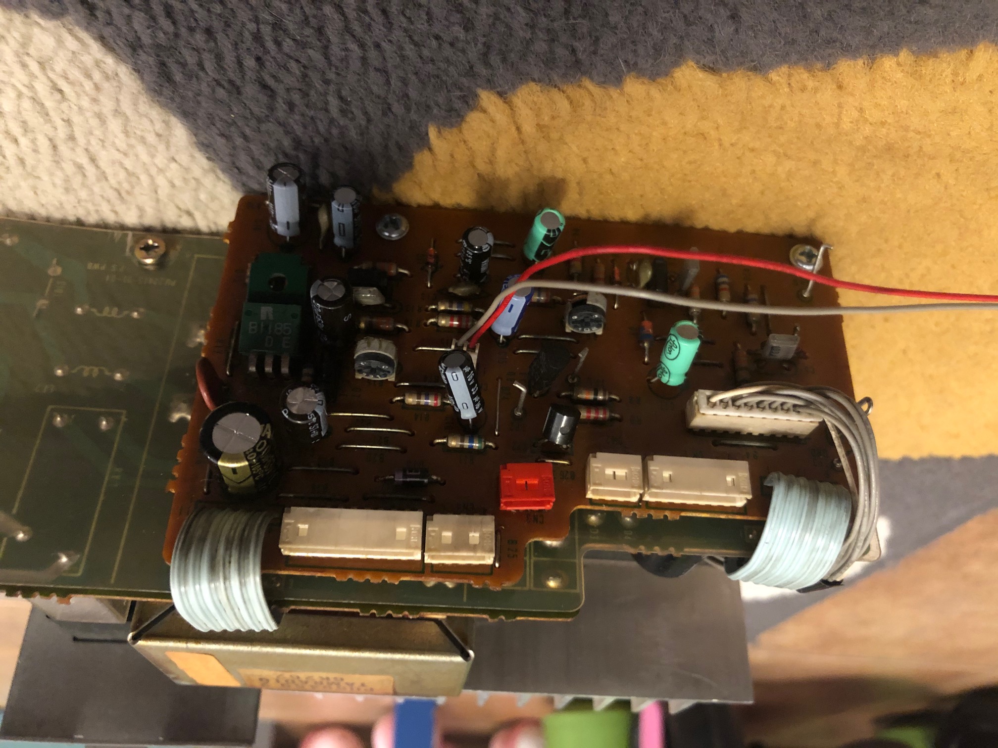

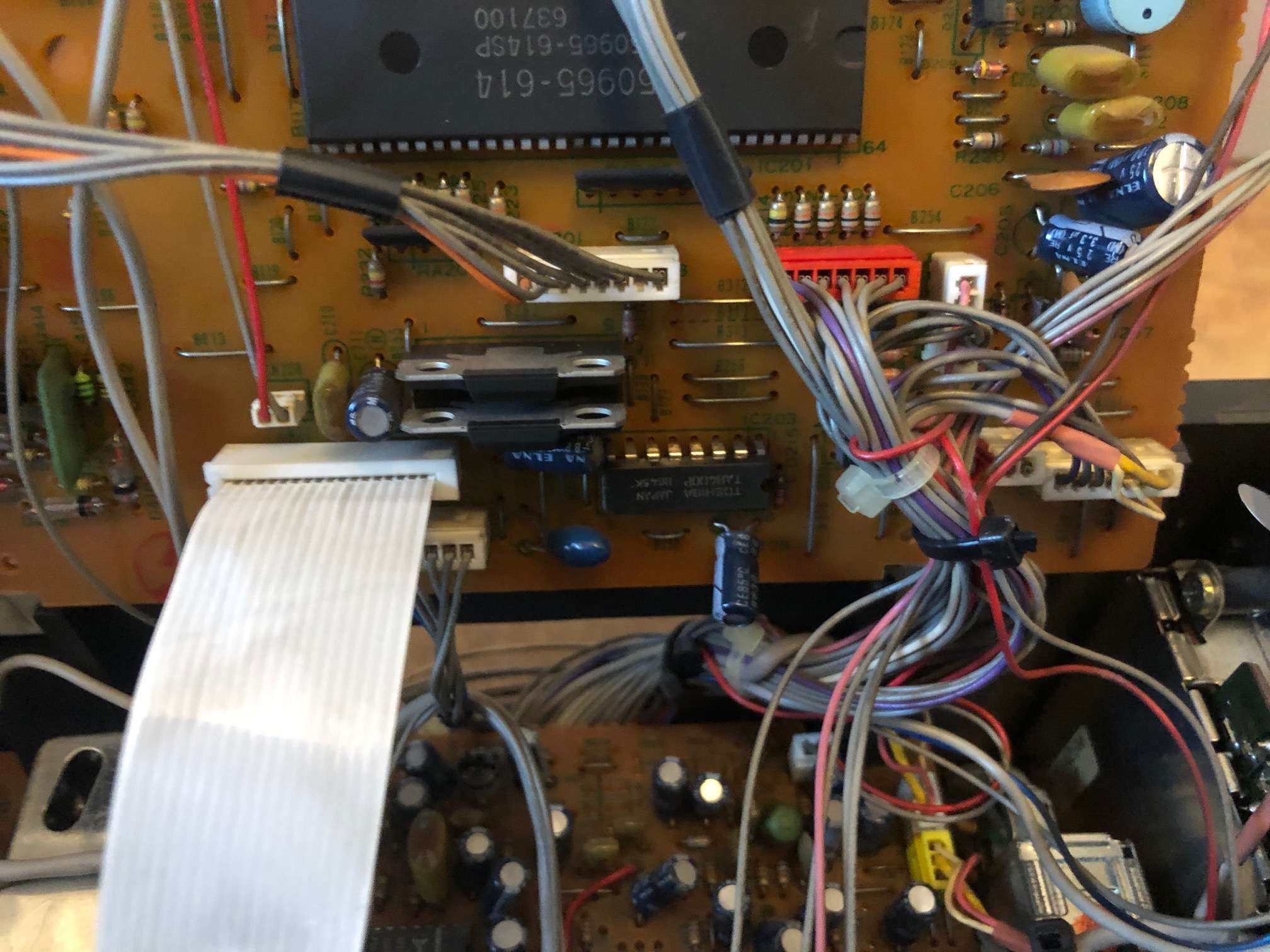

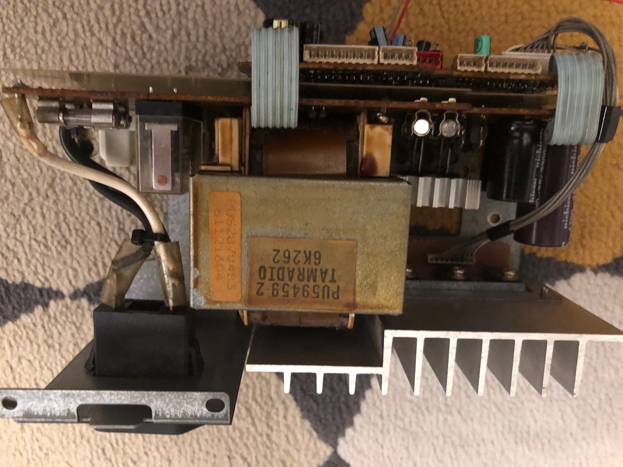

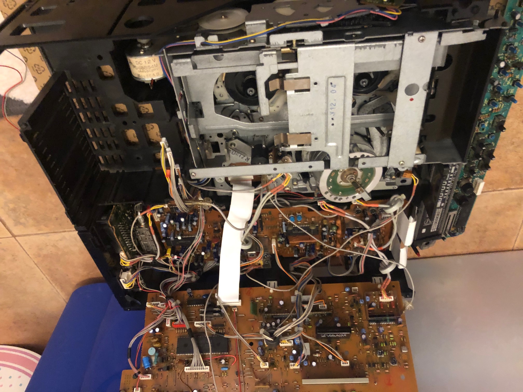

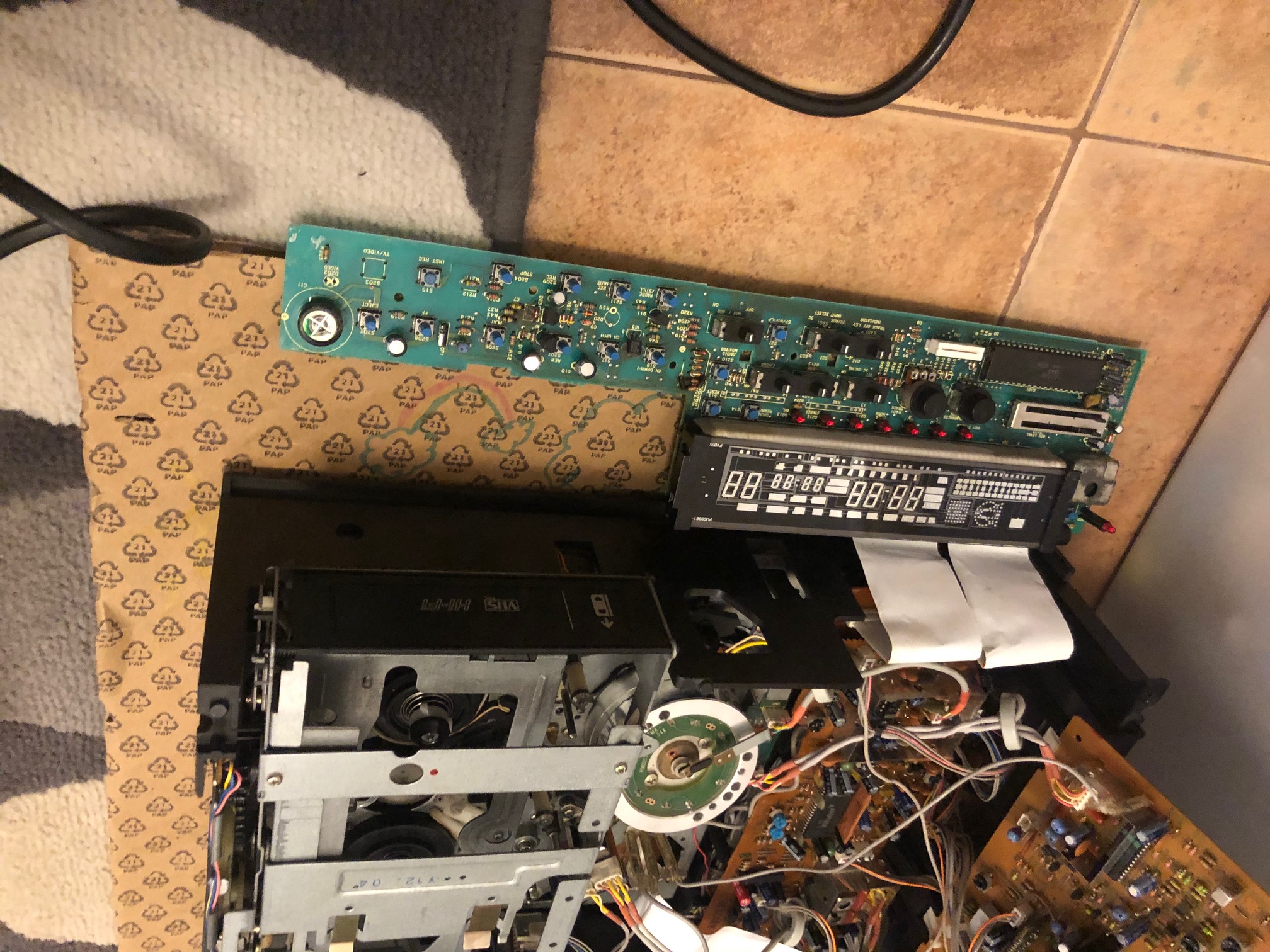

    Hi everyone.
    I bought this vcr, I don´t know if you are like me, but I´ve never heard of a vcr with a side loading mechanism...
    It was working, but the only problem was that as I loaded the tape, it started playing and a second after stopped, FF an RW equal.
    I have seen some youtube videos that showed that maybe was the reel sensor, the only difference was that mine, changed the counter from 0000 to 0001 or 0002, so I was not convinced that it was the problem... Dispite that, I connected my bluetooth receiver through rca cables to input, and I only had left channel in stereo, only in mono I had both channels, so I decided to disassembly it, download the service manual, and order all electrolytic capacitors for all boards, including PSU, in the hope to have a 80´s fantastic engeneering device for mora 40 years or so...
    I took pictures of all boards and connections, but after all caps replaced, I swapped power transistor plug "CN6" to "CN5", it has the same pin count so I stupidlly wrong connected it, when I plugged it to mains, the "Fuse2" burned all of the sunned, then I connected the mains to my serial bulb short protector and replaced the fuse, but everytime i turn the mains on, the fuse blowed, until I figure out that the plugs were connected wrong.
    My question is... After connecting all right, I measure voltages in PSU and none look like in the service manual.
    I replaced again all electrolytics in th PSU, but still the same.
    I´ll attach all the service manual I have and pics and video from my device.

        Can you highlight the two "power transistor plugs' that you mixed up, with good focused pictures of the whole area, for original problem, what exactly did it do? Looks like you put tape in, push play and 2 seconds later it ejects the tape on it's own, is that correct?

              I nomoresonys.
              You´re right, I´ve seen the video before got courage to disassembly my vcr and replace all electrolytic caps, hoping my problem was only bad readings from eeprom and the sensor was good, but after replacing all the caps, as I said, I mixed up the plugs on the boards.
              After measuring on cold, all the PSU components, I figured out that when I mixed up "CN6" to "CN5" the "R1" 10ohm fuse resistor burned out with "Fuse2" Thank God it did, I replaced it with a 2W 10ohm just to test and the VCR came to life again, all two audio channels work, beautifull sound, but the reel sensor doesn´t work, it starts to play and stops just like the youtube video. I searched on google, I can find the sensor, but only in foreign sites, that dont ship to Portugal.

                  I figured out the problem, as I said, the fuse resistor "R1", burned out as When "Fuse 2" burned too.
                  After replaced the resistor, the VCR came to life again...
