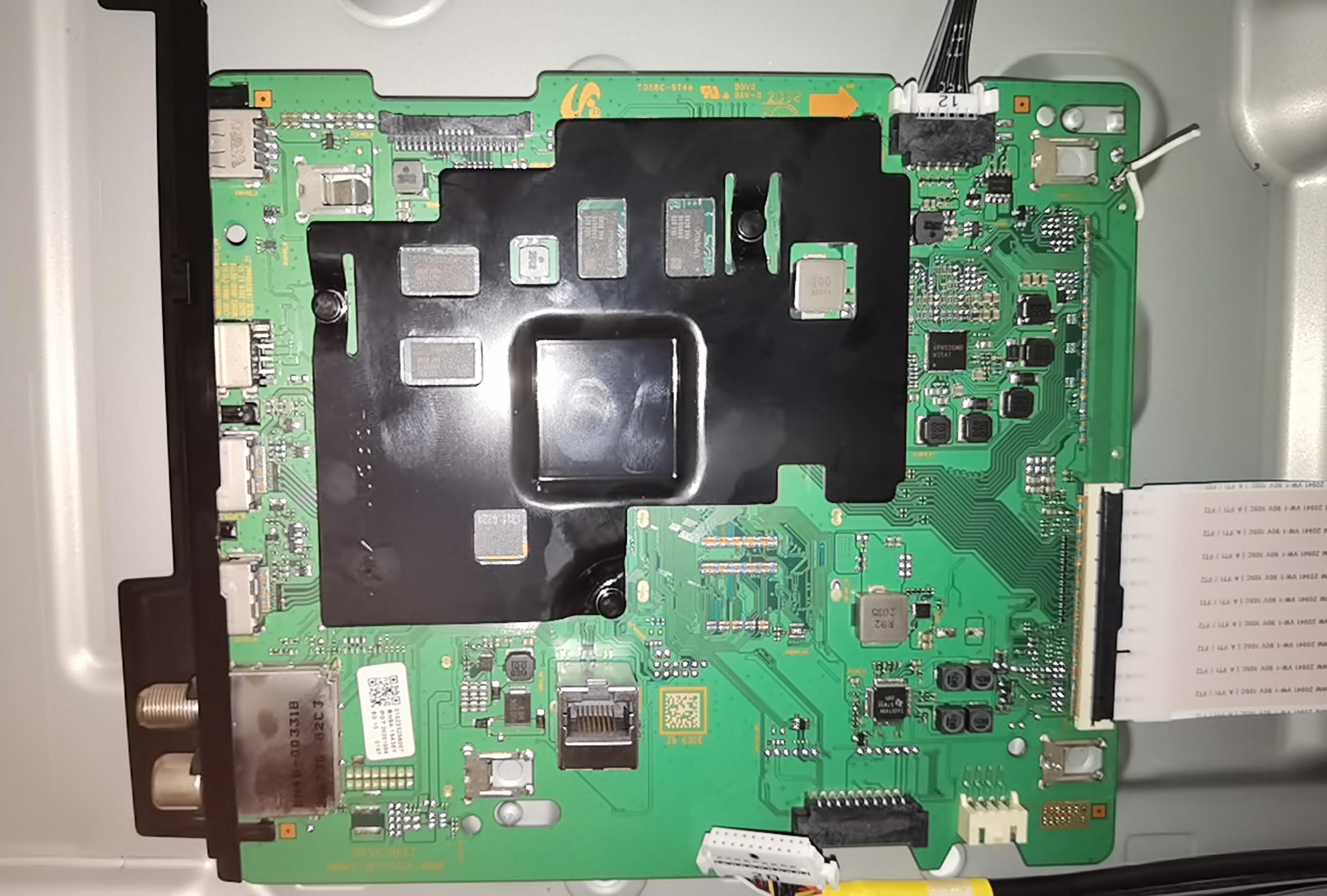

    1. I remove PSB input to MB ,the backlights are working fine ,no boot loop
    2.Connected PSB input to MB ,boot looping

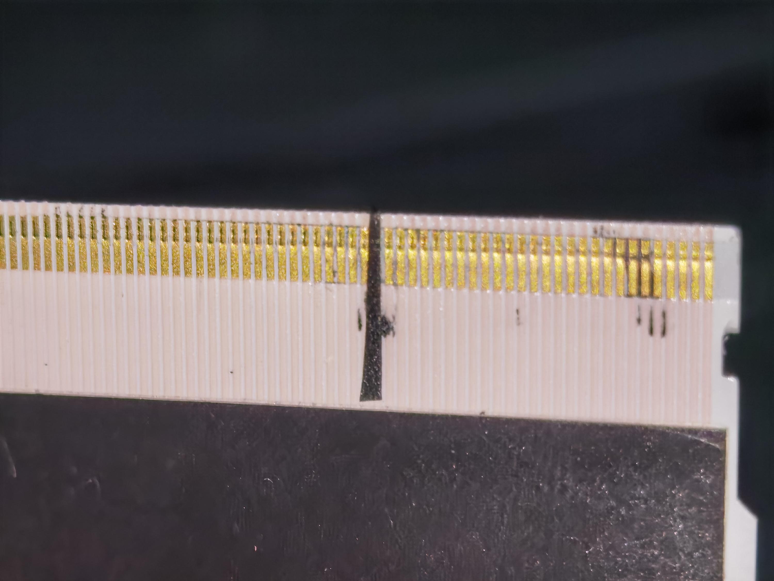

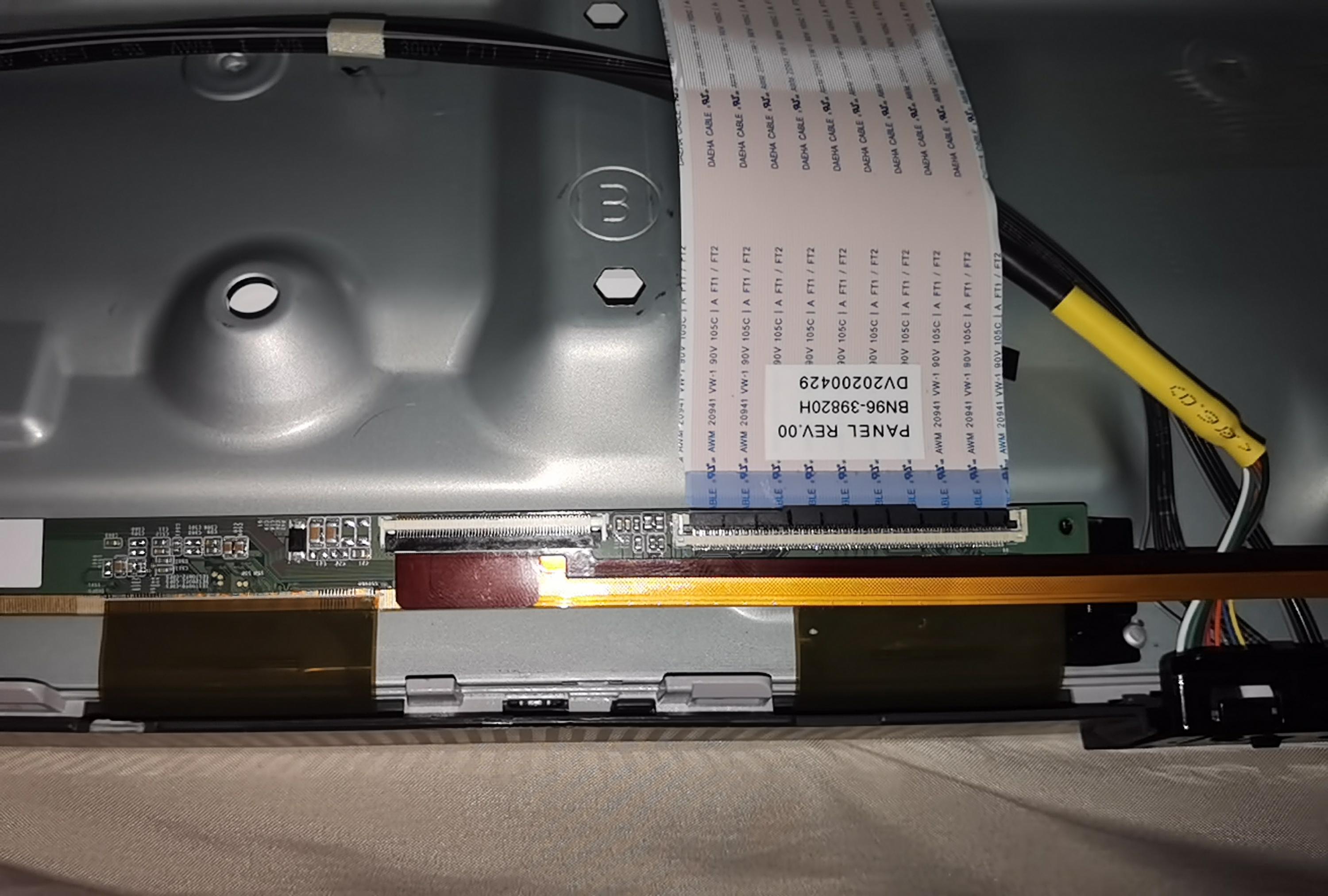

    4.Connected the flexi cable and removed the U shape flexi cable on panel pcb to isolate right side of the panel ,still boot loop
    5.Tried the masking trick and after various combination ,masking pin 28 on the flexi cable from the MB output side, no boot loop and the tv show line on display
    i have done voltage check on the panel side and i am getting 24v dc on both side of the panel.

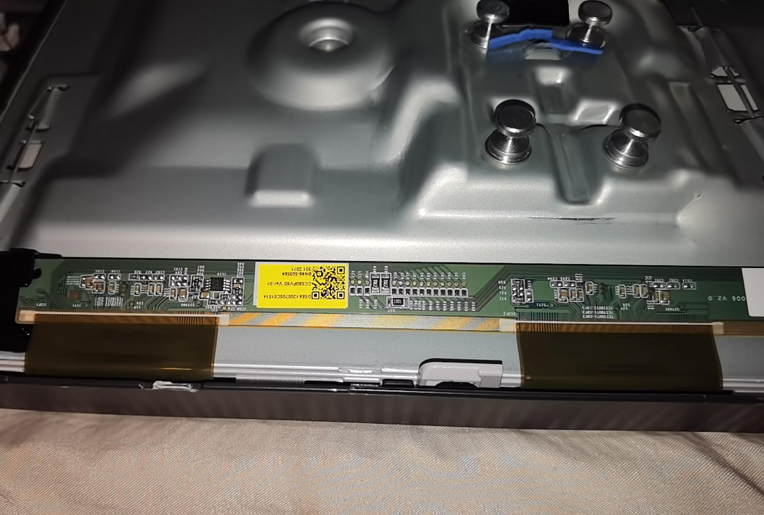

      Put up some good clear pictures of the panel driver boards and their connections, one easy thing to do is clean the ribbon cable ends with isopropyl alcohol, some use pencil erasers, not too vigorous they can be delicate.

        Another easy test, test the little mlc caps on the panel driver boards, probe on each end, check for shorts or very low ohms.

          Hi i am attaching some pics and sorry if i ask some silly questions as i am not a electronics nerd .. i m just learning from this forum .

                    Sometimes you can not get a good picture just masking one line, try masking about 15 pins on the bad side, sometimes it takes trial and error and sometimes it's just not fixable, in some cases it can be a bad diode array or bad resistor/s or other component on those boards.
                      well i have done all those trail and error hours and i reach up to this point .. the videos on youtube are not specific to this model and few are there but language barrier..
