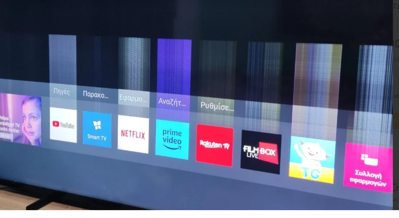

    Philips 58pus7505
    Hello
    i have this problem
    after 30 sec power on make this problem ...
    flicering this line ...
    do u have any idea what is the problem ,,,,
    THNKS

    Re: Philips 58pus7505
    I had the same thing here, but the TV was still under warranty so the entire panel and timing controller board was replaced.
    The conclusion from the repair technician was that it's an error in the panel, so that doesn't bode well for you unless you still have warranty on your TV.
