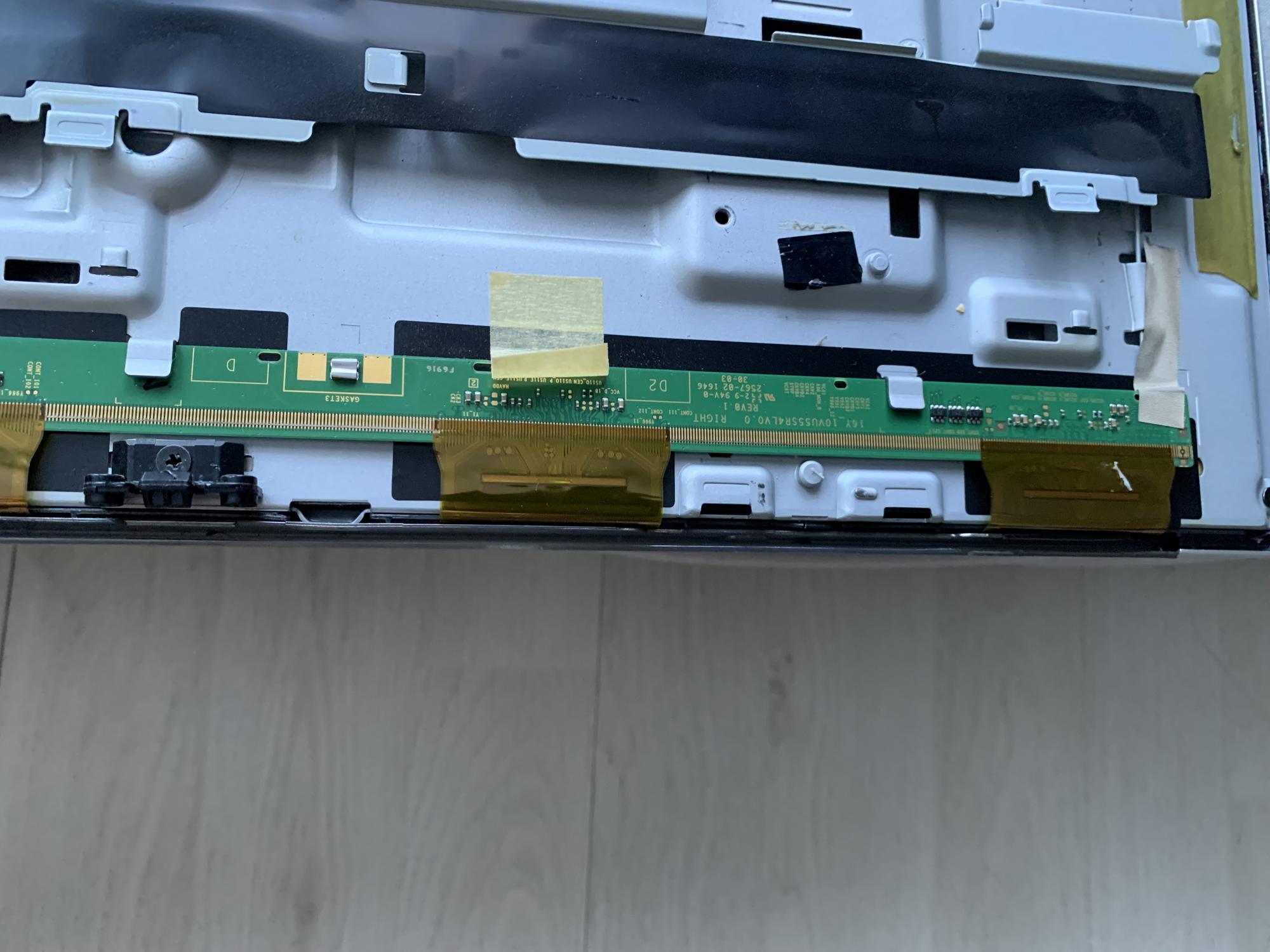

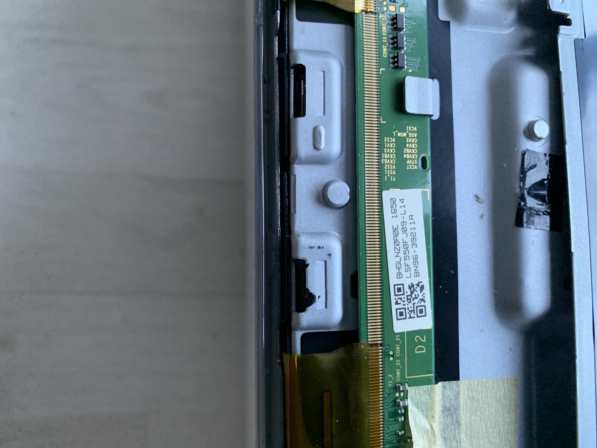

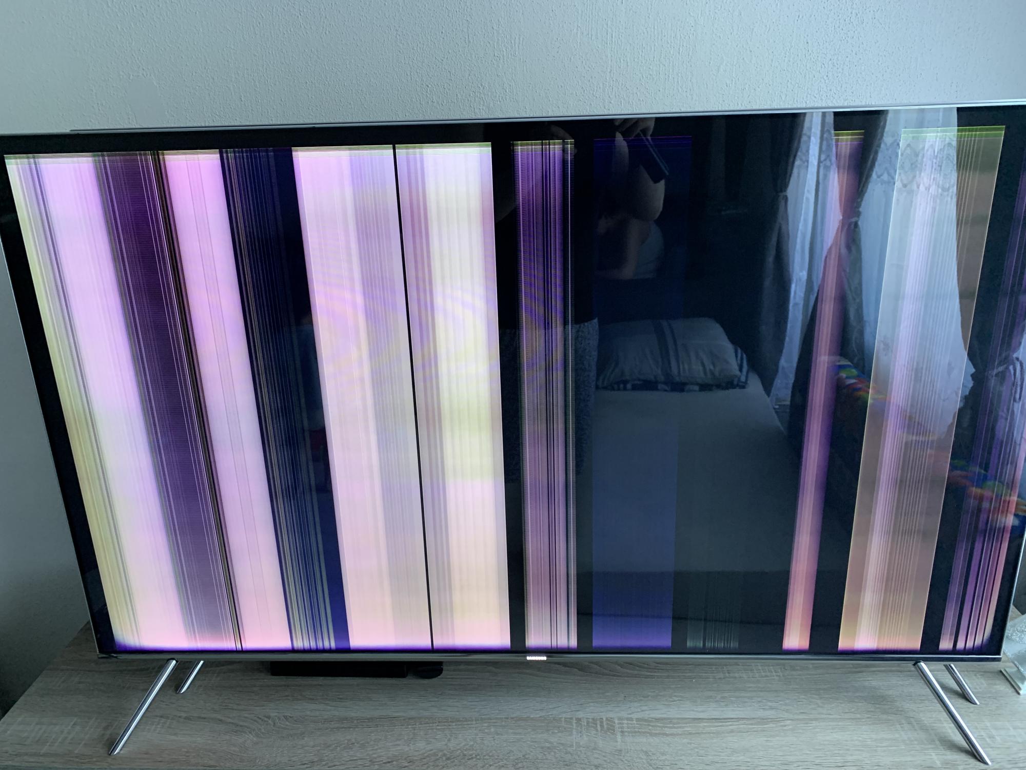

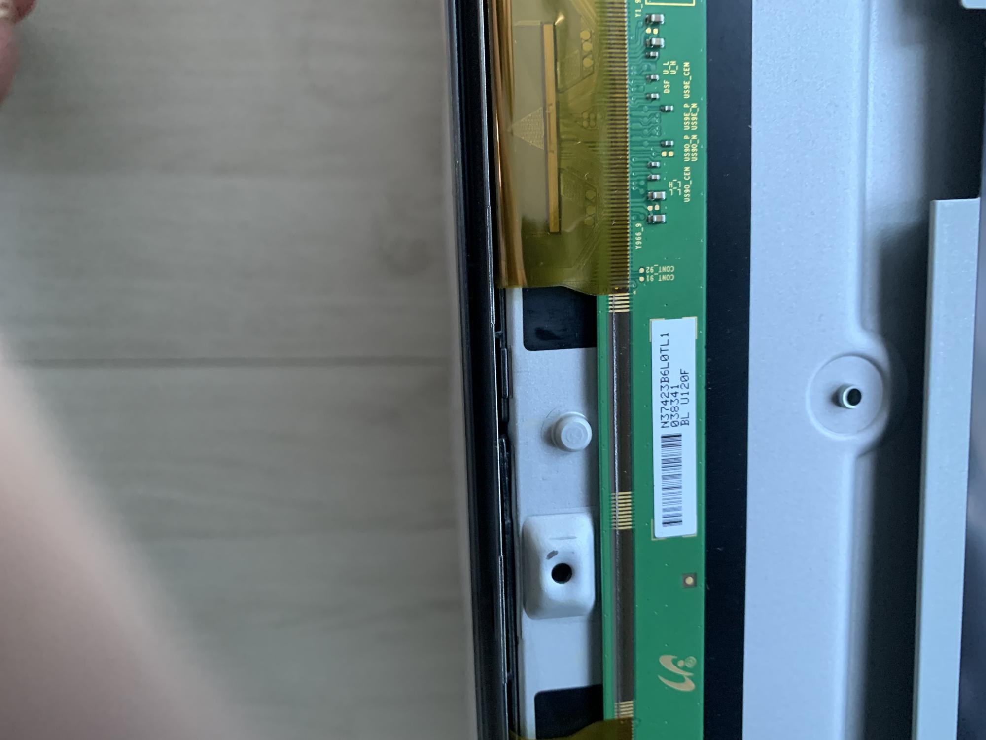

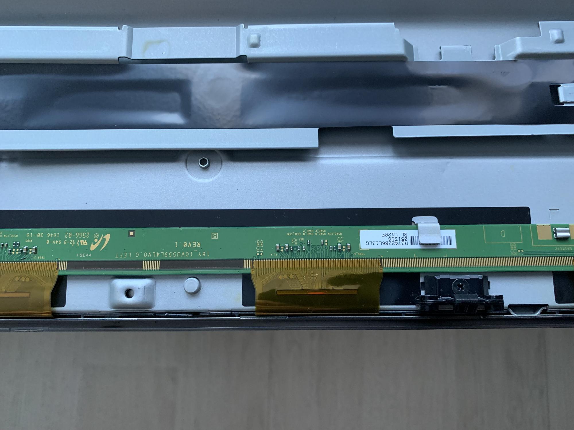

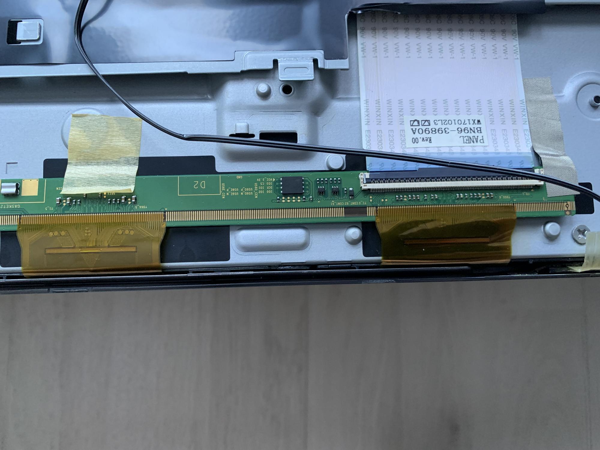

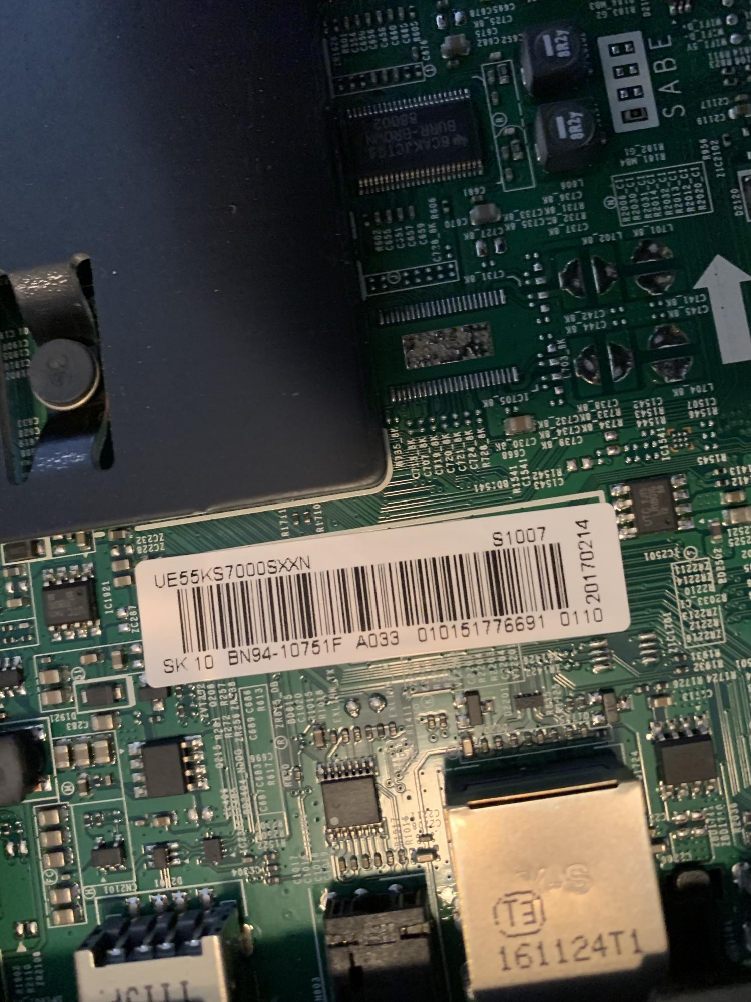

    I have a picture problem with this tv.
    This panel is not with the famous resistors and diodes which go bad.
    Does anyone have experience with such a panel?
    i will attach photos.
    Thnx

    Picture 1, the bars are not complete , there is a little part on the upper side without the bars, this looks to me like a faulty panel. Also the backlight in the lower part is to bright as if the Light Guide Plate is damaged/burnt.

      Oke thanx for the info. There is no repair for this issue.
