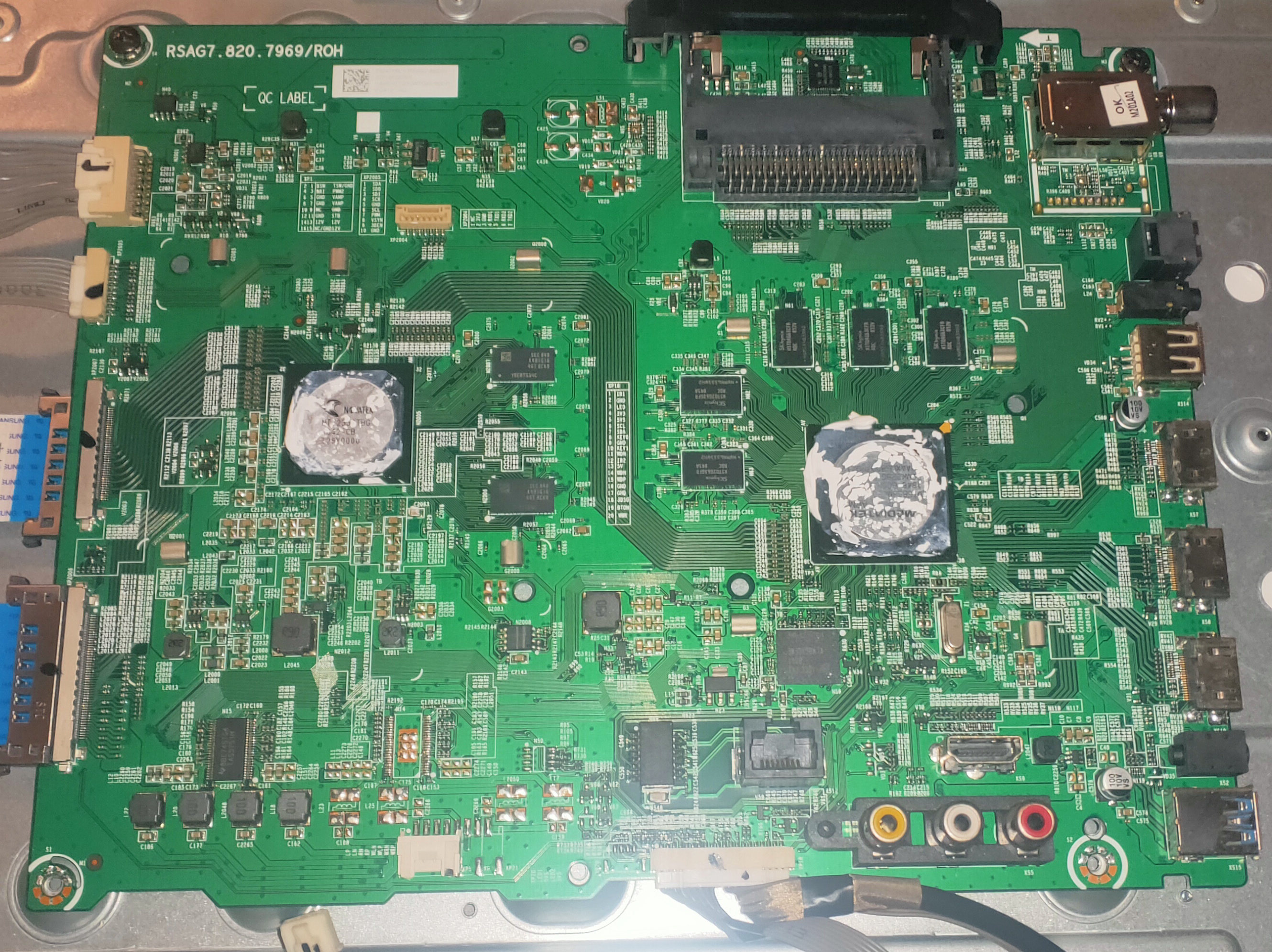

    Hi there,

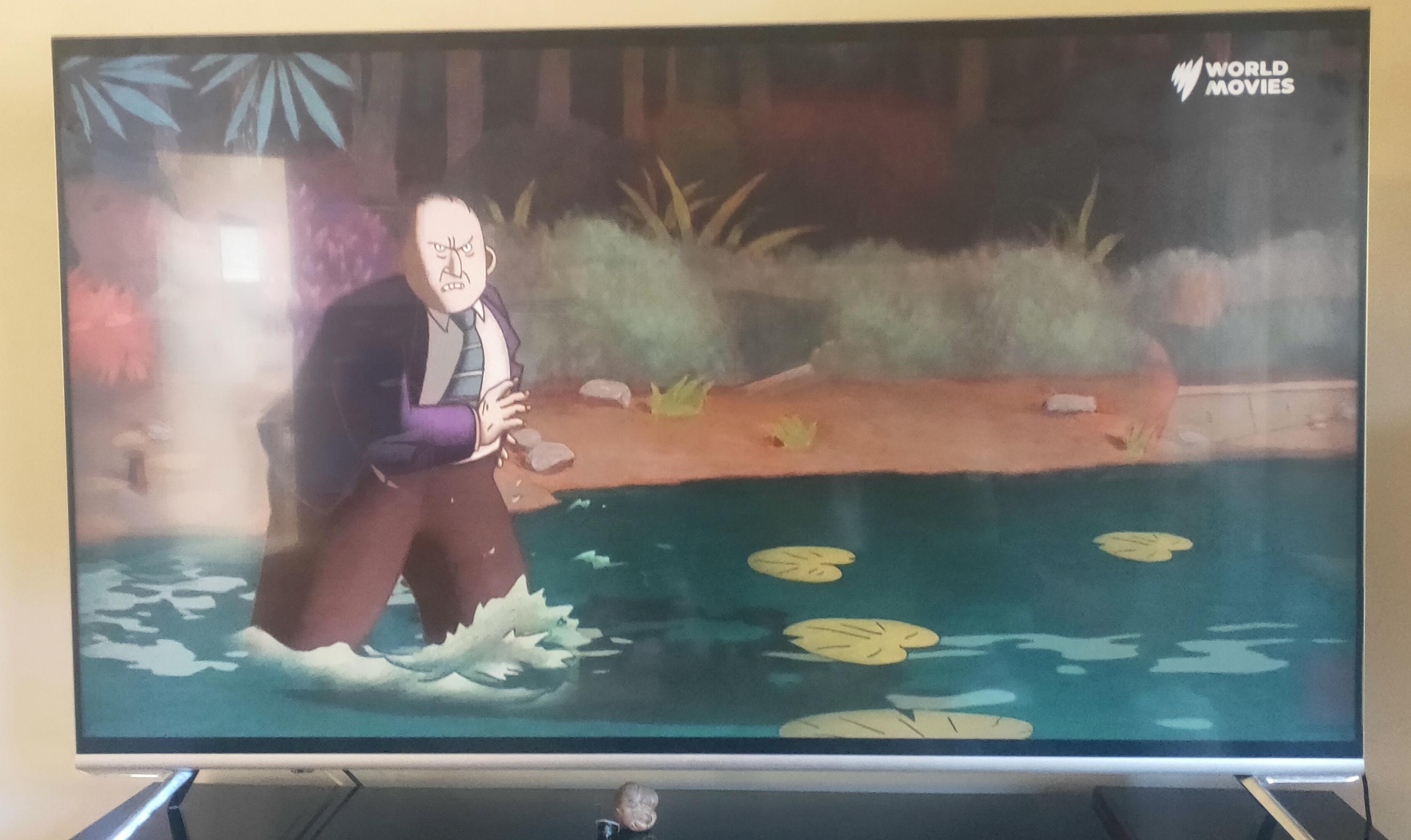

    I've got a Hisense 65P8 and it's stopped displaying a picture 6 months out of warranty.
    Pictures attached
    I've written out the codes on the stickers as they aren't very legible being so faint.

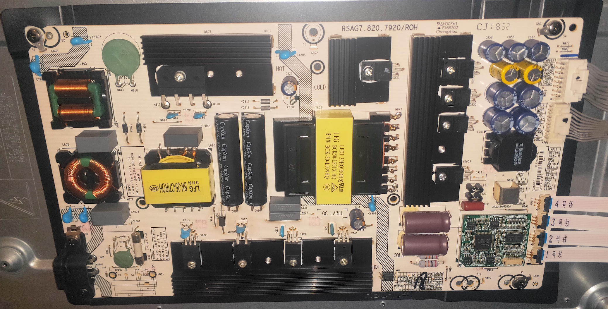

    Power board: RASG7.820.7920 - HLL5066WJ
    Main board: RSAG7.820.7969 - HA657700UWGT
    T-con board - 55T36-C04 - TT-5565T50C17
    I've been doing a lot of research and diagnosis.

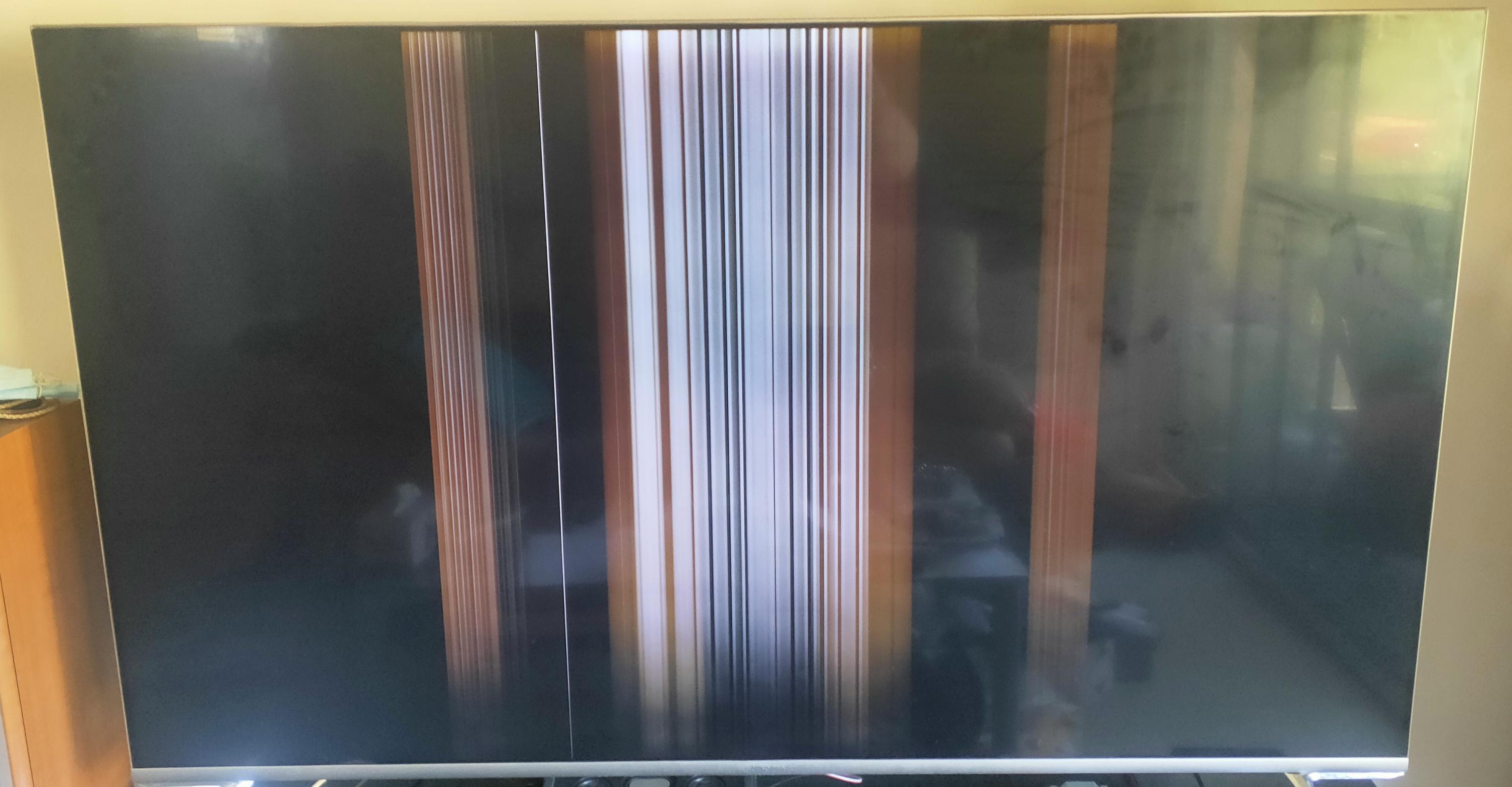

    Symptoms firstly:
    Unit was working one evening, then the image became a set of wide coloured stripes, [not the thin lines some experience, more like a single horizontal line of pixels was brushed up the screen from the bottom]
    So I waited a few minutes to see if if was a broadcast issue, tried displaying a menu - still coloured stripes.
    Powered it down, unplugged, switched back on and backlights illuminate but there's nothing displayed.
    The screen is essentially black [black as in the black of when it's on with the backlights on].
    I should add, I have tried the flashlight method to check if anything is displayed, it' blank.

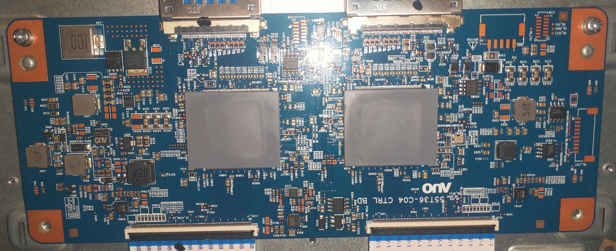

    So I've removed the heatsinks, as shown in the photos in preparation for reflowing the Novatek NT72334TBG graphics chip.
    Is there anything else I can do to nail it down to the main board or t-con board before I do the reflow.
    I don't want to do it just for the sake of it before exhausting all other possibilities.

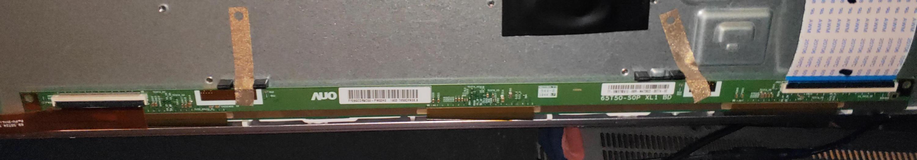

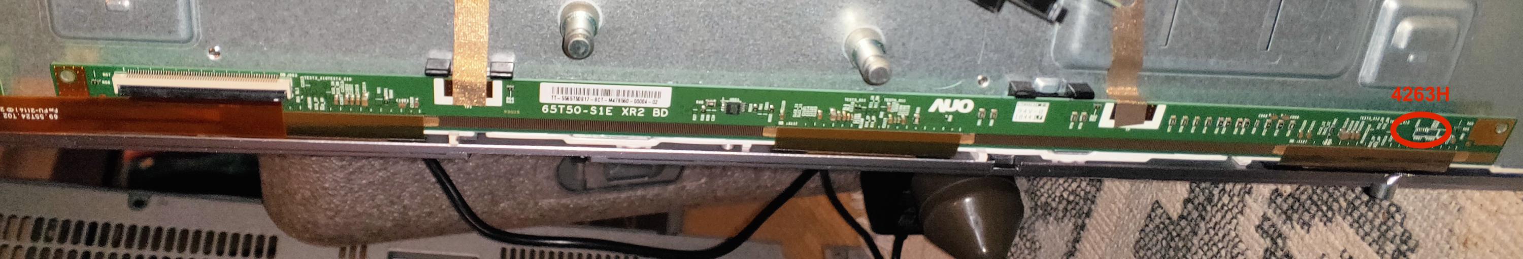

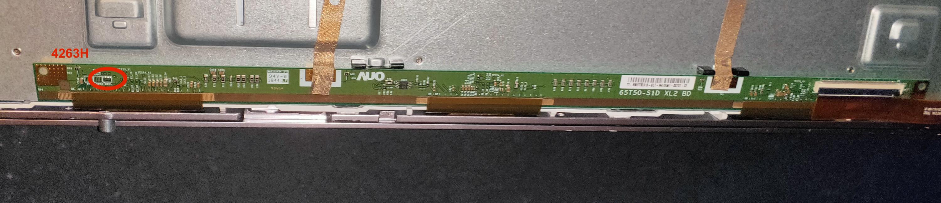

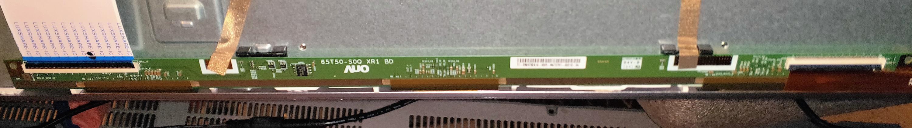

                    Here are the 4 buffer board photos, visual inspection doesn't show any blown components.
                    I have circled the 4263H TVS diodes on both of the outer boards.
                    I will go through and check for any shorted capacitors or open circuit resistors

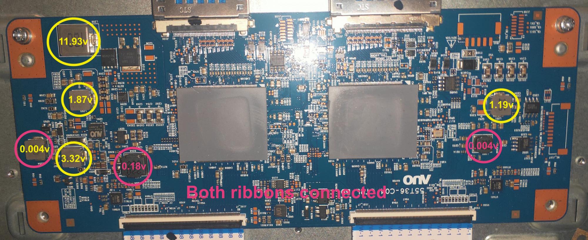

                            I've just run two further tests on the t-con:
                            One in both standalone mode and with the LVDS cables connected with the t-con to buffer ribbons cables connected alternately; and
                            One with the above with both t-con to buffer ribbon cables disconnected.
                            I was checking voltages at the inductors.

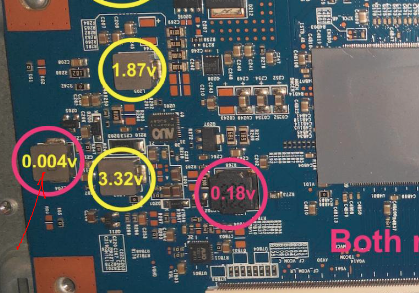

                            First test previously was with all cables connected and I got some strange voltage readings on some of the inductors, noted on the image.
                            Then the same check of the voltages with no ribbon cables connected between the t-con and the buffers.
                            I did actually do this with one side and then the other and then with no cables connected to the buffers, no difference between them.
                            Note the voltage differences on two of the inductors.
                            I will check across the buffer boards tomorrow for shorted components, something is not right with them.

                            • lotas
                              • Jan 2016
                              • 4609
                              • Russia
                              Re: Hisense 65P8
                              This indicates that the panel or strips are in short or low resistance, current protection is triggered and these voltages are blocked.

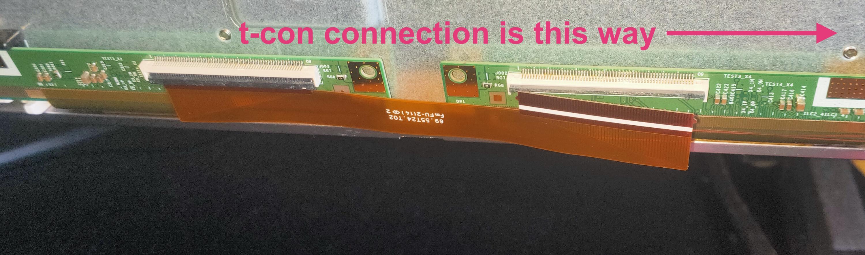

                                    Now I can see what you mean by the U ribbon, your description was clear, my vision and thinking was not, it was very late last night.
                                    The U ribbon is this connection between the buffer boards.

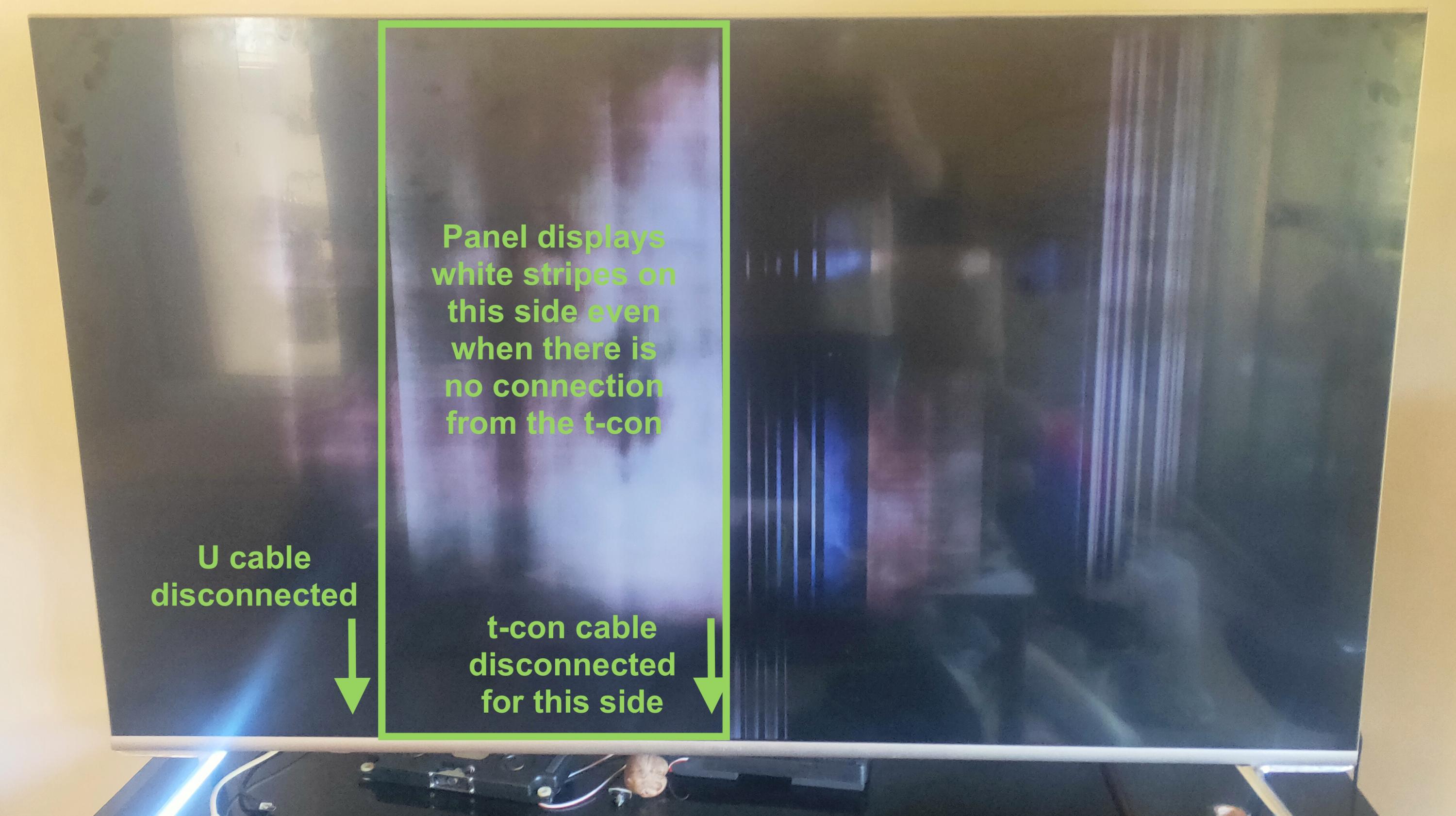

                                    I will test with the two U ribbons disconnected, the t-con LVDS cables connected and the t-con to buffer cables connected obviously.
                                    Now I fully understand that test.

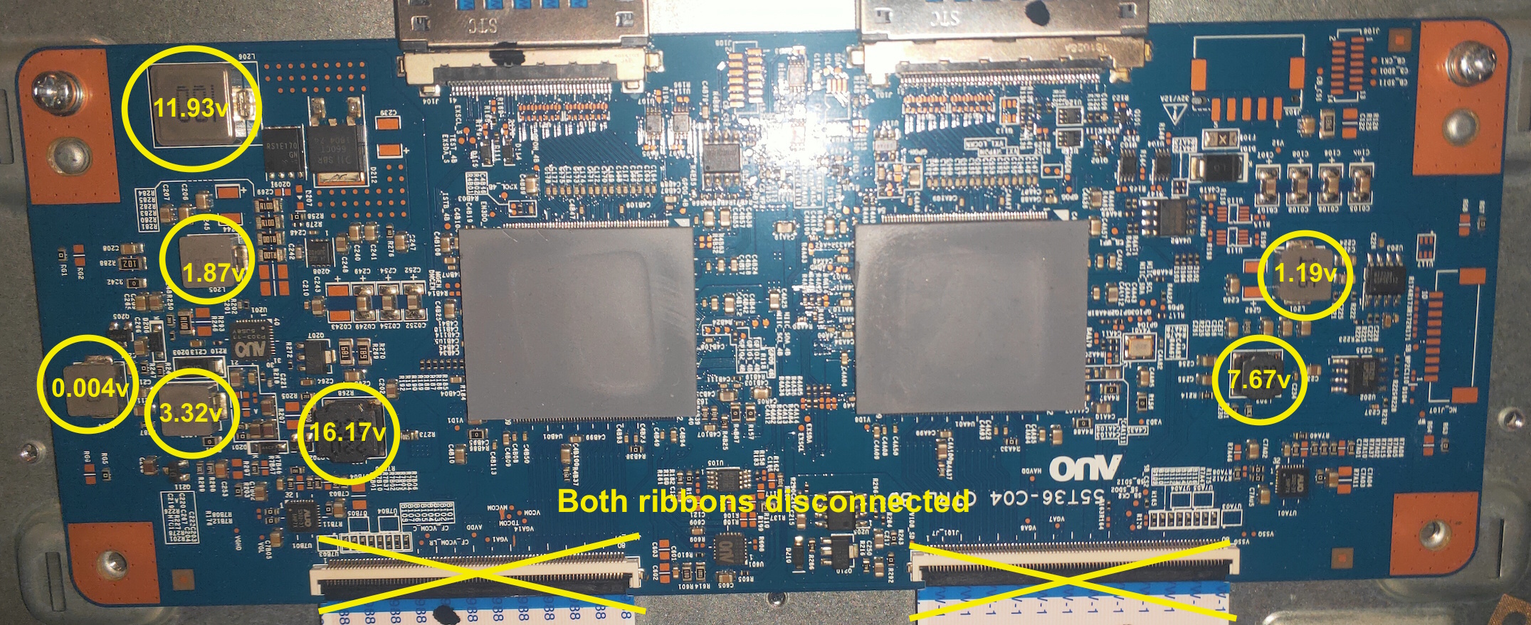

                                    Some sort of success, I have done the u ribbon disconnected test and now have the centre portion of the screen showing a striped image, whereas it was only dark previously.
                                    T-con voltage tests:
                                    Also I did that extra test of the voltages at the inductors on the t-con board with no panel connections to compare with my first set of measurements which showed three abnormally low voltages on three inductors.
                                    I have two voltages that were previously pulled low that without the t-con to buffer cables connected are now normal.
                                    There is however one remaining voltage on the t-con which is still low with no connections, and only 12v volts applied directly to the t-con [standalone], which is essentially 0v at L204.
                                    I haven't managed to locate the schematic for t-con 55T36-C04, that would make it easier to check.
                                    At least now I will have a target of either short circuit or very low resistance components [capacitors] to search for on the buffer boards and the t-con.
                                    • lotas
                                      • Jan 2016
                                      • 4609
                                      • Russia
                                      Re: Hisense 65P8
                                      There should be no voltage on L204, it stands on Gnd, this is to form a negative voltage (- XXv).
                                      • ruckusman
                                        • Jan 2009
                                        • 26
                                        Re: Hisense 65P8
                                        Thanks for this tip, it saved me removing the t-con board again unnecessarily and spending time checking components when no problem existed.

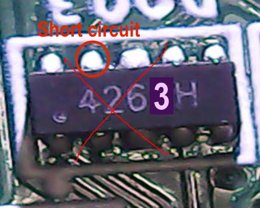

                                        SUCCESS
                                        I have a working TV again.
                                        The solution was the removal of D001 from BOTH outer buffer boards, please keep that in mind to understand the tests I conducted which follow.
                                        Firstly checking the 4263H ESD diode on the outer buffer board revealed a short circuit on the pin labelled in the photo.
                                        Note: This was the same for both components on each side.
                                        I've also checked them once removed and that pin is still short to ground.
                                        What may prove helpful for others is the sequential testing I conducted as follows:
                                        I removed one 4263H diode first, then connected three quarters of the screen to test.
                                        I had checked all of the other components on that first buffer board, before reconnecting the 3rd buffer board and obtaining the lines up the screen for the three quarters of the panel with the 4th buffer board u-cable disconnected.
                                        Connecting the 4th buffer board whilst only one 4263H ESD diode was removed from the first buffer board did not display anything on the screen which was my original symptom.
                                        So with that test conducted I moved to the other end and directly to checking then removing the other 4263H ESD diode.
                                        Then connecting the 4th buffer displayed the correct image, the unit is fixed.
