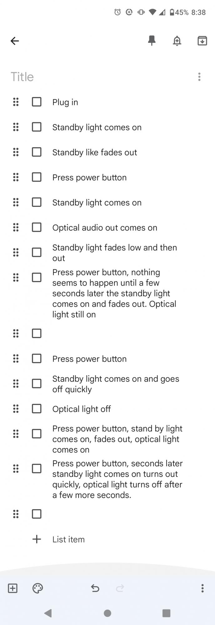

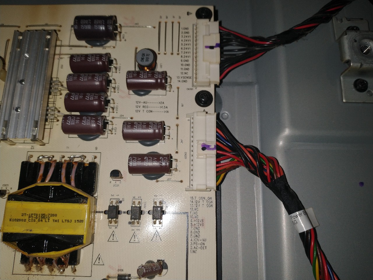

    Hi all, I have an M70-C3 Vizio that won't power on. I do get power/standby LED and optical output operation. I don't seem to have backlighting or display image, or sound.
    I have negligible voltage (0.001-0.003V) at T CON_ON and both 12V T CON pins.
    I have 12V on both +12VS pins.
    I have 33.xxV on 24V1 pins.

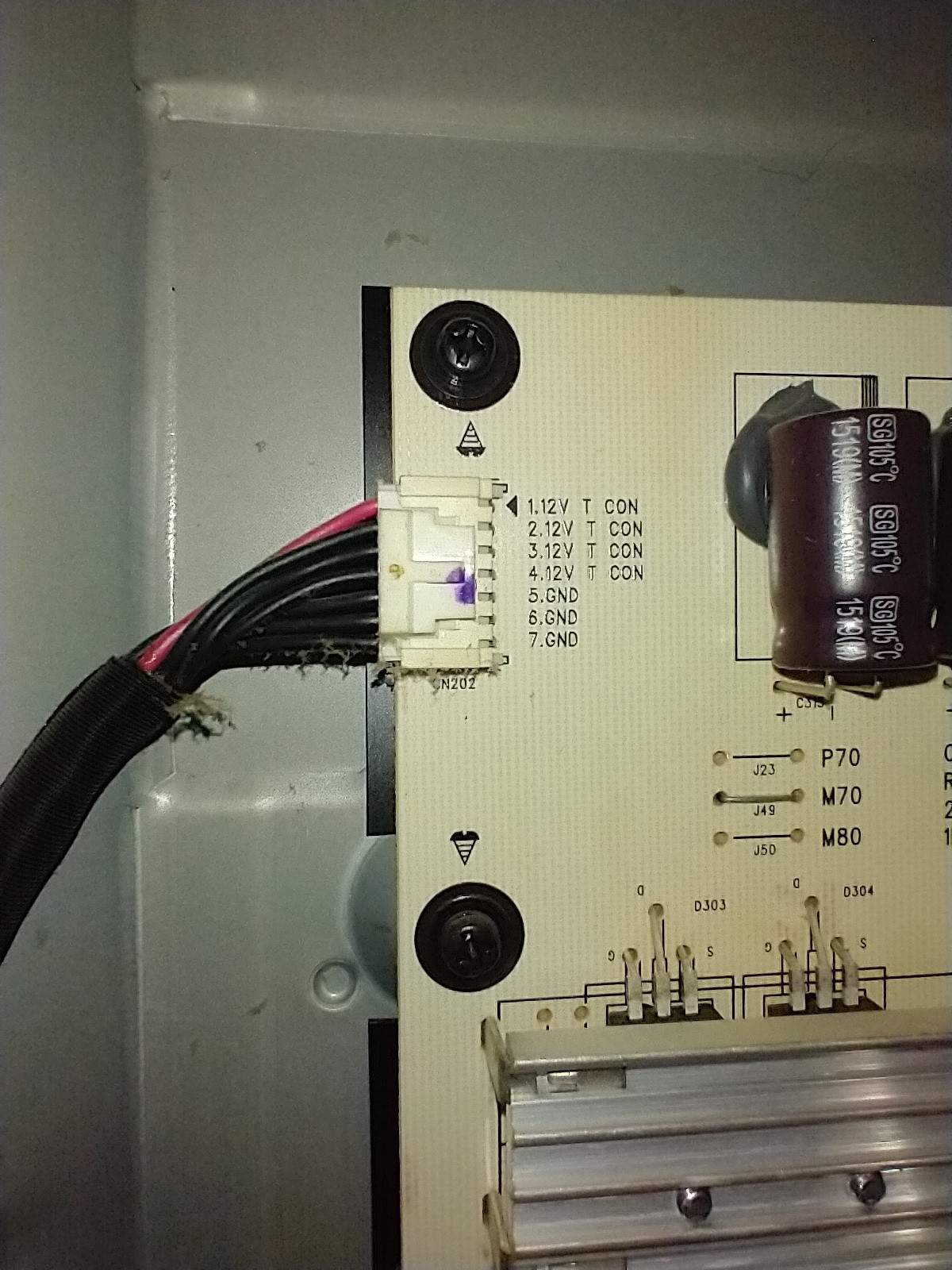

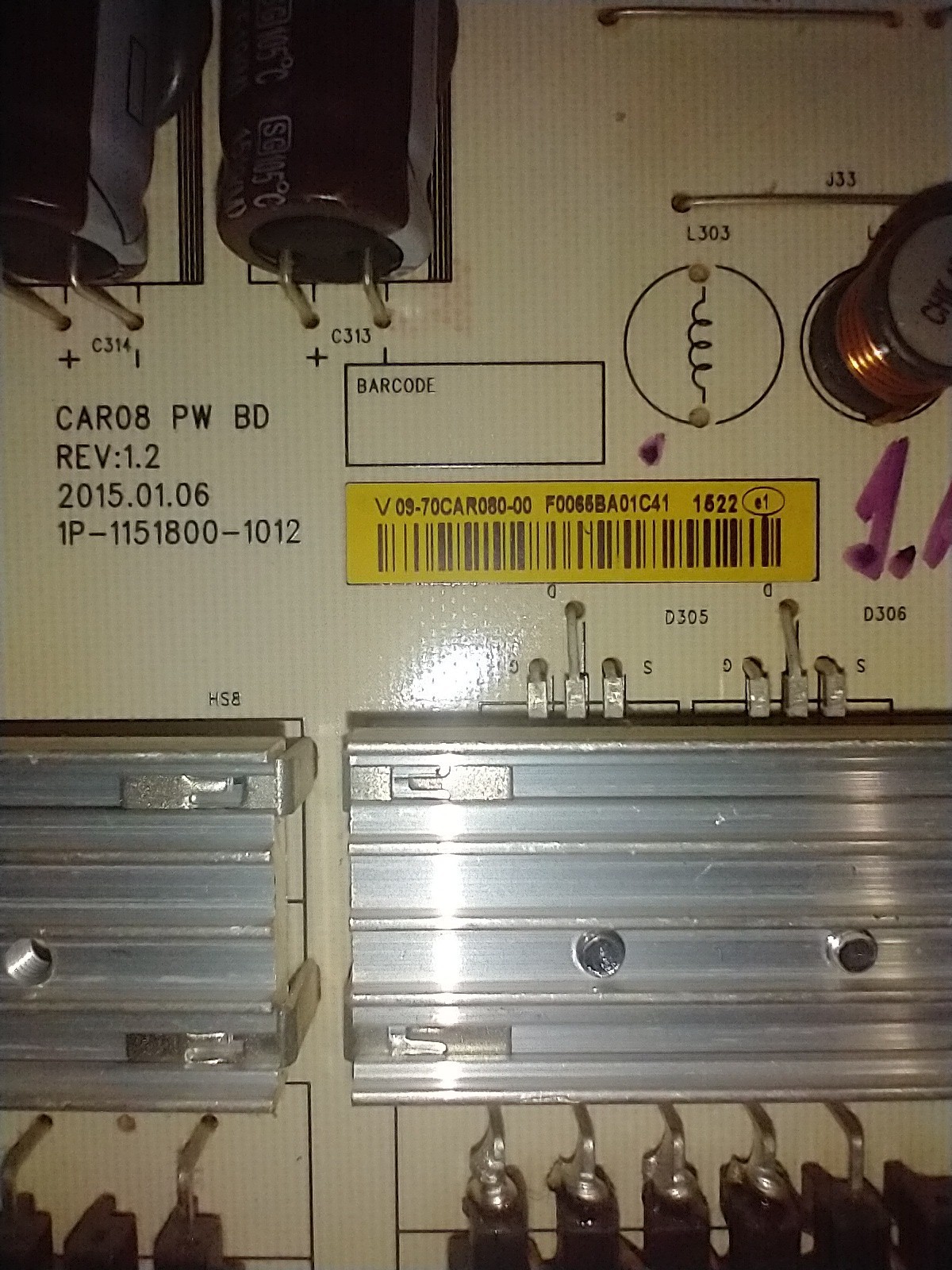

    Re: Vizio M70-C3 diagnosis
    Picture isn't clear enough to read the legend beside the connectors.
    • objext
      • Apr 2023
      • 16

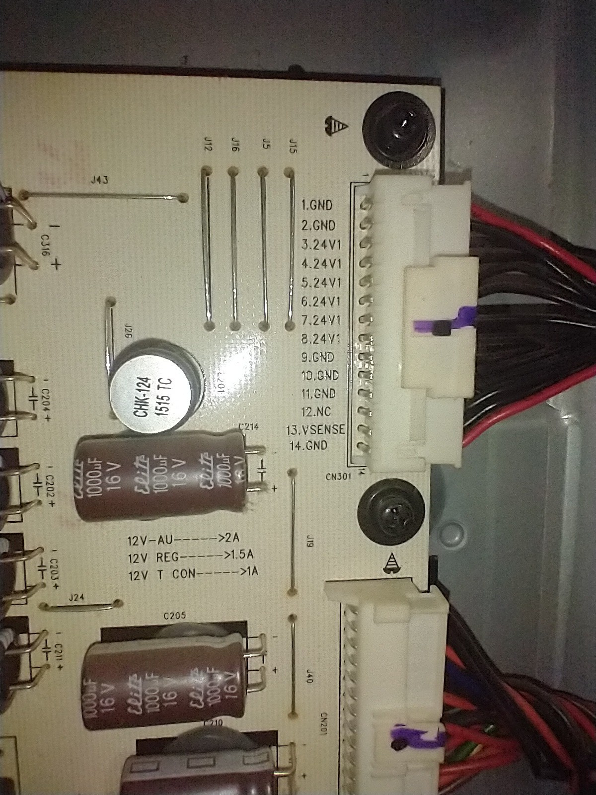

      How about these

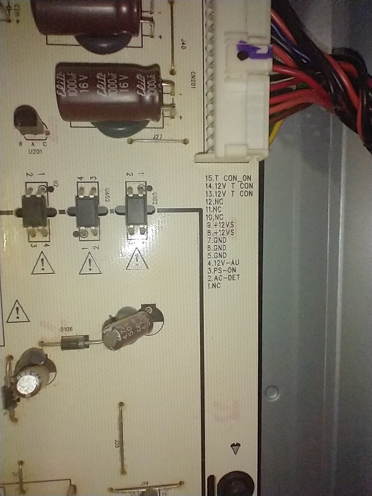

                        Also nothing on this tcon connector. I do get PS-ON signal, etc. Power supply seems to be working (?). Have tried pressing on main board heatsink, but no change.

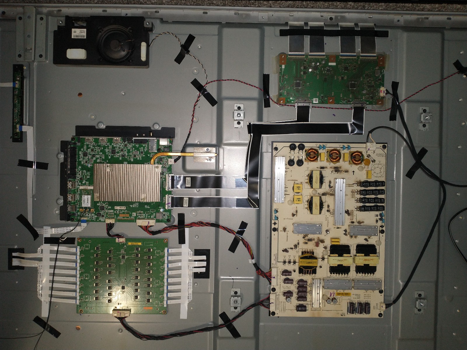

                          Can you post a picture of the whole back, as to see how everything is connected and a good clear one of the mainboard, also give it a good smell test, see if you can detect any faint burnt smells or see any small burnt traces etc.
                            No smell of burning
                              Unhook cable from powerboard to mainboard, check voltage at each pin of CN201, report readings, if anyone has any ideas on what to test or whatever, lets hear it, appears to be a tough one.
                              • objext
                                • Apr 2023
                                • 16
                                0
                                4
                                0
                                0.43
                                0
                                0
                                0
                                12.7
                                12.7
                                0
                                0
                                0
                                0
                                0
                                0
                                This doesn't surprise me because it can't be powered on without the main board.

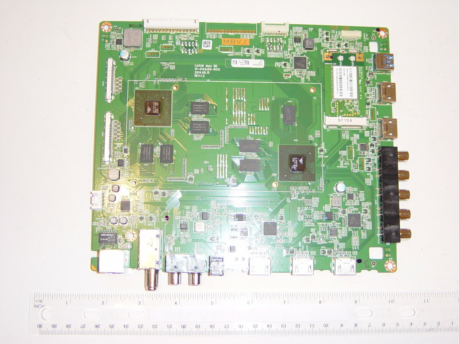

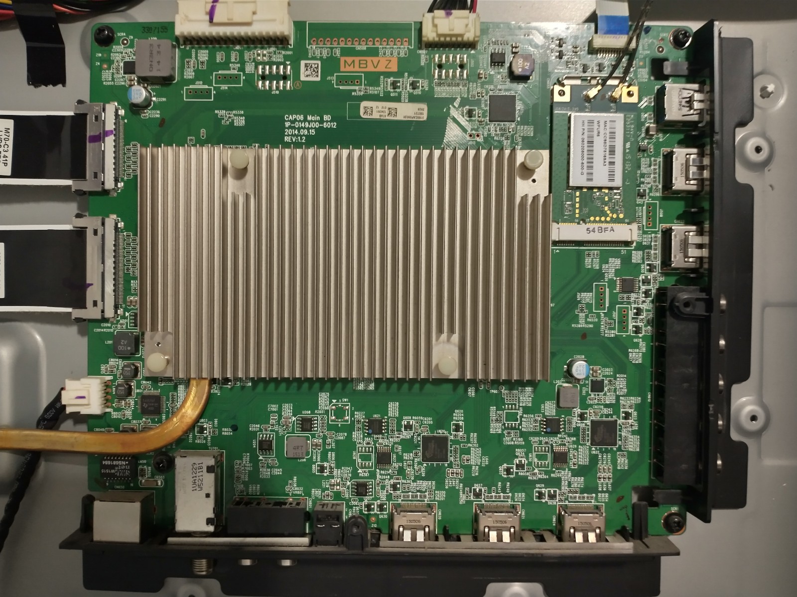

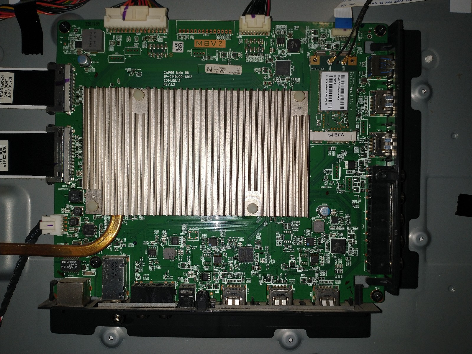

                                  Probably the classical ~2015 Vizio BGA solder failure. While this main board has a better heatsink with a heat transfer pipe to the rear chassis, the symptoms sound quite classic to these common Vizio BGA solder ball failures. Although other Vizios with the BGA failure often exhibit blinking standby LED lights thats not present here.
                                  Here is the pic of M70-C3 main with heat sink removed (copied from ebay)
                                  Here is a post with likely same Vizio BGAs with heat sink removed (memory layout orientation slightly different but probably the same BGAs). OP in this thread did the typical heat reflow and got the TV to boot with display in post #11.
                                  https://www.badcaps.net/forum/showpo...72&postcount=3
                                  Here is badcap search result for "m43. Probably all with this typical Vizio BGA solder failure problem. Lots of ~2015 era Vizios used these BGAs and have solder failure problems. Likely from using older (cheaper) hotter chip fab while pushing it with more smart TV functions (makes it hotter) Combined with the problematic lead-free BGA solder balls results in balls cracking over time and failing. AMD/nVidia GPUs first encountered this in the late 2000s.
                                  https://www.badcaps.net/forum/search...rchid=33613311
                                  You can try to heat the heatsink with hairdryer for awhile and see if TV boots.
                                  I believe the only long lasting fix is using a proper BGA reflow station : Remove chip, reball (typically leaded balls), resolder. Short cuts like heat gun, hot air station, oven bake will not last very long
