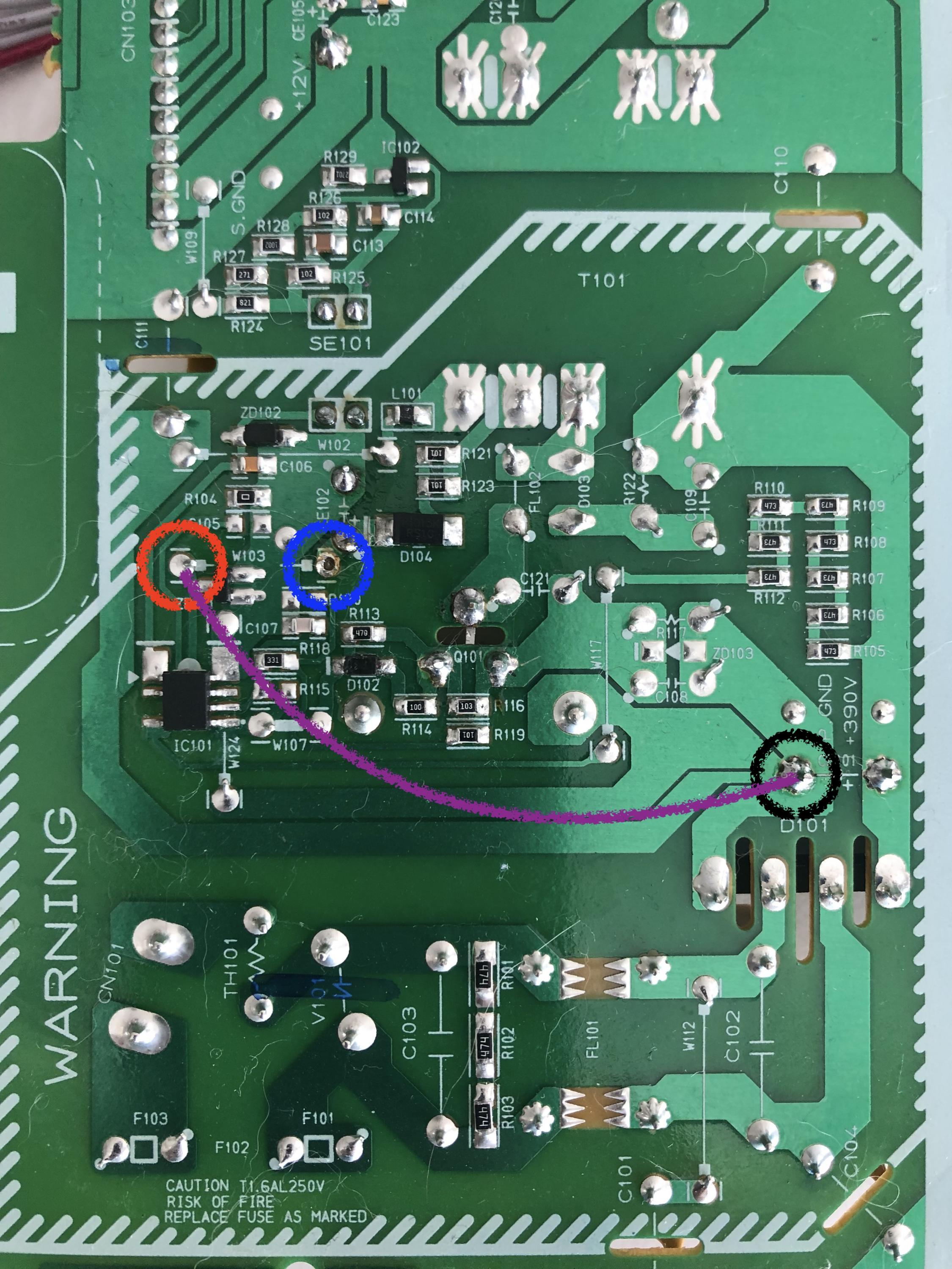

        Originally posted by R_J
        What is the number on IC101 and what is the dc voltage across CE102?
        Even with a high quality zoom, I can't seem to make out any numbers. I did find a service manual for the UBK80 which has a similar board layout when it comes to IC101, even though it doesn't show a clear picture to make out any model info:
        https://www.manualslib.com/manual/24...ected=1#manual
        With the multimeter on 20, the voltage across CE102 is 0.59. I think I did that right.

          You will likely need to clean the top of the ic with alcohol to read the number, Check that ZD101 is not shorted, I suspect the ic will have an internal startup cell to supply the initial vcc for the ic, but without the number it is just a guess. This vcc should be around +20v
                Cleaned with IPA, found my magnifying glass, and used my lamp - at just the correct angle, I was able to read the following:
                35111
                SK021
                226L
                Testing the following diodes using the diode setting on my multimeter:
                D102 54/54
                D104 554/0L
                ZD101 571/0L & 571/0L
                ZD102 706/0L

                  Upon further review, it looks like it's actually:
                  3S111
                  SK021
                  226L

                            Originally posted by momaka
                            K, sorry for the late reply.
                            I've been familiarizing myself with this site and the forums, you post a lot. I greatly appreciate any slice of time you provide this thread.
                            I find this reading worrisome.
                            In diode check mode, do you really get [0]54 (mV) and not 540 mV?
                            If yes, that diode might be bad. Remove out of circuit and re-check using diode mode.
                            With red probe on anode and black probe on cathode (side with white/gray stripe) --> around 500 to 700 mV Vdrop.
                            Now reverse the probes (black on anode and red on cathode/strip side) --> 0L
                            This last one is very important - if you don't get anything else but 0L, the diode could be bad... and most certainly is if this test is performed with the diode out of circuit.
                            Yes, confirmed, it's 054 in diode mode.
                            That is strange.
                            You should see a normal diode drop one way and 0L (open-circuit) or very high mV reading the other way - that is stable reading within a second or so. Electrolytic cap CE105 is sort of in parallel to this circuit, since the aux. winding on the transformer is pretty much a short-circuit at DC... thus, it would appear as if CE105 is in parallel with series network of D102 and R121/R123. So the changing values could be due to charging up and then discharging this capacitor through your multimeter.
                            Thus, it might be a good idea to remove D102 as mentioned above and test it out of circuit. Now, if you're getting a hard time trying to remove D102 due to it being an SMD component, you can remove jumper W103 (labeled "Vcc") and CE105. This will isolate D102 as if it was out of circuit. Then test and report back if you get proper diode drop in forward direction and 0L only in reverse direction.
                            I agree that it's strange, but this is the exact same reading that I get on the working board (you'll recall I mentioned I have to of these units - I inherited a working and non-working model).

                                  Unsoldered the right side of jumper W103 (blue circle).
                                  Checked diode D102 with a result of 057.0 Ohms & 0.087 V in selected diode test. Same reading.
                                  Checking resistance between the solder pad of W103 that connects to IC101 (red circle) and the big capacitor CE101 (black circle) I get 0L with no change regardless of the resistance setting - new mm has an auto mode, old mm I tried 200, 2k, 20k, ...

                                        OK, sorry for the delay. I had to track back a little to see what's going on... and maybe a good thing. Since D102 seems to still test consistently at 50-something Ohms even with the second multimeter, I'll just say to change it. Doesn't have to be an exact replacement diode. Probably any diode will do, even something like a general purpose 1N4148. To avoid having to purchase parts, you can look for one on another scrap PCB or electronic device if you have any. Or maybe borrow the same diode from the working PSU?
                                        If not, we could try the aux. voltage injection method next. But before you jump to that, it might be a good idea to build yourself one of these:
                                        https://www.badcaps.net/forum/showpo...4&postcount=70
                                        ^ i.e. a dim bulb tester
                                        Since the power supply in this DVD player also appears to have parts going to the main circuit board, I would say increase the incandescent bulb size to 60-100 Watts... which at this time might be hard to find, due to incandescent bulbs not being sold anymore (not in common hardware stores anyways.) But 40W appliance or specialty incandescent bulbs should still be available, along with 35W and 50W halogens. 2x 35W halogen bulbs or 2x 40W regular incandescent bulbs or 1x 50W halogen might be just enough for the power supply to try to turn on with the rest of the DVD player electronics connected... but if not, you can just try to power the power supply without connector CN103 being connected to anything. At that point, we will just be looking for a voltage on its output - i.e. between secondary side ground and 12VA pins on CN103.
