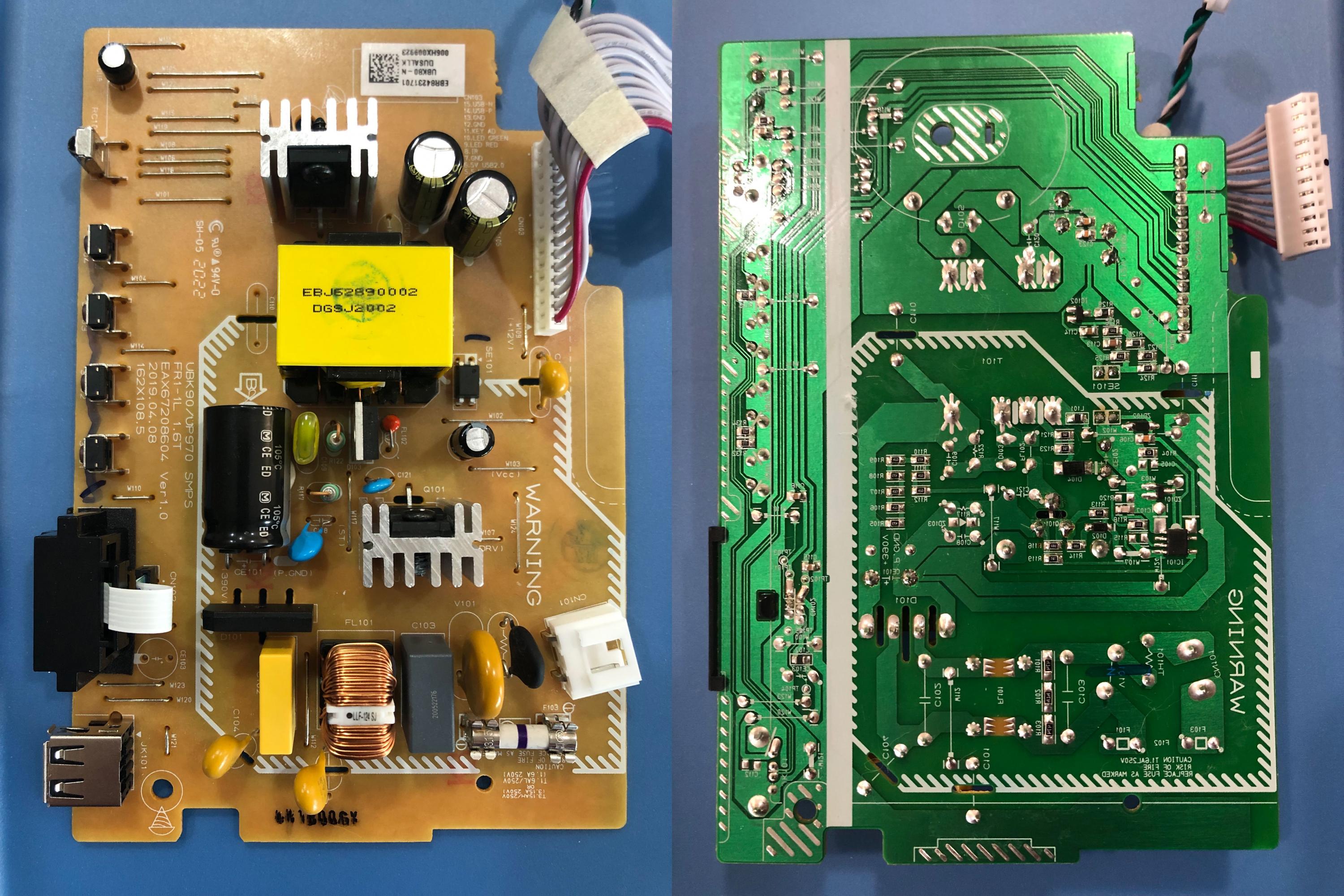

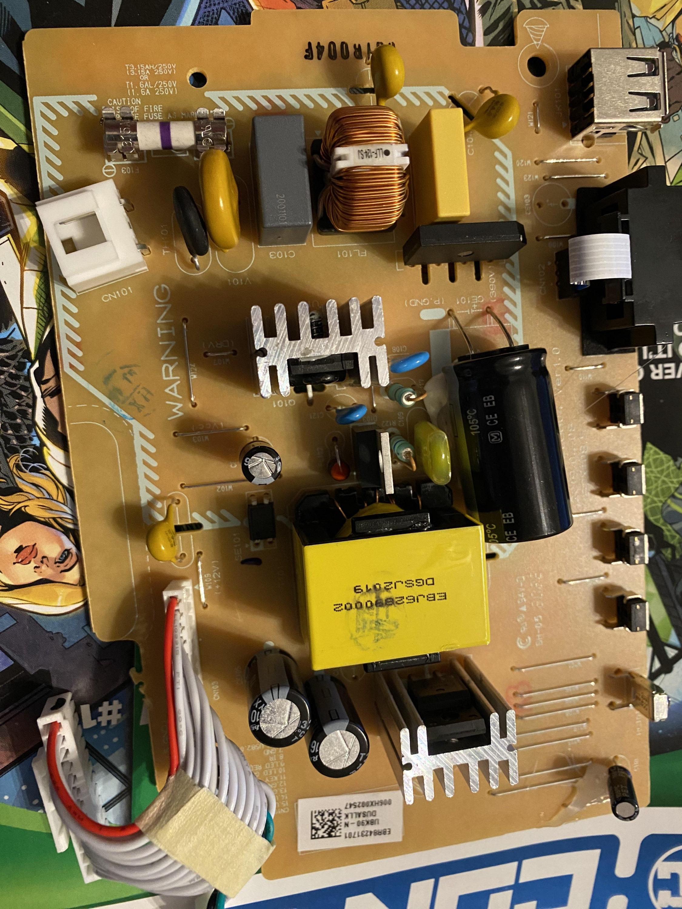

          Could you post a picture of the main board(s) and power supply of this player?
          LG and Samsung regularly use their own SamWha, Sam Young, and other not-so-great (but not completely terrible) electrolytic capacitors, which tend to work OK for a while and then fail after a number of years.
          Since you have no power, my suspicion would be the power supply. If the output electrolytic caps look OK, then the next suspect is usually the small "startup" electrolytic cap on the primary side (usually a 10-47 uF cap, rated for 25V, 50V, or 100V). When it goes bad, PSU cannot start up.
          Easiest way to check if it's a cap issue (so long as the caps are not too far gone) is to open the unit and use a hair dryer to heat up the boards inside. Start with the power supply board and heat it up until everything inside feels nice and warm (but not burning hot) to the touch. Then plug in the unit and see if it powers up. If it doesn't, it could be that the caps have gone a little past "marginal", or there could be an issue somewhere else.
          Either way, start with the hair drier and then let us know what happens. Then we continue from there. I don't suggest to "blindly" replace the MOSFET on the primary side (or any other parts) without verifying something actually is blown or bad. In the case of the MOSFET, for example, there is usually a low-resistance fusible resistor connected to its Source pin and primary-side ground (negative lead of the big electrolytic cap.) If the MOSFET goes bad, either that resistor will go open-circuit or the fuse would have blown. With your fuse being OK, I suspect the MOSFET in the PSU is still OK and the fault is somewhere else.

            all the caps look fine, the power supply board has a date of 2019-04-08 the only thing so far that hasnt tested right has been the mosfet, i currently dont have my esr meter with me so i cant test the caps

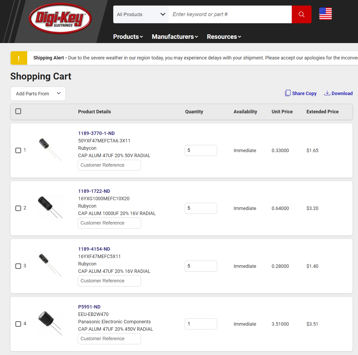

                  i plan to just replace all of them but i just cant find a replacement for the big one in 460v max i can find is 450v and even then the best i can do is nichicon and the others are rubycon
                    460V? Are you sure?
                    Should be a 450V cap. 460V is not a standard voltage rating.
                    There's no APFC circuit in this power supply, so you can use even 420V or 400V -rated primary cap without issues. (Actually, since you're in the USA and we have 120V AC line, you can get away even with just a 200V -rated cap... just don't bring this overseas somewhere with 220-240V AC. ).

                      i thought it was weird as well and i double checked and scrapped away the glue that was on it and it says 47uf 460v, i am also attaching a screenshot of what i have added to my digikey cart to replace the caps with
                      i did check for bad and cracked solder joints and they all look good, though when i replace the caps i will give them a once over with my iron just to be safe

                        LOL. Just curious, what brand and series is the capacitor? Maybe it's such an obscure brand that it has a printed typo.
                        Looks good to me.

                          i dont know the series but they are all chang or something like that and i will go ahead and get those ordered and get this thing fixed

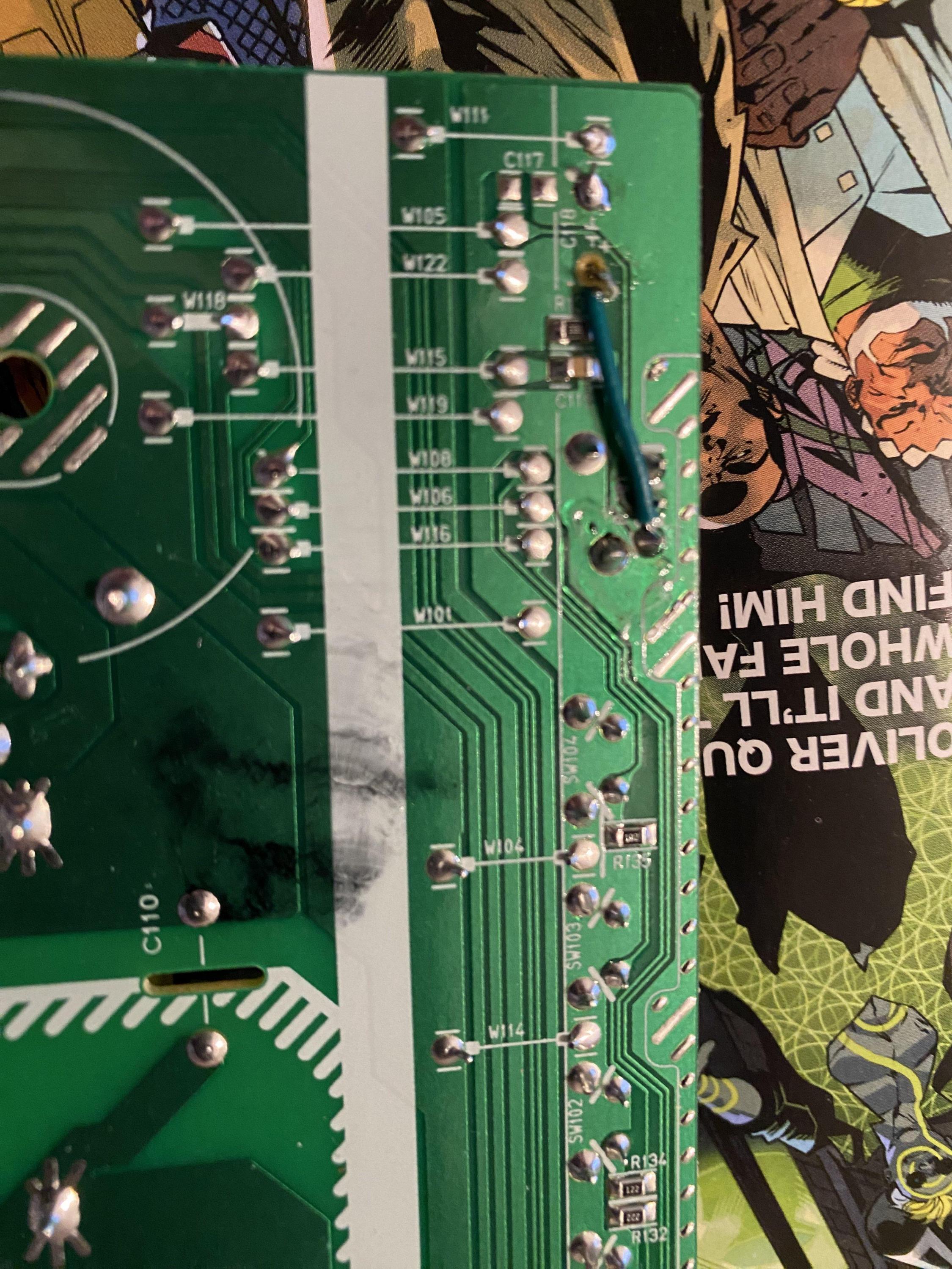

                            new caps arrived, took me about 10 or so minutes to replace them all, i did remove a pad by accident as you can see the green wire, but i managed to fix it and it tested fine and i added some hot glue to the cap on that side to keep it from moving
                            thanks for all of the help and advice and heres hoping this thing lasts a lot longer

                              Another way to do this is if there is enough of trace is left you can take the lead from the capacitor to the trace and make it look a little neater but if you have to go over another trace just use some insulation from a wire and put it on the capacitor lead once you have the capacitor mounted just be careful to not use too much heat soldering to the trace
                              I have done this many times in the past and very good results

                                I created an account to post that I have the exact same Blu-Ray player, with the same issue. It died around 12/2021. All the caps look fine.
                                For anyone that may stumble upon this, as I did, the capacitors are all Chang. They can be looked up at:
                                Although, as mentioned, the 47uF 460v cap isn't listed on the sheets (or anywhere for that matter).
                                In circuit, the optocoupler is giving strange readings, but I'm going to start with the adjacent 47uF 50v cap. I'll probably do as you did and replace all the caps.

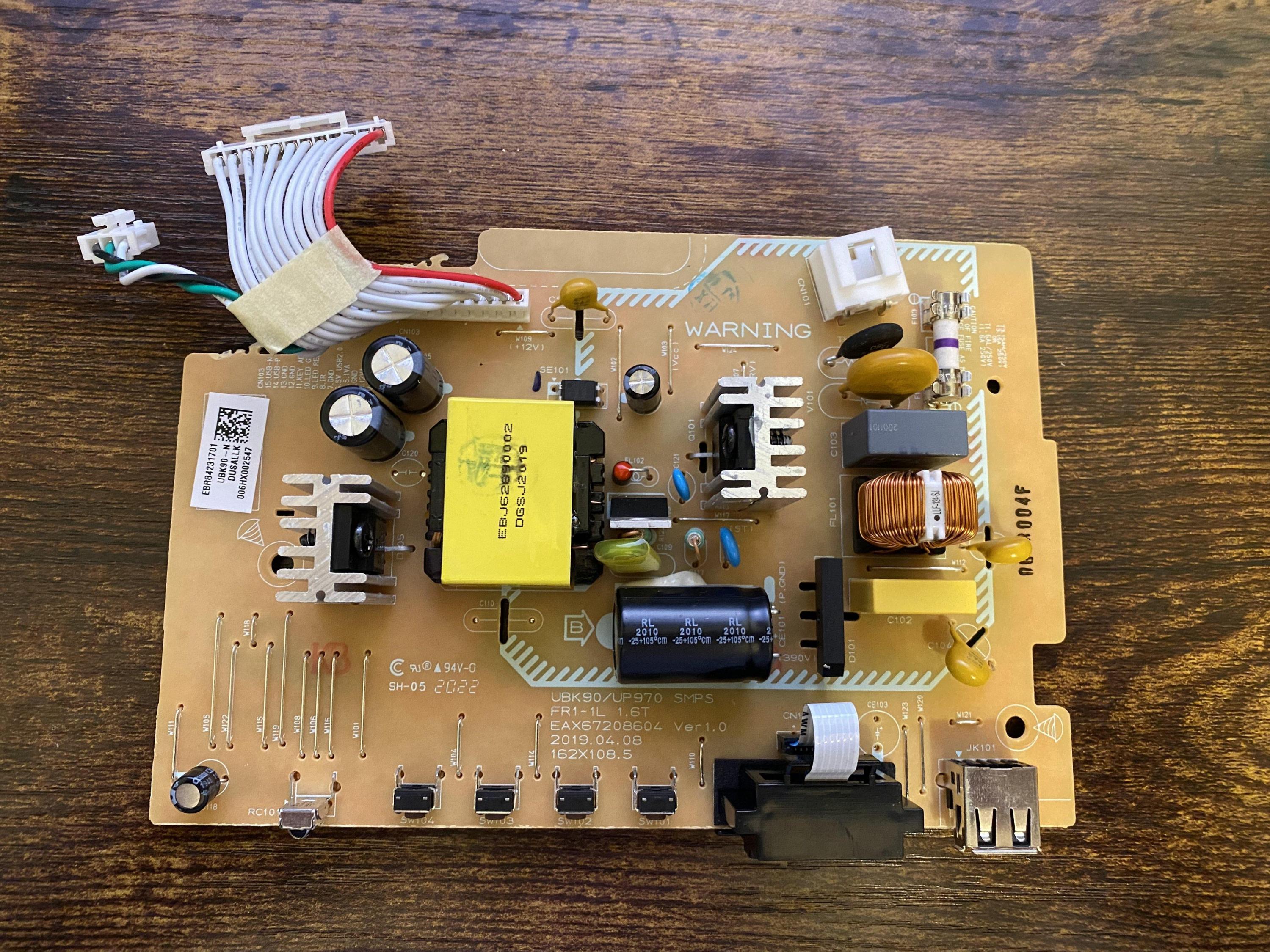

                                    I went with all Panasonic caps, and ordered:
                                    EEU-FR1H470B - 47uF, 50V, 6.3mm x 11.2mm
                                    EEU-FM1C102 - 1000uF, 16V, 10mm x 20mm - x2
                                    ECE-A1CKS470B - 47uF, 16V, 6.3mm x 5mm
                                    EEU-ED2G470 - 47uF, 400V, 16mm x 25mm - Same dimensions as the Chang "460"
                                    I also went ahead and ordered a board matching optocoupler and mosfet:
                                    LTV-817B
                                    STF8N80K5
                                    I started by replacing the caps (in the order listed above), testing after each one with power to determine which cap was at fault. After replacing all 5 caps the problem persisted. I tested each cap out of circuit and they all appear to be fine. I really need to just get an ESR meter.
                                    Next, I replaced the optocoupler and mosfet, testing with power after each component. Still no power through the board. I tested both original components out of circuit and they tested fine. Though, the mosfet wouldn't show continuity after switching gate to drain - but, neither did the new replacement, perhaps it's my cheap multimeter.
                                    So, at the end of the day, the board is still not working. Though, I did get more experience soldering, so that's nice.
