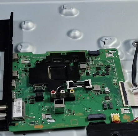

    Have just replaced main board BN94-15427Q with a new board from exact same model buth uses a different version and panel. Have copied the SPI data from the original board and got rewarded with a perfect picture.
    1 of the HDMIs is not being recognized by any type of input. Strangely enough the faulty board had same HDMI slot faulty. I have factory restarted from service mode, upgraded software but still same issue.
    Before I open the set again can anyone confirm here if the SPI flash may contain HDMI related data?
    Thanks!

      each Input Port assign with hex code at service menu... compare the ones which work with other didn't work and try if there are option to choice. or find same TV service menu and compare Option.
