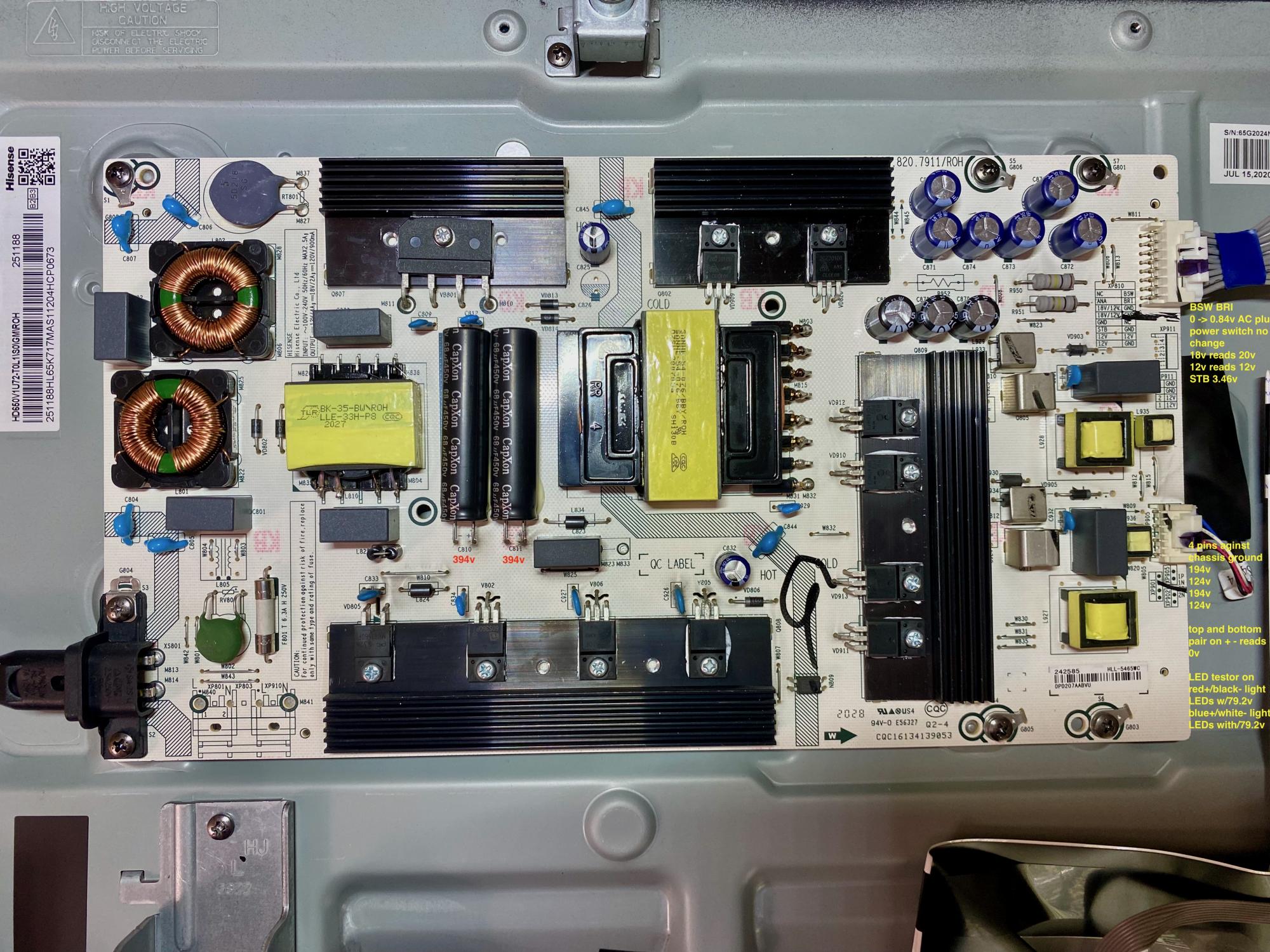

    TV standby light flash once after plug-in AC power. Then silent. No backlight, no LCD image on flash light test, no SPDIF light.
    All PSU voltages to main looks good (12v, 20v (label says 18v but is 20), standby voltage) Probing main board shows what appears to be a DCDC converter (MSH6103A can't find datasheet) providing 5v, 3.3v and 1v. 5v present to the standby light power switch board.

        • howardc64
          • Jun 2017
          • 648
          Re: HiSense 65H6510G no boot
          Originally posted by Diah
          yours photo remark voltage[/URL] i cant understand from it any point.. as its out of my poor English knowledge.. sorry
          4 pins on PSU LED connector. Presumably 2 serial circuits.
          blue
          white
          red
          black
          volt meter ground probe on chassis
          blue = 195v
          white = 124v
          red = 195v
          black = 124v
          meter + on blue, meter - on white = 0v
          meter + on red, meter - on black = 0v
          These voltage reading starts when plugging in AC cord and never change with pressing TV power button.
          LED tester + on blue and - on white light up LED and reads 79.2v
          LED tester + on red and - on black light up LED and reads 79.2v
          I only use shopjimmy reference to see # of LEDs. Of course it may not be exact to whats in the TV. To see whats in the TV require a lot more disassembly.

            disconnect the MB from socket XP810 and tested the voltage you have on it and on the LED BL socket with references to TV chassis
            • howardc64
              • Jun 2017
              • 648
              XP810 disconnected from main
              BSW BRI 0v
              18/12v = 20v
              all 12v = 9.4v
              BL Connector (volt meter - on chassis)
              Connected to backlight
              blue and red = 190v when plug in AC and continuously dropping
              white and black = 120v when plug in AC and continuously dropping
              Disconnected from backlight
              white and black = < 10v and continuously dropping
              • Diah
                • Feb 2013
                • 6446
                if you are sure MB disconnected and this is the value u have,,, then you have one Optokoppler between primary and secondary PWB defect

                  • howardc64
                    • Jun 2017
                    • 648
                    I only see 1 optocoupler on bottom of PSU (right of center). The diode side measures good (1325 in forward bias, 0 in reverse ) Don't know how to check emitter collector side in circuit.
                    Maybe try the powerboard as stand alone and see if you get steady voltages and backlights on.
                    PSU doesn't light up backlight with main disconnected. Anyway, there is clear evidence main is dead. Here is latest summary
                    I believe the boot sequence is as follows
                    - PSU generate 12v to main and 20v (not sure what this is for, maybe tcon or audio amp? I have seen LG tcon's PMIC generate 20v+ VGH from 12v)
                    - If main boots properly, it will turn on standby light and power on IR. If TV is requested to power on, main will tell PSU to turn on backlight along with supplying analog or PWM dimming signals. PSU on this board shows ANA signal at a minimum (I've seen ANA and PWM dimming on a 55 Samsung but not sure HiSense have both)
                    - BSW (Backlight Switch?) between PSU and main is likely the signal main uses to tell PSU to turn on backlight. Goes to about 0.8v when AC is plugged in. I jumped this line with 3.3v standby (generated by main's DCDC power tree) and saw backlight flash on briefly. I'm guessing probably need to supply proper ANA signal (maybe jump 3.3v also) to keep it staying on.
                    - Main's DCDC power rails use PSU's 12v to converts to all the necessary voltages to drive its components starting with the computing system (CPU=1v, DDR3=1.5v, eMMC=3.3v and 1.8v) just to be able to boot the computer. Other voltages like 5v exist for USB, IR, wifi, etc
                    -All of the main's computing system voltages are present checking around SOC/DDR3/eMMC. One of the 2 USB port has no 5V. Circuit trace (service manual has the circuit diagram) shows its enabled by the CPU so CPU didn't get that far.
                    - FLIR image of main shows one region of SOC and one side of eMMC warms up on plugging in AC. This likely shows everything is configured to start reading boot/system code from eMMC. The correct boot sequence on AC plug in would be to enable IR and turn on standby light at a minimum. But lacking standby light, 2nd USB port power, no SPDIF light etc... means SOC didn't get very far.
                    So main is dead and I suspect it is likely firmware. Main boards for this TV (3 years old) is out of stock everywhere @ $100. Many complaints of slow smarttv software and bricking from updating the TV. Anyhow, Hisense doesn't even provide USB recovery firmware without request. Not sure can get PC flashed tools and firmware.
                    So to summarize, main has the 12v source from PSU and DCDC generates all voltages for the SOC, DDR3, eMMC but no evidence its booting very far. Don't think I want to invest $100+ on a replacement main so will see if can gather enough SOC tools to see if can at least get a terminal prompt over the service port (3.5mm jack for serial UART signal)

                        • howardc64
                          • Jun 2017
                          • 648
                          UPDATE
                          The PSU does make a faint noise differently with main connected and disconnected. Furthermore, one periodic noise correlates with voltage drops.
                          Main Connected
                          - Every ~30s will hear a faint 1/2s squeal sound near the big transformer (haven't isolate it exactly where from) when this sound occurs, all DC voltages will drop momentarily. 195v will drop about 10v on digital volt meter. Even main side's 1v CPU supply voltage will drop a tiny amount (few 100th of a volt on the meter)
                          Main disconnected
                          - No periodic squeal but a faint clicking sound that speeds up after plugging in AC which seem to gradually become steady clicking frequency.
                          So I guess PSU could still be suspect as without a scope, can't see how clean the DC voltages are going to main.
