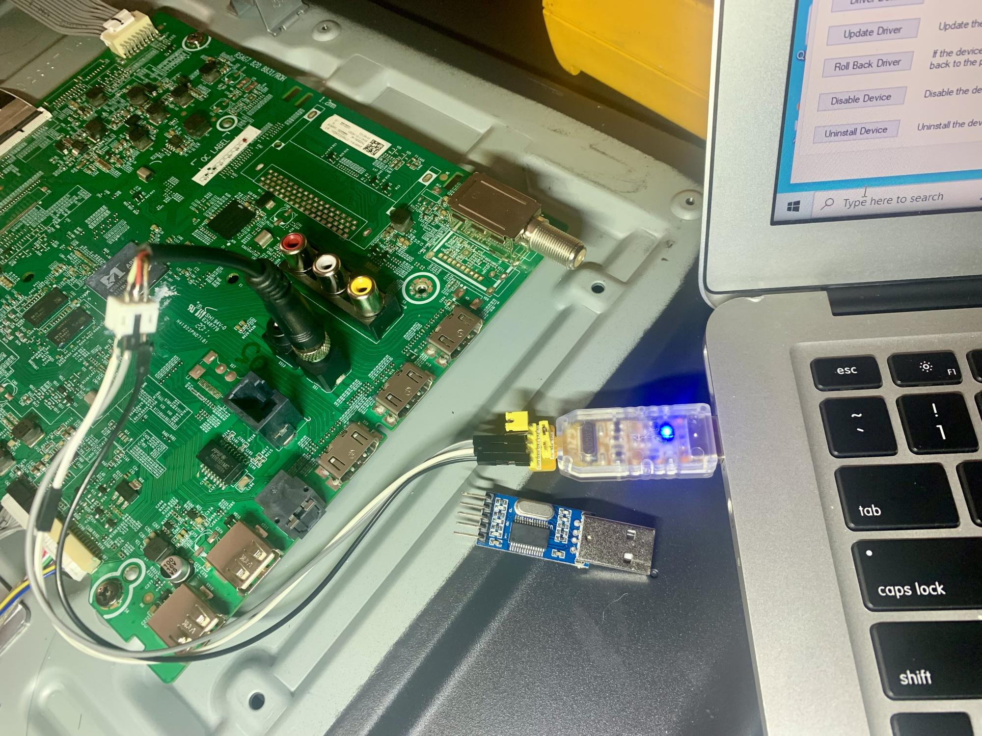

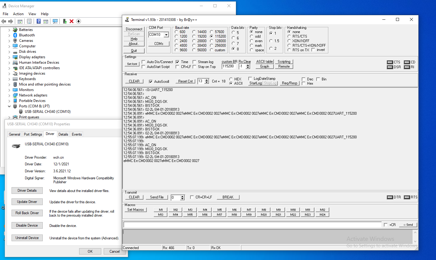

      USB<->TTL UART Dongle
      • Have 2 (old PL2303HXA, CH340G)
      • Both work with terminal apps to receive SOC CPU log.
      • mstv_tool not finding CH340G serial port. What driver do you use?
      • DMM confirmed dongle TX/RX continuity to SOC UART ESD and 3.3v pull up resistor. Both paths are good.
      • When PC transmits, dongle TX LED blink
      mstv_tool and SOC Communication
      • I guess maybe failed eMMC maybe doesn't give chance for communication.
      • boot to eMMC error is < 1s (see time stamped log output)
      • likely no mstv_tool and SOC CPU software rendezvous mechanism. eMMC error could be coded to not properly respond to UART RX interrupt in early boot phase. software would need to anticipate eMMC failure to properly respond to mstv_tool. Don't know for sure.
      • probably boot need to not have eMMC error, try to fetch UBoot unsuccessfully (software probably planned for this), flash standby LED lights and wait for mstv_tool.

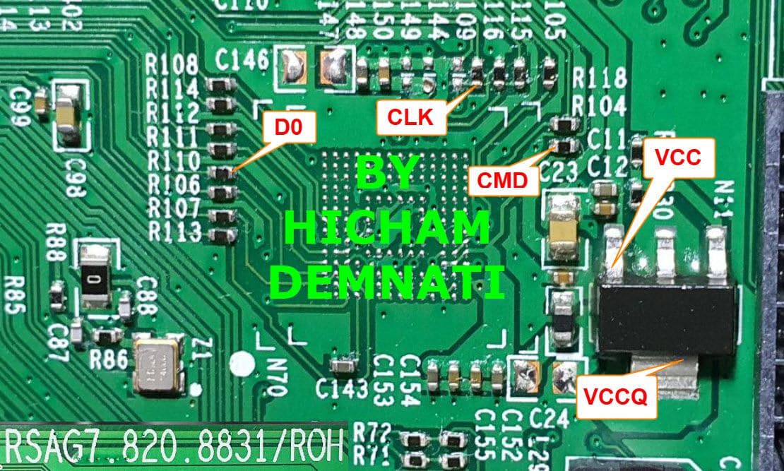

            Here is the emmc pinout if you want to read data from emmc via ISP through the programmer.
            The main thing is not to heat it up! (will die completely), but try to freeze.
                haha nice find. Thanks! I got the eMMC datasheet pinout also.
                I know can solder on cheap USB/eMMC reader, freeze and try to read. But latest eMMC itself contains multiple partitions and access security rights. I read 4pda post some people say its fantasy to achieve success... Do you know if actually possible?

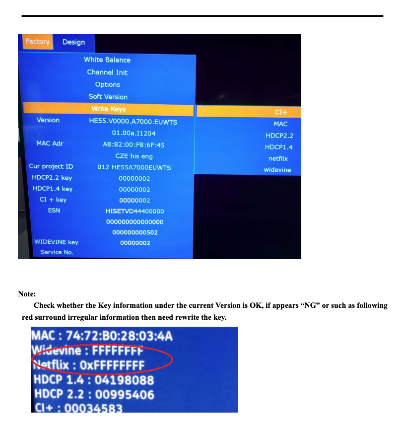

                                    Re: HiSense 65H6510G no boot
                                    Originally posted by howardc64 View Post
                                    HiSense eMMC replacement can not solve security keys
                                    This eMMC seller is the one I contacted asking about HiSense eMMC and he said will lose HDMI and many streaming apps.
                                    there are no security keys at all.... the keys which should written within service menu and USB stick in case eMMC replace or blank MB installed
                                    the keys are CI+ key in case on board there are CI+ socket
                                    write MAC linkage
                                    Write NETFLIX Key
                                    write WIDEVINE Key
                                    and HDCP 2.0 or 2.2

                                      Interesting. But install new eMMC + new firmware and can not read old dead eMMC. Then what keys put in service menu?
                                      Here is SOC's service manual section on keys
                                        #99
                                        all these except MAC are licenses for Brand & specific Soc. all TV same Brand share the same LIC. there are no separated LIC. KEY will Generated according TV Model ESN
                                        its the same to Android TV Box. Amlogic for example give each manufacture of brand LIC can be burned on all boxes.
                                          did you tried to have the MB solo and feed it 3.3V from yours TTL and see how the log will be
