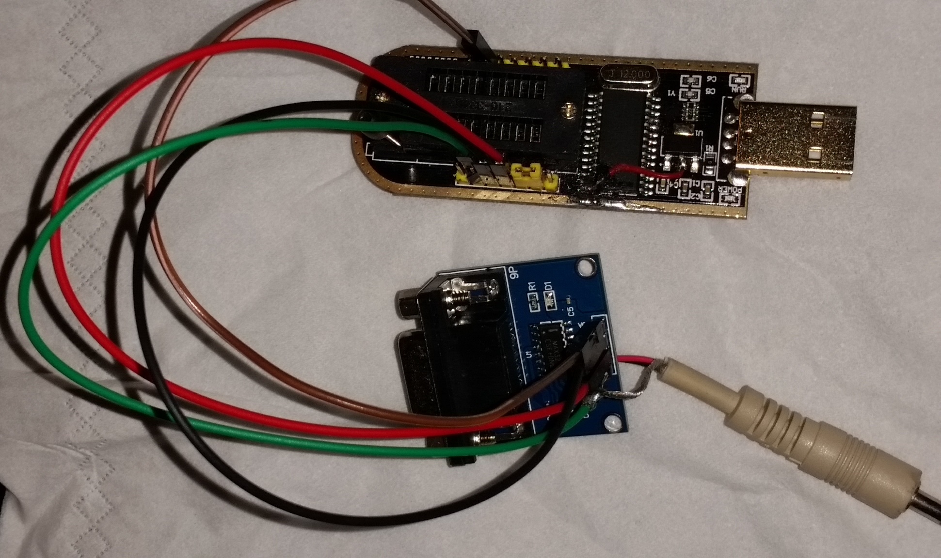

                          Connect MSTAR_TOOL
                          Running MSTAR_TOOL but no connection to the SOC.
                          • MSTAR document says UART is off by default and requiring turning on (TV menu setting) to use with debug tools. Does "off" mean only SOC can't receive UART? or both don't receive and transmit? SOC UART obviously transmitting output to my serial dongle in SBoot.
                          • Does anyone know if MSTAR_TOO app can be used with generic USB<->Serial dongle (Have CH340 and PL2303HXA (A=old version ~2012)) or have to purchase MSTAR USB Debug dongle? I set tool to UART 115200 protocol but seems to not connect.
                          • MSTAR USB Debug dongle usually comes with VGA adapter. For this TV with 3.5mm service port. I assume just connect debug dongle serial TTL GND/RX/TX to 3.5mm jack?

                                  Here is a new good MStar ISP utility with support for : eMMC, NAND, SPI.

                                      Thanks, tried the same versions in post #63. Unfortunately same unable to properly connect behavior
                                      • Need to click through the external exception COFB007E errors during launch (I assume exe just not finding DLLs for unnecessary debug hardware for older TVs)
                                      • Set to USB Serial COM port. Same 115200 baud, 8 bit, no parity, 1 stop as terminal programs.
                                      • Read Bank tries to read and give UART receive error
                                      • One time saw read bank gradually increase. But the increase was only from SOC printing log/error messages. So clearly, need to stop the SOC from printing as indicated by the MSTAR usage guidelines.
                                      Thanks! Was going to search for this utility next
                                      Says can't find HW on first launch (PL2303HXA<->3.5mm service port on COM9) and couldn't do anything in menu of course. All launches after first time just silently quit... Strange.
                                      mstv_tool
                                      • Maybe eMMC failure prevents this from working? Also if any server code has to be loaded on the SOC CPU from eMMC, then can't get that far with eMMC has failed.
                                      • Service manual says need to run mstv_tool to get device ID and email for a password to unlock flash eMMC capability. So if can't run this... probably the only solution remain is a eMMC chip programmer (RT809H with a 153FBGA socket)
                                      • mstv_tool has no get Device ID button.
                                      • mstv_tool procedure require stopping the UART in 1 of 3 ways (<<MSTAR>># du in MSTAR mode, 00112233 in Supernova mode, nothing if no UART activity) I guess mstv_tool, terminal, and SOC are just all sharing this serial port so they can not all use the port at same time. Tried entering 00112233 in terminal (even in a self repeating macro in case need to be specific timing on boot), no change, UART keeps on bootloop on eMMC error.
                                      • Tested TX pin from USB serial dongle all the way to the bottom metal connection finger of the 3.5mm socket for continuity to ensure able to transmit to the SOC CPU.
                                      i2c utility
                                      • This probably require the special mstv usb debug tool?
                                      My main motivation is to find cost effective solution for average DIYers. Purchasing more repair tools and replacing eMMC is probably beyond many DIYers. Will investigate if 2021 HiSense 65" TV main board can be easily compatible.

                                          Originally posted by howardc64 View Post
                                          [*]Set to USB Serial COM port. Same 115200 baud, 8 bit, no parity, 1 stop as terminal programs.[*]Read Bank tries to read and give UART receive error
                                          baud 115200 are the interface of the PC to have correct log letters. Soc during boot send / read at different baud to communicate with external and internal.
                                          i use CH341A at serial configuration 3.3V level to the pc with same yours baud. i connect it to serial adapter az same 3.3V level and then go to target UART.
                                          any time the Soc changed baud the serial adapter will deal with it and changed as Soc wish , with out effect on CH341A baud connection.
