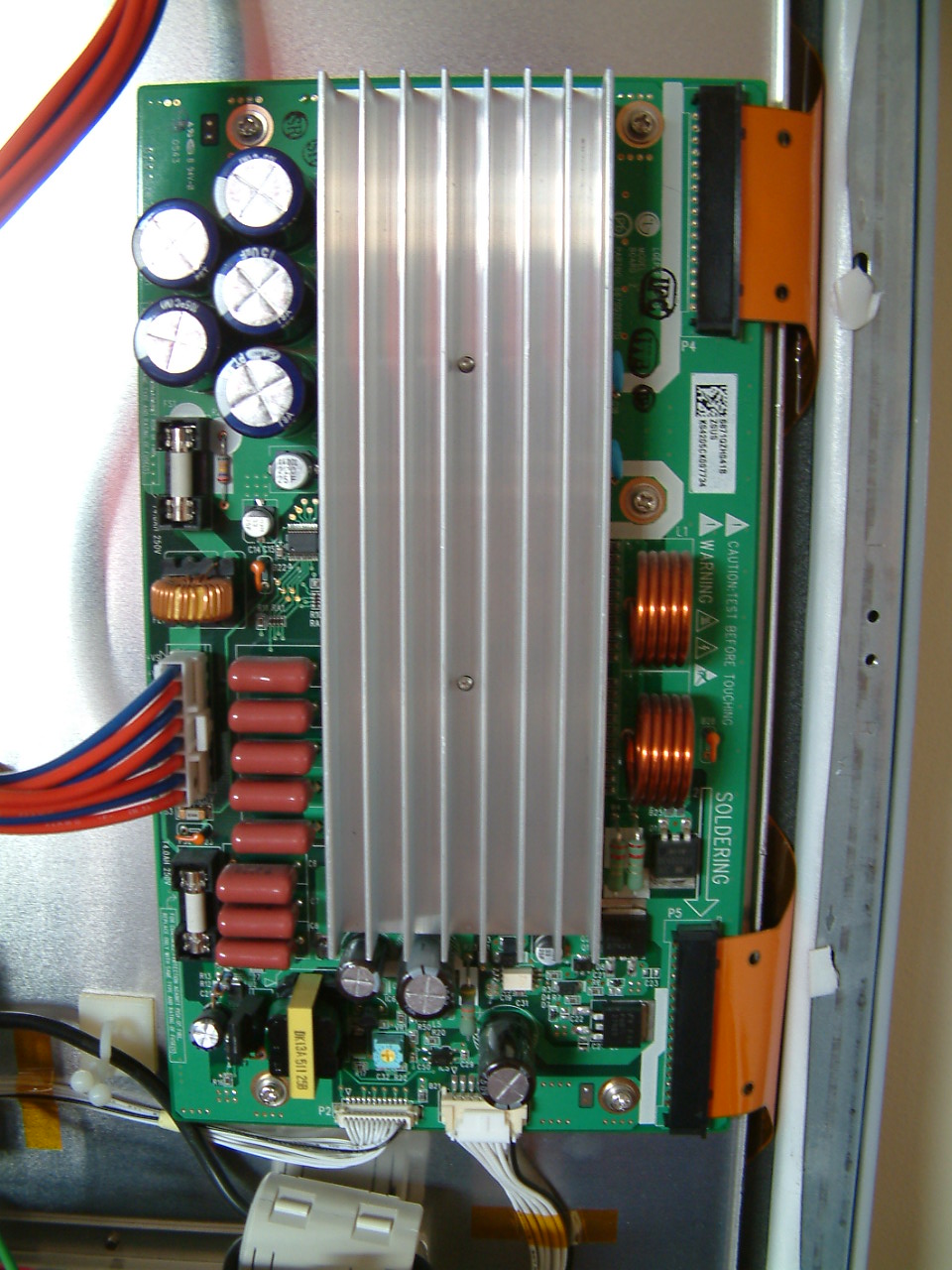

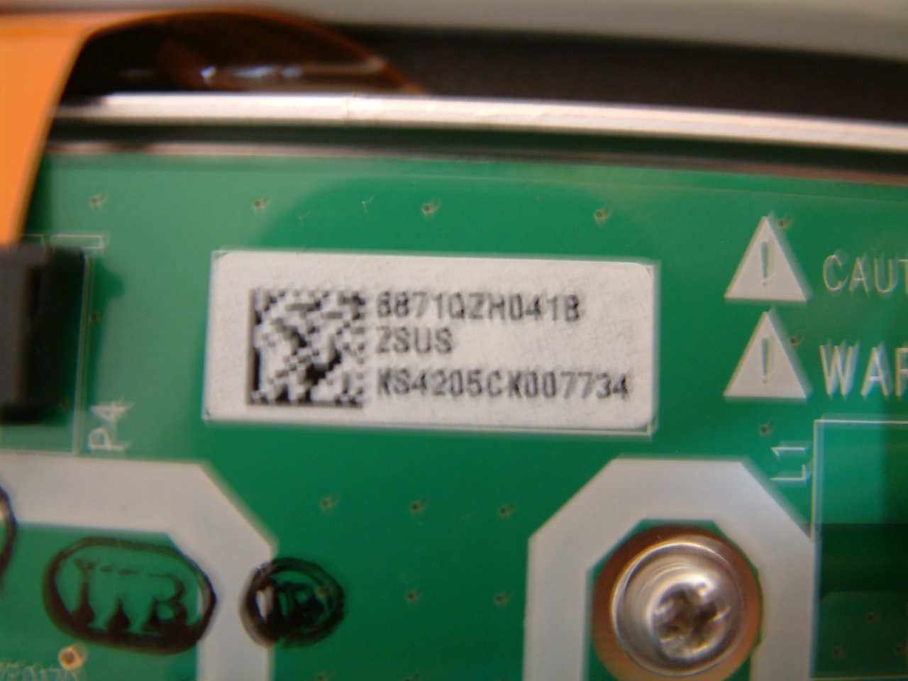

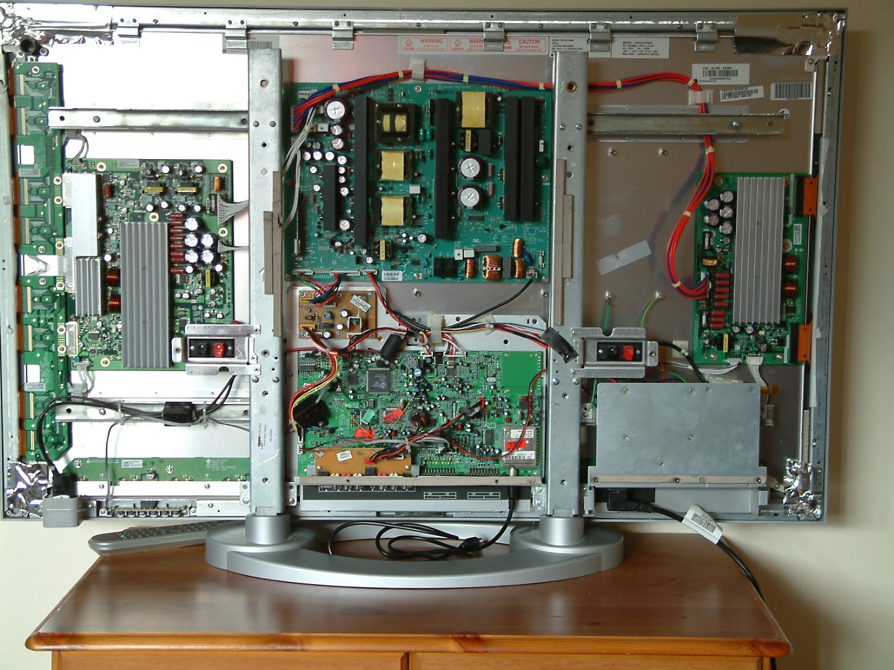

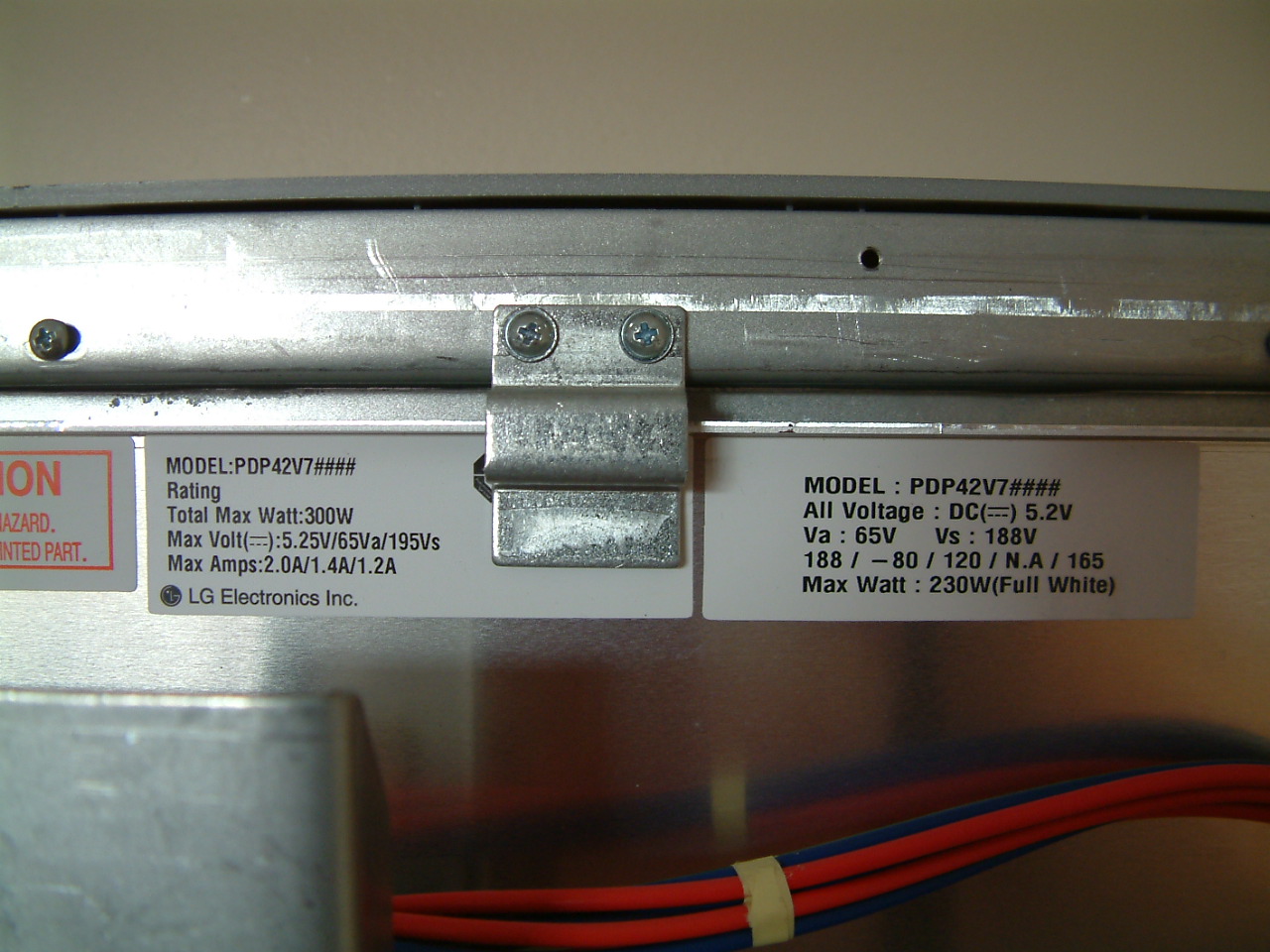

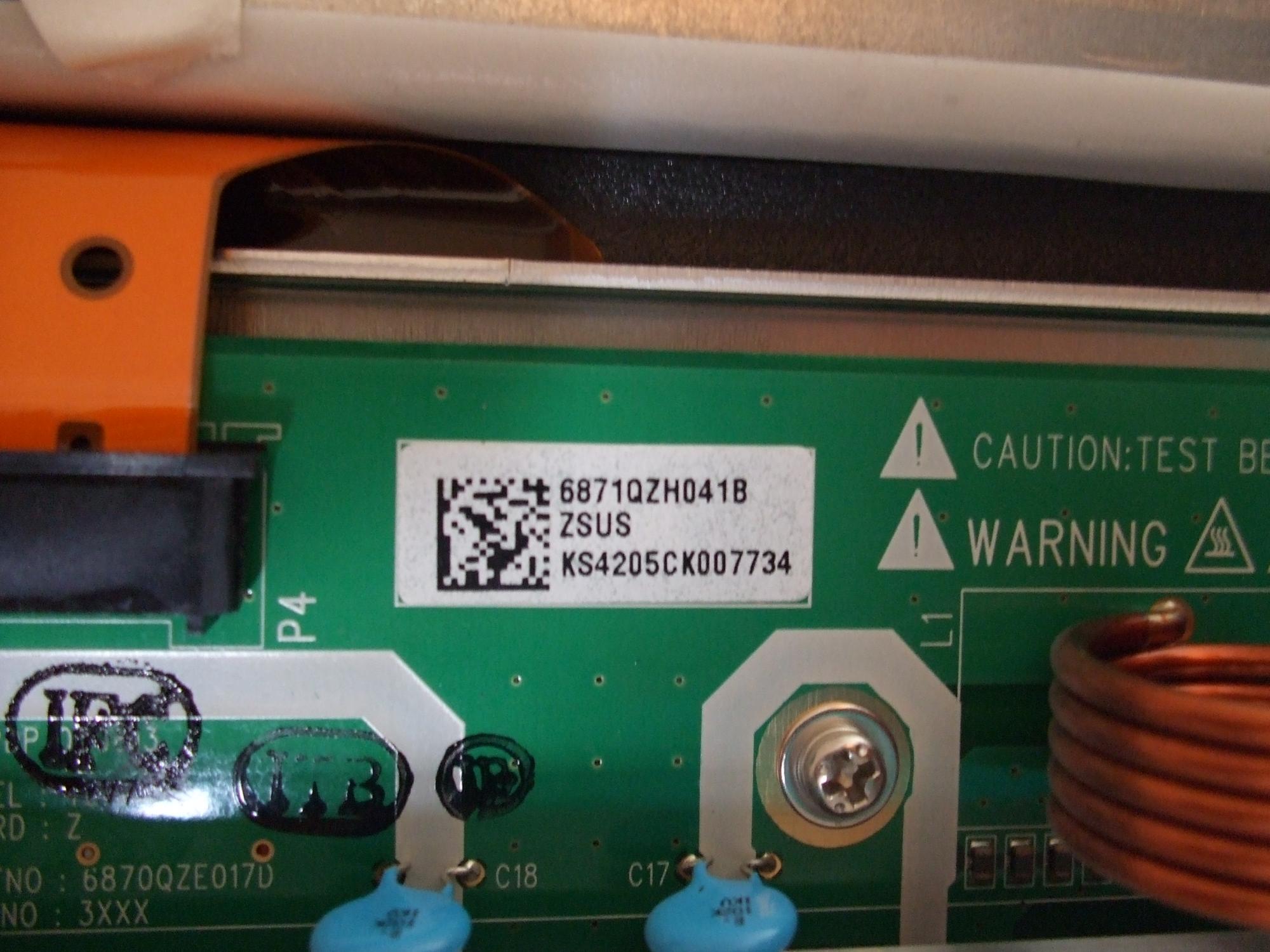

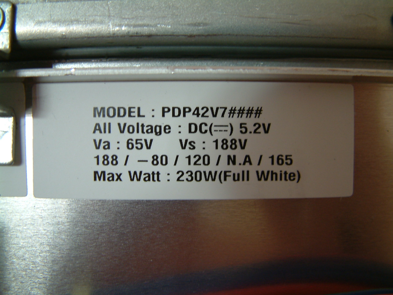

    Follow the links in my signature for taking and attaching pictures. I want one covering the full back of the TV (with the back cover off, obviously). I also want pictures of every label on the back of the plasma panel that specifies voltage, or model number of the panel. And on the right side (as viewed from the back) there should be the Y sustain card. This will probably be 12cm x 25cm. A sharp, clear picture of that showing all part number labels would be a big help.

      Re: Vistron vis042 plasma on standby
      Hi Plainbill
      Find attached photo's hope these are ok, if not let me know and ill take a photo again,
      Many thanks for the fast reply,
      Pete.
        Excellent quality pictures. I wish we got more like those.
        A quick background. LG Electronics manufacturers plasma display panels and sells them as an assembly to TV manufacturers, including Vistron. The assembly usually consists of the plasma panel itself, the Sustain cards (Y on the left, Z/X on the right), the buffers (Y on the left, X on the bottom), the main control card (hidden behind the 'TV board' towards the bottom) and the power supply. Vistron (or one of the other dozen plus manufacturers who buy panel assemblies) then add the 'TV board', audio amplifier, speakers, etc. The 'TV board' contains the tuner, the signal inputs, the signal processors, the over-all control processors, and additional power supplies for those components. It also does some rudimentary checking of the main power supply. If there are any failures, it goes into 'protect mode' and shuts down the main supply.
