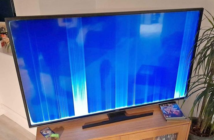

    I've seen this for sale, any ideas about the fault.

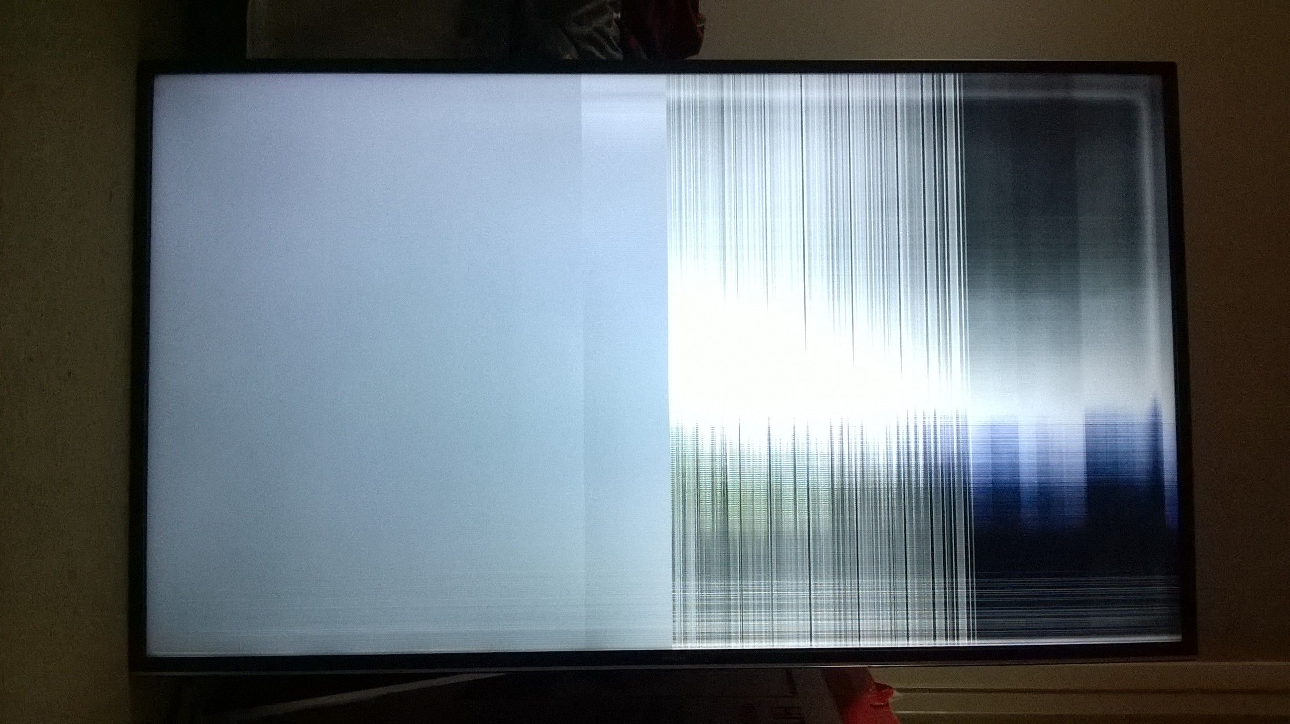

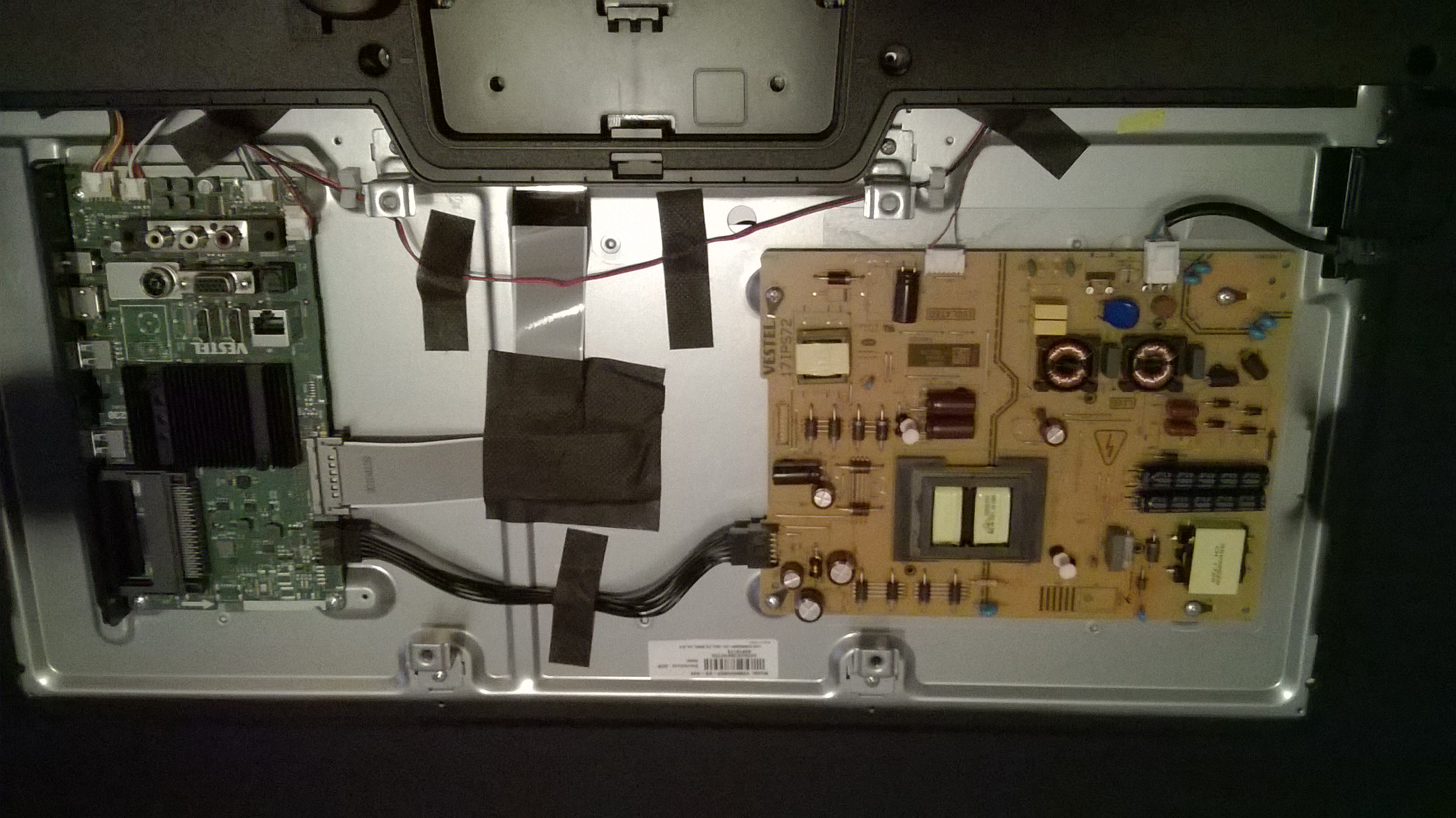

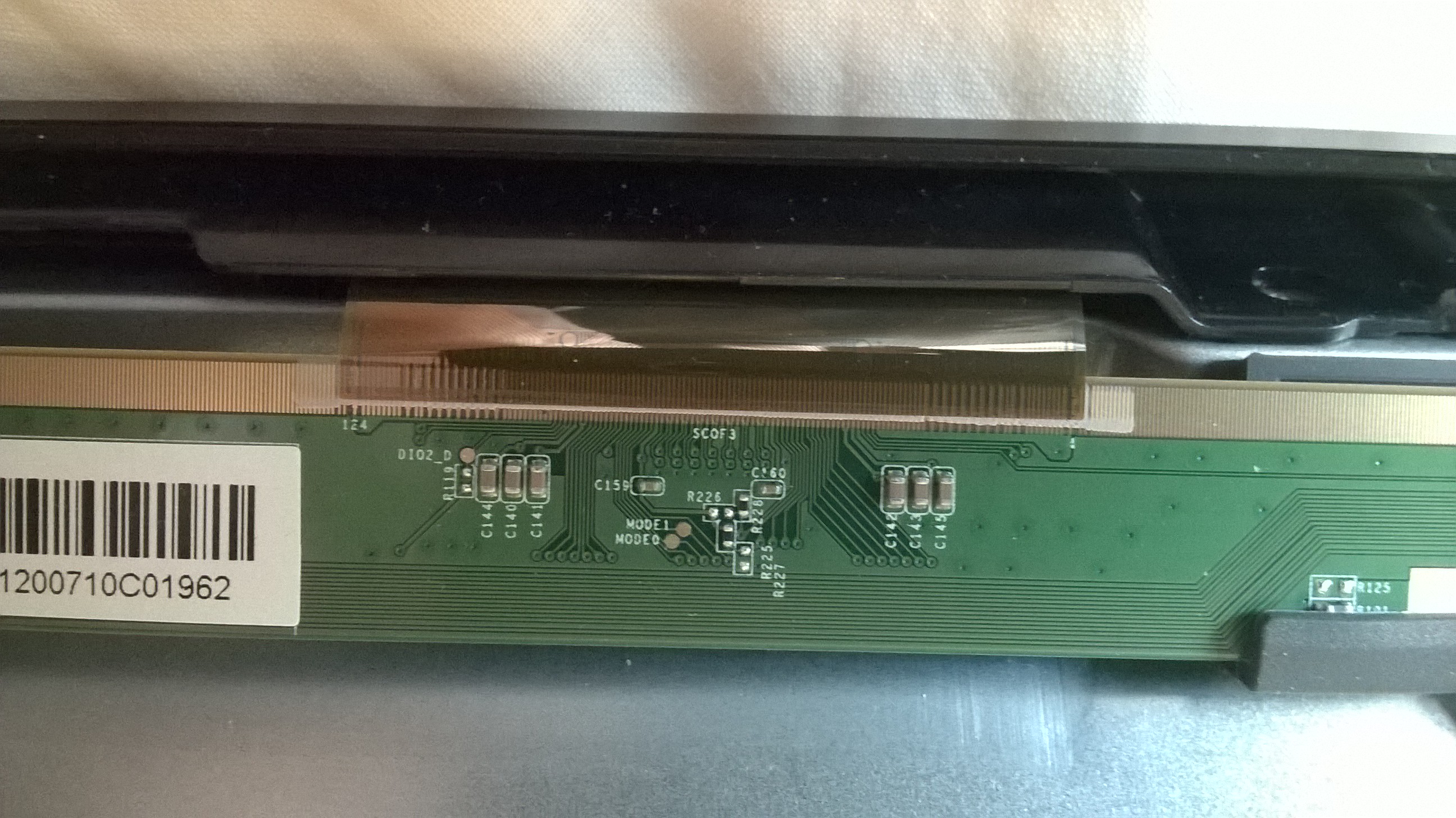

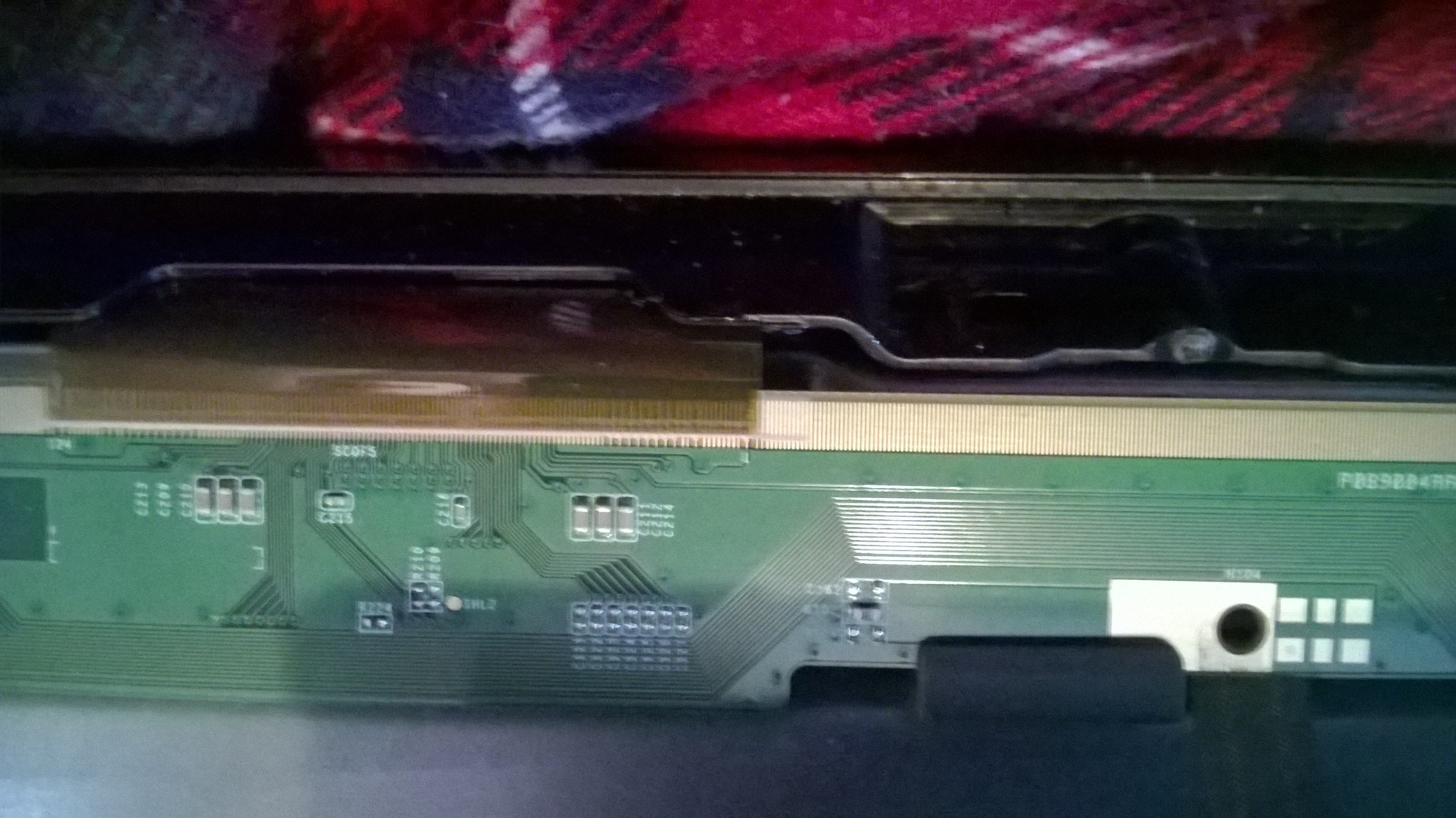

      The price was reduced to £15 so I bought it thinking I can sell the parts if I can't get it working. I removed the right hand side cable from the T-con board and I get a good clean half black and half white screen. If I plug and aerial in I get a slightly polorised picture but no striping. When I removed the left hand side cable from the T-con board and plug the right hand side back in, I get striping and no picture. I tried the tape trick but it didn't work. I tested all the caps on the screen buffer boards but there are no shorts. I tested the T-con board (CCPD-TC495-008 V4.0) and Vcom is 6.8v VGL is -5.8 VGH is 24v and VDD is 15.2v.

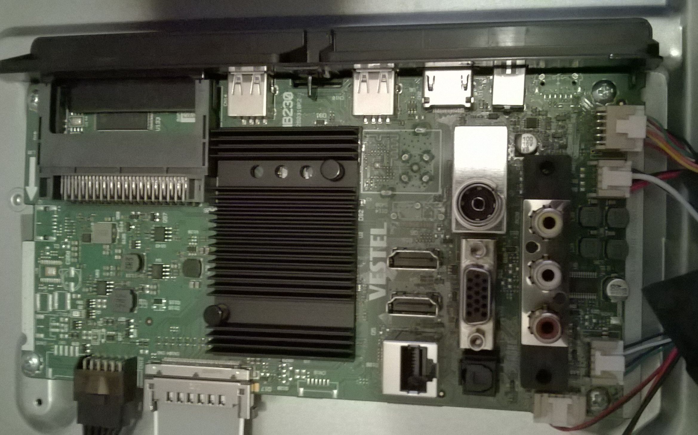

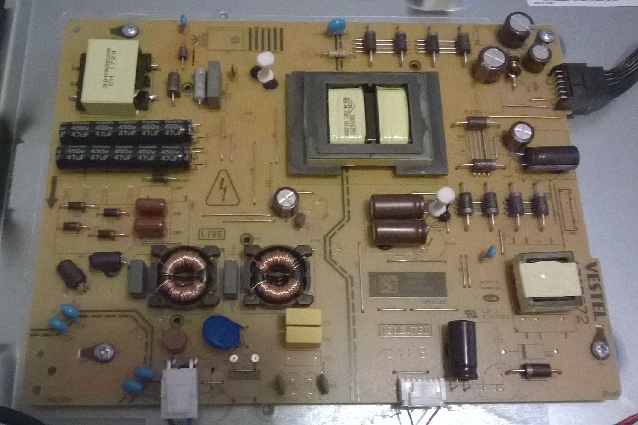

          show me the main boards please

            Vestel mb 230
            Vestel 17IPS72

              search over here the Vestel mb 230 firmware with urs panel no. its firmware issue

              • lotas
                • Jan 2016
                • 4802
                • Russia
                Re: Hitachi 50HK6100U Screen fault?
                The firmware will not help, the problem is in the panel.
                  maybe try tape cut-off method, can check the little mlc caps on panel driver boards for shorts or very low ohms, been over both procedures many many times here.

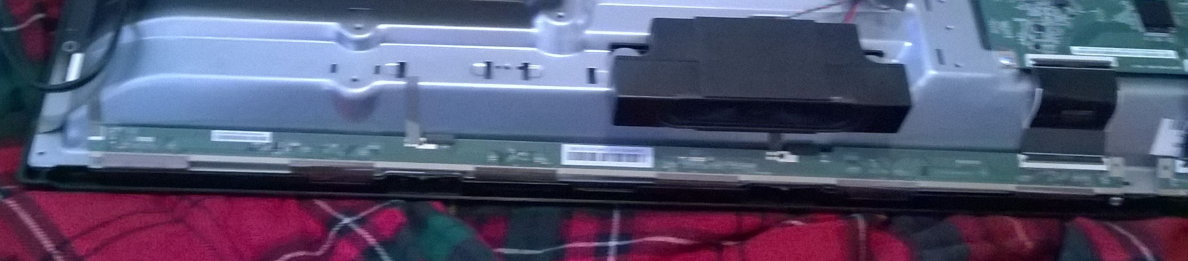

                      The right side is not working. Let him turn off the left side and connect the right side and post a photo of the image.

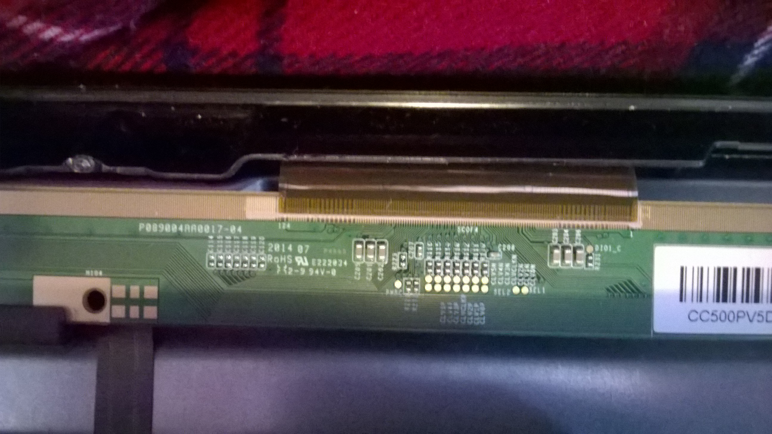

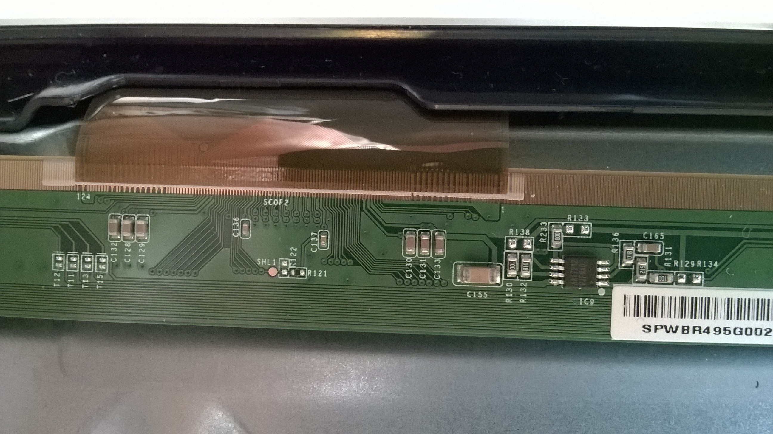

                      Ukdigger take a high-quality photo of the completely left bar (when viewed from the back of the TV) and the T-con board.

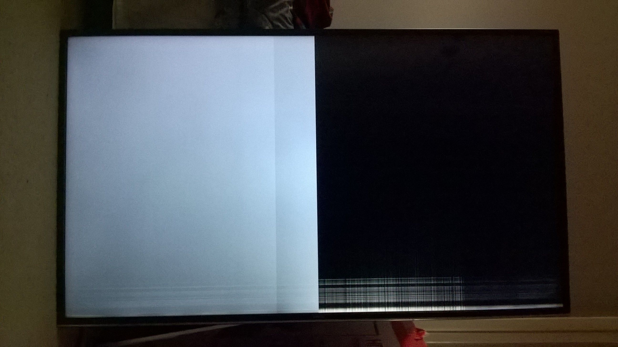

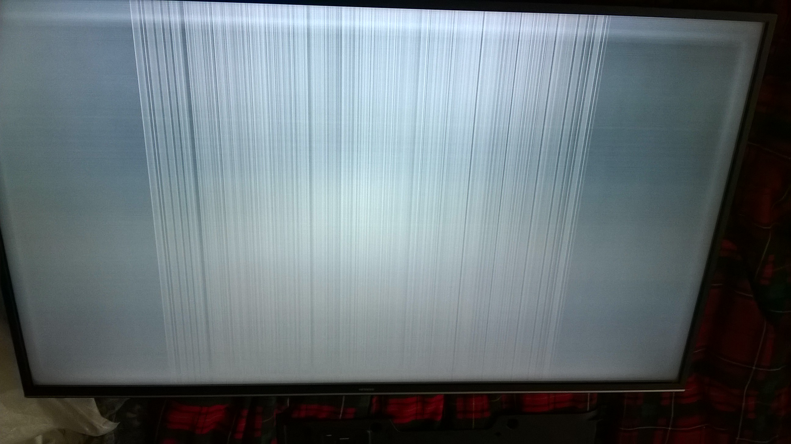

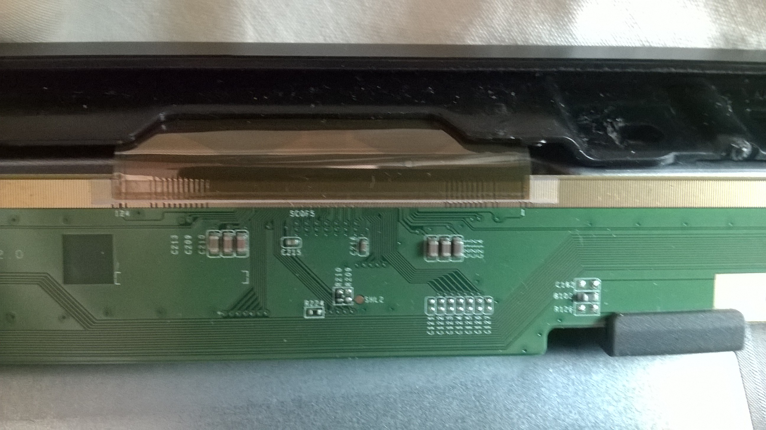

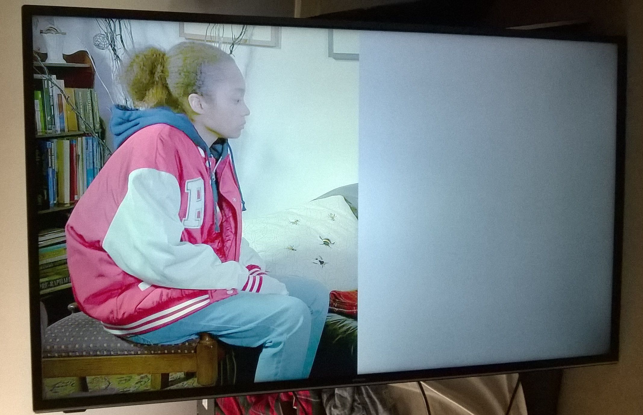

                          Picture with right hand side cable removed, as viewed from the back of the TV with aerial plugged in.
                          • Ukdigger
                            • May 2020
                            • 121
                            • England
                            • Ukdigger
                              • May 2020
                              • 121
                              • England

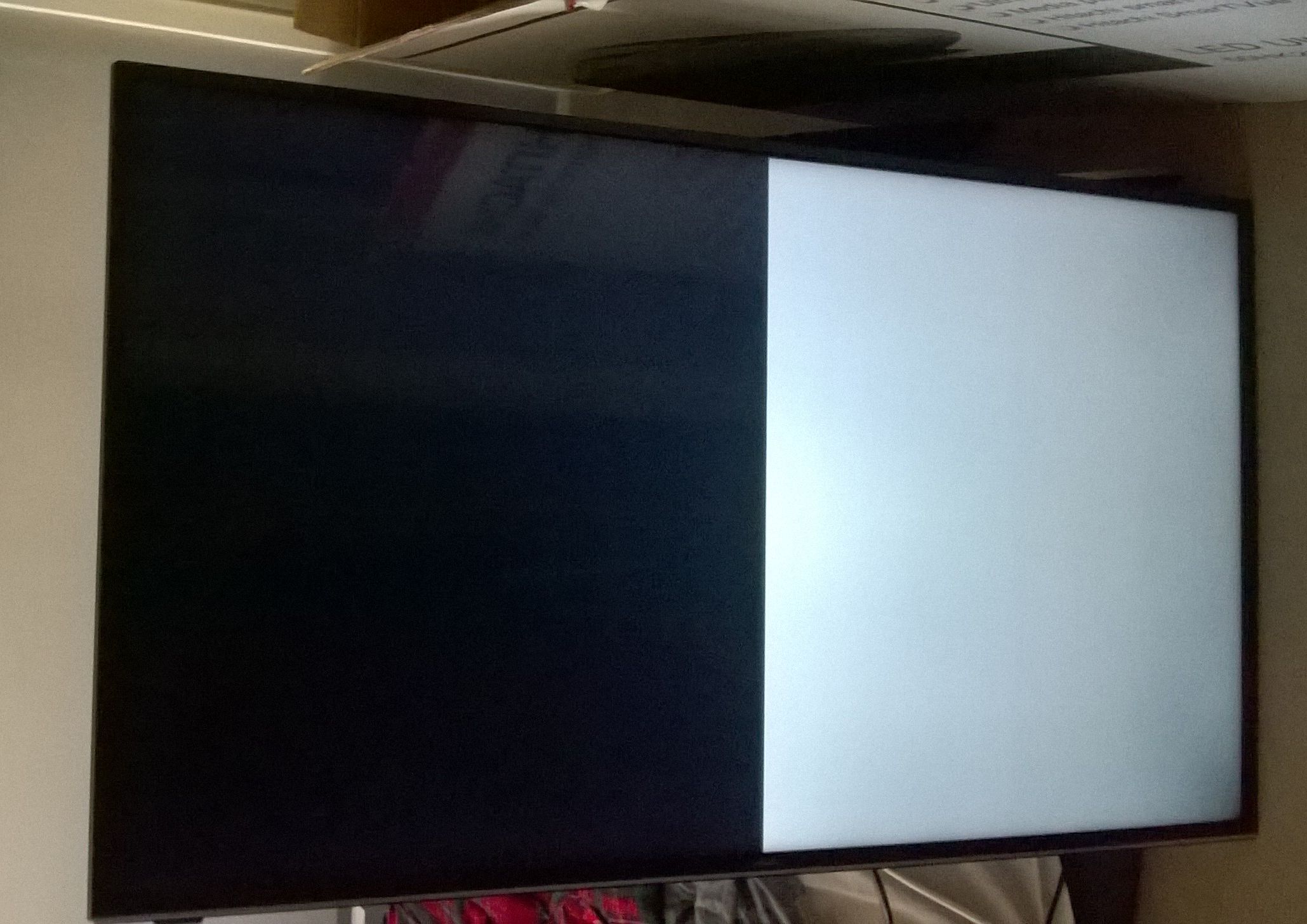

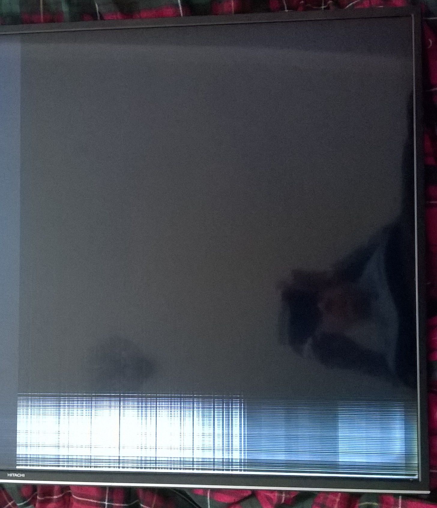

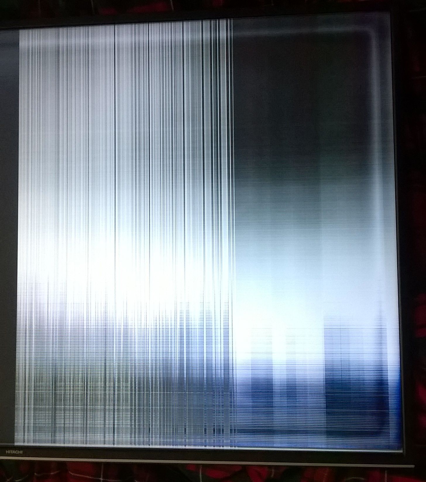

                              Pictures with right hand side cable removed, as viewed from the back of the TV. In my original post it should have said left cable removed gives a picture.
                              The screen changes from one picture to the other every couple of seconds

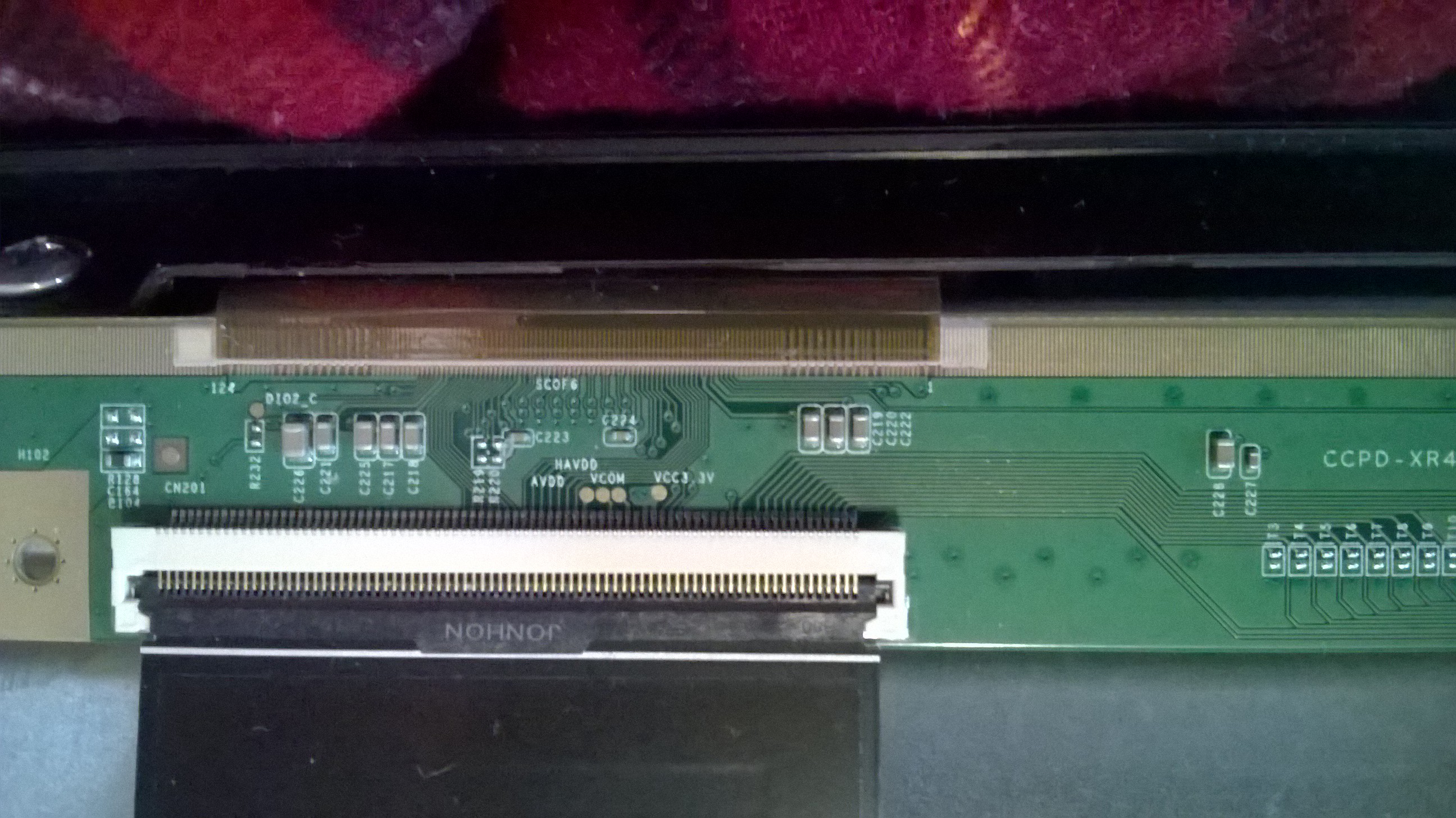

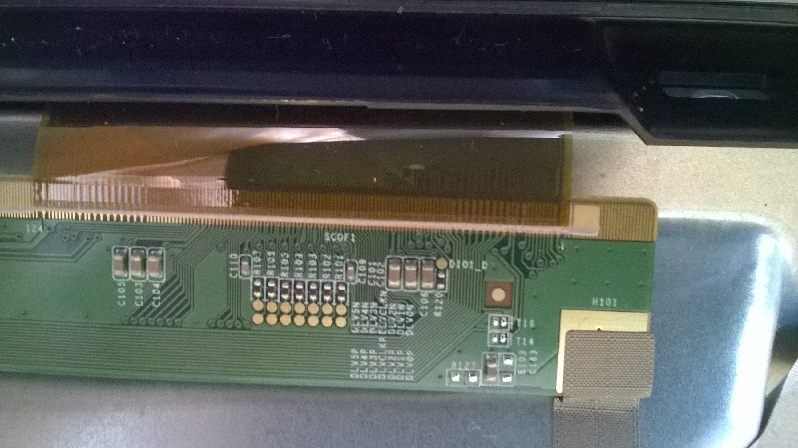

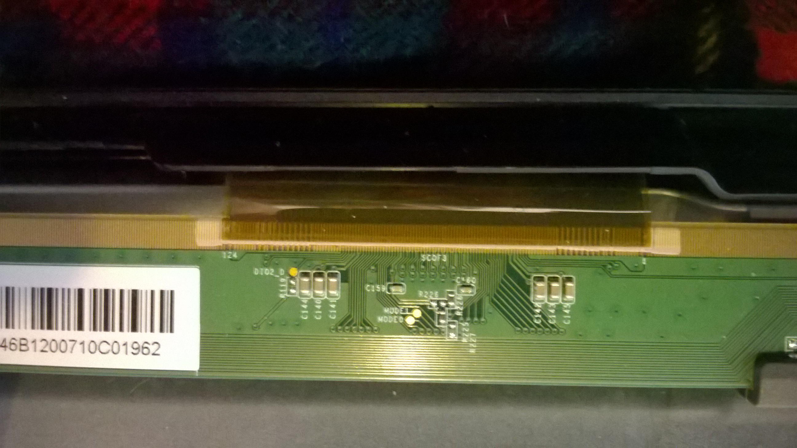

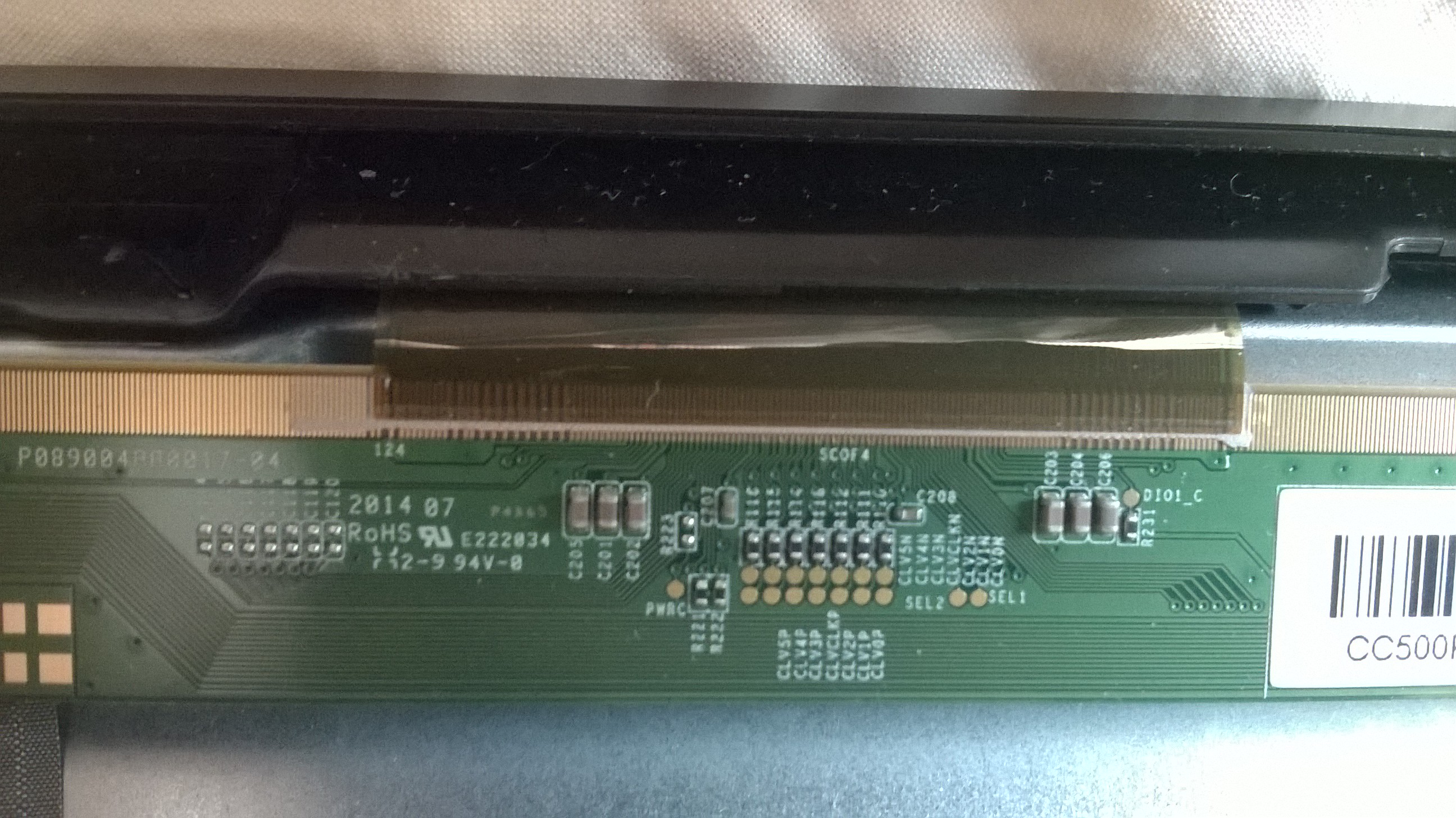

                                Can you take clearer photos of a non-working bar, otherwise you got very muddy ones?
                                • Ukdigger
                                  • May 2020
                                  • 121
                                  • England

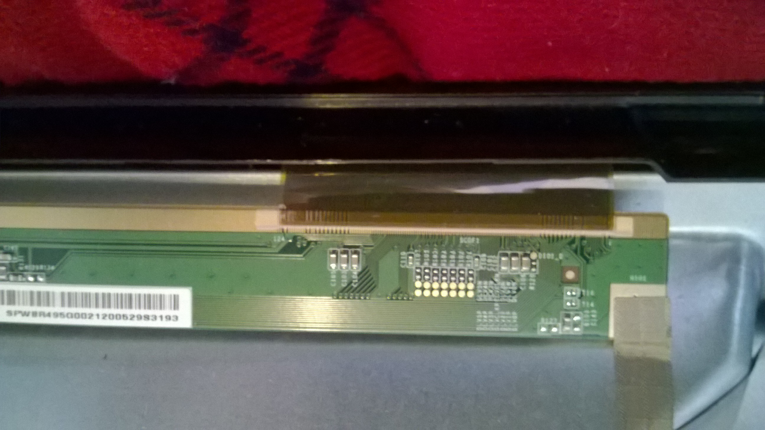

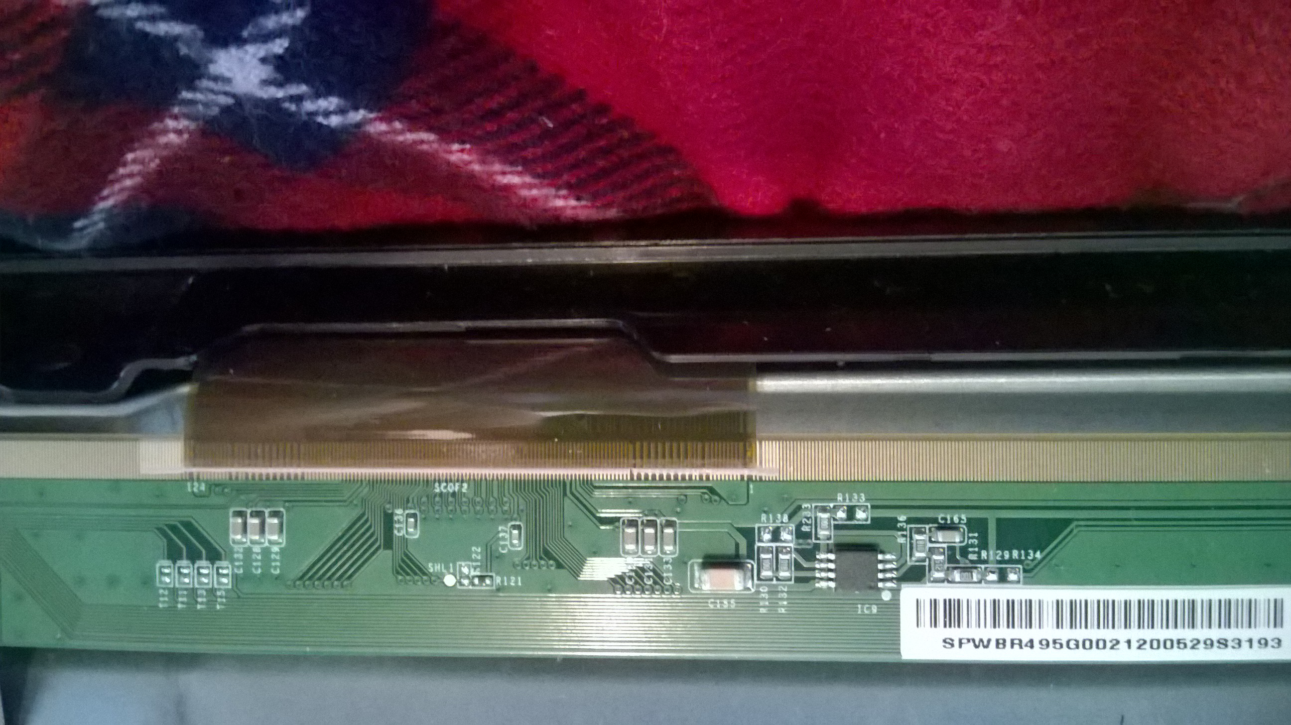

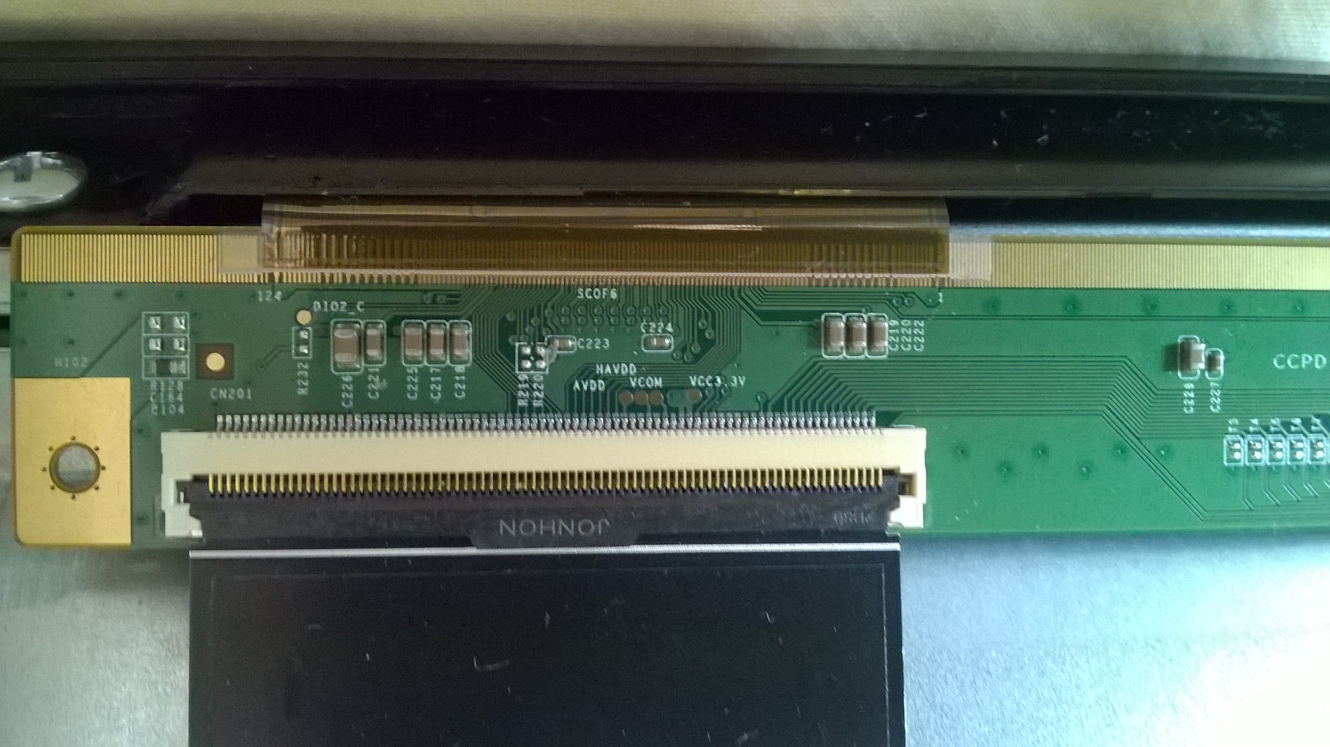

                                  Non working side, changes every few seconds

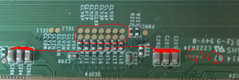

                                      You can measure the resistance of these test points to ground (GND) with the cable disconnected from the T-CON.
                                      • Ukdigger
                                        • May 2020
                                        • 121
                                        • England
                                        They all read 1.58 in diode mode
                                        I checked the other board and they all read 1.57 apart from 2 which read 1.56

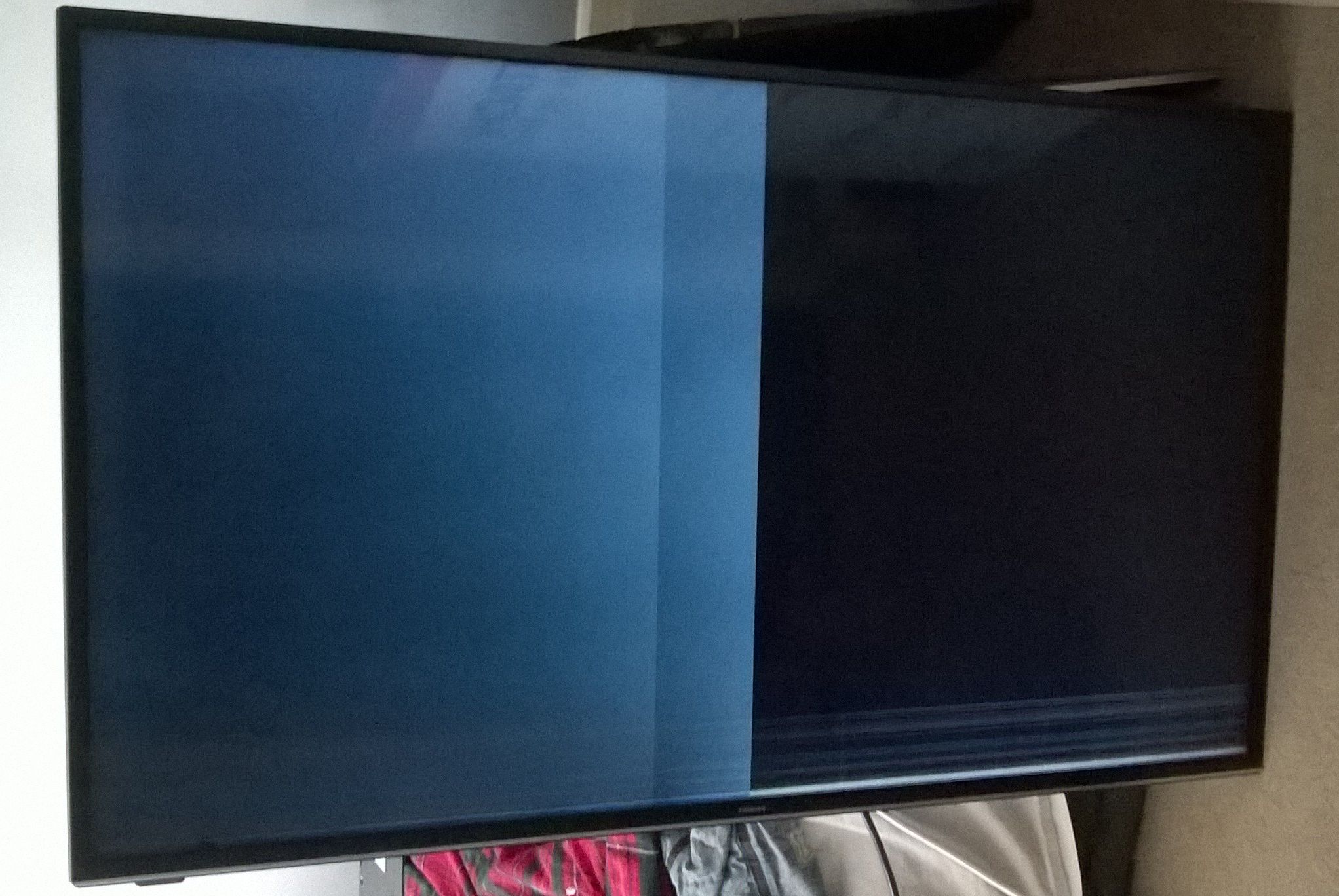

                                          I own a Hitachi 50HK6100U with a display fault. After some troubleshooting, I've found that removing one tcon cable produces a clear image on the side still connected. Removing the other tcon still provides display output; however, this is a heavily distorted image. With both cables connected, only the top ~25% of the screen provides display output which is still distorted. It's only when both are connected that most of the screen no longer provides output. The attached images show the screen with each tcon cable disconnected, and one with both connected. The red line shows where the display cuts...
