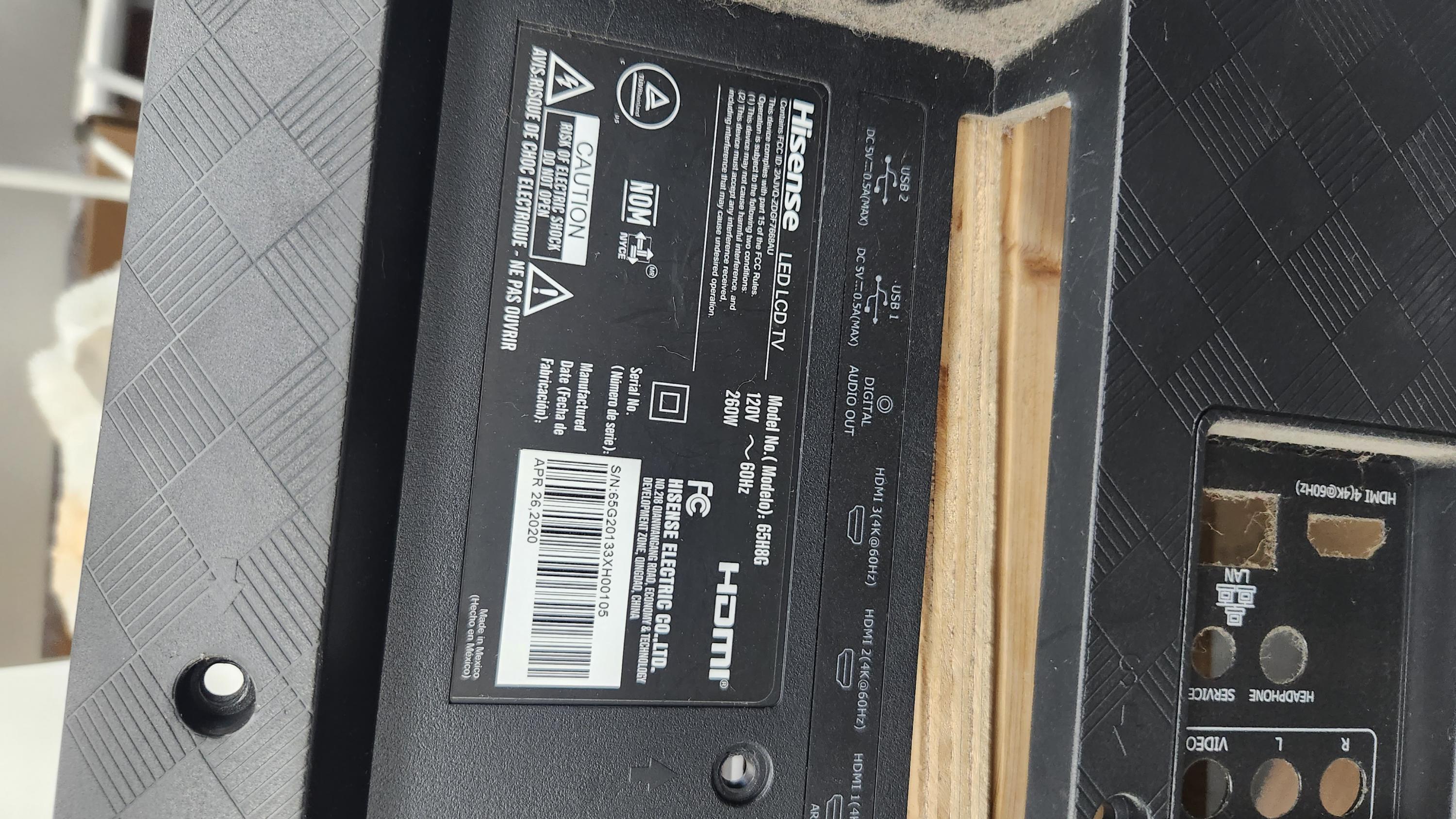

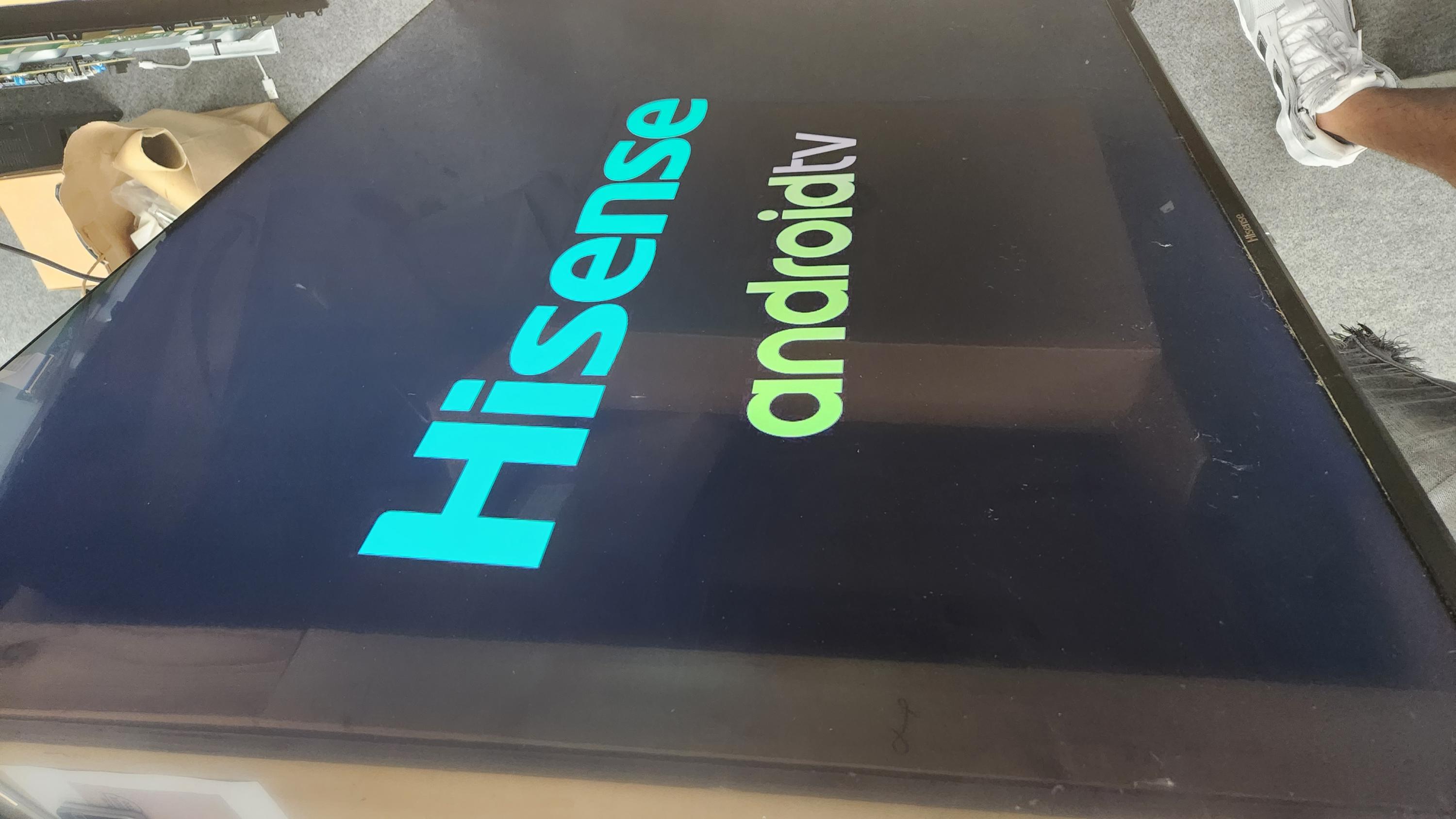

    Hi i have a Hisense TV that is stuck boot looping. Tried reaching out to hisense for the firmware file but no response and its been a couple weeks. Does anyone here possibly have it? Thanks in advance for any help.
    Here is the label and picture of what it shows on the screen.

    Re: Hisense 65H8G Boot Loop
    Your tv got bricked by a recent android update most likely. I would wait for Hisense to send you a new firmware update to put on a usb stick formatted in Fat32. Than update the tv on power on with the USB update.
    • tech9pc
      • Sep 2021
      • 49
      If the USB update from stick don't kick in / or doing a hard reset .. you will probably need to replace the main board.
          I had the same issue with my Hisense 55H9G. I reached out to them on Facebook and they sent me the file. Try Facebook.
          • frannyjunk
            • Oct 2010
            • 82
            Here is the link to Hisense tv firmware: https://www.hisense-usa.com/support/firmware-download
