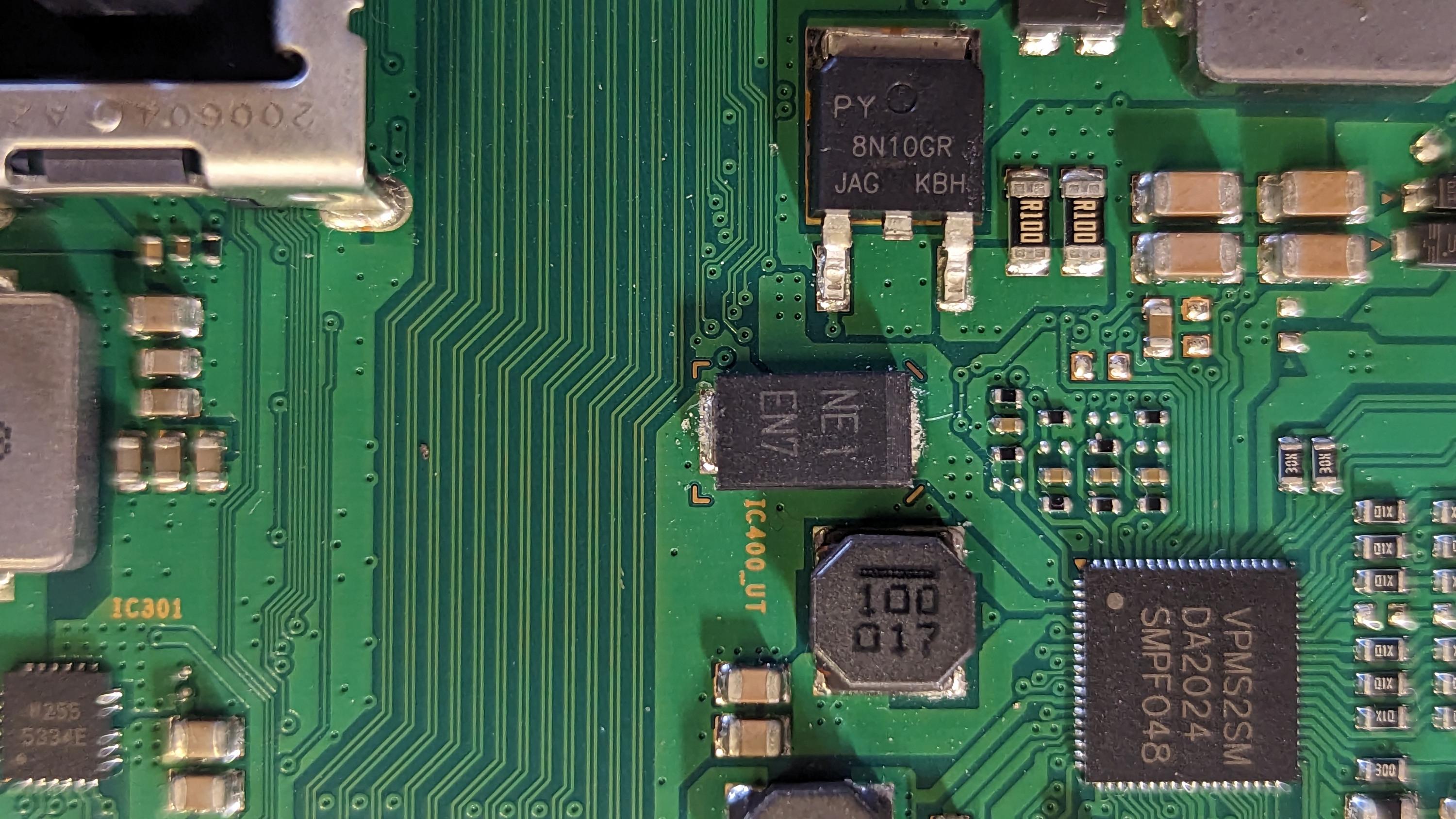

    I picked up this Samsung 50" QLED, QE50Q50TUA.
    MB is BN41-02756C.
    PB is BN44-01058A
    no dedicated TCON - its on MB.
    fault symptoms are:
    TV powers on, Backlights come on, no picture, then restarts and repeats.
    Power from PB to MB is good, 13V is present as detailed on the PB board diag info.
    i can find some 1.3v and 3v power on the MB, but nothing higher.
    there is no VGH on the buffer boards, again some 1.5v and 3v, nothing higher.
    found this SMD device (diode ?) which doesnt register on ESR/cap/diode tester, removed it and still tests the same.
    SMD code : NE1 EN7
    label near it : IC4000_UT
    cant find it anywhere -any suggestions what it might be and what i could replace it with ?

    Re: Samsung QE50Q50TUA power cycling.
    It's not a diode, it's a Polymer Chip Tantalum Capacitor.
      ok, thanks.
      ill see if can find a suitable replacement from a spare board.
      • stav242
        • Jan 2014
        • 61
        • United Kingdom
        replaced with a 33uf 50v cap. no change though.

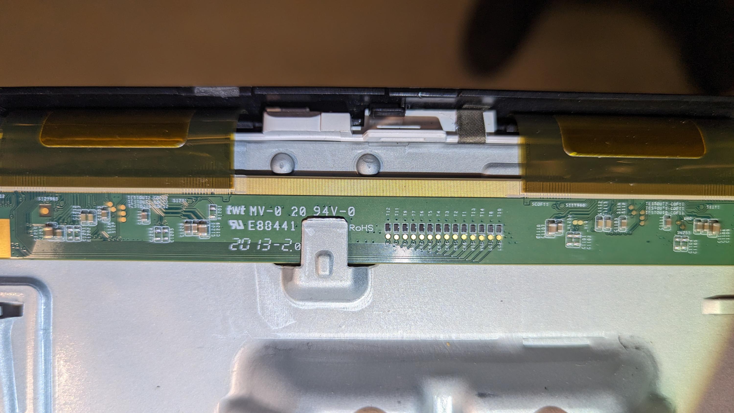

              • lotas
                • Jan 2016
                • 4753
                • Russia
                The problem is in the panel itself, take a photo of the full buffer strips and on which strip, if it is connected, the reboot occurs.

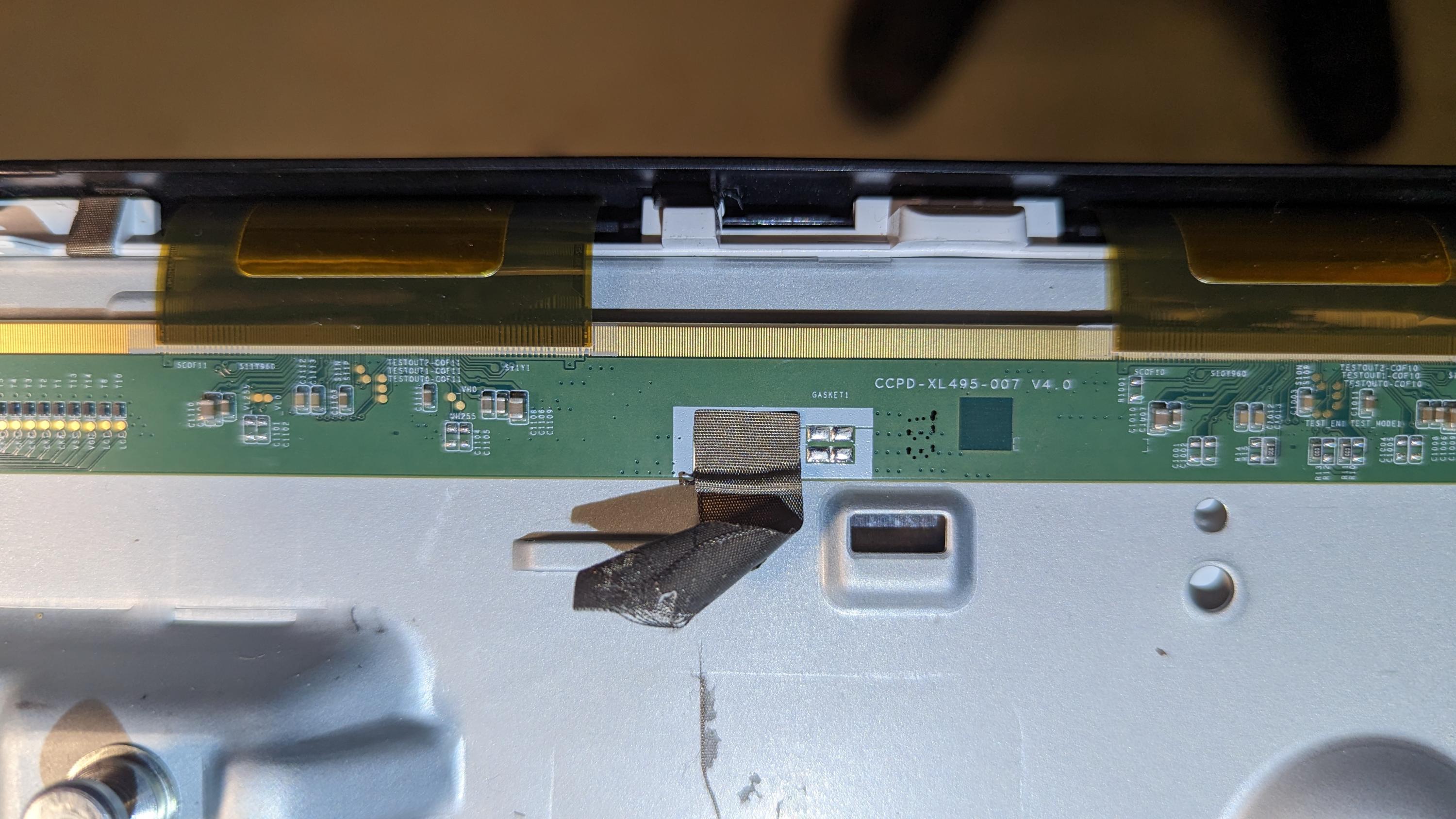

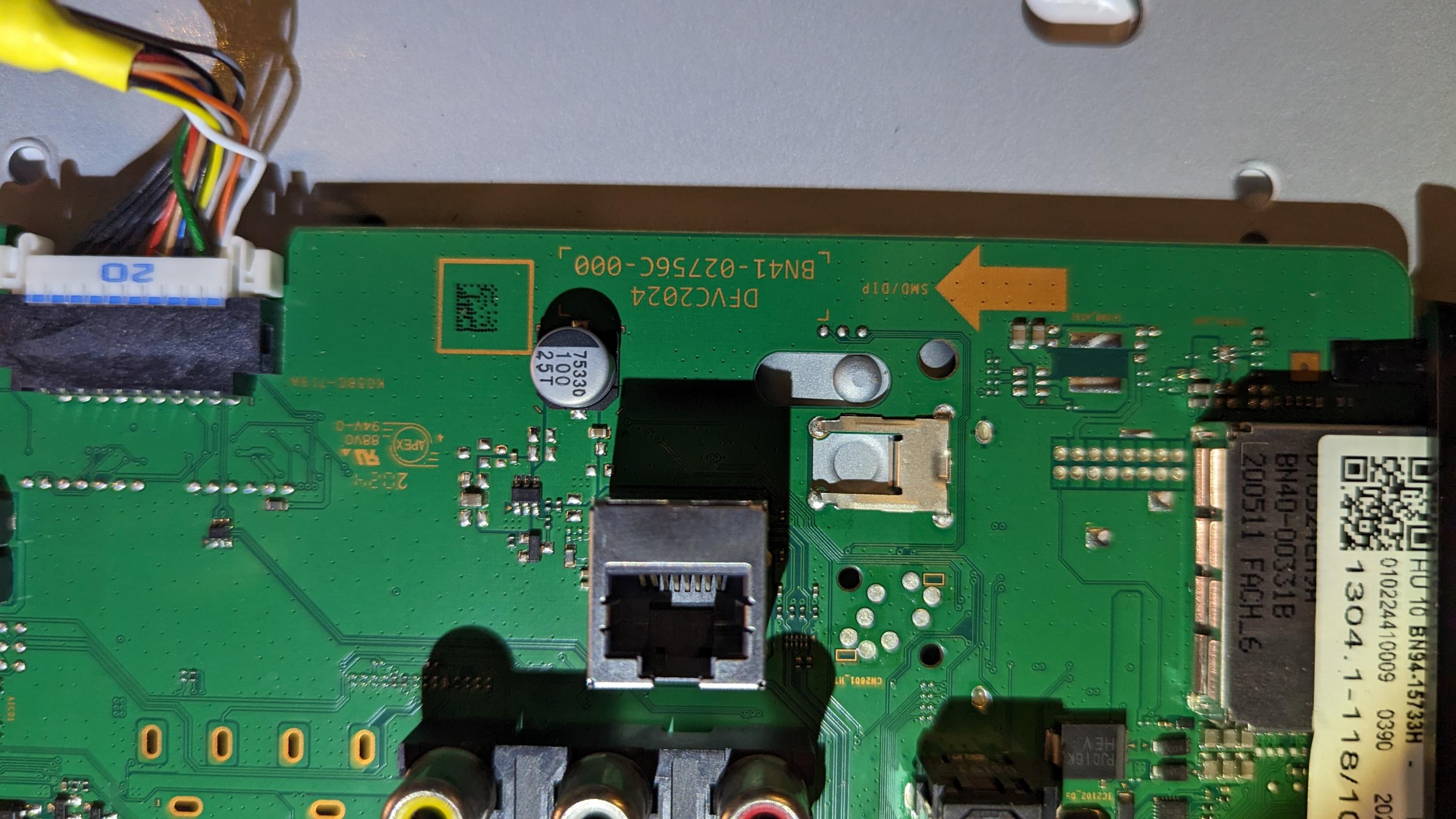

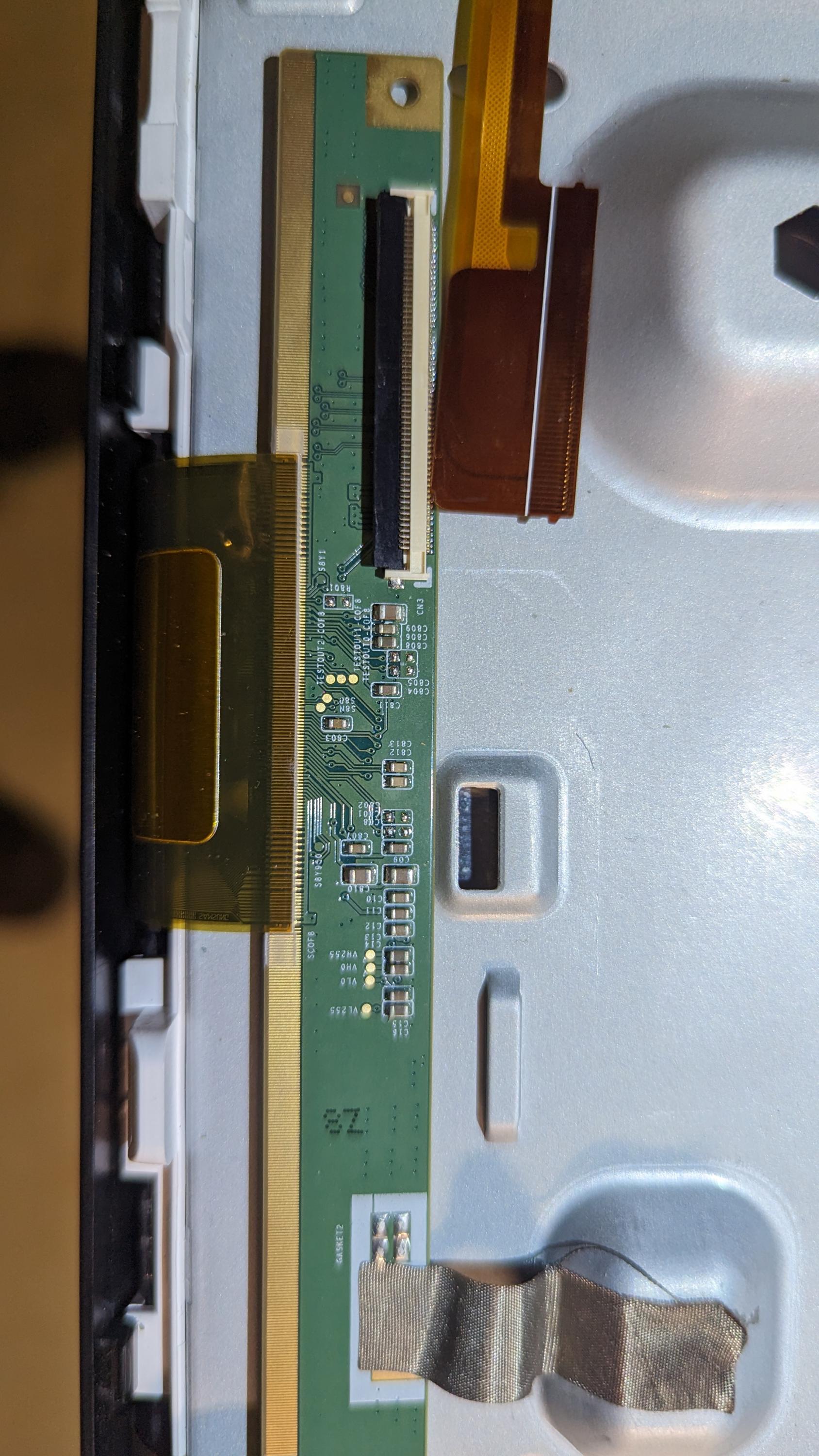

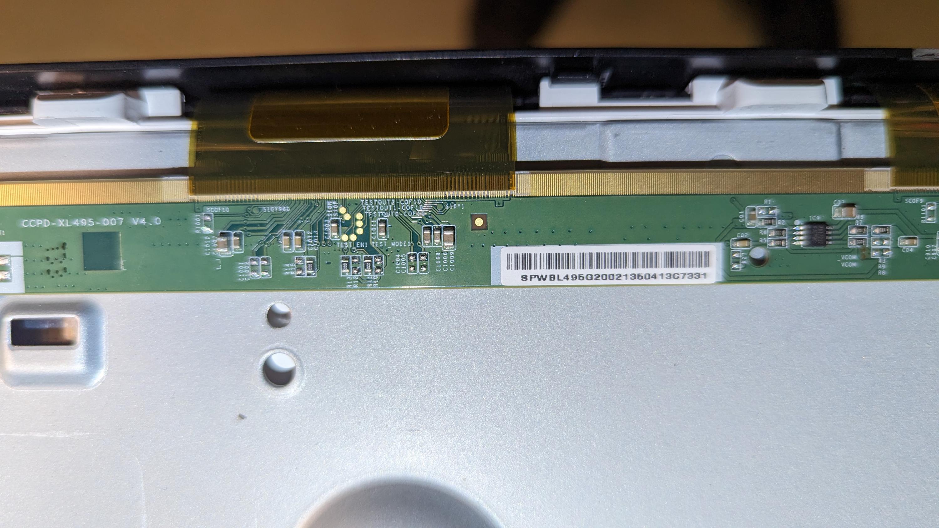

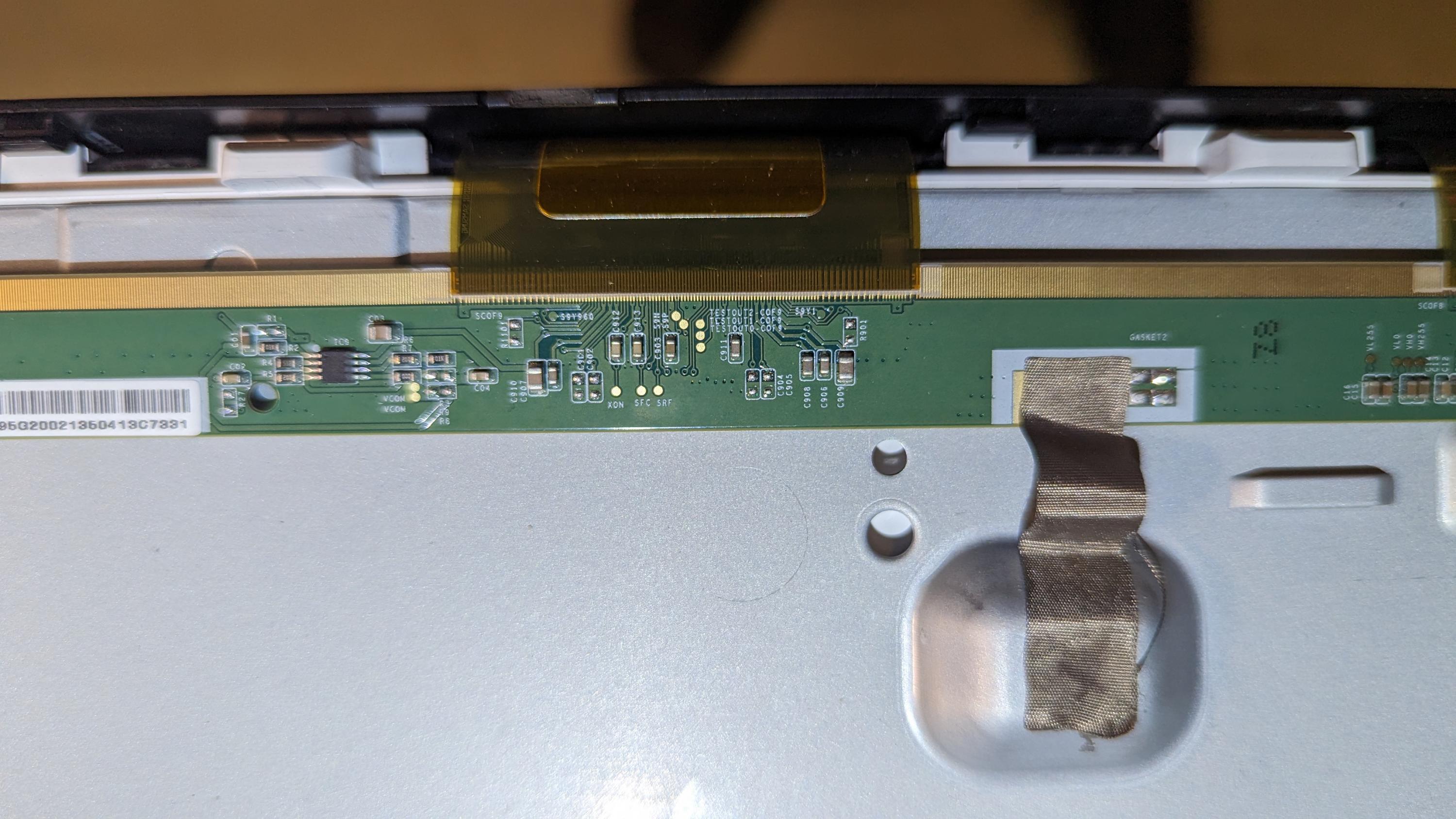

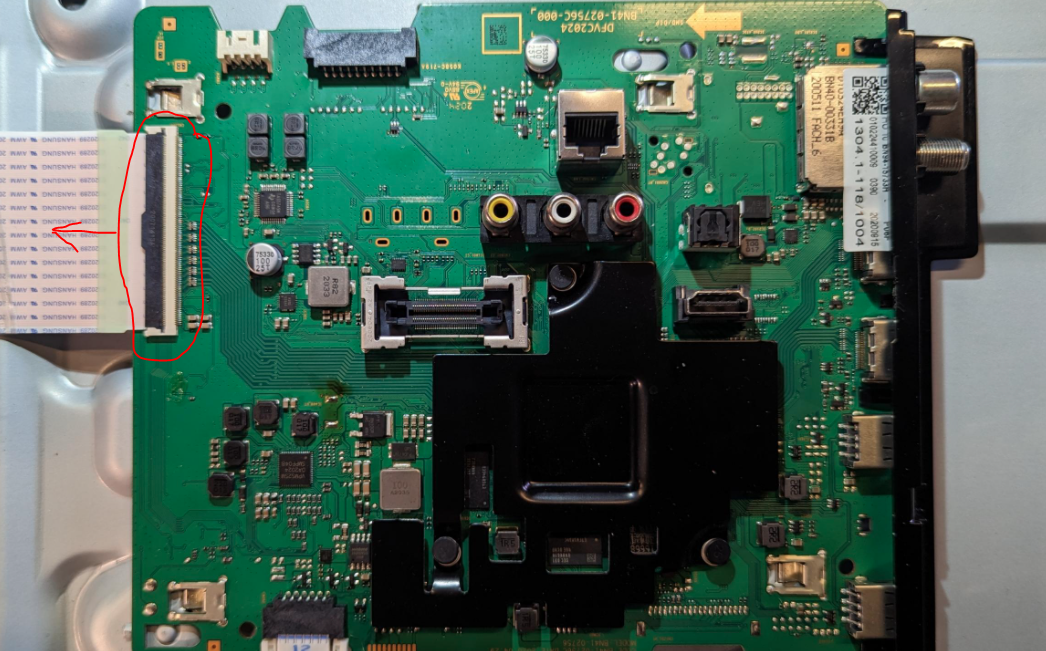

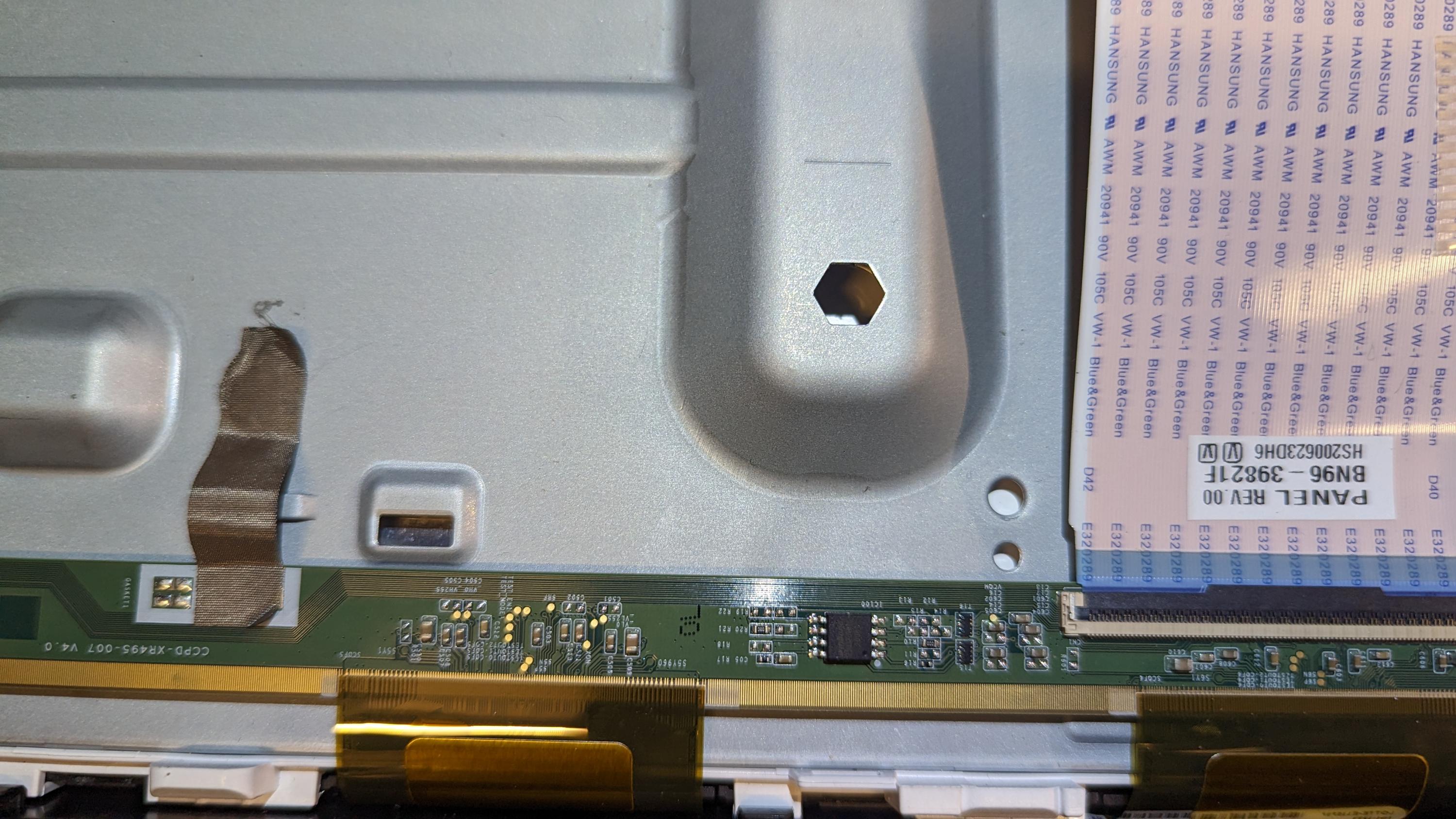

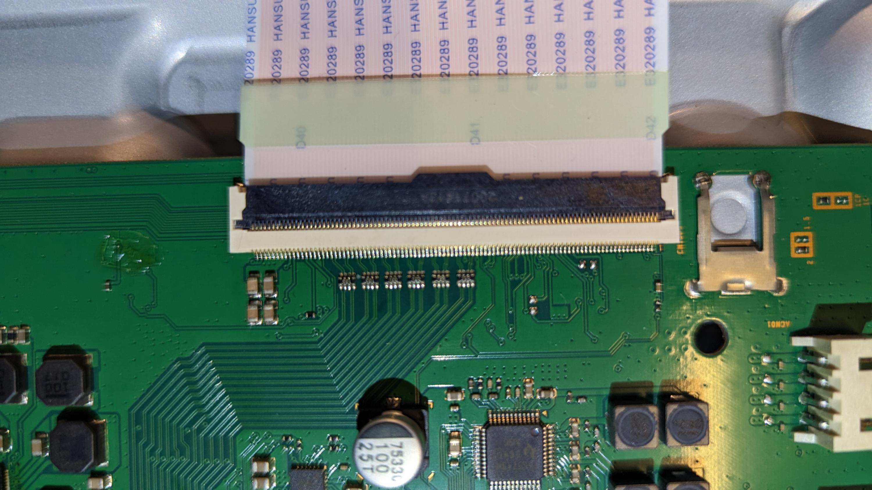

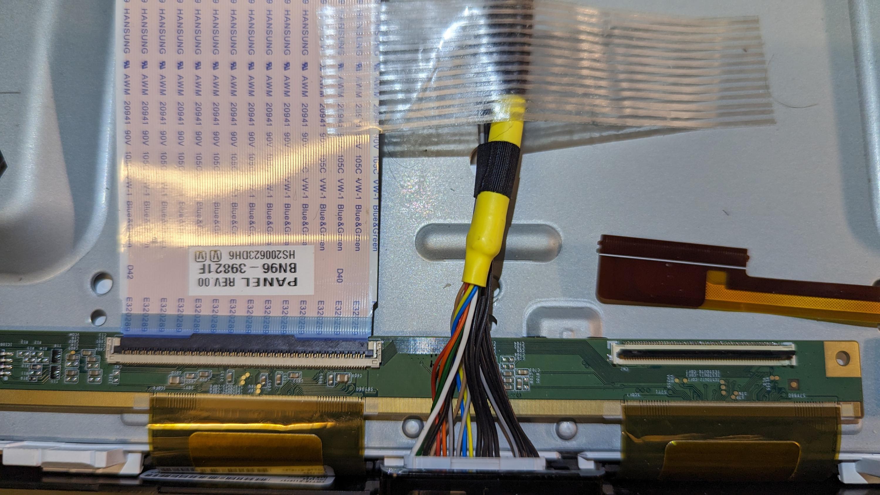

                  • stav242
                    • Jan 2014
                    • 61
                    • United Kingdom
                    ok, photos attached.
                    2x of main board with LVDC connector - no markings i can identify any volatages to check.
                    2x of left board - this is connected and TV powers on, optical port on MB lights up constant, remote works, but no sound or picture.
                    4x of right board, this connects to leftboard, and when connected the TV reboots every 10 seconds. - can see the MB optical light and backlights power cycle.
                    ive checked the cof tabs, cant see anything visually wrong, no burns or damage.
                    this TVs a QLED and cant immediiatley see hwo to get the LCD panel away from the frame to do a more intrusive panel check atm ... will see if i cant figure it out.
                      Looks like another TU.
                      Why do you need to remove the panel?
                      • nomoresonys
                        • Jan 2013
                        • 12276
                        • U.S.
                        It's a samsung QExxxxx POS, problem is the panel as stated, don't really need to look at the backlights, so no reason to tear all the way down.
