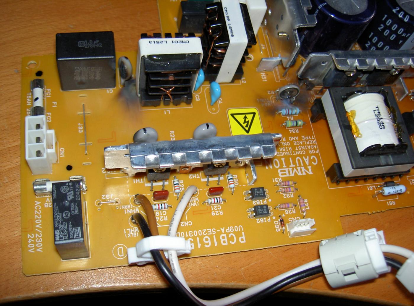

    Took it apart and this is what I found:
    A blown transistor (front of pic) and all of the components marked VS and a number (all over the PCB actually) some kind of zener diode?
    The left 1000uF 200v 105°C Nichicon bulk cap also has a slight bulge, guess it did not like the surge either...

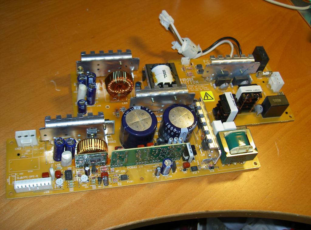

    This powersupply actually wights more than most PC powersupplies, including cables and case!
    Not holding my breath I asked google the PCB number, and lo and behold, eBay got me sorted, seller did not offer shipping to Sweden initially but I sweettalked him/her

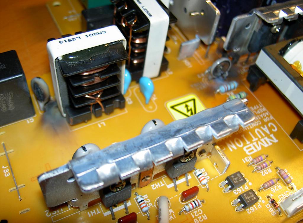

    "TH" suggests to me that it is a thyristor (TRIAC).
    Since the two TRIACs are adjacent to each other, they would have the same number.
    The TRIACS are usually used for the fuser lamps and in some models, motor control.
    One of the blown components appears to be a NTC. What are the designations on the PCB where the blown components are (other than the TRIACs and capacitors)?
      Re: Minolta Magicolor 2200 printer powersupply
      That's it (as far as I can visually indicate that is)
      I can see atleast 3 fully blown to bits triacs
      And the "transistor", marked TH1 on PCB:
      BCR8PM
      12L 23AX
      It was too a triac, a semiconductor by Mitsubishi Electric
      The capacitor that looks ok has 0.03ohm ESR, the bulging one has 0.06, so maybe it's fine afterall
      If anyone needs this PCB just give me a PM, after I verify that the one from the eBay auction works you can have this one. Of course with the mentioned defects

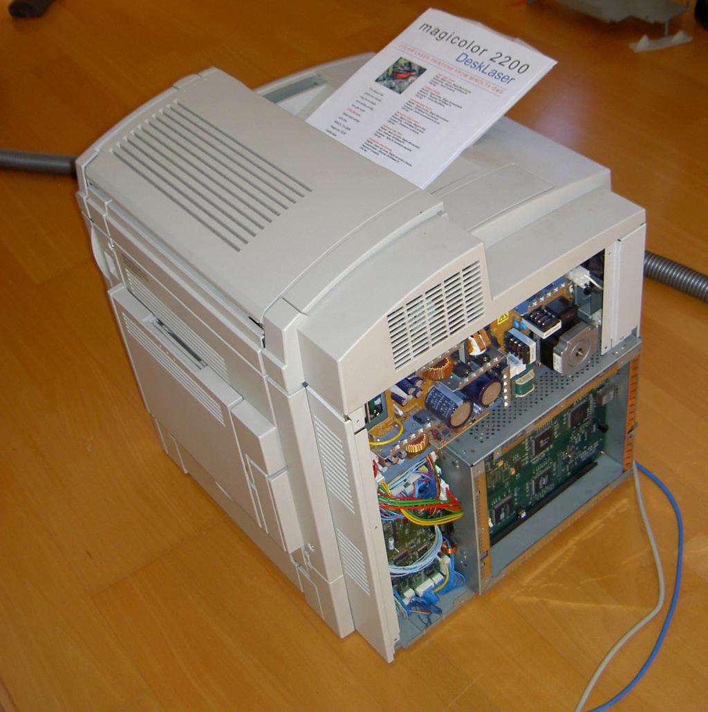

        Got the PCB yesterday, took a while to screw the printer back togehter, and when I finally had it all setup it wanted to piss me off by saying this and that cover isn't closed etc (problem with the microswitches and damn plastic shit )
        Anyway, after a while of fiddling it powered up, and I managed to print it's testpage, it works!!!
        3 hours later I had managed to get TCP/IP printing to it working (don't ask, lets just say I prefer HP)
        So Out the Win2K testpage goes too, working fine...

            Hmm, took it apart now, there is no filter.
            That is to say the cable that goes into the unit goes directly up to the PCB I replaced (through the on/off switch)
            Neither the receptable or on/off switch has any filter built in it seems...
            So the filtering must be done on the powersupply's PCB alone...?
            In the picture below power comes in through the connector marked CN1 on the very left of the PCB...
