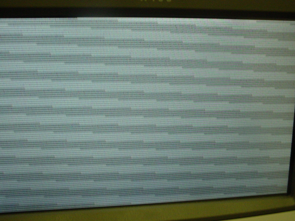

    Lexmark x463 screen
    so someone came by my doctors office and sold them this printer, for a lot less then it sells for, it worked at first, but now, when it comes on and you press the screen a patteren of grey and black squares in a diagnoal patteren. I took a pic with my phone and can't find my usb cable for it
    I looked at it, found the motherboard with rubycons, looking all right, but the screen turns off after a few mins, and any touch to it brings back up the same patteren
    think its the screen or the motherboard? I can get both, but not for cheap

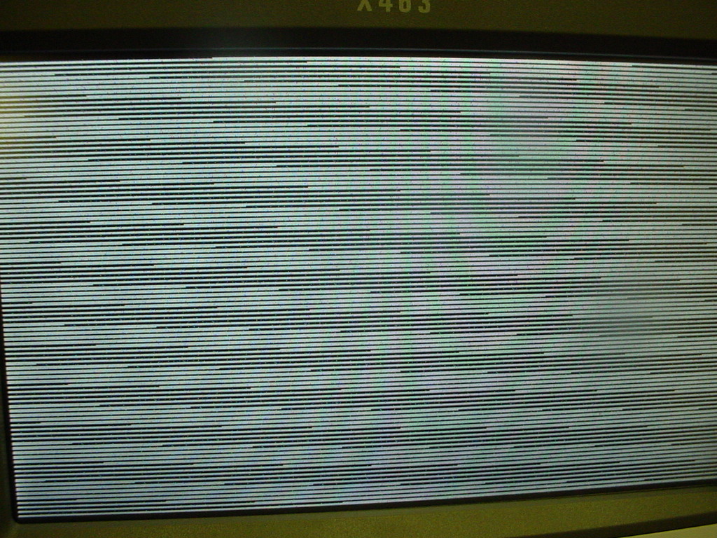

        well the thing would never boot to the point where it got itself an ip address, and would respond to the updater tool, even with USB. With USB, the laptop I was going to use to flash it never detected any devices. Here are pictures of the screen. I wonder if the motherboard is freaking up the screen, or the screen is freezing up the motherboard
        caveat: when you first turn it on, the screen has nothing on it. If you touch the screen, this (attachment) appears. goes into power saving mode turning the screen off, but the digitizer will still work and bring the same thing back up

            Is it only the screen, or is the rest of the machine not functional too?
            • Uranium-235
              Comrade Glimmer
              • Aug 2007
              • 5042
              • US
              Re: Lexmark x463 screen
              the rest of the system, it dosen't do a full boot. but what I was thinking is maybe the screen is freezing the rest of the system when it started to boot. I dunno, take what you can from the screenshot above
                its working...appearently it was under warranty, and i'm suprised lexmark honored the warranty after the office lady told them where she got it from
                "some guy was going around selling them off the back of a truck"
                no kidding
                it was the motherboard, and it works fine. Now just to find a fax card. Last place I 'bought' it from emailed me saying they were actually out of stock, even though the website said they weren't, and refunded me the money. its hard to find for under $300, most of the places that list is for under $100 usually have no inventory, or say its in inventory,when it really isn't
