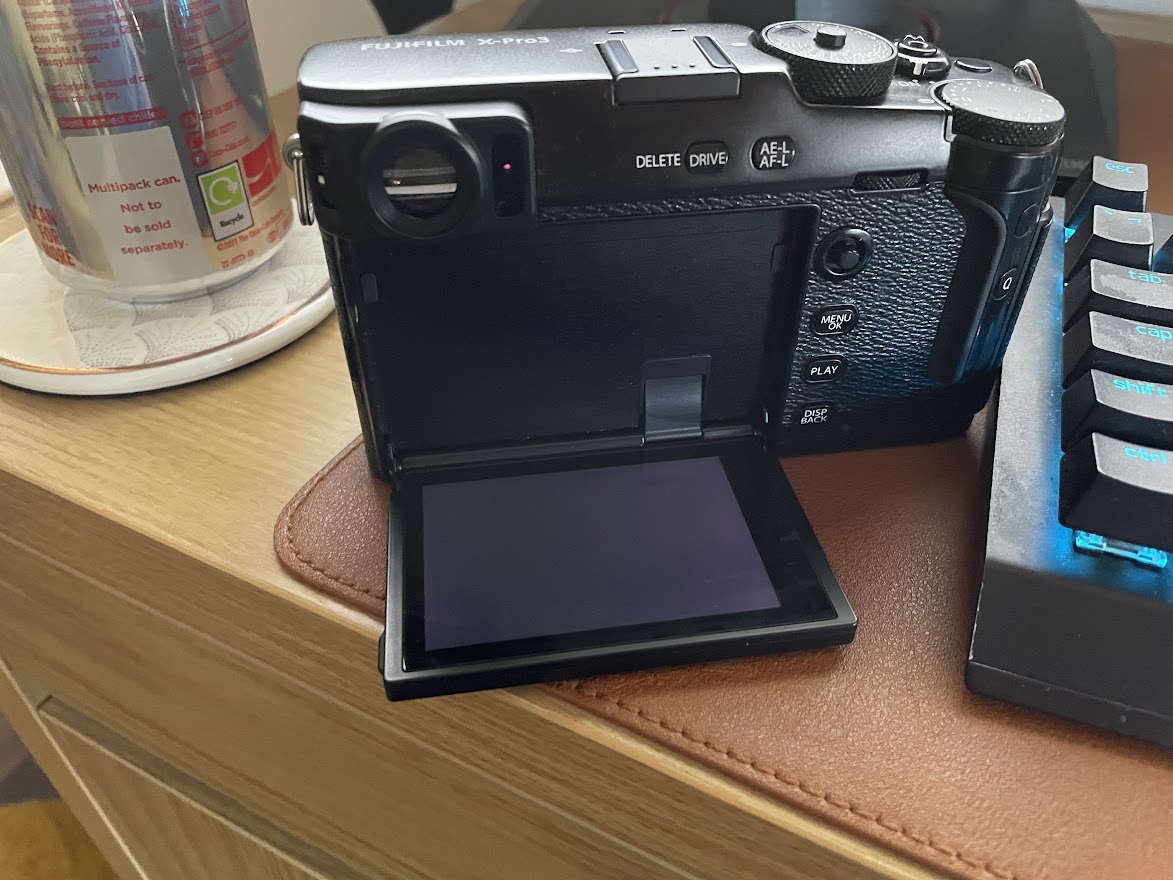

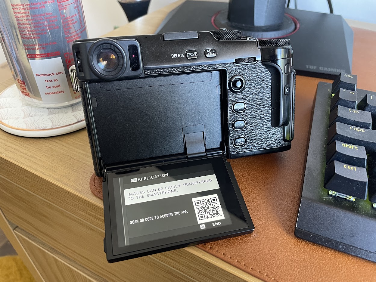

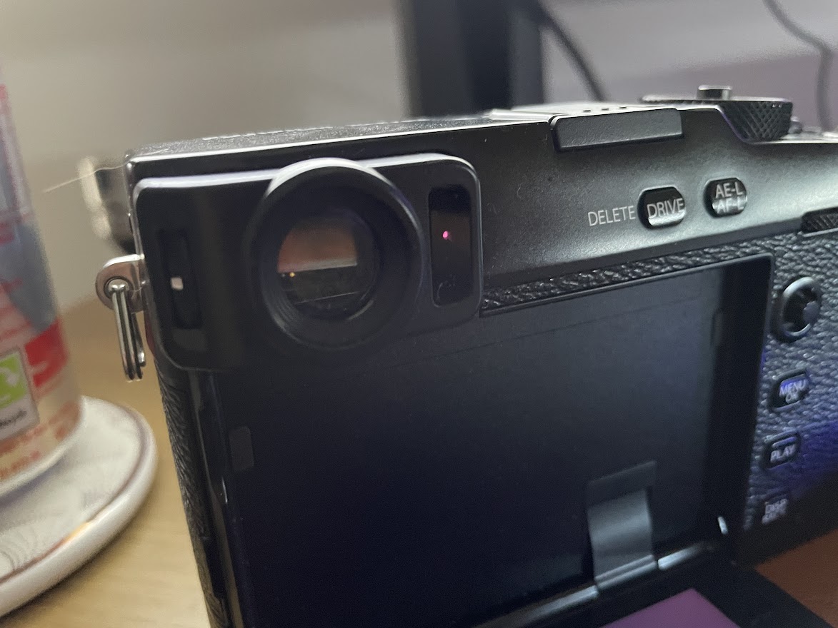

    I recently got a Fujifilm X-Pro 3 body and am having some problems with it. At first it wasn't turning on at all, with the only option was to go into firmware upgrade mode. I have upgraded the firmware to 2.00 and it does boot succesfully now. However, after going through the time and date setting, pressing OK or back turns the screen to black and opens the viewfinder.
    Turning off and on again leads me through the same steps and the same outcome. I've tried using two new batteries as well, with no avail.
    I'm not sure if this is still firmware related or a hardware issue. Is it possible this occurs from trying to use the camera without a lens?
    I've attached a few photos below.

        It did reset to default after the firmware upgrade, but I cannot get past this screen and into the menu to do another factory reset. I could not find a way to reset this outside of camera settings, like a combination of buttons or battery removal.

                Thank you for your suggestions, although there is no difference. Here are my findings:
                I have gotten a Meike 35mm lens to test, no difference. Firmware upgrade menu still shows 2.00 with lens on. Also, beforehand it was 1.33, so not too old.
                It does not revert back to the time/date menu, it opens directly on the QR code.
                With an SD card, there is also no difference.
                Re-flashing is not possible as it simply tells me it has the same or newer firmware already (tried SD card with 2.00, 1.33 and 1.01).
                I will post a video on what happens exactly when I press OK or back.

                  What happens when you scan the QR code with your cell phone? Does it try to establish a connection?
