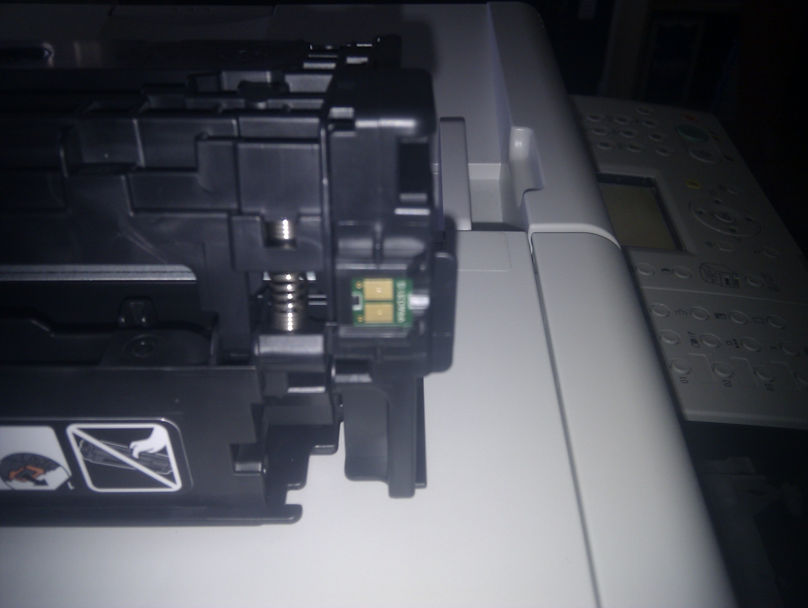

    Bought this canon printer a while ago and its been working great apart from maybe a bit slow, anyways on to the problem. Yesterday it started to complain about the black toner being empty. So i did what usually works for other printers, take it out, shake it a bit and put it back in. Only takes a few seconds then it says the same thing.
    Thing is i looked at what have been printed since it was bought, about 400 papers in b/w and 200 in color. The black toner is rated at 2300 @ 5% coverage. Its mainly text beeing printed on this printer, a few emails and stuff. Is there anyone that know of a way to reset the counter or fool the counter in any way, maybe have a service manual or something? Id like to use up whatever toner is there. Think its a total ripoff these new printers have this function, especially when it cant count even close to correctly.
    If you do the open/shake routine you can sometimes get it to print one paper before it says its empty again, and those prints looks just fine so i know its not empty. Already ordered a new toner for whenever its really empty.

              Re: Problem with Canon MF8050cn Laser Printer
              Tried some hard shaking now, didnt work, took a pic of the chip thingy. Sorry for bad pic quality, just took it with my phone since that what i had availible at the time. Come to think of it the chip looks similar to whats on the canon inkjet printers. And i actually remember canon replacing a cartridge for them once when a brand new cartridge said empty (used to work in a computer store). Anyways here is the link for buying the chips, the particular auction is with toner but they sell them without toner as well.
              http://cgi.ebay.com.sg/Canon-MF8050-...-/160426260298
              The I2C writing sounds interesting, maybe ill just put in the new toner when it arrives and start playing around with the old one then, should get the new one tomorrow.

                    • 31260
                    some new stuff only has 2 contacts - i think they must use the I-button 2-wire prototcol with parasitic power.
                    there's loads of free data & utility's for this but you need to build a programmer that pulses the data line with a high current.

                              Well, today i got the new toner so the printer is up and running again without having to open and close the door for the toner to get a print done. Had a closer look on the chip thingy and its just two contacts on a double sided pcb. On the backside they hide some chip under a black blob of some kind, anyone know how you can easily remove the blob without damaging anything to find out what chip it might be?
                                • 31260
                                you dont, the chip is bare silicon - no resin package.
                                • digge
                                  • Apr 2006
                                  • 296
                                  Ok, mean one have to take a guess of whats in there and hope you don't fry it then It'll be a while before i get to it, a friends computer came in between and needs fixing.
                                    • 31260
                                    meter the resistance between the metal framework and the 2 contacts in the printer.
                                    if your lucky you will find a ground.
                                    then you just need to built an atmel 2-wire interface.

                                      The toner cartridge has a capacitive level-sensors. Placing a very small capacitor parallel is enough to simulate a full cartridge.
