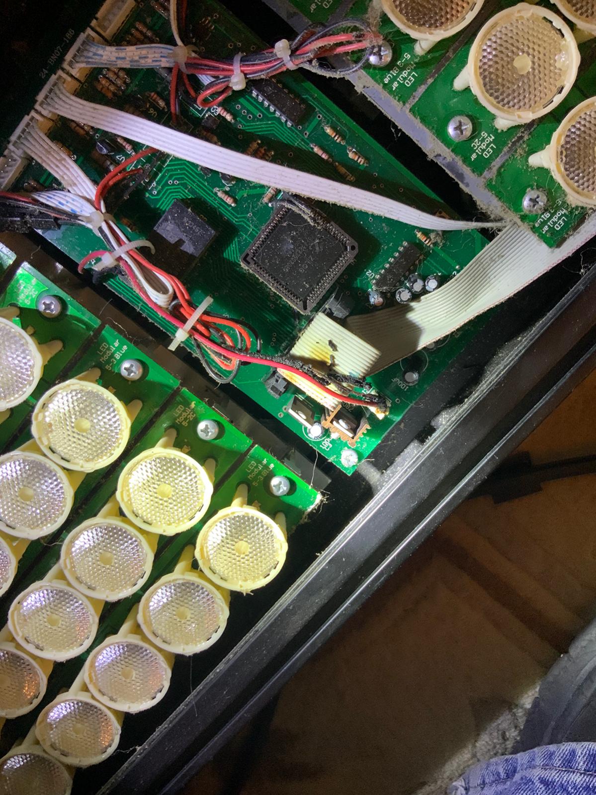

        OK, I cracked open the LED panel itself, which turned out to be only 4 screws then slide out the plastic that covers the LEDs and it exposes everything ... as you can see... I saw a problem immediately... You'll have to zoom in on the second picture to see it but the plastic on whatever that DC power connection is, is totally fried off of the wire though the wire is not disconnected.

          #64
          Re: Fish Tank LED Power Supply Gets Hot then shuts down
          looks like you found the very slow blow fuse .

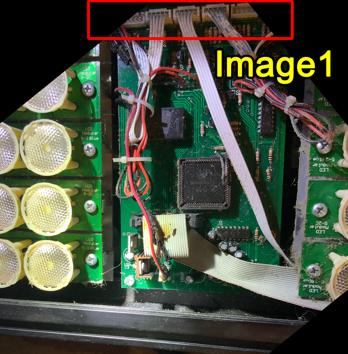

            #65
            Jokes ... love it!

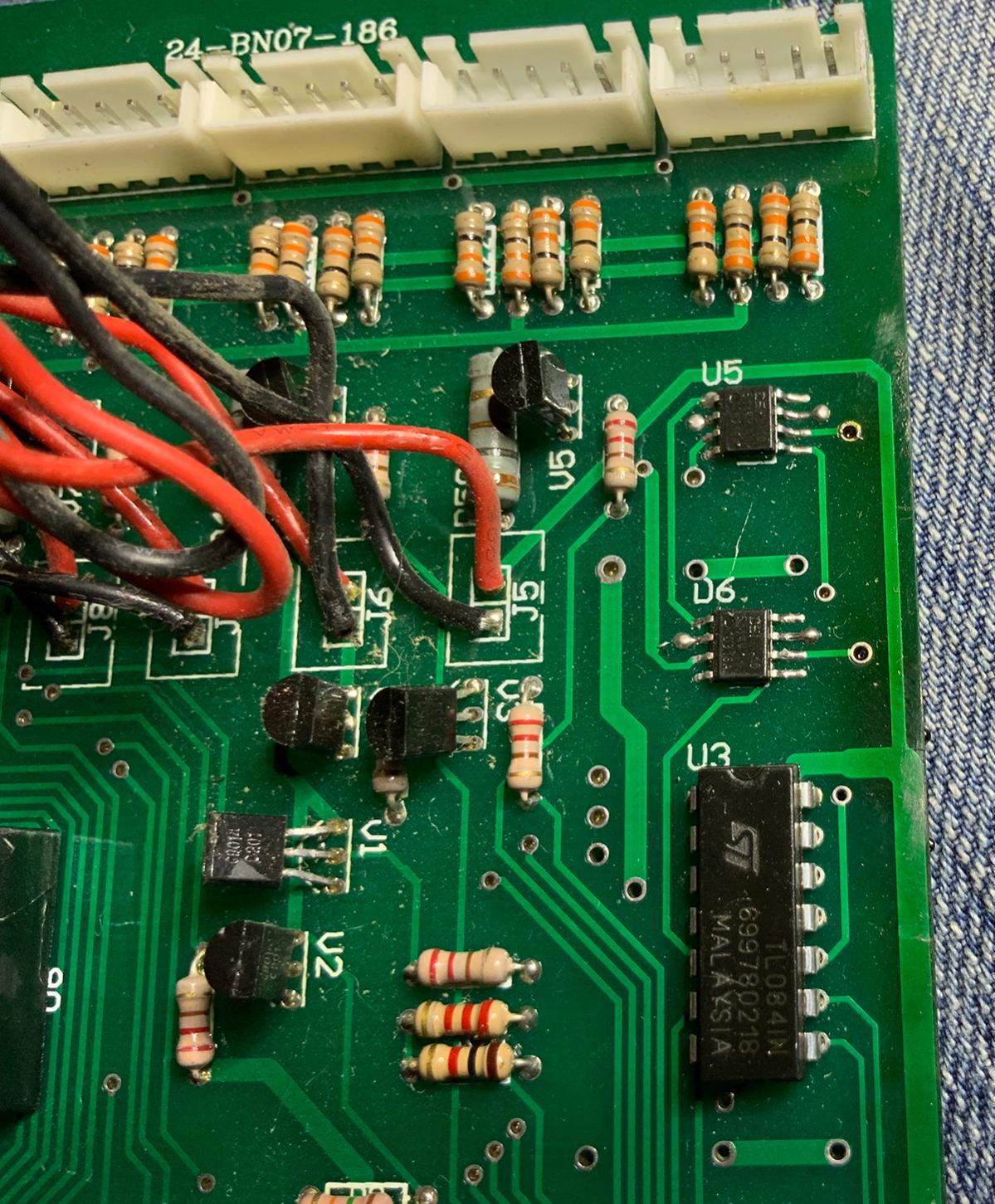

            Up next ... I removed the circuit board and there are some interesting places on the board with obvious over heating ... even traces where the solder mask is burned off but not even near any component ... ill have pictures soon.
            sigpic
            • EasyGoing1
              Shock Therapist
              • Sep 2016
              • 977

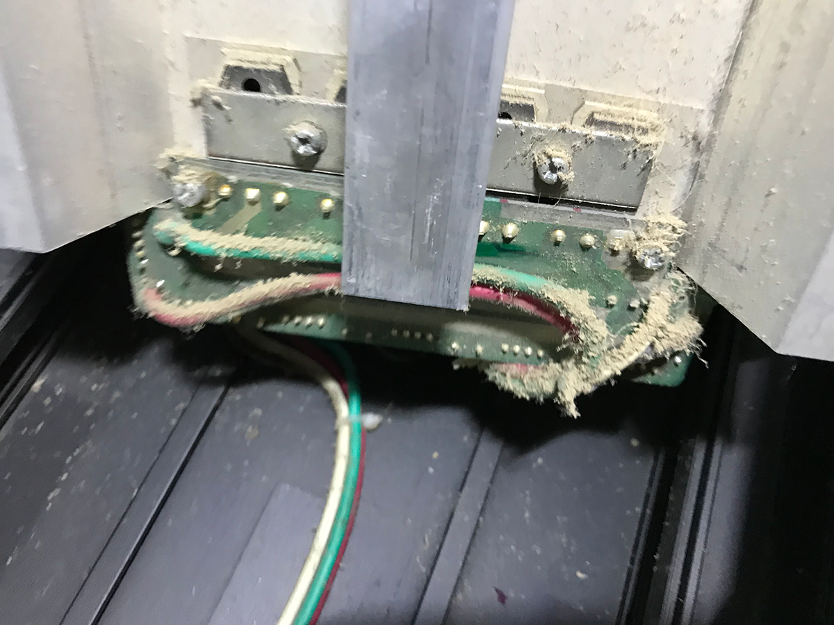

              #66
              So I took the circuit board out and as you can see ... several places got damaged by excessive current draw ... the side by side is the board flipped against itself so you can see that one side of the board got burnt while the other side didn't except in that one general area.
              The housing has FOUR fans, two on each end... the red and black wires connect those fans and thats all those wires do.
              Last edited by SMDFlea; 10-12-2022, 01:53 AM. Reason: copy images from imgur to badcaps
              sigpic

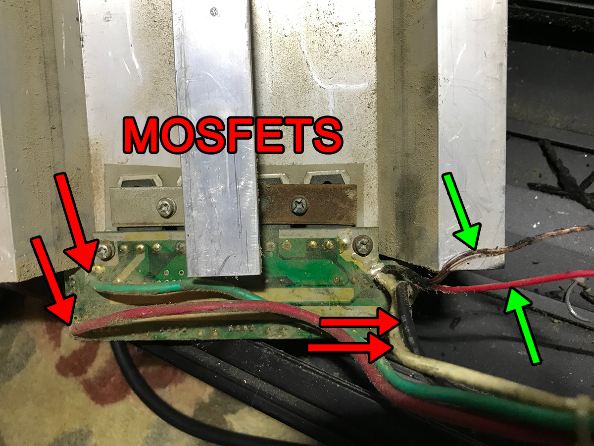

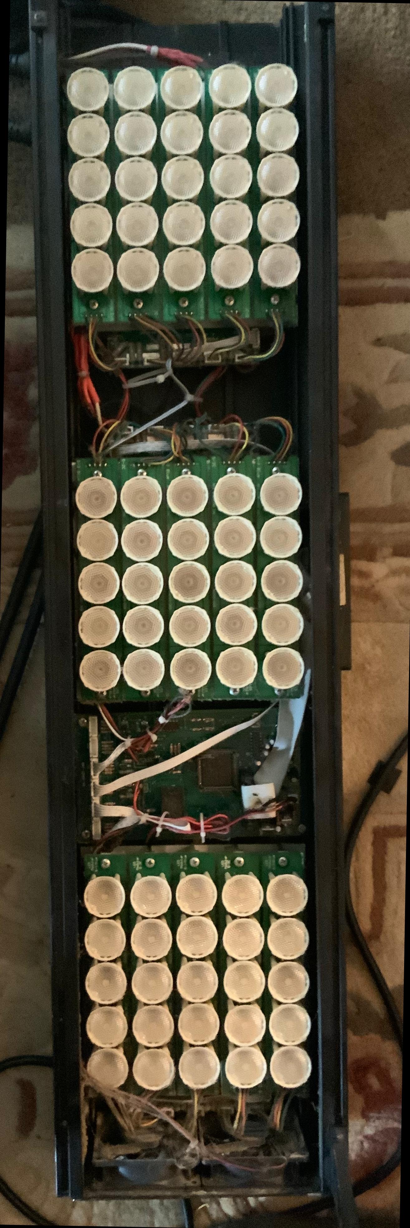

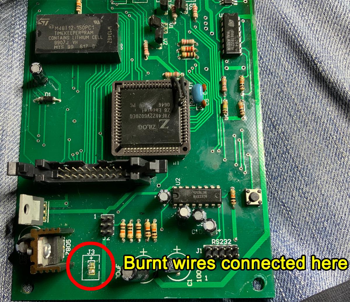

                      #70
                      OK, here's what I THINK is going on with this thing...
                      this image shows that there are THREE LED "Arrays" which consists of 5 rows of LEDs that are screwed down to a heat sink.
                      The wires that come in from the two PSUs are wired straight up to the circuit boards that are mounted next to each LED array. Then, we have this controller board...
                      That feeds each panel by those connectors at the top. ALSO, each panel has FOUR MOSFETS on the underside of the circuit boards attached to each panel and the top of those boards simply have what looks like 2 or 3 watt resistors ... something like 6 per board I think...
                      I BELIEVE - based on one of the chips I looked up, which was a PWM chip, that the LED panel MOSFETS are being fed a PWM voltage.
                      There is a wide connector that feeds the display / control screen, and a COM port that was unoccupied.
                      Heres where it gets kinda weird - at least to me it seems weird ...
                      The voltage that is powering the main controller board is taken from the end LED panel and it feeds directly into the input of a 7805 (which has burn marks on the PCB at its solder points) and THOSE are the wires that got their sheathing melted off. And take a look at these two MOSFETS where that power connection feeds from...
                      The red arrows point to the PSU wires and the two green arrows are pointing to those fried wires which are the power source for the controller board.
                      As you can see ... there is major discolleration at those two MOSFETS and it KIND OF LOOKS LIKE RUST TO ME like it got wet ...
                      Here is one of the other panels MOSFETS and you can see that they have no discoloration at all...
                      So this is where I'm not sure what to think ... clearly the main board was drawing too much power to that 5 volt regulator but yet the MOSFETS at that LED panel that feeds the power to the main board look suspect to me but they would have no role in powering the main board, they would only be powering the LED panel that they drive ...
                      So im not sure where to proceed from here...
                      sigpic
                        • 31303
                        #71
                        if the main board locks up the led panels could be 100% duty cycle instead of pwm.
                        if you isolate the controller and feed 9v into the regulator, does it output 5v? and how much current does it draw?
                        • redwire
                          • Dec 2010
                          • 3912
                          #72
                          J3 is just the DC input to the 7805 5V regulator. With the -ve black wire burning up I think would be caused by a ground fault.
                          So there is an overcurrent happening between the J3(GND) and power... somewhere. Guessing a fan or LED board or heatsink insulation failed and has shorted to power and the resulting high current is pulling ground return current through J3?
                          I would look for an open ground wire from the mosfets to the PSU.
                          Poke around with an ohmmeter and see if the mosfets are still insulated from the heatsink, ground wire did not go open-circuit etc.
                          It's a bit of a weird failure.

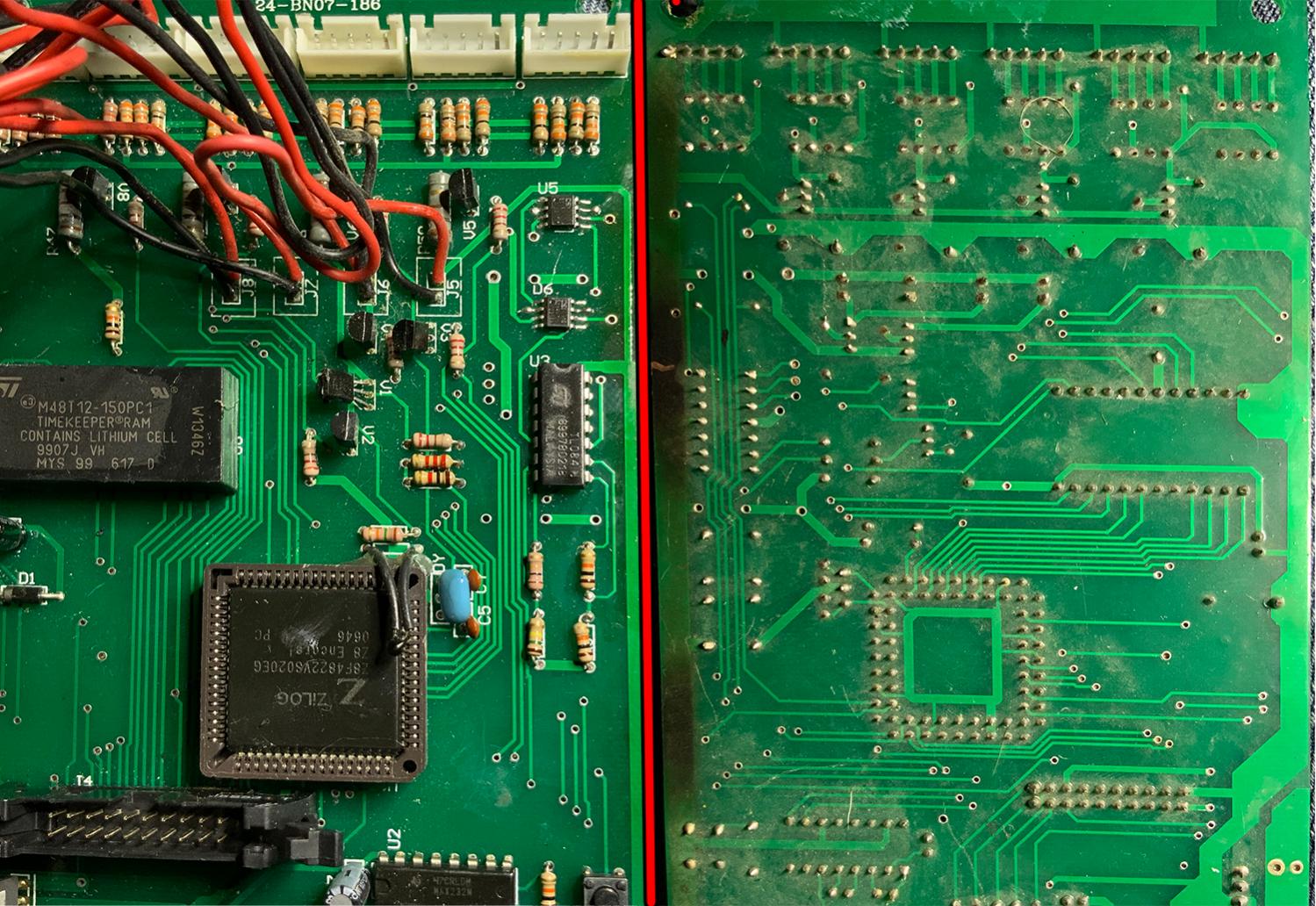

                              #74
                              OK, the MOSFETS are NOT shorted to their heat sink.
                              But what I find strange is that the red wire (the slow burning fuse) is actually soldered at the same point where the black wire is soldered coming from the PSU...and the ground wire (from the slow burning fuse) can be seen as the tip of the green arrow is touching it ...
                              I didn't see any kind of short at that circuit board, though with the wires having been melted, I can certainly see how the exposed wire could have been shorting but I didn't look for that before removing the wire from the main board and jostling it around.
                              The two red circles are the same solder point from opposite sides of the board
                              And NO, those white connectors next to the resistors never connected to anything ... in case you were wondering.

                                      #78
                                      I'm thinking +power goes to the LED's, so I would make sure the LED base is not shorted to the heatsink. Or an open high current ground wire/connection going back to the power supply. The red LED's don't seem to have insulated mounting screw holes on the PC board.
                                      The mosfets are on the low-side, switching to ground so a short (to heatsink) there would just give power all the time to the LED's, drain-gnd short.
