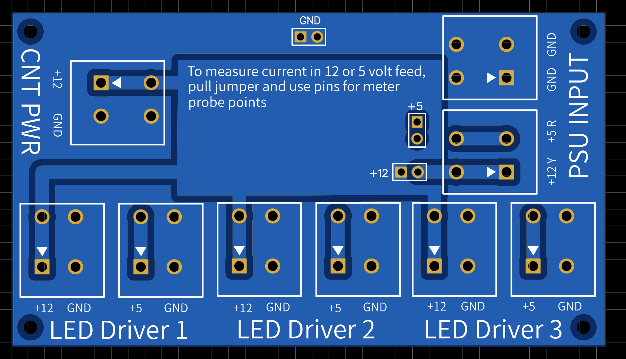

          Funny you mention that as about an hour ago I was contemplating whether or not I should replace the internal wiring, or at a minimum, everywhere there is exposed wire where it solders to a PCB (wires from the PSUs that is), remove the solder, clip the ends and re-strip them and re-solder.
          But, this is where I stop thinking that it had anything to do with the wiring at the three LED driver boards ... the burnt wire was burnt all the way from the LED driver board to where it connects on the main controller board, then we have burn marks along the main controller board ... so the actual source of the high current drain on that +12V line could not have been caused by any mishap with the wiring from the PSUs ... there had to be something on that controller board that was drawing too much current but I can't find anything that is not working on the main controller board and so ...
          I wonder if a situation like this happened...
          The light mounts to a large fish tank which means that condensation - especially when the unit is not powered on, is a high possibility ... so like what if they left the unit off for a long time ... maybe days ... and some condensation builds up on that main controller board and creates a temporary short somewhere on that board so that when the unit is then turned on, that short burns the board, melts the wire, damages the PSU and in all that chaos, the moisture that caused the short gets boiled off from the heat it caused.
          Then from that point forward, when they try to turn the unit on, it only turns on for a second or two and that damaged PSU goes into thermal over-heat protection mode or it just straight up stops providing power but remember the heat sinks in that PSU get too hot to touch within seconds after switching it on...
          But a temporary short would explain the high current while also not having any failed components on the main controller board.
          YES, the 7805 still gets hot, but that will be mitigated with the constant airflow going through the enclosure so that could actually be operating within design specs.
          It very well could be that the solution this whole time is just to replace the melted wire and the bad PSU.
          I'm pretty sure I could test this theory by testing the unit with only one LED panel at a time. After connecting one panel to the good PSU, and powering the controller board from my bench PSU, if everything checks out, then I swap that LED panel with the next one and test it, etc. until all three are tested and proven to be working.
          If that works, then I can take measurements to find out just how much current this damn thing really consumes and spec a power supply accordingly.
          Also, if it turns out that I'm right about how this unit failed in the first place, I do want to replace the two power supplies with a single power supply and mount some kind of wire distribution panel inside the enclosure where the one PSU feeds that panel and then it breaks out to the driver boards and the controller board.
          This PCB I threw together could work for that distribution panel and it only costs $22 delivered within 5 days. I could also add jumper points and include an inline fuse for both the 5 and the 12 volt lines and mount the fuses on the outside of the enclosure so they would be easy to replace if they blew. The current measuring points was just an idea I had ... not sure if Id keep that or not, but certainly would use a similar layout for the fuse idea.
          Here is a 3D view
          sigpic

            A large number of wires just soldered onto the board is sloppy design especially if it's not restrained from movement, even if it wasn't intended for movement. Shipping is movement...
            • EasyGoing1
              Shock Therapist
              • Sep 2016
              • 977
              #146
              Re: Fish Tank LED Power Supply Gets Hot then shuts down
              The alternative is solder and heat shrink and making cables that have to split into many directions using that method is less than ideal. Also, those connectors that I have that solder directly to the circuit board have grabbing strength that is extremely strong. I think they could easily withstand 50 lbs of tugging force or more. I've tried pulling wire out of them manually before and I couldn't do it.
