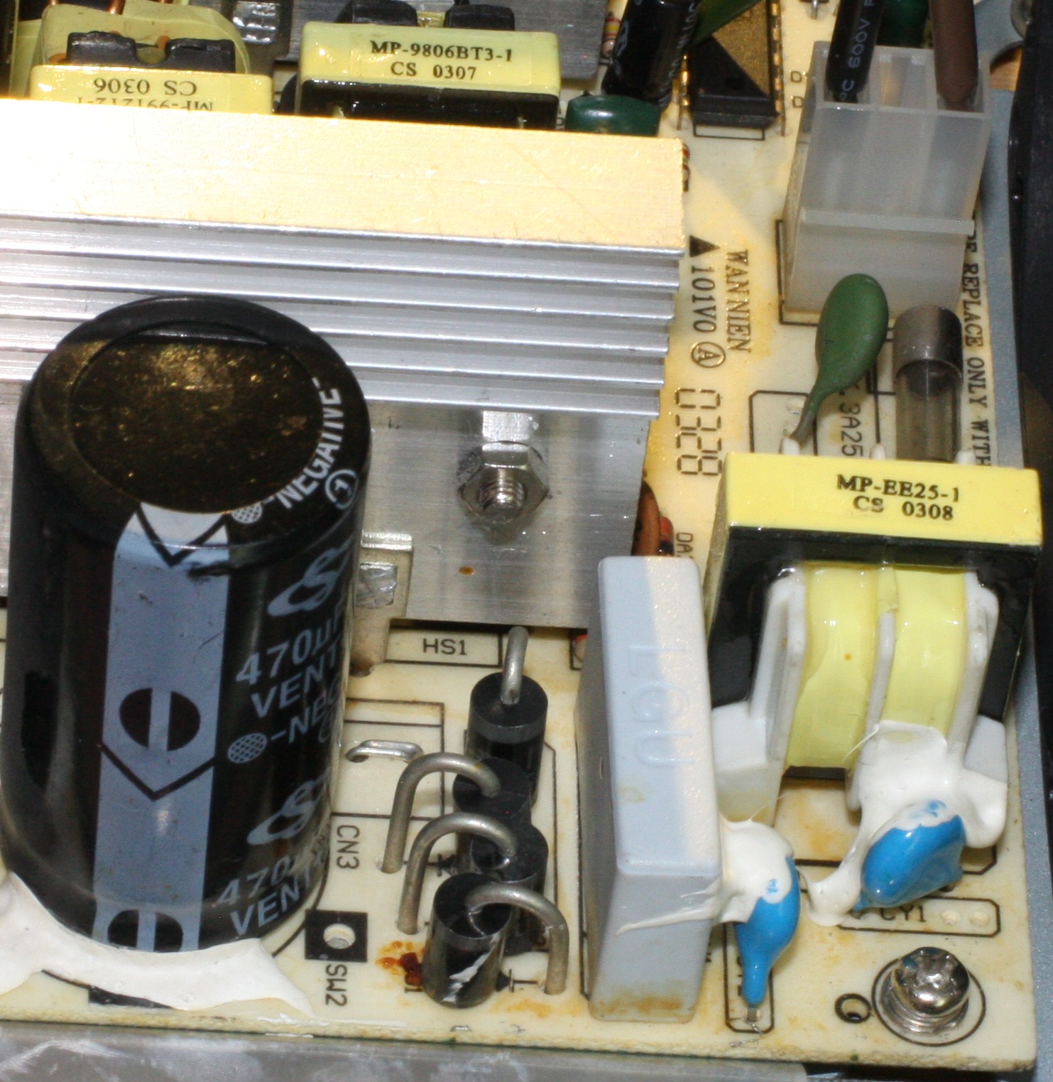

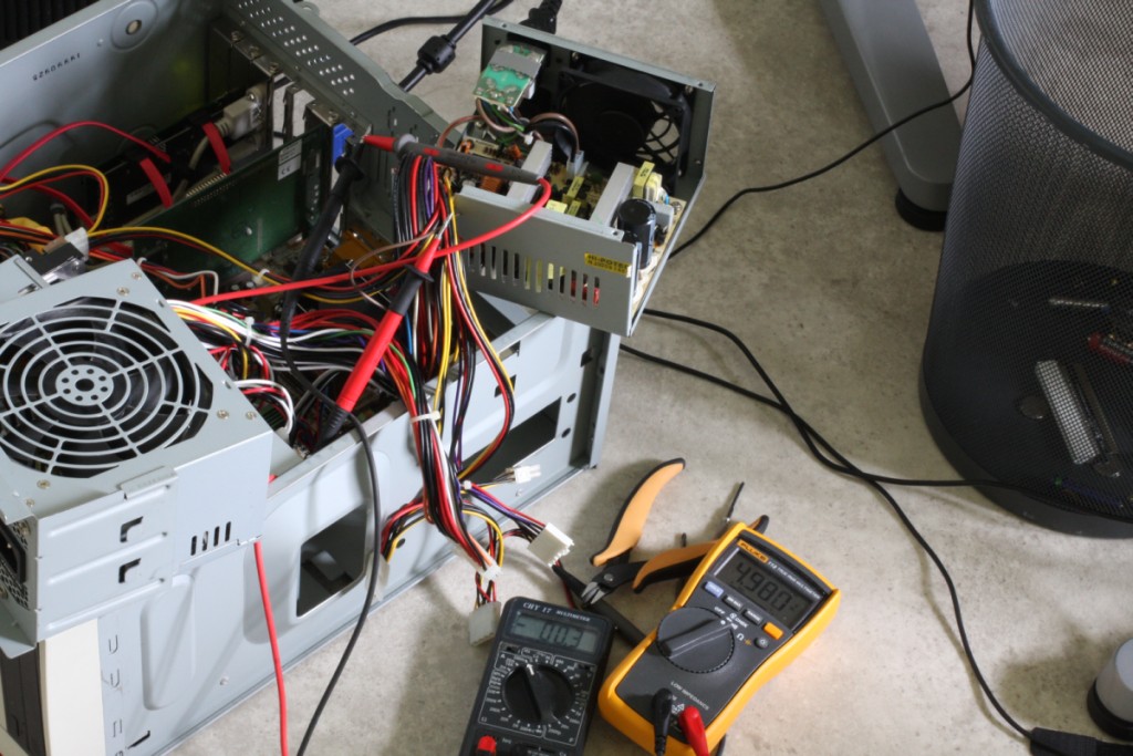

          Ok, I fixed the PSU, it was easy
          2x 2200uF 10v bulging caps on 5VSB secondary side, replaced with 2x Rubycon 3300uF 6.3v MBZ
          (My rubies are getting kind of old so want to use up my stock, otherwise such a nice cap would have never gone into this thing )
          When the computer is soft-off it draws 1.5A from 5VSB
          When I start it this drops to 0.3A
          When I enter S3 standby mode it also draws 1.5A
          If I remove the NIC cable it draws 0.2A less in soft-off and standby, while running there is no difference...
          I tried disconnecting 5VSB when the computer was running
          I lost the VGA output and the CPU fan turned off but the system was still running, because my power meter showed 81w... The PSU fan was on aswell... (When running idle it draws 77w which seems to be correct, because 0.3A x 5v = 1.5w + the CPU fan)
          So I don't know what it uses 5VSB for while running but it seems to be something crucial
          Also I was pinging the computer from another computer over the network and it stopped replying as soon as 5VSB was gone, however the NIC LED's where still lit...
          The 5VSB was very stable after my 8 year old Rubycon caps had a little time to warm up
          It was at 4.0v first but I left it plugged in for 10 minutes and then it had risen to 4.97v
          And it keeps this voltage stable in a transient test going from running in idle to standby mode (I don't have an oscilloscope though)
          As for the original caps what are they, that S logo inside an eye?

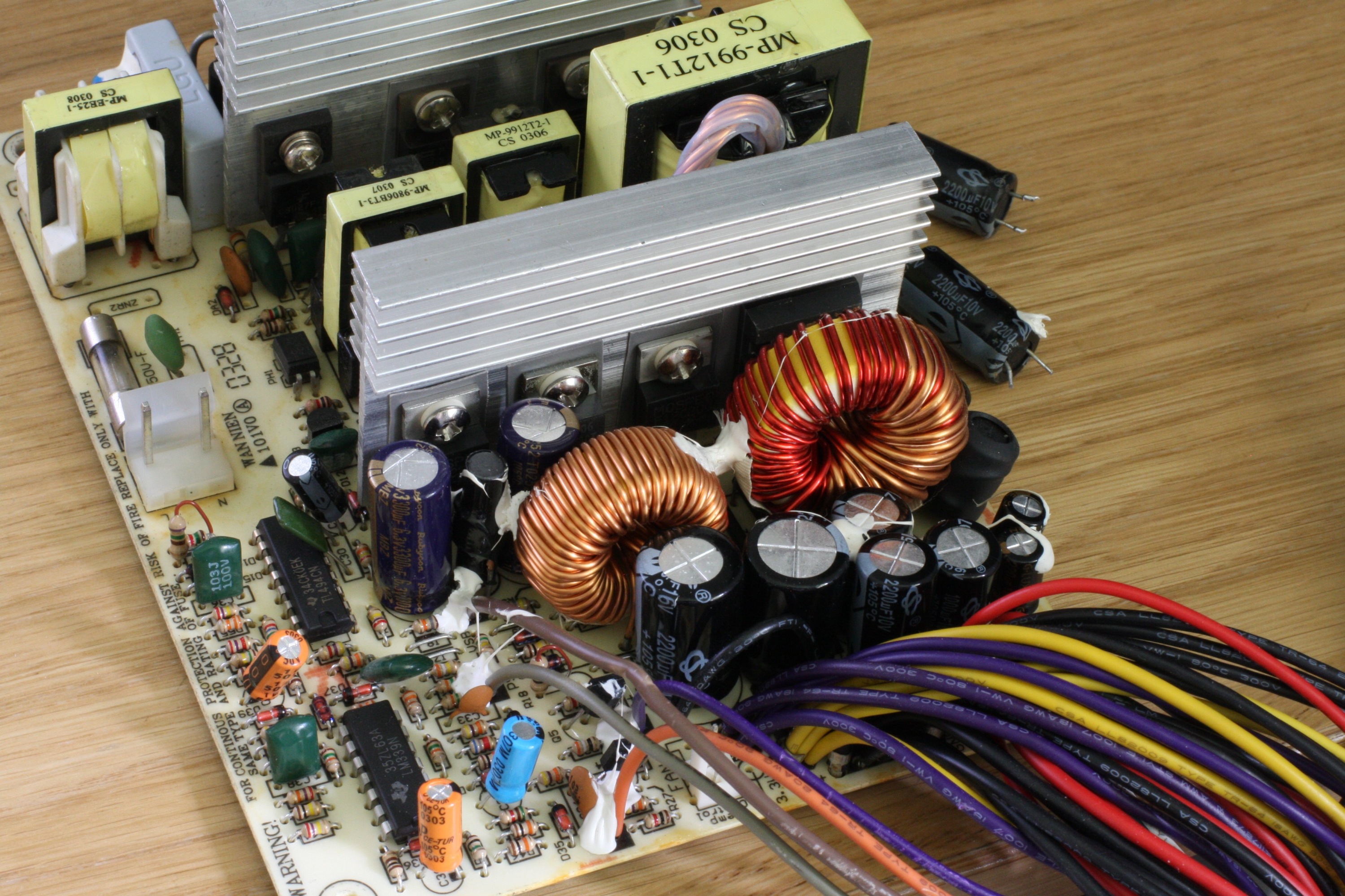

          As for the PSU this is how it looks, not half bad actually
          Good input filtering (there is extra filtering on a small PCB behind the power receptable aswell, consisting of 2x Y caps, a Ferrite coil and an X cap)

            Re: Operation of the 5VSB system?
            Those are CS caps, known crap brand.
            I recommended to replace all of them. They've much leakage when they failed then cause silicon blown out.
              This is a macron power mpt-301, a very good 300watt psu.
              I have a unit like that that had bulging primary 680uF cs caps.
              https://www.badcaps.net/forum/showpo...86&postcount=3
              My psu also has a bridge rectifier of 6 A, not 4 diodes and larger 13009 primary transistors. It has mov too...
              I replaced all caps with panasonic and rubycons and the psu works like a charm.
              https://www.badcaps.net/forum/showpo...5&postcount=48
              I think Rubycon MBZ are a bit too low esr for psu.
              About the "CS" caps... http://capacitor.web.fc2.com/
              website: http://www.12kj.com/

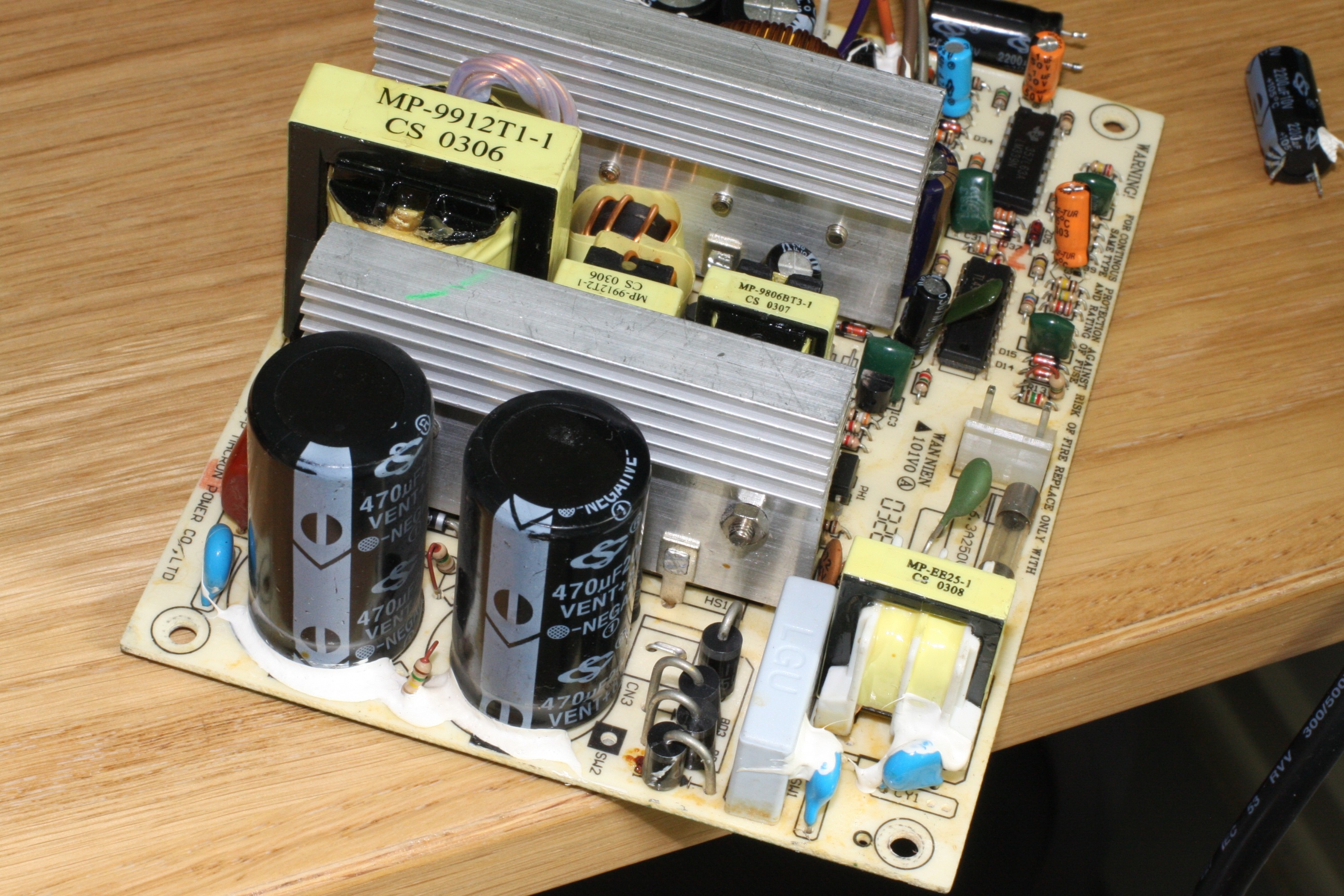

                Thanks for your replies POM_MJ and goodpsusearch
                I will keep this as a PSU for testing only, not for usage, would it see usage I would for sure do a full recap
                Anyway I noticed for example on POM_MJ's PSU there is the 115/230v selector switch, mine omits this switch (fixed @ 230VAC)
                Also I see where the PFC coil is supposed to be placed on my PCB, CN3 in the attached photo (The selector switch cables go here to SW2 and SW1 hidden between the furthermost Y capacitor and the coil behind it, what does that coil do btw, just noise supression?)
                It will be a good test PSU "for that other thread" if I ever find a PFC coil
                Also it would be fun to try and design a safe 5VSB circuit for this PSU, which if I'm not completely off my base uses a two transistor design?
                Lastly in the other pic you can see my über safe testing environment
                  The coil labelled MP-EE25-1 and CX,CY is transient filter to separate noise between AC line and high voltage side of the PSU.
                  to mod 5VSB circuit, see Bestec ATX250-12E up and running! by everell, he's an expert.

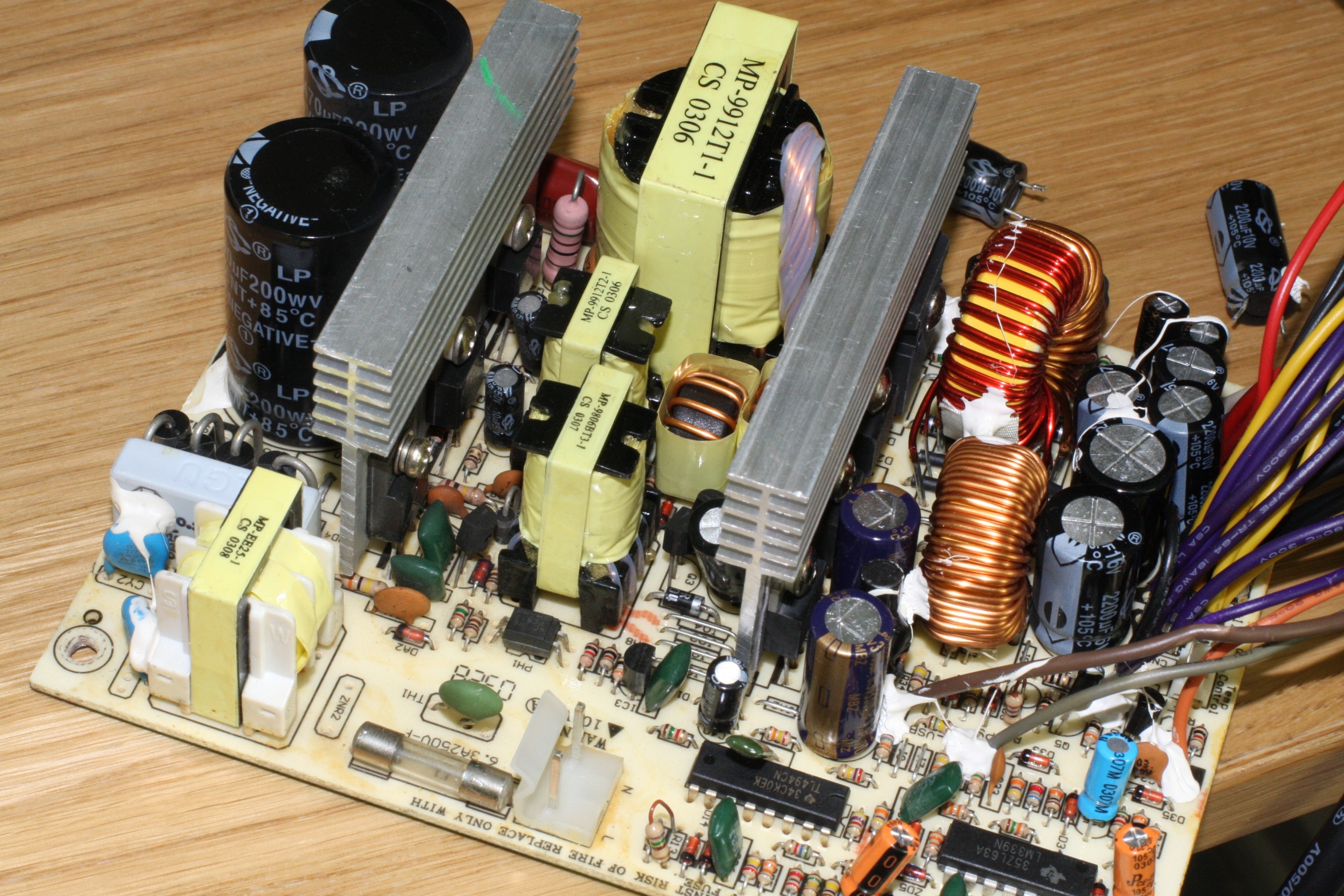

                        Btw, that transistor on the right of the 5VSB transformer, is this also part of this circuit?
                          I also have a Macron Power mpt-301. Just recapped it about a month ago.
                          While it does seem to use a 2-transistor 5vsb design, I was not able to locate the so-called "critical cap". There are a bunch of 10uF caps on the secondary, but I don't think those are it. Perhaps it's a modified 2-transistor design? In most other 2-transistor designs I've seen, the critical cap is always on the primary side near the 5vsb transformer.
                          As for the transistor on the right of the 5vsb transformer - from what I remember, that was just part of the feedback loop for 5vsb.
                          By the way, if you're fixing this PSU, you might also want to change the loading resistors on the 3.3v and 5v rails. Mine had a 10 Ohm on 3.3v, and a 25 Ohm on 5v - that's almost 2W of heat being dissipated, and it's pretty close to the caps, too. I put the 25 Ohm on the 3.3v and a 100 Ohm (from another PSU) on the 5v.
                            Thanks for the input momaka, but look in the picture 370forlife posted
                            Right above the two circled transistors there sits two capacitors, right by the 5VSB transformer
                            10uF 50v, don't you think those are it?
                                      Nope, those caps are part of the driving circuit for the transistors on the primary.
                                      When I was recapping mine, I did actually trace the whole 5vsb circuit but was not able to find a critical cap. There are two polyester film caps in that area, though - perhaps one of them might be it (but I'm not sure)? Maybe Everell knows, he's an expert on those 5vsb circuits (and PSUs in general ).
