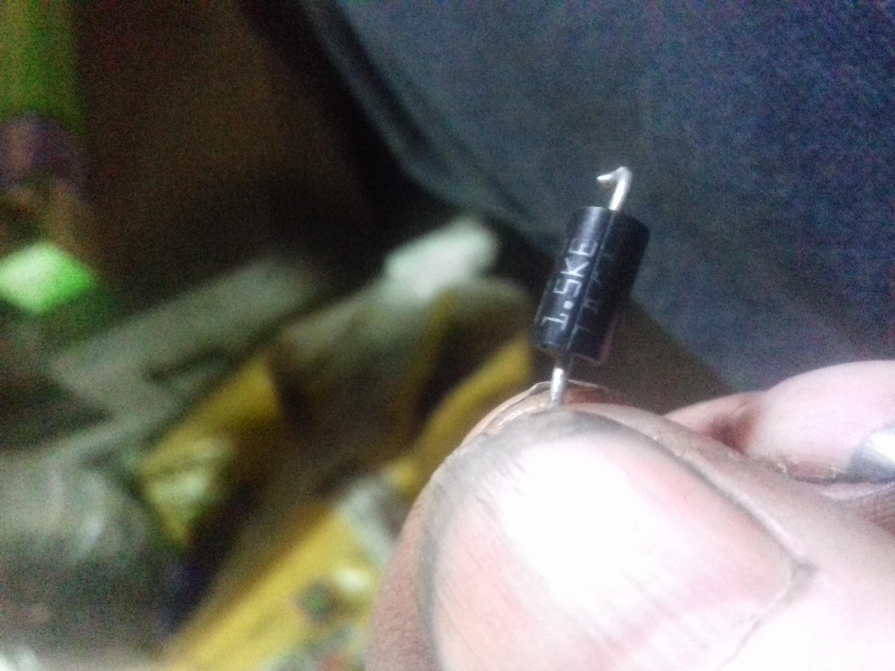

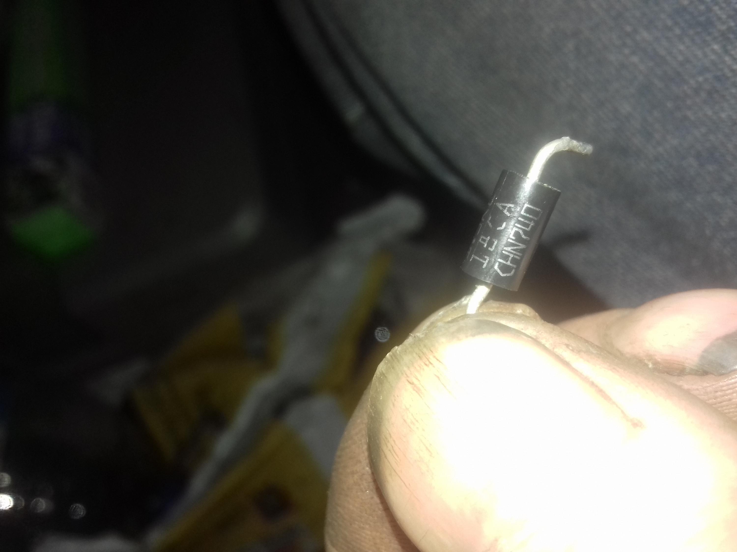

what is this symbol on tvs diode ?
  • petehall347
    • Jan 2015
    • 4427
    • United Kingdom
    can't figure out this strange symbol
    can see its a 1.5ke series but its the next bit . 1?ca .. is it an 8 i wonder ?
  • R_J
    • Jun 2012
    • 9551
    Re: what is this symbol on tvs diode ?
    likely 1.5KE18CA
    • petehall347
      • Jan 2015
      • 4427
      • United Kingdom
      Originally posted by R_J
      likely 1.5KE18CA
      that's what i was thinking thanks
      • CapLeaker
        Leaking Member
        • Dec 2014
        • 8199
        Just this one is bi-directional, since the band on on side of the diode is missing.
        • petehall347
          • Jan 2015
          • 4427
          • United Kingdom
          1.5KE18CA is bi-directional, according to the datasheet .
          • CapLeaker
            Leaking Member
            • Dec 2014
            • 8199
            I didn't look at the datasheet, as I just looked at your pics and noticed no bands and nothing was mentioned. Carry on! :-D
