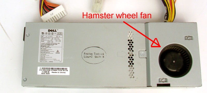

                Re: Dell GX270 Power Supplies
                GX270 PSUs have a hamster wheel fan, not a standard one, so finding a replacment may not be easy. The last GX270 PSU I opened had a nidec fan, so it kind of surprises me that it failed here.
                  i thought the hamster wheel was the case fan in the slimmer units...
                        Here's a GX270 PSU.
                          They're called squirrel cage fans... or, more appropriately, centrifugal blowers - http://en.wikipedia.org/wiki/Centrifugal_fan
                          c_hegge - that's not the only type of PSU used in the GX270's. The smallest ones had a standard bladed fan.
                            I know what they're really called. I just call them that because they look like a hamster wheel.
                            What I didn't know is that there was more than one type of GX270 PSU as the one I posted before is the only type I've ever seen or heard of.
