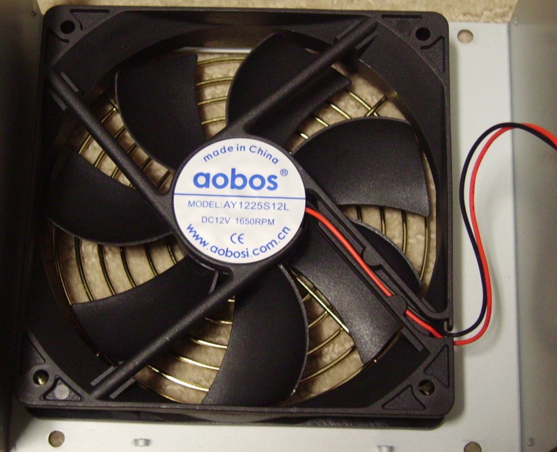

    those caps SUCK! what brand fan?
      I know BH caps are bad. I can't remember the brand of fan. probably some off-brand.

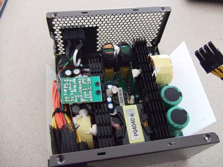

                  Solytech owns deer now. It's now called the "deer group" consisting of Deer computer, Solytech Enterprises, and Apex.
                  This is what you get from solytech if you pay a bit more:
                  It's even 80plus silver with teapo secondaries.

                    ^that doesn't even look too bad oO

                      Re: Aywun PSUs. Anyone here heard of them?
                      Voltage regulation is really nice. Barely missed 80plus gold.
                        WHAT? 86 - 89% efficiency... on 120V ? omfg
                        makes me wonder what it could do on 230V then

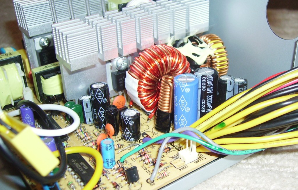

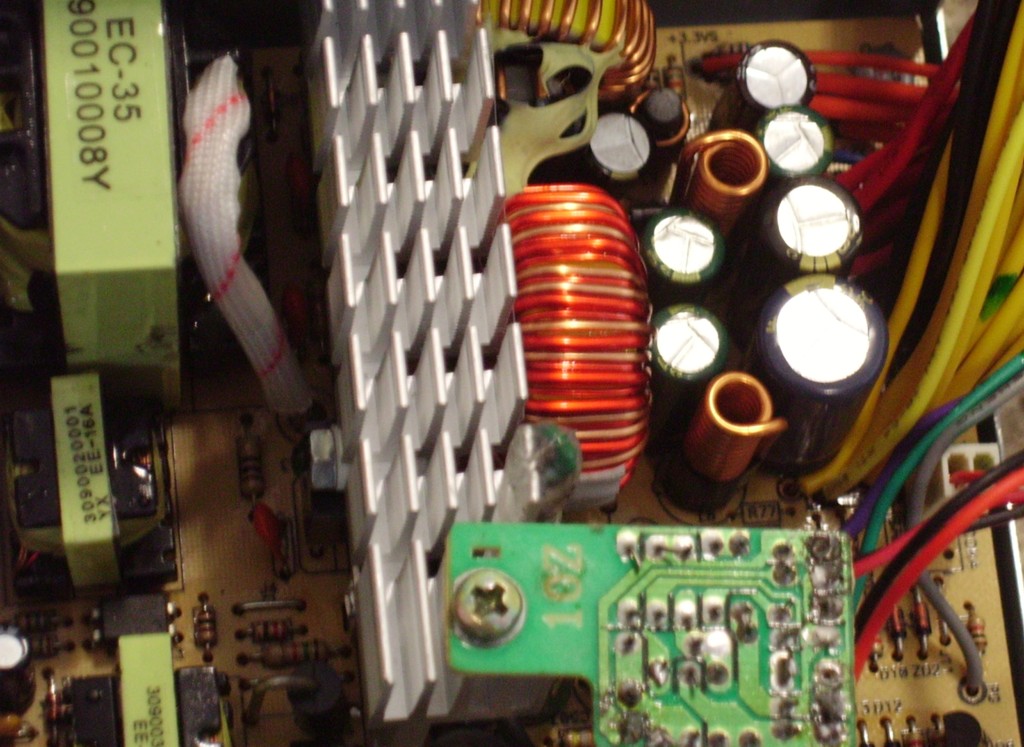

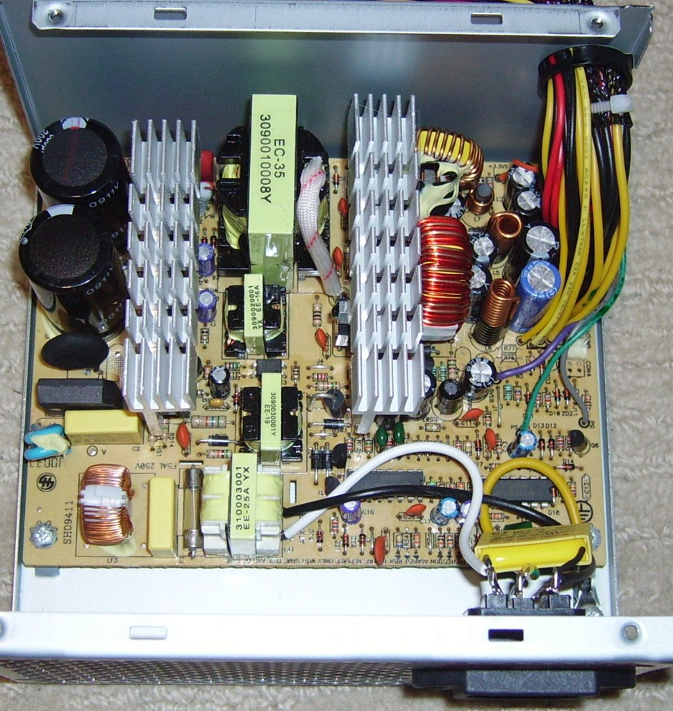

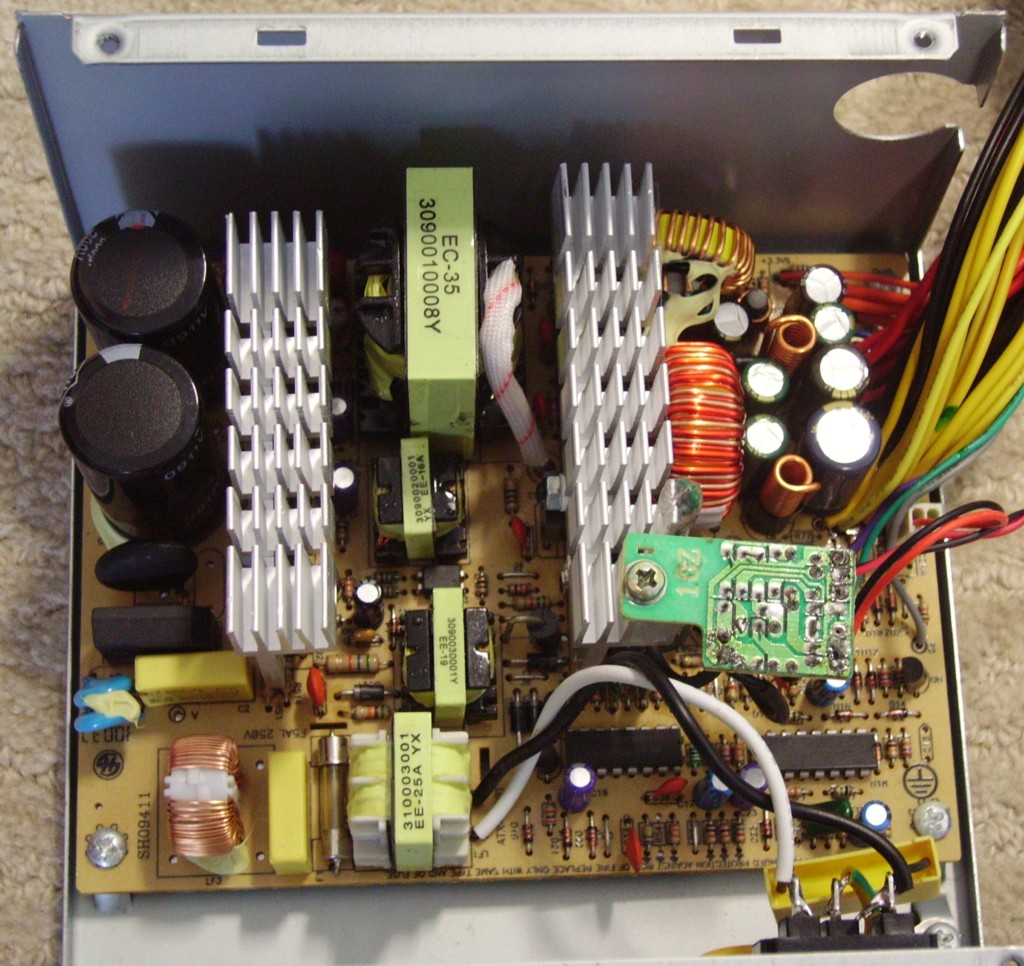

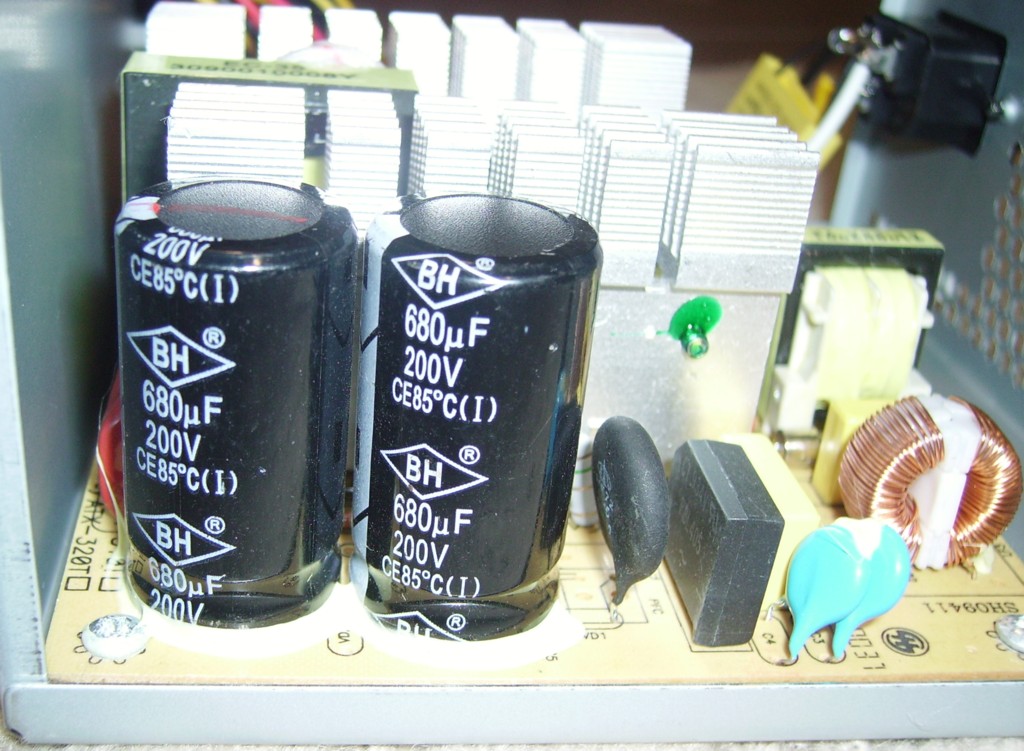

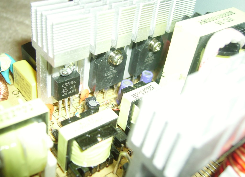

                            Picturres
                            OK I took one home today. Here are some inside pictures. The rectifier is a 4A. Thie two smaller transformers look a bit smaller in this unit that they did on the other one I opened, but the main transformer is still more beefy than what I see on really cheap no-name PSUs. They usually sell for around $40 AUD. There's also an A1-3000 (420W) and an A1-2000 (320W).
                            What do you guys think? A Keeper after a re-cap or throwaway junk? ALso, What wattage do you think it could manage?
                              The heatsinks and output rectifiers (particularly the +12V one), as well as the 200V input capacitors are a bit small for this wattage.
                              I also saw a 450W power supply (new) for only AU$30! - it was not going to be used anywhere near its maximum output, and the heatsinks were a bit small.
                              That goes to show you only get what you pay for...
                                reminds me of the Yuelin-based "powork"..
                                http://www.jonnyguru.com/modules.php...Story3&reid=71
                                i'd say it's a ~ 300W (maybe 350W) keeper with new caps.
                                seems to be a 3.3/5V heavy ATX 1.3 unit with 12V being overrated to calculate up to 500W on the label (imho)
                                  It looks like a keerda, same people behind logisys. Really dosen't look that bad, I see two diode packs on the 12v rail which is favorable. Heatsinks/primary switchers/transformer looks beefy enough for a 300-350W load.
                                    I replaced the caps with the following
                                    1x 1000uF 10v -> 1000uF 6.3v NCC KZE (salvaged from dead motherboard)
                                    4x 1000uF 16v -> 1000uF 16v Sanyo WF (salvaged from dead motherboard)
                                    2x 470uF 16v -> 470uF 16v Panny FM (new)
                                    1x 3300uF 6.3v -> 3300uF 6.3v Panny FJ (new)
                                    2x 2200uF 16v -> 2200uF 16v Panny FC (new)
                                    I have also added a fan controller salvaged from a dead PSU.

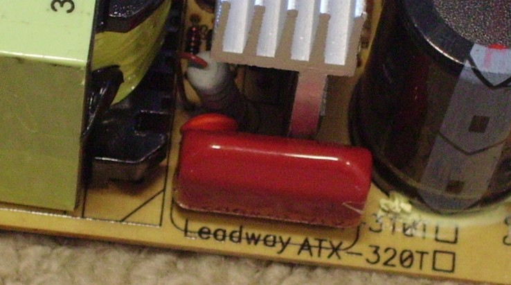

                                      I think I might have found the OEM. Leadway Electronics.
                                      http://www.meijipower.com/en/product...yId=161&page=1
                                      EDIT: Leadway = Meiji
                                        ATX-320T ... probably the wattage.
                                        if so, it seems like i wasn't too far off with the guessed ratings in post #16
