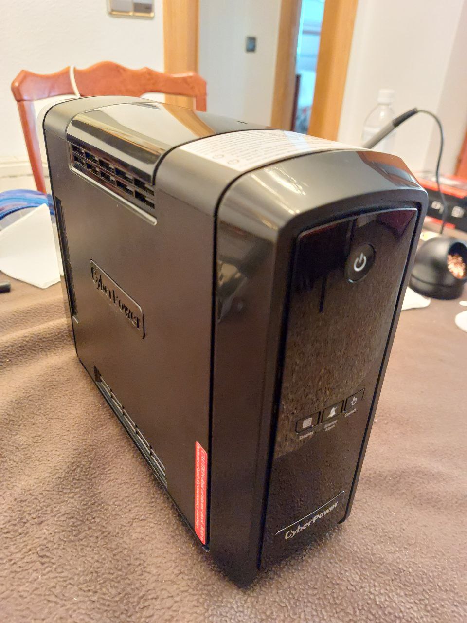

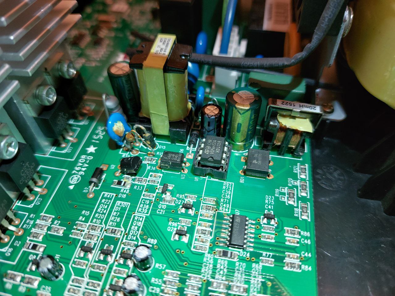

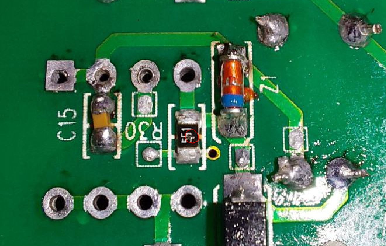

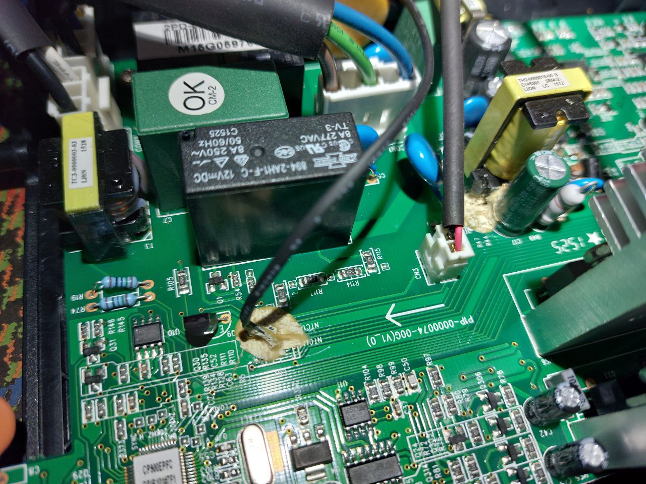

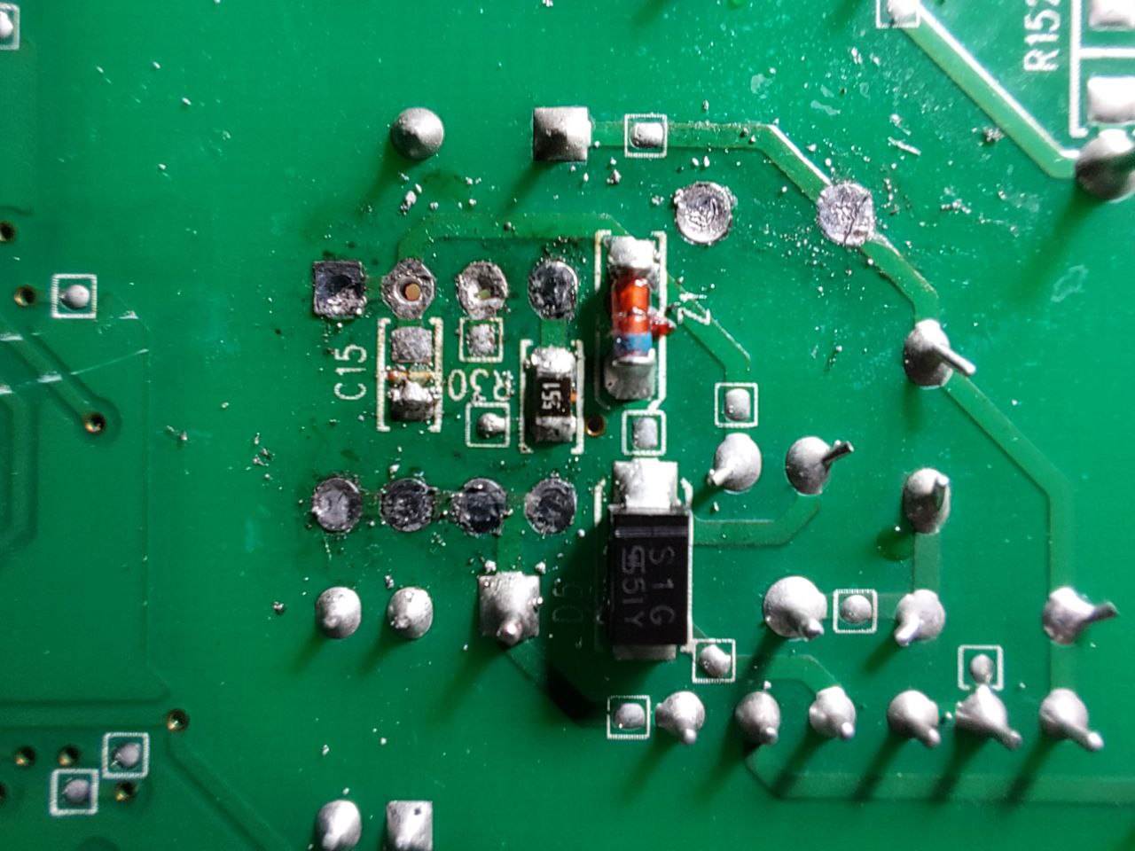

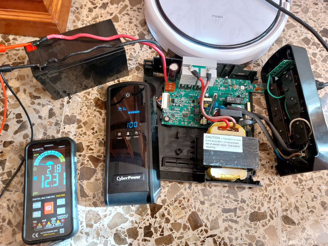

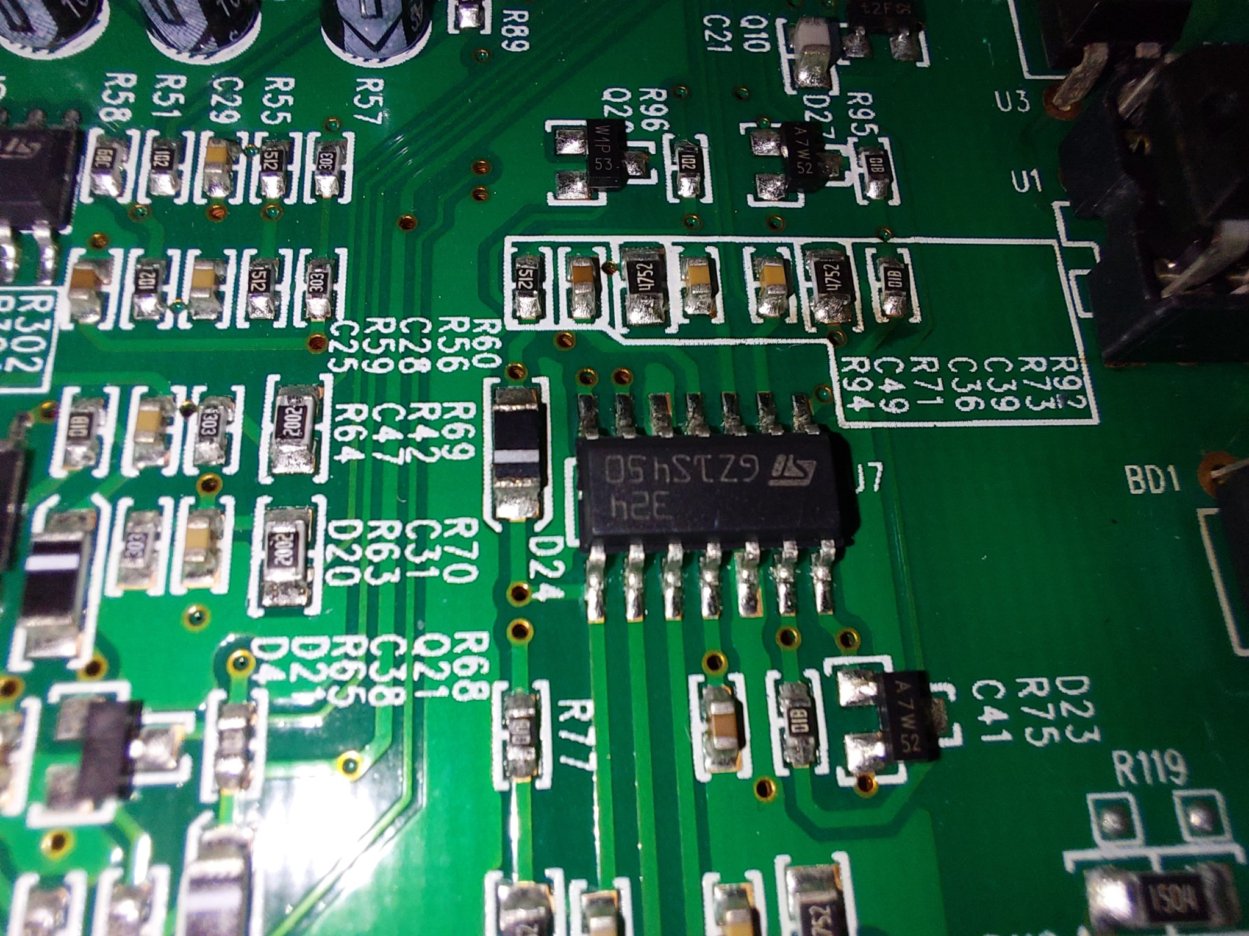

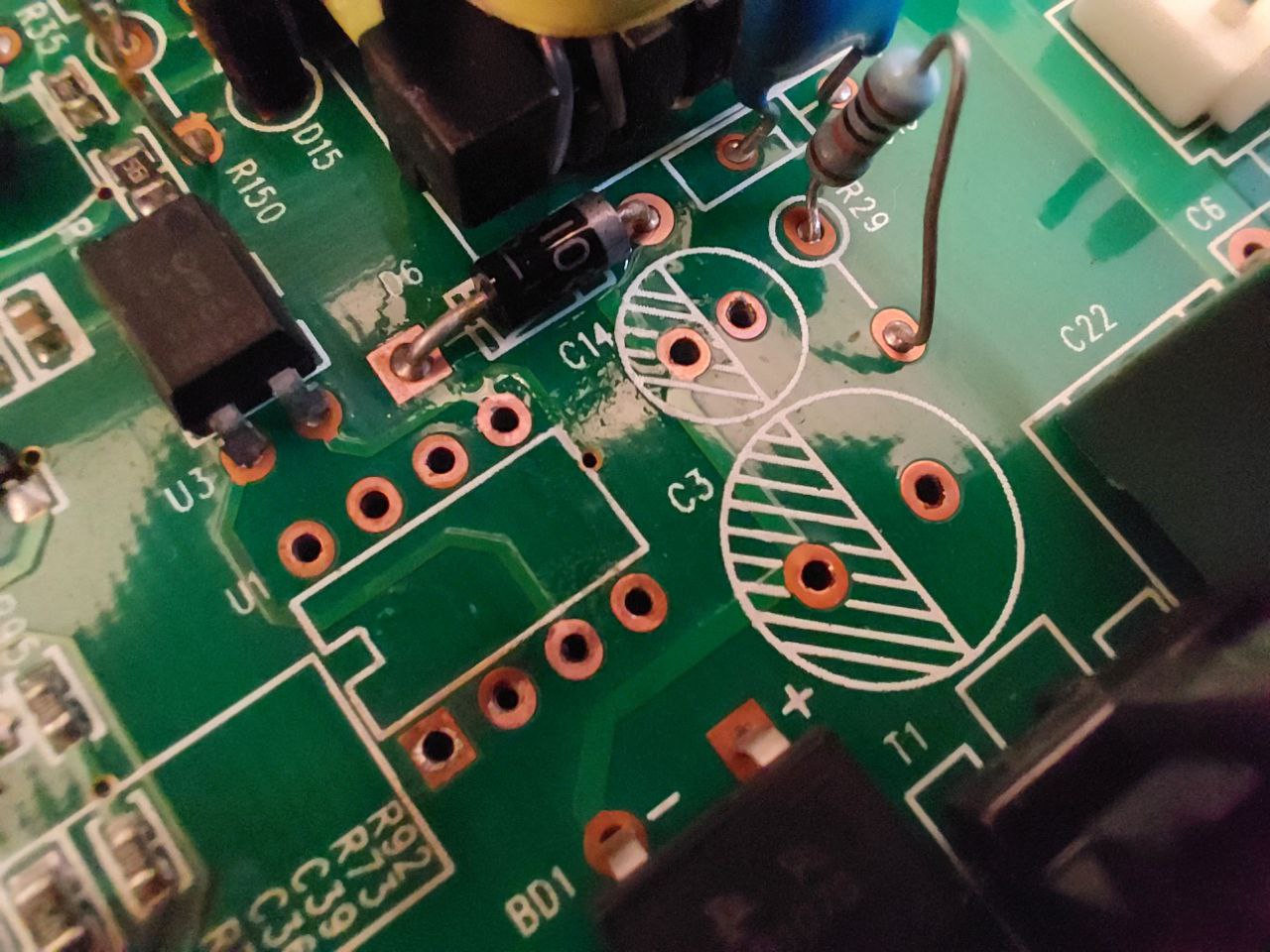

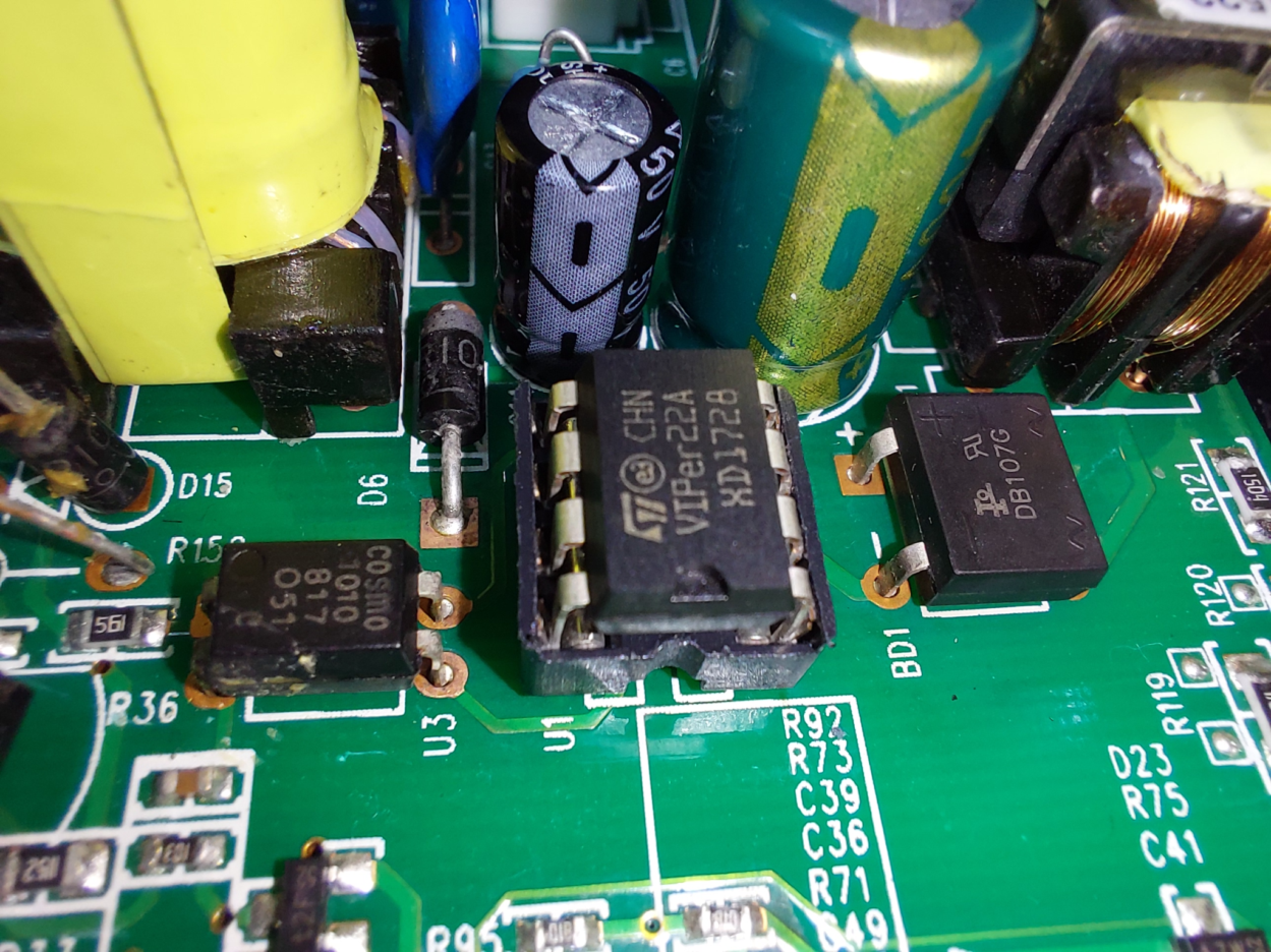

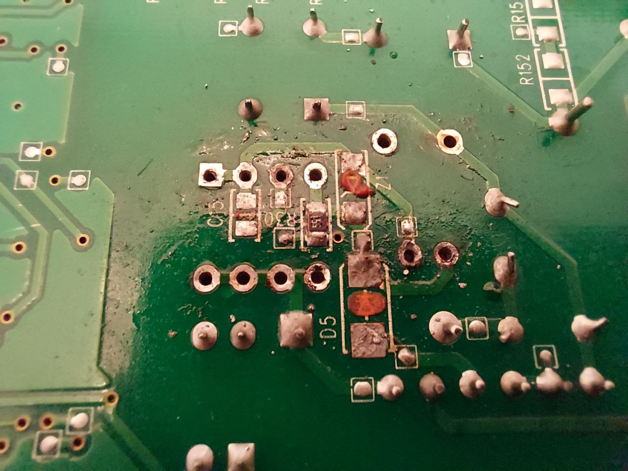

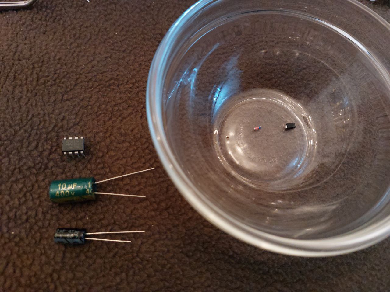

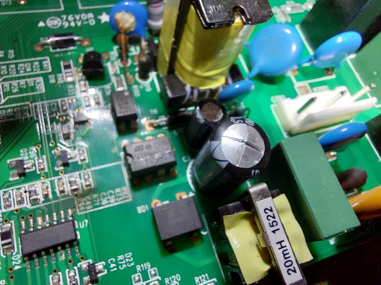

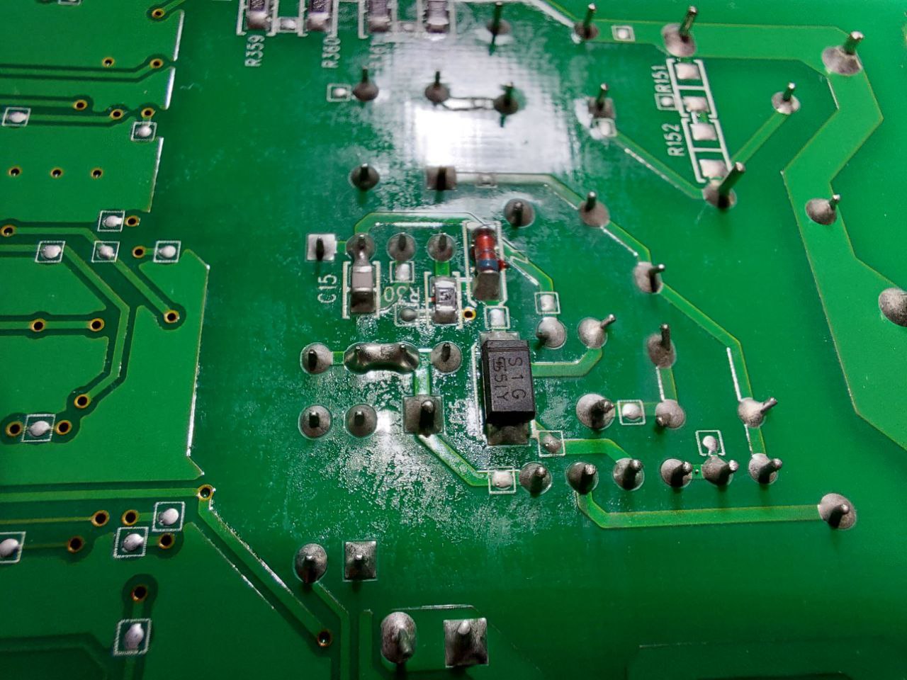

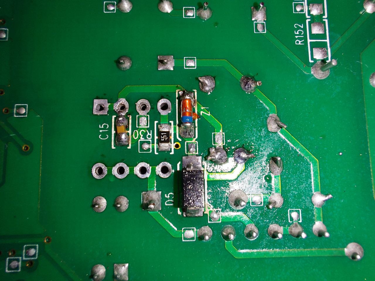

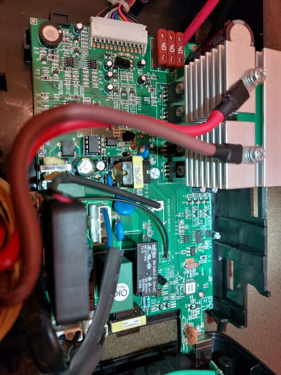

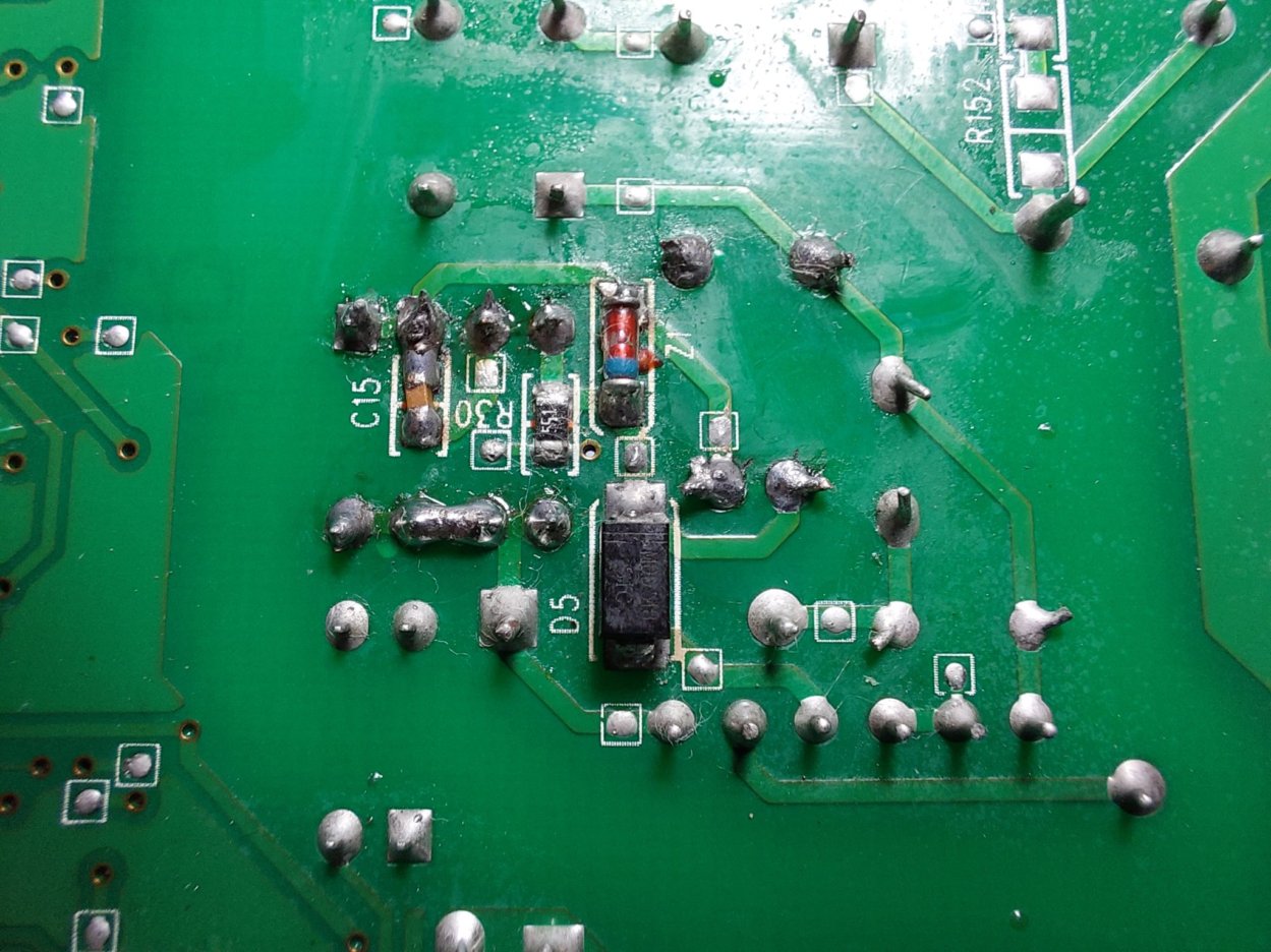

Cyberpower CP900EPFCLCD - F03 Error
  • Shinjinkun
    • Mar 2022
    • 35
    • Spain
    Cyberpower CP900EPFCLCD - F03 Error
    Hello guys.
    Please help me fix this UPS!
    I got this UPS from a guy on Ebay. It stated that it wasn't working, but didn't specify about the F03 error.
    Anyway, when I received it, I supposed that just the battery was dead, a quick fix. Changed the battery, connected the device, and everything worked without issues. However, three days later, the UPS started beeping, showed the F03 error, and had to switch it off, as I didn't know what was going on.
    Going forward, I researched about the problem, and found that it was an issue with the charging circuit. It seems that, while the battery was at full charge, the ups was working normally. It was when the battery lost part of the charge, and the circuit tried to recharge it, that the problems arised.
    I opened the box, and found that a cap and the vyper22a were blown. And also, it is possible that other parts are bad, as the infamous glue was around several critical spots. I removed all of the glue, but obviously the parts need to be swapped.
    I removed the blown cap and the vyper22a, but in the process, I also broke a SMD capacitor (C15). Does any of you know the capacity of the white capacitor I removed by mistake? Or if there is a way to calculate it?
    Furthermore, I think the zener diode and the s1g diode may be also dead. Any idea of the values of the piece were I to buy it? So far, I ordered the capacitor, the vyper22a, and some smd capacitors, but I don't know about which values I need.
    So, long story short, I need the specs for the white capacitor (C15) and the zener diode (Z1) in order to buy them to try to replace them.
    Could you give me some ideas, please? I am really in the dark right now What other components should I test? Is there anything else I could do?
    Thanks everyone!
  • Per Hansson
    • Jul 2005
    • 5895
    • Sweden
    Re: Cyberpower CP900EPFCLCD - F03 Error
    The datasheet for those IC's contains implementation examples.
    Usually the manufacturers follow those quite closely so that is a good starting point.
    • Shinjinkun
      • Mar 2022
      • 35
      • Spain
      Re: Cyberpower CP900EPFCLCD - F03 Error
      The datasheet for those IC's contains implementation examples.
      Usually the manufacturers follow those quite closely so that is a good starting point.
      Do you mean the datasheet for the Viper22a or the board? I am pretty inexperienced in electronics, so I'd appreciate if you could share a link to follow, please.
        master hoarder
        • May 2008
        • 12175
        • Bulgaria
        Re: Cyberpower CP900EPFCLCD - F03 Error
        Originally posted by Shinjinkun
        Do you mean the datasheet for the Viper22a or the board? I am pretty inexperienced in electronics, so I'd appreciate if you could share a link to follow, please.
        Well, if you can find a schematic for the UPS, that would be great. But if not, the VIPer22a datasheet does contain a lot of useful information.
        VIPer22a datasheet:
        https://cdn.badcaps-static.com/pdfs/...55464b79b4.pdf
        Originally posted by Shinjinkun
        So, long story short, I need the specs for the white capacitor (C15) and the zener diode (Z1) in order to buy them to try to replace them.
        Z1 is not that critical for the operation of the VIPer22a - it's there for protection, in case V_dd goes too high. Since the VIPer22a IC is rated for up to 50V on the V_dd pin (though operating, it is specified for 9-38V), my guess would be that a Zener anywhere in the range of 30-40V should be safe to use without possibly clamping too early (if the transformer's primary auxiliary winding - the winding that supplies V_dd to the IC via diode D5 - has a really high output, for example.)
        Just make sure diode D5 is good or replace it. Here, a fast-recovery 40-100V rated diode should work fine.
        Also, don't forget to replace the small 50V, 47 uF cap! That's your startup/run cap.
        As for ceramic cap C15... this one might be a little more challenging to guess. I don't see anything in the VIPer22a datasheet that specifies how to calculate it. That said, I looked up images of random VIPer22a schematics, and the value for the capacitor in this spot varies anywhere from 220 nF to 10 nF. My guess would be that 47-100 nanoFarads will be OK. Just know that the higher the capacitance, the slower the response of the feedback to the IC will get. This could be a good thing or a bad thigh, of course. From what I'm seeing from the online picture schematics, 47 nF is the most common value, so perhaps go with that. As for voltage rating... since pin 3 of the VIPer IC gets is current from the V_dd supply through an optocoupler's output transistor, the voltage will probably be lower. Nevertheless, 35V-50V rating of the cap should be sufficient.
        • Shinjinkun
          • Mar 2022
          • 35
          • Spain
          Re: Cyberpower CP900EPFCLCD - F03 Error
          Originally posted by momaka
          Well, if you can find a schematic for the UPS, that would be great. But if not, the VIPer22a datasheet does contain a lot of useful information.
          VIPer22a datasheet:
          https://cdn.badcaps-static.com/pdfs/...55464b79b4.pdf
          Z1 is not that critical for the operation of the VIPer22a - it's there for protection, in case V_dd goes too high. Since the VIPer22a IC is rated for up to 50V on the V_dd pin (though operating, it is specified for 9-38V), my guess would be that a Zener anywhere in the range of 30-40V should be safe to use without possibly clamping too early (if the transformer's primary auxiliary winding - the winding that supplies V_dd to the IC via diode D5 - has a really high output, for example.)
          Just make sure diode D5 is good or replace it. Here, a fast-recovery 40-100V rated diode should work fine.
          Also, don't forget to replace the small 50V, 47 uF cap! That's your startup/run cap.
          As for ceramic cap C15... this one might be a little more challenging to guess. I don't see anything in the VIPer22a datasheet that specifies how to calculate it. That said, I looked up images of random VIPer22a schematics, and the value for the capacitor in this spot varies anywhere from 220 nF to 10 nF. My guess would be that 47-100 nanoFarads will be OK. Just know that the higher the capacitance, the slower the response of the feedback to the IC will get. This could be a good thing or a bad thigh, of course. From what I'm seeing from the online picture schematics, 47 nF is the most common value, so perhaps go with that. As for voltage rating... since pin 3 of the VIPer IC gets is current from the V_dd supply through an optocoupler's output transistor, the voltage will probably be lower. Nevertheless, 35V-50V rating of the cap should be sufficient.
          Wow, that's a thorough explanation! Let me review all these values and see if I could get all these components. But at least, it looks promising
          Thanks a lot for the suggestions!
          • Shinjinkun
            • Mar 2022
            • 35
            • Spain
            Re: Cyberpower CP900EPFCLCD - F03 Error
            Originally posted by Shinjinkun
            Wow, that's a thorough explanation! Let me review all these values and see if I could get all these components. But at least, it looks promising
            Thanks a lot for the suggestions!
            FYI, I already ordered all the missing components.
            I got a zener diode kit for Z1, with several values:
            ZMM30V (30 V), ZMM33V (V), ZMM36V (36 V),ZMM39V (V).
            Which one of them should I use? You commented it should be between 30 to 40V, but which one should do better?
            Bought the S1G cause I think is in bad shape.
            Got an extra 50V 47uF in case it doesn't work.
            For the C15, also got a kit with loads of values, 47nF included. I hope that one should work ok.
            One last comment, in case the SMD resistor 551 break or something, also got a resistor kit but, the kit only contains a 560 OHM, instead of the 550 OHM that the 551 should have. Because they have a 5% tolerance, I suppose it should work too...
            I will let you know once I receive all the components. Thanks again!
              • Jul 2011
              • 6070
              Re: Cyberpower CP900EPFCLCD - F03 Error
              Originally posted by Shinjinkun
              One last comment, in case the SMD resistor 551 break or something, also got a resistor kit but, the kit only contains a 560 OHM, instead of the 550 OHM that the 551 should have. Because they have a 5% tolerance, I suppose it should work too...
              I will let you know once I receive all the components. Thanks again!
              It should work
              • Shinjinkun
                • Mar 2022
                • 35
                • Spain
                Re: Cyberpower CP900EPFCLCD - F03 Error
                Hi guys!
                Finally, I got all the components needed to reattach.
                As you can see in the attached picture, I got:
                Viper22a integrated
                Capacitor 400V 10uF
                Capacitor 50V 47uF
                Diode S1G
                Capacitor SMD 470pF
                Zener Diode MELF 39V
                I already removed all the components.
                I checked the 50V cap, but I found that it was fine... anyway, I will put a new one.
                About the 551 resistor, I don't think I need to change it.
                Do you have any suggestion to resold everything back?
                Is there any test I should perform after having everything in place?
                Thanks again!
                  • Jul 2011
                  • 6070
                  Re: Cyberpower CP900EPFCLCD - F03 Error
                  So have you tried to power up this switching power supply yet to see if you fix it or not
                  • Shinjinkun
                    • Mar 2022
                    • 35
                    • Spain
                    Re: Cyberpower CP900EPFCLCD - F03 Error
                    Originally posted by sam_sam_sam
                    So have you tried to power up this switching power supply yet to see if you fix it or not
                    No, I haven't yet, as I didn't complete all the soldering. I am waiting to get a socket for the integrated, so once I receive it, I will complete the final piece. I attached the picture of the current motherboard after soldering most of the components.
                    I will show you the final pictures and tell you if it works or not once it's complete.
                    Thanks!
                    • pete_c
                      • Apr 2022
                      • 16
                      • US
                      Re: Cyberpower CP900EPFCLCD - F03 Error
                      @Shinjinkun
                      Very nice soldering on your board.
                      Have you tested the UPS yet?
                      Auto mator
                      • Shinjinkun
                        • Mar 2022
                        • 35
                        • Spain
                        Re: Cyberpower CP900EPFCLCD - F03 Error
                        Originally posted by pete_c
                        @Shinjinkun
                        Very nice soldering on your board.
                        Have you tested the UPS yet?
                        @pete_c I finished with the fix a couple of days ago, but I was using it in case I got the F03 error again. It doesn't look like it is the case though. So far is working great.
                        Big thanks to @momaka for the suggestions of components. It seems that they were spot on.
                        In the end I swapped both caps (the 50V and the 400V). About the Viper22a, I added an extra socket in case I have to change it in the future, but I hope it won't be needed.
                        You can see the pictures with the final board components. I was using the multimeter to check that the voltage of the battery was within normal values. It is curious that this UPS doesn't overcharge the battery as some off-line ones that I own. The others charge the battery at 13.5V, but this one seems to only use 12.5V instead. The reason is probably the better design and components, but who knows...
                        Again, thanks to all for your help. It is really appreciated.
                        Regards
                        • Shinjinkun
                          • Mar 2022
                          • 35
                          • Spain
                          Re: Cyberpower CP900EPFCLCD - F03 Error
                          Guys, forget about what I said previously. I just got the dreaded F03 error again. I checked the battery, and it was around 10.29V, so I have the impression that for the latest 3 days, the battery has been discharging without realizing it....
                          this only means that even that I swapped all the broken components, there is still something wrong with the board. Now I have no idea how to track the error and what can I do to fix it.... T_T
                          Any suggestions will be really appreciated.
                          • Per Hansson
                            • Jul 2005
                            • 5895
                            • Sweden
                            Re: Cyberpower CP900EPFCLCD - F03 Error
                            Yes proper standby charge voltage for a lead acid battery is around 13.7v and charge voltage is around 14.7v
                            Now that you replaced the Viper have you checked what voltages you have on the capacitors you replaced, so we are sure that it is working at all?
                            I notice in your first picture some soot around component U7.
                            I think it is a ST 324 op-amp that is probably used in the charge control circuit.
                            Hard to know without a circuit diagram of course.
                            I attached a picture where I highlighted a possibly bad solder joint for a through hole component.
                            I also would not exclude the 550Ω resistor or the optocpupler U3 since they are in the path of destruction too...
                            Last edited by Per Hansson; 05-14-2022, 08:59 AM.
                            • lotas
                              • Jan 2016
                              • 4794
                              • Russia
                              Re: Cyberpower CP900EPFCLCD - F03 Error
                              Yes, it is clear that the 550 Om resistor has a burnout.
                              • Shinjinkun
                                • Mar 2022
                                • 35
                                • Spain
                                Re: Cyberpower CP900EPFCLCD - F03 Error
                                Yes proper standby charge voltage for a lead acid battery is around 13.7v and charge voltage is around 14.7v
                                Now that you replaced the Viper have you checked what voltages you have on the capacitors you replaced, so we are sure that it is working at all?
                                Can I use the multimeter directly over these caps while working? I mean, should I get the 50 or 400V on them? I never did this, so it is difficult for me.
                                I notice in your first picture some soot around component U7.
                                I think it is a ST 324 op-amp that is probably used in the charge control circuit.
                                Hard to know without a circuit diagram of course.
                                Yes, I also noticed the burnt marks, but I thought it was from the cap or the viper when it poofed. I checked continuity on the components on top of the U7, but I am not sure how to test the U7 itself.
                                I attached a picture where I highlighted a possibly bad solder joint for a through hole component.
                                I can desold and resold it just in case.
                                I also would not exclude the 550Ω resistor or the optocpupler U3 since they are in the path of destruction too...
                                I thought about replacing the 550Ω resistor, but I thought it was ok. I can replace it as I have some spares. Regarding the optocupler, how can I check it? I will try to find this part somewhere.
                                • Shinjinkun
                                  • Mar 2022
                                  • 35
                                  • Spain
                                  Re: Cyberpower CP900EPFCLCD - F03 Error
                                  Originally posted by lotas
                                  Yes, it is clear that the 550 Om resistor has a burnout.
                                  I will try replacing it.
                                  • Per Hansson
                                    • Jul 2005
                                    • 5895
                                    • Sweden
                                    Re: Cyberpower CP900EPFCLCD - F03 Error
                                    Originally posted by Shinjinkun
                                    Can I use the multimeter directly over these caps while working? I mean, should I get the 50 or 400V on them? I never did this, so it is difficult for me.
                                    Yes exactly, start there and then we can look at the rest.
                                    • lotas
                                      • Jan 2016
                                      • 4794
                                      • Russia
                                      Re: Cyberpower CP900EPFCLCD - F03 Error
                                      If the switching power supply works, then voltage should appear on this capacitor.
                                      • Shinjinkun
                                        • Mar 2022
                                        • 35
                                        • Spain
                                        Re: Cyberpower CP900EPFCLCD - F03 Error
                                        Yes exactly, start there and then we can look at the rest.
                                        I took the measures for the three capacitors. These are the values I obtained:
                                        C3 - 400V 10uF ---> 0.403V
                                        C14 - 50V 47uF ---> 0.184V
                                        C17 - 25V 470uF ---> 0.939V
                                        I haven't replaced the 550Ω resistor yet, though. Not sure if this point can affect the taken measures.
                                        I attached a couple more pictures in case they help.
                                        • unimatrix93
                                          TV backlight zener diode
                                          by unimatrix93
                                          Hello everyone, I'm repairing an LG TV backlight and I noticed some strange behavior when I touching the backlight strip with a missing Zener diode.
                                          So I replaced the leds on the strips and they seemingly working fine, but soon as I touch the strip which has a missing Zener diode the whole backlight turns off for a few seconds and then turns back on.
                                          Is this caused by the missing diode? If so what kind of zener diode should I use to replace it?.
                                          The led strips has 9 6V leds.
                                          02-10-2025, 12:13 PM
                                          NTE Electronics “NTE5251K” Zener Diode 9.1V @ 50W Do-5.5% Want to build a 9.1 output from a 9.6 lipo4 battery pack
                                          by sam_sam_sam
                                          I have bought this Zener Diode for this project what size and wattage resistor value do I need to use to get near 50 watt output
                                          I bought this from an eBay seller but unfortunately they only had one
                                          I bought three from Vetco Electronics these are Sylvania ECG5185A 9.1@10w A to Stud what size and watt resistor do I need to use to get near 10 watt output
                                          I bought three of from them to also make battery packs with this output power limit in mind
                                          I want to use this battery pack and turn it into a 9.1 output battery pack output to eliminate using 9 volt battery...
                                          04-23-2025, 05:50 AM
                                        • Vincenzo2
                                          Element 32 inches tv (ELEFW328B) Unknown component: Diode or zener?
                                          by Vincenzo2
                                          My Element 32 inches tv (ELEFW328B) lost it's backlight (confirmed with a flashlight test) and the connector on the PCB (it has one board that has a processor chip, switch mode power supply, and backlight circuit) that has the two wires that go to the backlight LED strips has a very low voltage (28-29 volts) when turned ON, in my opinion.
                                          Started testing components and found an SMD diode or zener that is shorted (even zero fusing resistors read a few tens of milliohms, while this thing reads zero).
                                          I put some pictures here to show that it is labeled "M7"....
                                          09-07-2023, 07:43 PM
                                        • hobostove
                                          Corsair RM1000e - Help identify 5VSB Zener diode
                                          by hobostove
                                          Hey there guys. I've got a Corsair power supply that's come across my bench dead. I usually don't mess with power supplies, but it's a slow week so I'm giving it a whirl.
                                          Taking it apart I heard a screw rattling around inside, and when I got it apart I found a couple blown components near what I think is the 5VSB area.
                                          There's a 22ohm resistor that's melted and open, but it still has the bands.
                                          The other part is a zener diode and it's top went to jesus, so I can't read the marking.
                                          It looks like the diode connects the source and drain of a TNY284...
                                          03-27-2025, 02:25 PM
                                        • debidoobs
                                          Yamaha delay D1500, zener diode broken with no marking
                                          by debidoobs
                                          im actually trying to save a d1500 delay from yamaha. I found the service manual but schematic is missing and BOM list is a bit unclear as components listed have no reference linked to the pcbs... In my case, one zener diode was broken (114 code on the pcb in attached file) and couldn't be repaired : it was a zener type package. In the BOM list i found 3 reference on this board : 1S555 (can be replaced by 1N4148), RD4.7EB2 (approx 5v rectifier), RD7.5EB3 (approx 7v rectifier)...
                                          Actually the cathode goes to VCC of sram M5M5118P, without this diode missing, i have...
                                          04-24-2024, 09:01 AM
