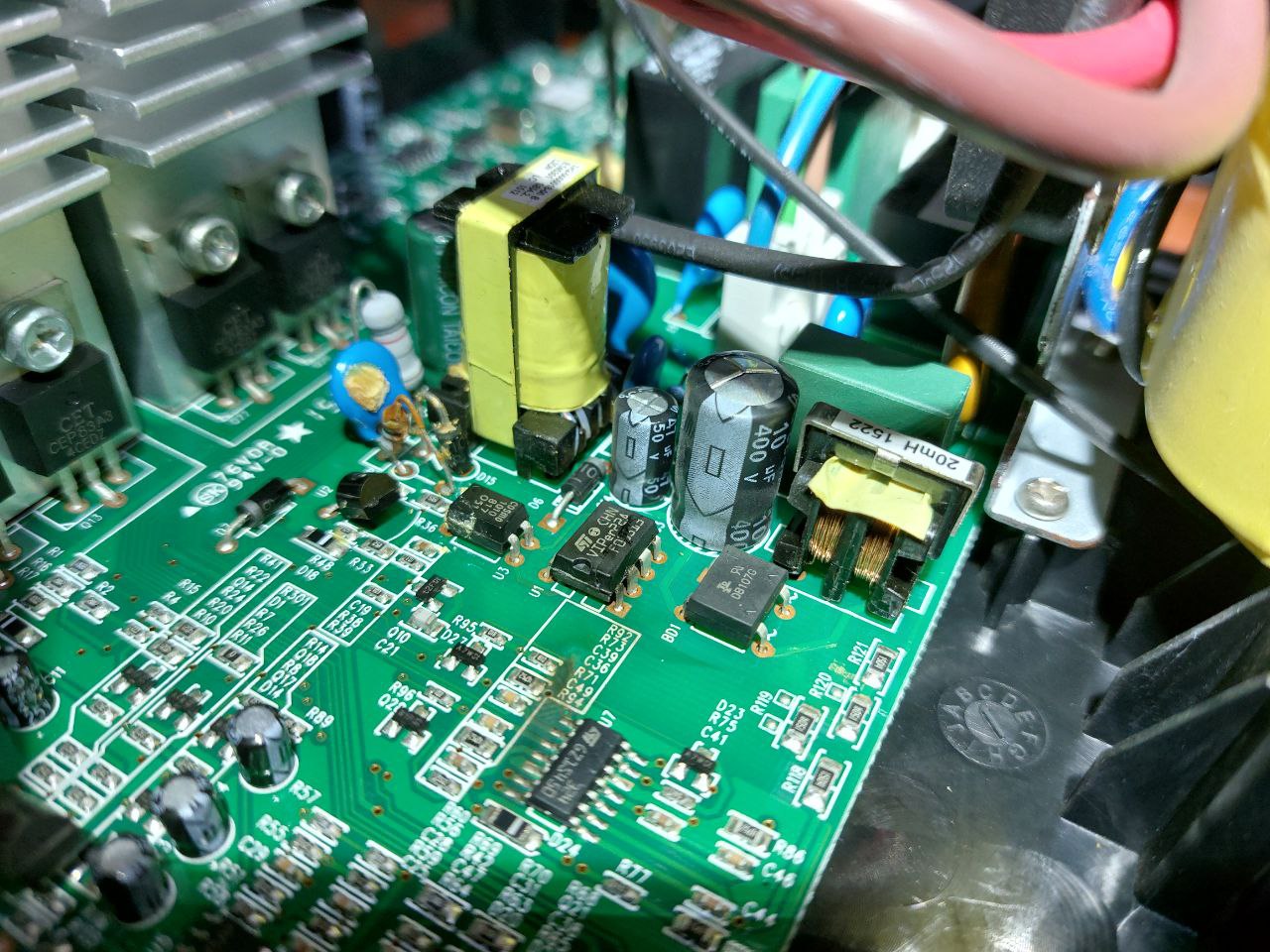

Hello guys.
Please help me fix this UPS!

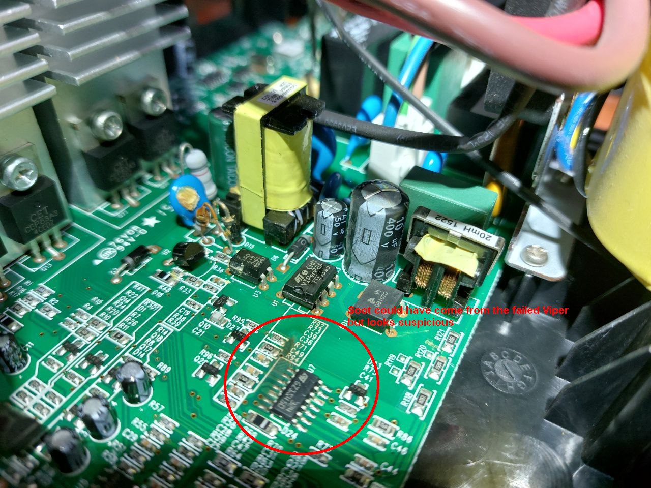

I got this UPS from a guy on Ebay. It stated that it wasn't working, but didn't specify about the F03 error.
Anyway, when I received it, I supposed that just the battery was dead, a quick fix. Changed the battery, connected the device, and everything worked without issues. However, three days later, the UPS started beeping, showed the F03 error, and had to switch it off, as I didn't know what was going on.
Going forward, I researched about the problem, and found that it was an issue with the charging circuit. It seems that, while the battery was at full charge, the ups was working normally. It was when the battery lost part of the charge, and the circuit tried to recharge it, that the problems arised.

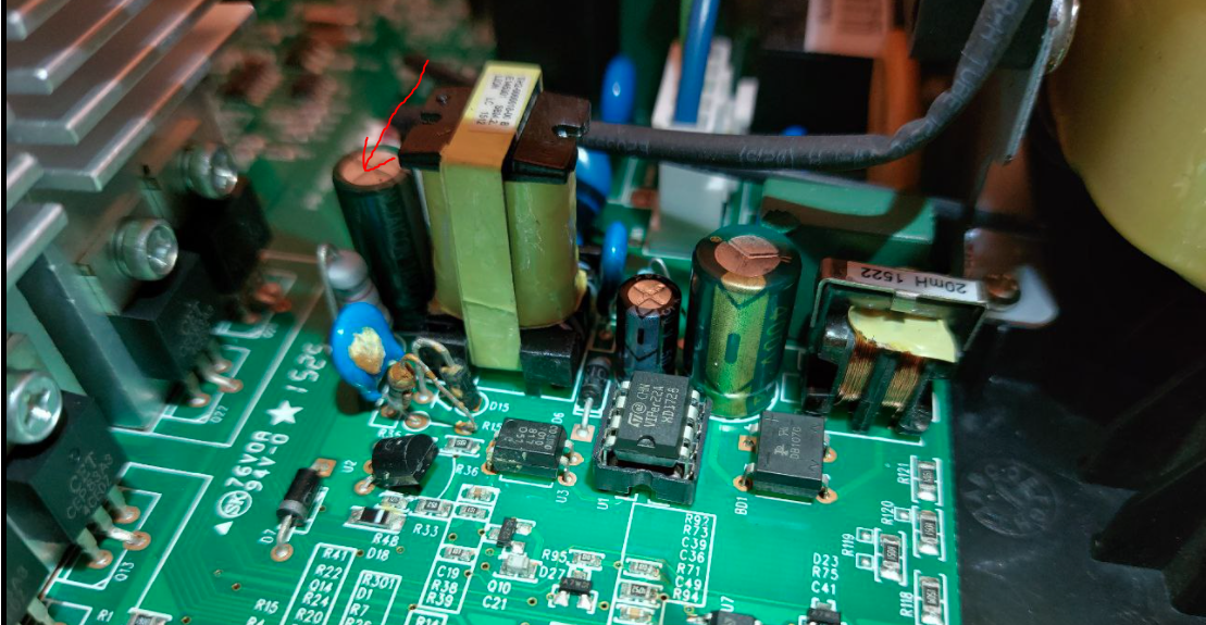

I opened the box, and found that a cap and the vyper22a were blown. And also, it is possible that other parts are bad, as the infamous glue was around several critical spots. I removed all of the glue, but obviously the parts need to be swapped.

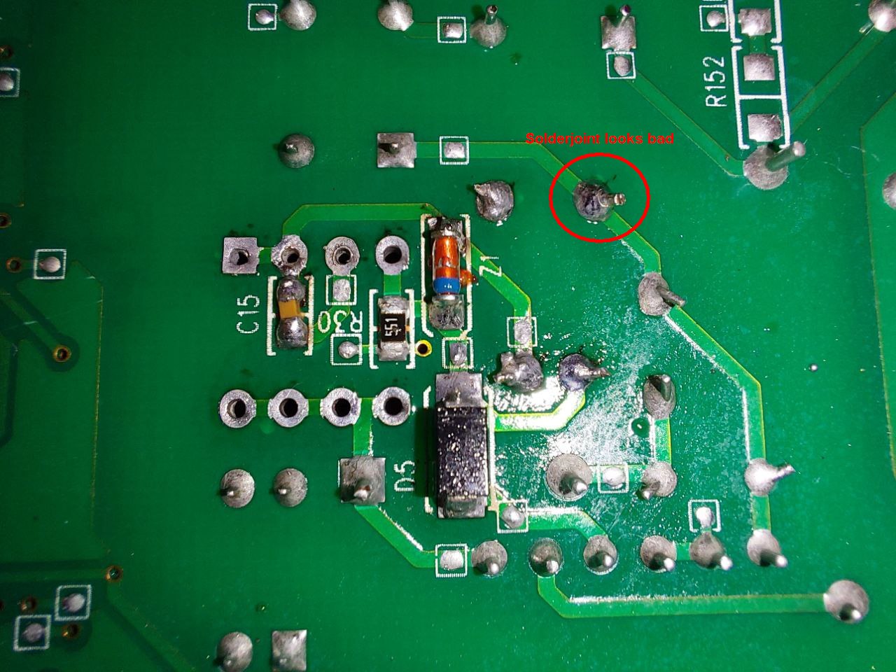

I removed the blown cap and the vyper22a, but in the process, I also broke a SMD capacitor (C15). Does any of you know the capacity of the white capacitor I removed by mistake? Or if there is a way to calculate it?
Furthermore, I think the zener diode and the s1g diode may be also dead. Any idea of the values of the piece were I to buy it? So far, I ordered the capacitor, the vyper22a, and some smd capacitors, but I don't know about which values I need.
So, long story short, I need the specs for the white capacitor (C15) and the zener diode (Z1) in order to buy them to try to replace them.
Could you give me some ideas, please? I am really in the dark right now
What other components should I test? Is there anything else I could do?
Thanks everyone!
