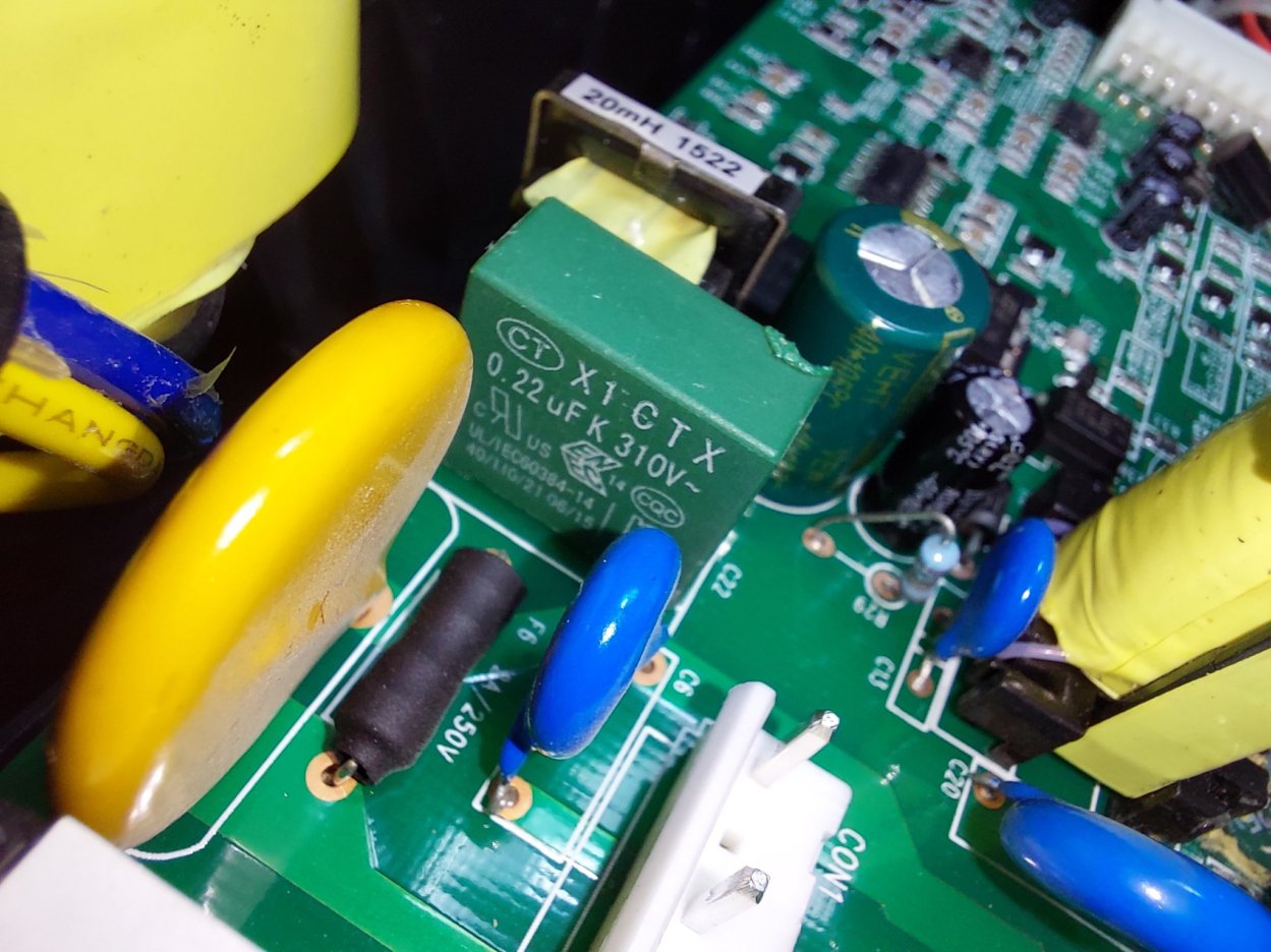

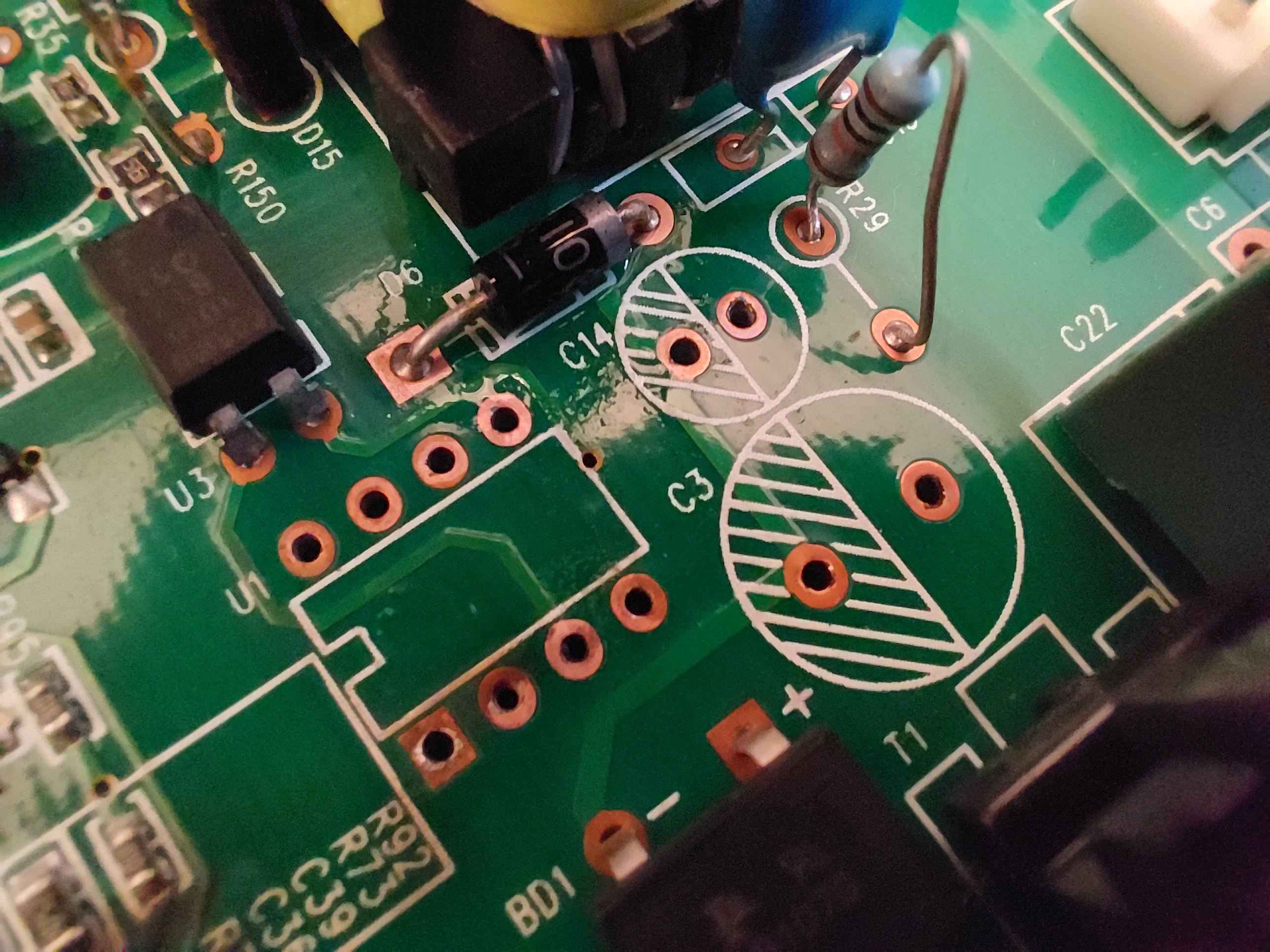

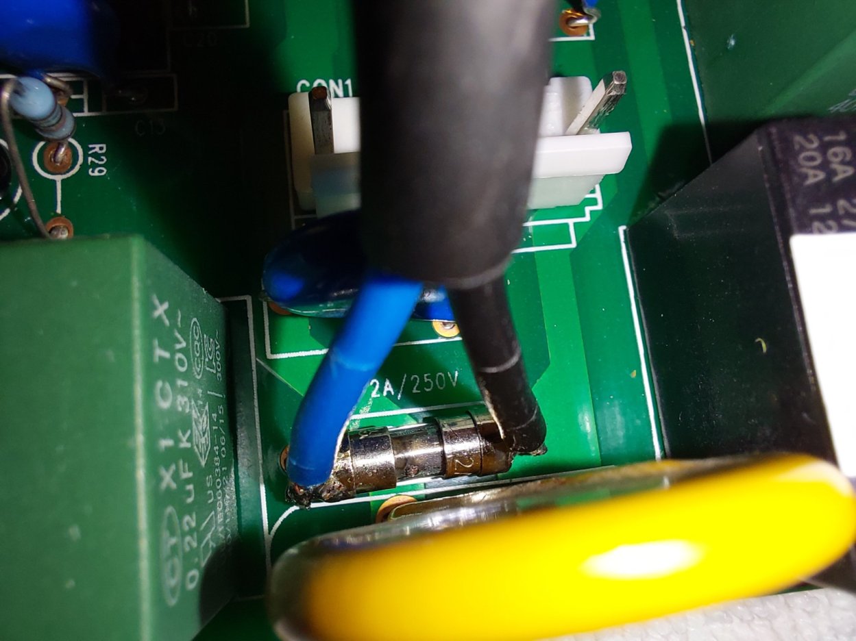

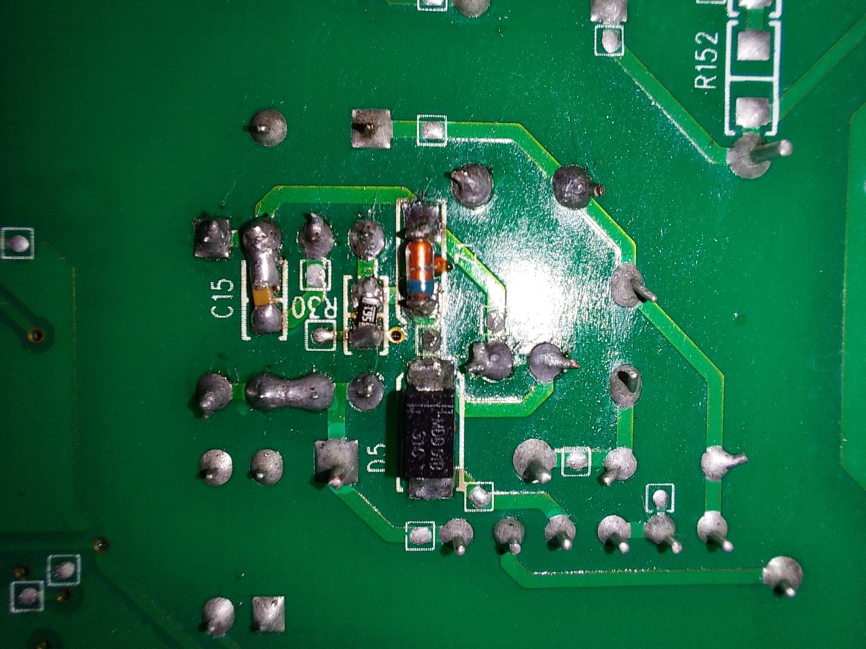

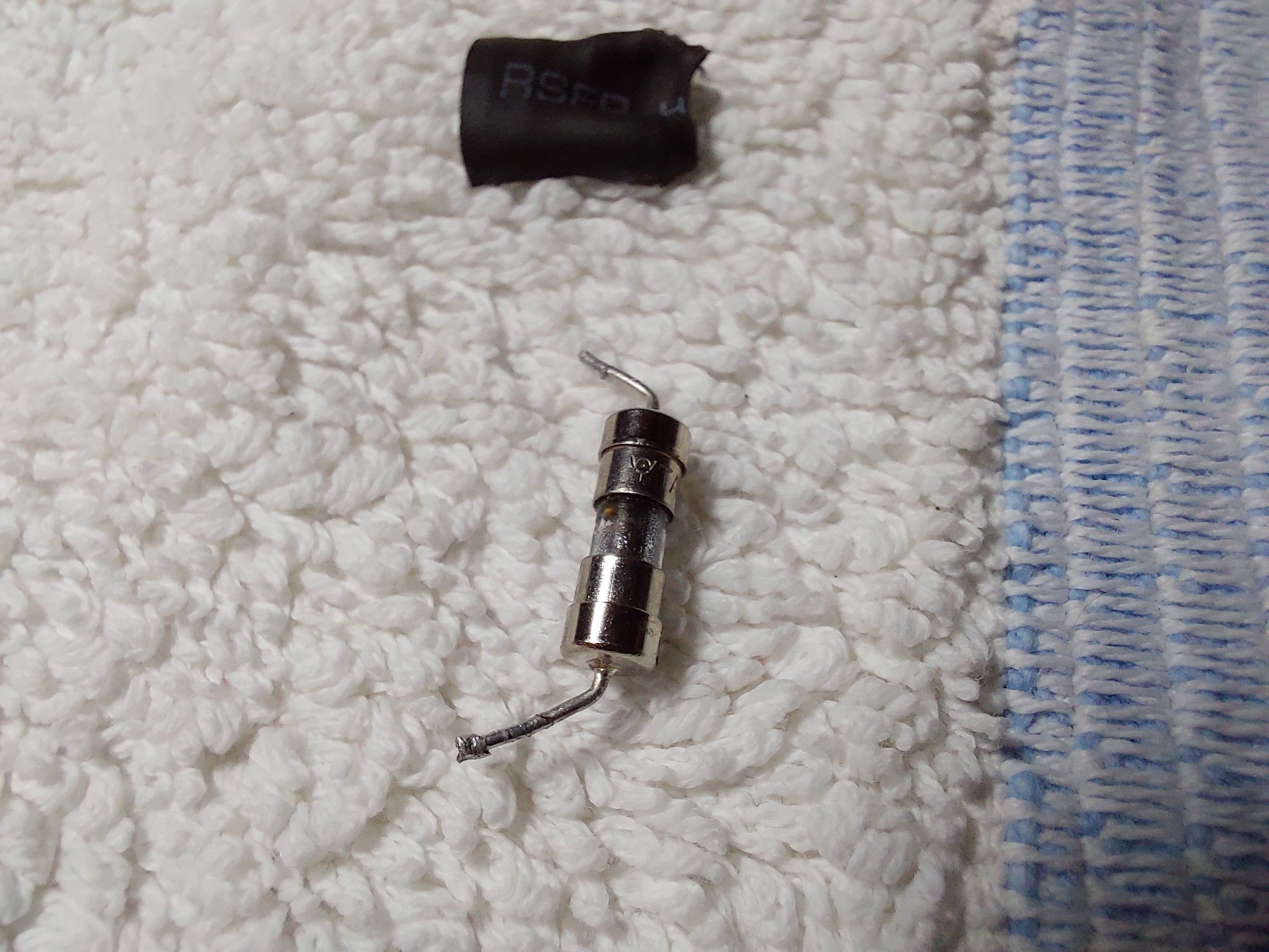

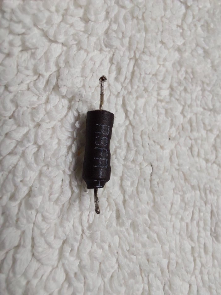

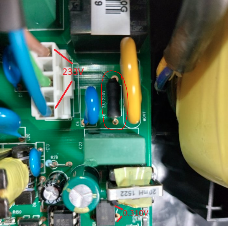

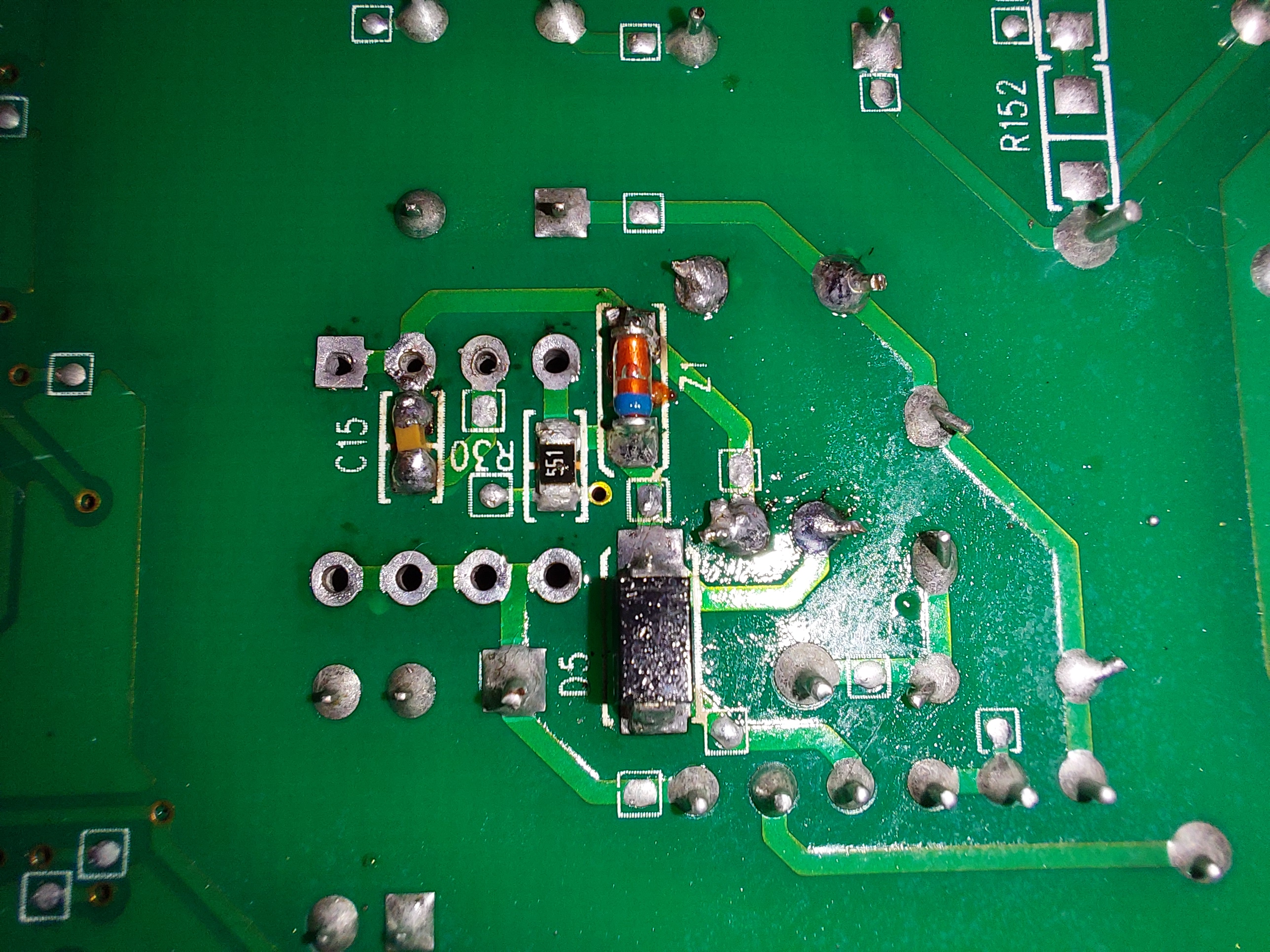

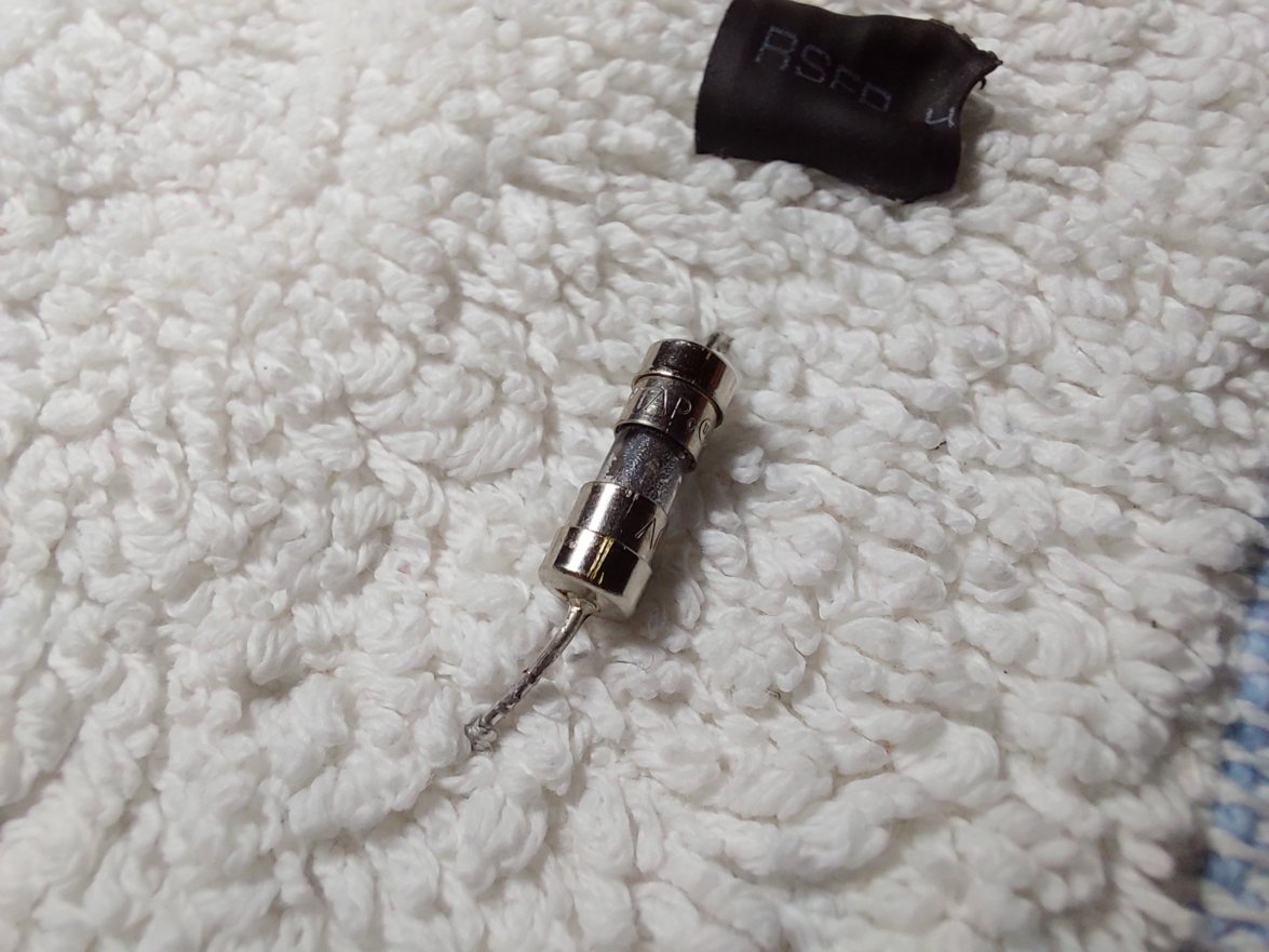

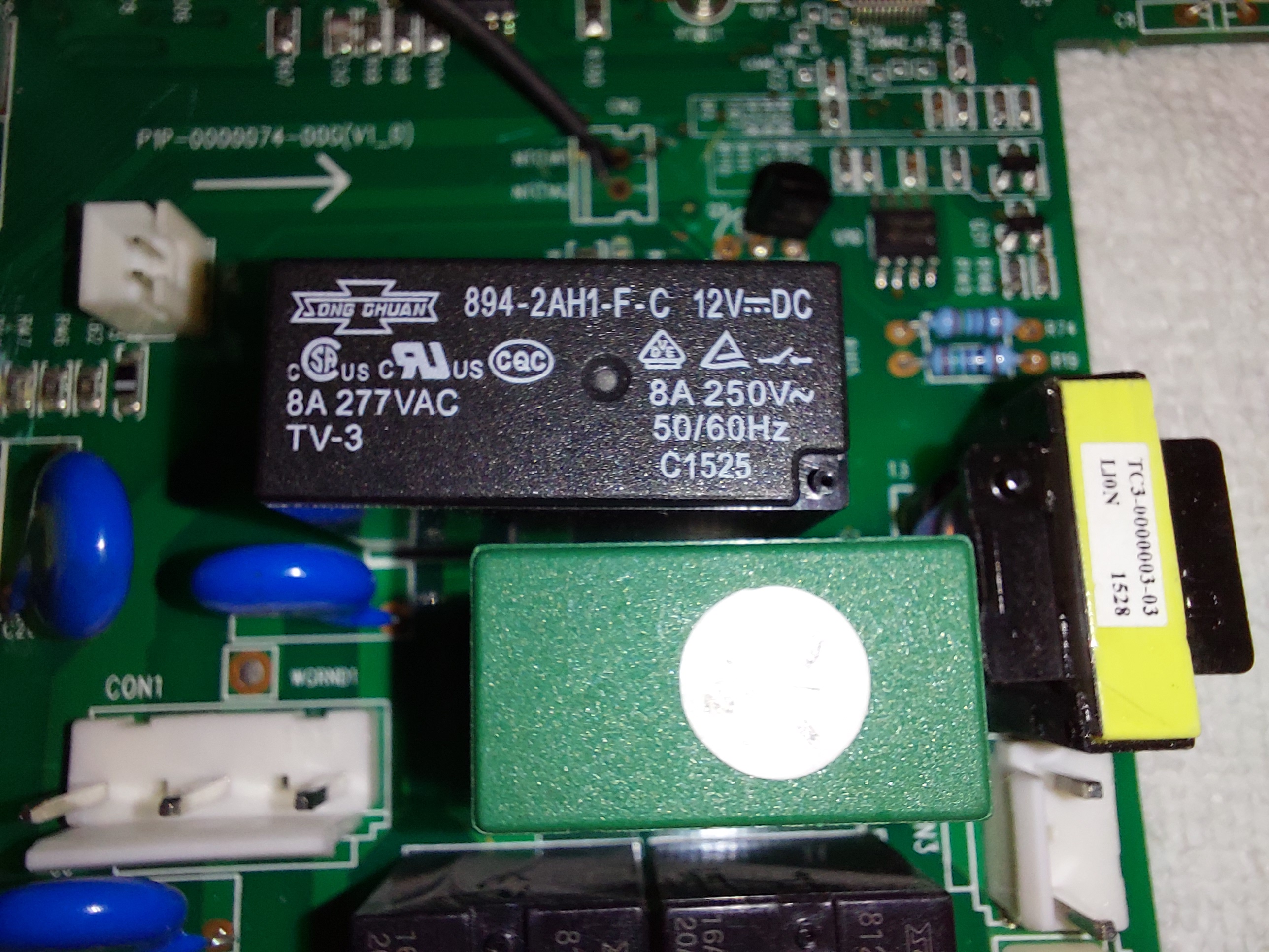

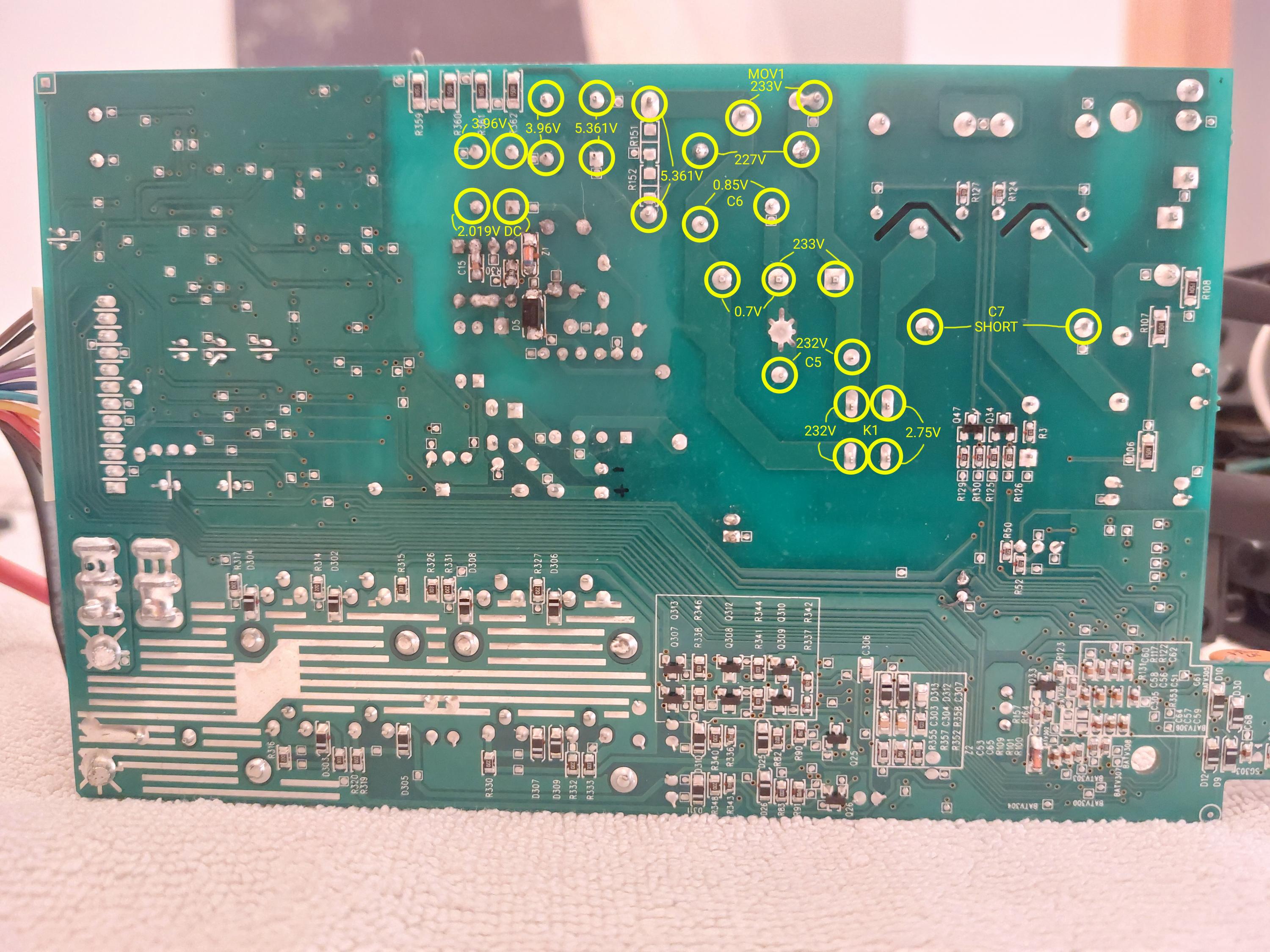

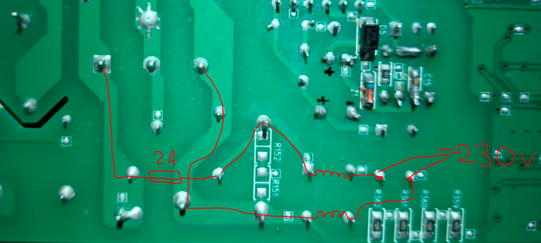

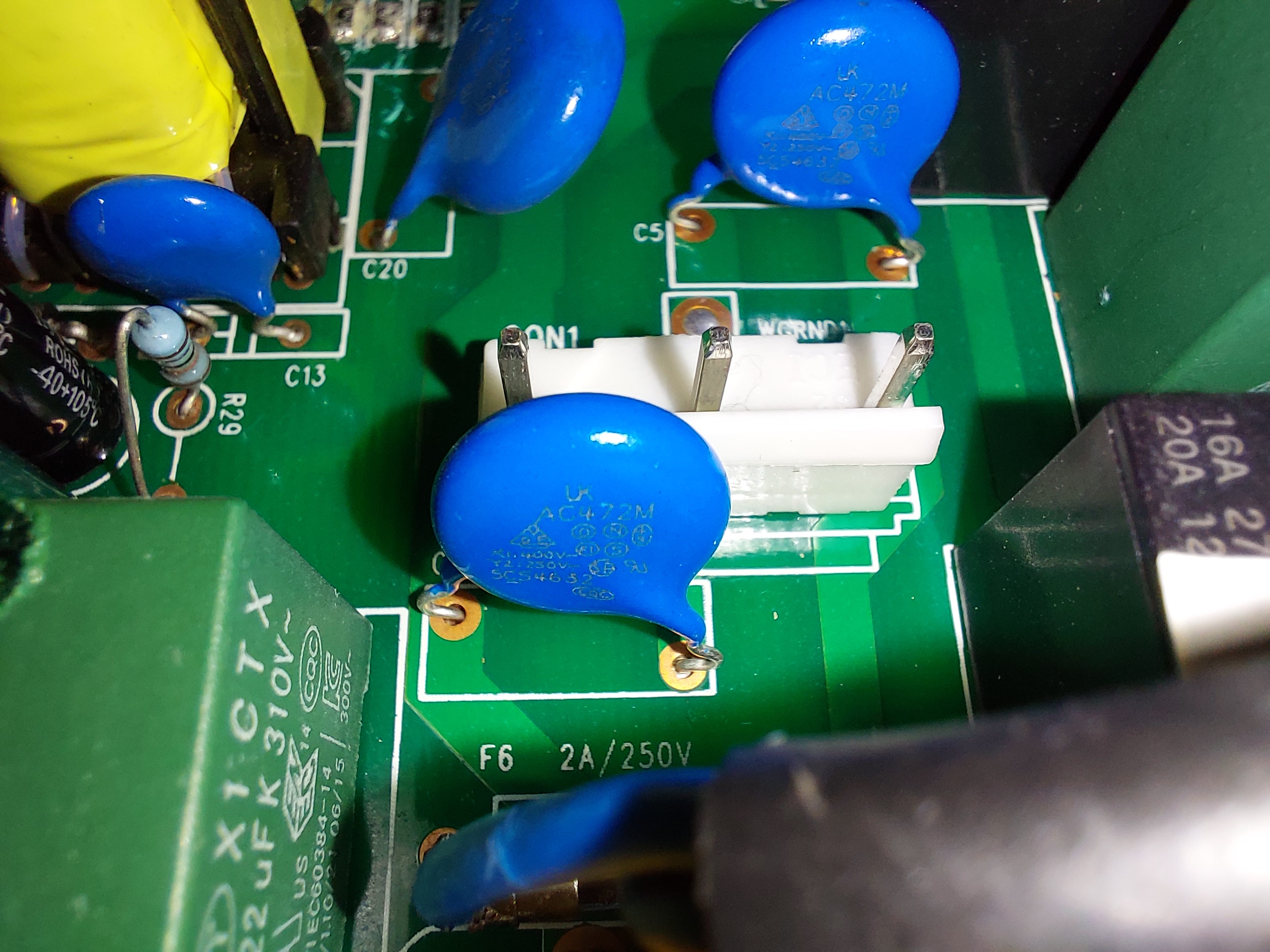

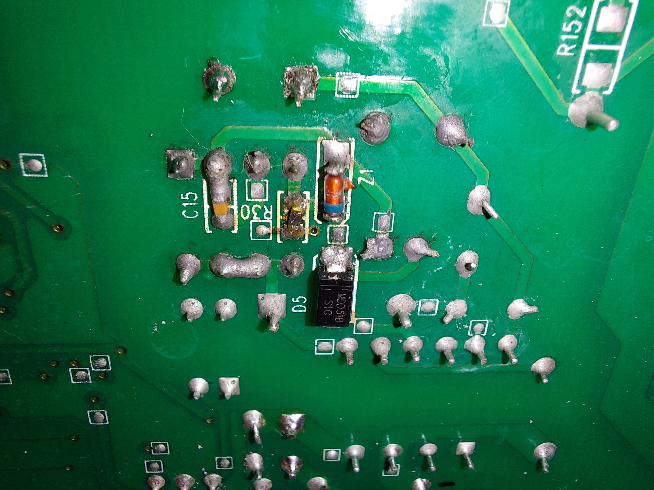

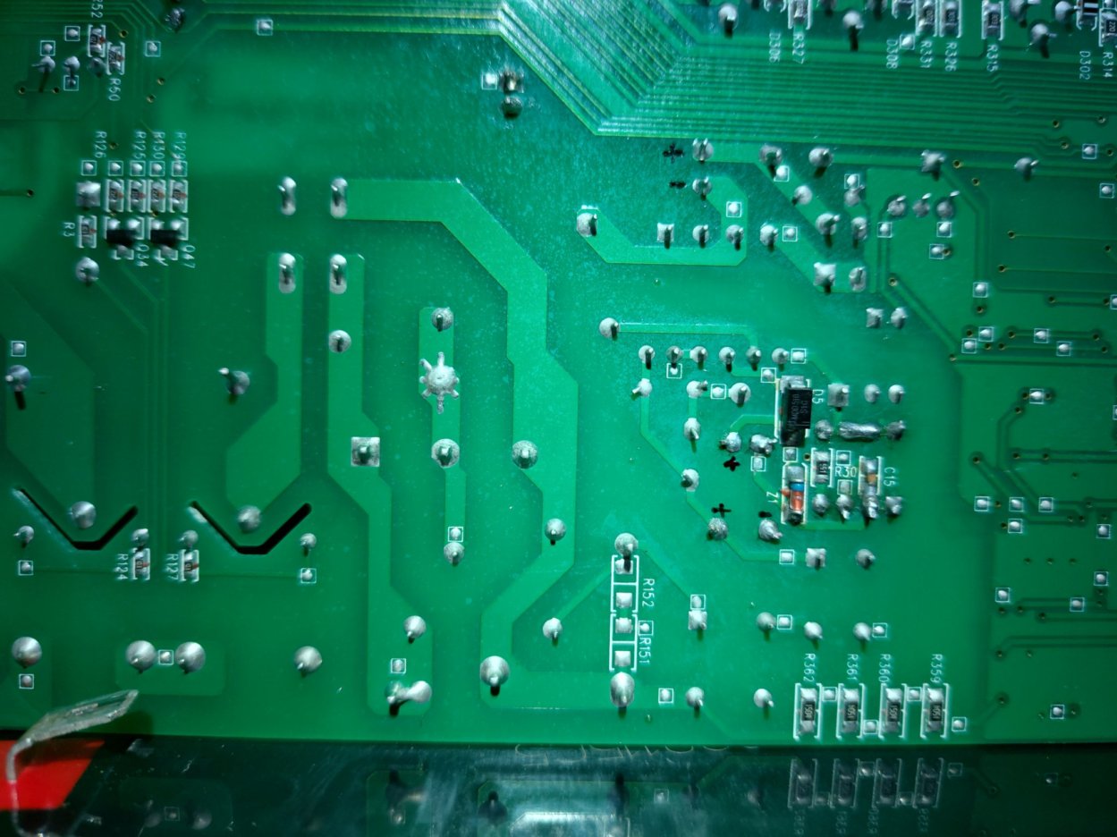

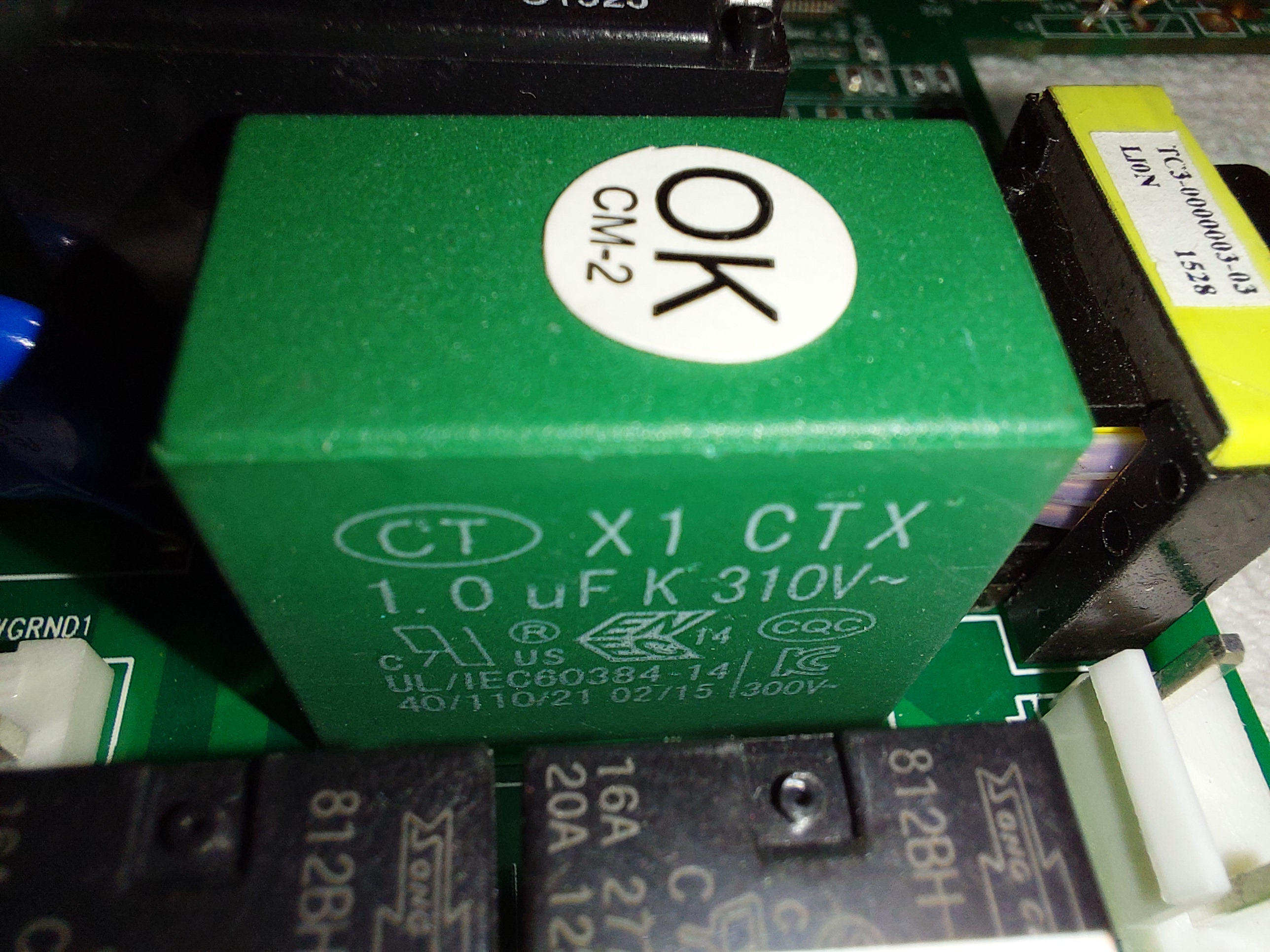

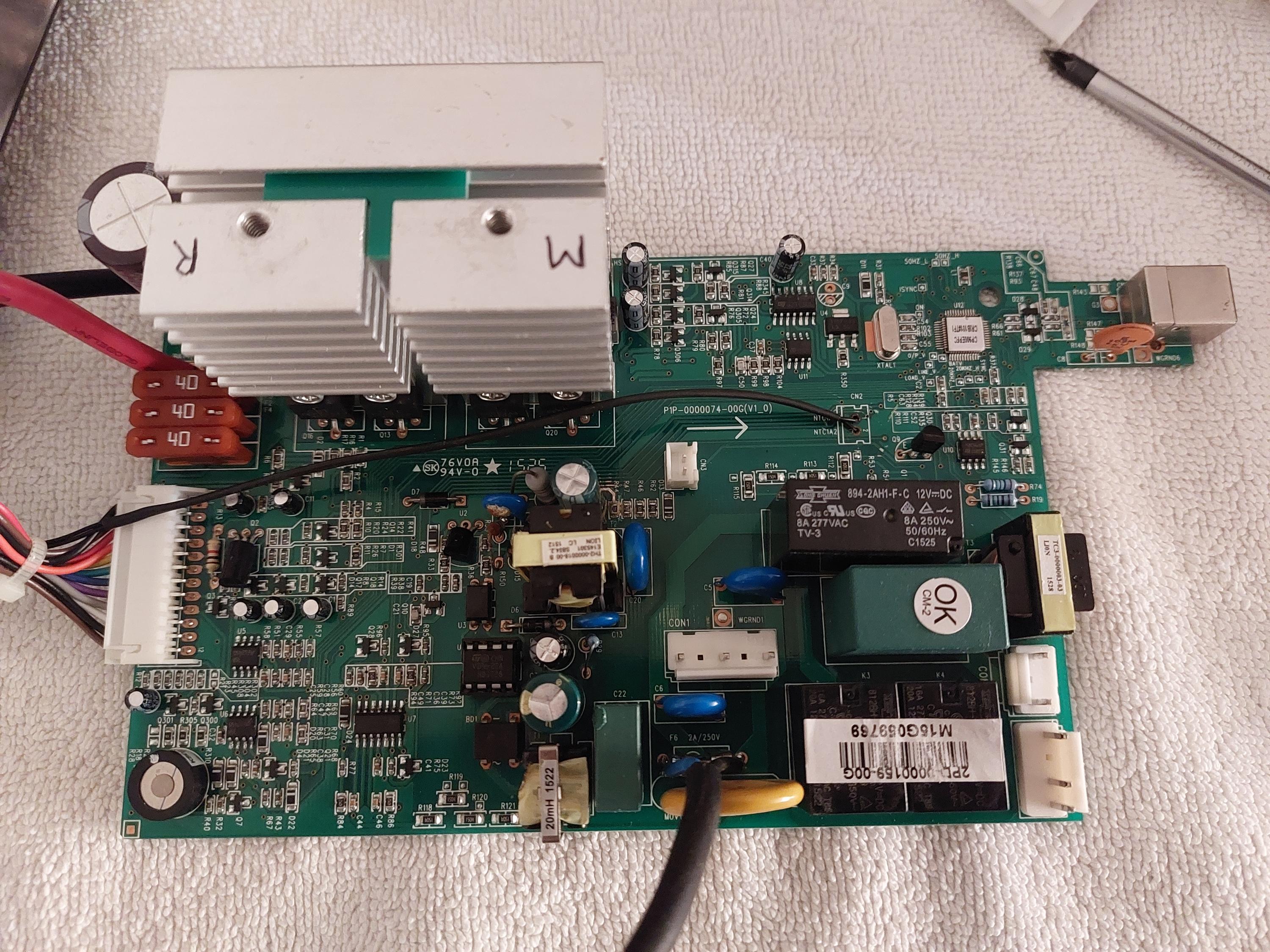

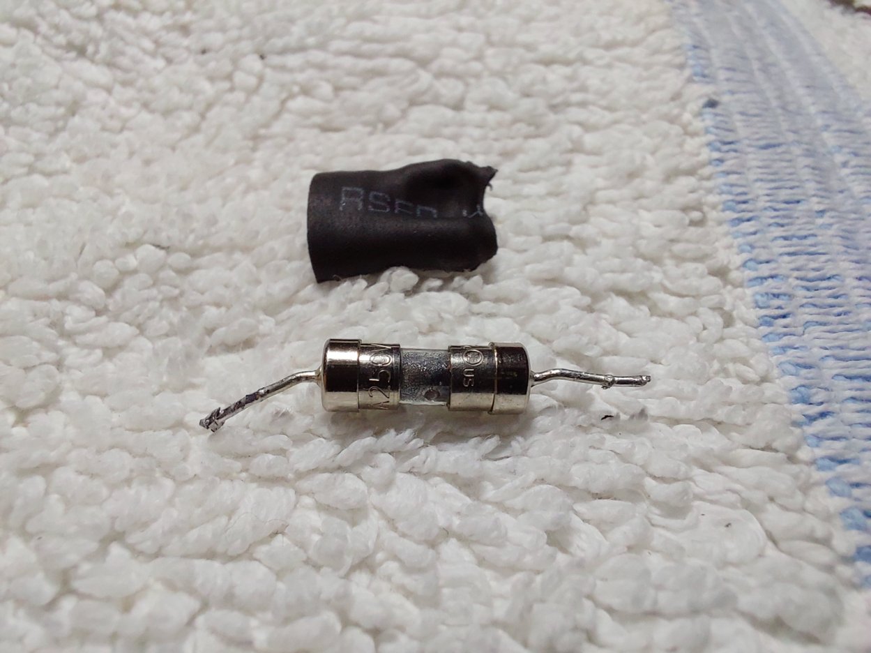

Cyberpower CP900EPFCLCD - F03 Error
  • lotas
    • Jan 2016
    • 4885
    • Russia
    Re: Cyberpower CP900EPFCLCD - F03 Error
    You should have a high DC voltage on C3 - 400 V 10 uF, if it is not there, then the AC voltage does not reach the diode bridge, you need to check the fuse or low-resistance resistor, or the relay between the AC 220v input and the diode bridge did not work.
    • Per Hansson
      • Jul 2005
      • 5895
      • Sweden
      Re: Cyberpower CP900EPFCLCD - F03 Error
      Yes, could also be that the bridge rectifier BD1 is broken, so check if you have input AC voltage on it.
      • lotas
        • Jan 2016
        • 4885
        • Russia
        Re: Cyberpower CP900EPFCLCD - F03 Error
        And some more UPSs will not start (they will not turn on the relay to start the switching power supply) without a battery, you need to check the power with the battery.
        • Shinjinkun
          • Mar 2022
          • 35
          • Spain
          Re: Cyberpower CP900EPFCLCD - F03 Error
          Originally posted by lotas
          You should have a high DC voltage on C3 - 400 V 10 uF, if it is not there, then the AC voltage does not reach the diode bridge, you need to check the fuse or low-resistance resistor, or the relay between the AC 220v input and the diode bridge did not work.
          Alright, I checked the values for the BD1 component:
          input AC: 0.310V
          output DC: 0.403V
          I also checked the cable that comes from the input AC cable (after the fuse) to see if the current was getting into the board. It has 233V, so it seems that at least until that point the current is as expected.
          Using the attached picture Cyberpower04.jpg, where should I measure and which values should I expect? If you could pin-point in the picture, it will be even better, as I am a total beginner.
          By the way, I always connect the battery for the tests
          • lotas
            • Jan 2016
            • 4885
            • Russia
            Re: Cyberpower CP900EPFCLCD - F03 Error
            Check this fuse.
            Last edited by lotas; 05-14-2022, 06:41 PM.
            • Shinjinkun
              • Mar 2022
              • 35
              • Spain
              Re: Cyberpower CP900EPFCLCD - F03 Error
              Originally posted by lotas
              Check this fuse.
              Done! I checked with the multimeter in continuity, and is showing OL, and it is not beeping. That means it doesn't have continuity, right?
              • lotas
                • Jan 2016
                • 4885
                • Russia
                Re: Cyberpower CP900EPFCLCD - F03 Error
                So he burned out and broke the chain.
                • Per Hansson
                  • Jul 2005
                  • 5895
                  • Sweden
                  Re: Cyberpower CP900EPFCLCD - F03 Error
                  Originally posted by Shinjinkun
                  Done! I checked with the multimeter in continuity, and is showing OL, and it is not beeping. That means it doesn't have continuity, right?
                  Great, I would replace this fuse with an old incandescent 40w or 60w light bulb.
                  If this bulb turns on bright when you turn the UPS on you still have a big problem somewhere.
                  You can of course skip this test and just replace the fuse but you risk blowing everything up again...
                  • Shinjinkun
                    • Mar 2022
                    • 35
                    • Spain
                    #29
                    Re: Cyberpower CP900EPFCLCD - F03 Error
                    Great, I would replace this fuse with an old incandescent 40w or 60w light bulb.
                    If this bulb turns on bright when you turn the UPS on you still have a big problem somewhere.
                    You can of course skip this test and just replace the fuse but you risk blowing everything up again...
                    Ohh, I heard about the light bulb thing before, but I am not sure how to do it.
                    So, if I understand correctly, I will need a lamp holder (or bulb socket, not sure the correct name) with two cables. Where should I connect these two cables? To the same positions the broken fuse are connected? Or somewhere else?
                    Regarding the replacement fuse, I understand that it must be a 250V 2A one, fuse with leads through holes, but I have seen different kinds of fuses and I am not sure which one to pick. Would you mind sharing a link to buy them here in Europe, let's say Amazon, Aliexpress or Ebay? Or at least telling me the keywords I should look for?
                    Finally, it is probably that other components in the chain are also affected before arriving the Viper22a. Is it possible to test these components individually without having to connect the whole system? Or at least, a way to isolate parts of the circuit to avoid blowing anything else?
                    Thanks again for all your help.
                    • Per Hansson
                      • Jul 2005
                      • 5895
                      • Sweden
                      #30
                      Re: Cyberpower CP900EPFCLCD - F03 Error
                      Originally posted by Shinjinkun
                      Ohh, I heard about the light bulb thing before, but I am not sure how to do it.
                      So, if I understand correctly, I will need a lamp holder (or bulb socket, not sure the correct name) with two cables. Where should I connect these two cables? To the same positions the broken fuse are connected? Or somewhere else?
                      Yes exactly, just connect it where the fuse was before.
                      Originally posted by Shinjinkun
                      Regarding the replacement fuse, I understand that it must be a 250V 2A one, fuse with leads through holes, but I have seen different kinds of fuses and I am not sure which one to pick. Would you mind sharing a link to buy them here in Europe, let's say Amazon, Aliexpress or Ebay? Or at least telling me the keywords I should look for?
                      Cut away the heatshrink tubing from the old fuse and read what it says on the ends: there are fast and slow fuses and it is important to pick the right type...
                      Originally posted by Shinjinkun
                      Finally, it is probably that other components in the chain are also affected before arriving the Viper22a. Is it possible to test these components individually without having to connect the whole system? Or at least, a way to isolate parts of the circuit to avoid blowing anything else?
                      Thanks again for all your help.
                      Yes some parts can be tested, like diode check the bridge rectifier for example.
                      I would also check the 550ohm resistor and optocoupler U3, this can be done with diode check too.
                      As for the rest as long as you use the lamp as a current limiter there is not that much that can go wrong...
                      • Shinjinkun
                        • Mar 2022
                        • 35
                        • Spain
                        #31
                        Re: Cyberpower CP900EPFCLCD - F03 Error
                        Yes exactly, just connect it where the fuse was before.
                        Perfect. I will get a lamp holder tomorrow. I remember I have one in the garage.
                        Cut away the heatshrink tubing from the old fuse and read what it says on the ends: there are fast and slow fuses and it is important to pick the right type...
                        Alrighty. I hope the fuse has some print on it. Otherwise, is going to be difficult to pick the fuse.
                        Yes some parts can be tested, like diode check the bridge rectifier for example.
                        I would also check the 550ohm resistor and optocoupler U3, this can be done with diode check too.
                        As for the rest as long as you use the lamp as a current limiter there is not that much that can go wrong...
                        The bridge rectifier is the BD1 component (BD107G), right? I measured it, without removing from motherboard, with the negative in the AC inputs, and was getting 0.595V in diode mode. The same putting the negative in the positive DC, so I am not sure if this means it works.
                        However, the U3 component doesn't give me any readings. I didn't remove it from the board either.
                        • Shinjinkun
                          • Mar 2022
                          • 35
                          • Spain
                          #32
                          Re: Cyberpower CP900EPFCLCD - F03 Error
                          I removed the fuse from the board, but it doesn't clarify much. Attached some pictures for you to see.
                          The markings on the fuse are like this:
                          RSFR-H on the self-shrinking tube.
                          2A 250V | in one side
                          TAP c UL US | on the other side
                          I have been looking for hours to see if I can find the same kind of fuse, but no luck so far. Do you have any idea about which one should work?
                          • lotas
                            • Jan 2016
                            • 4885
                            • Russia
                            #33
                            Re: Cyberpower CP900EPFCLCD - F03 Error
                            Yes, put any size on 2A.
                            https://aliexpress.ru/item/400006248...00000159518588
                            Last edited by lotas; 05-16-2022, 12:51 PM.
                            • Per Hansson
                              • Jul 2005
                              • 5895
                              • Sweden
                              #34
                              Re: Cyberpower CP900EPFCLCD - F03 Error
                              The "T" in "TAPc" could stand for "Time Delay" i.e. a slow blow fuse.
                              But none of those letters really make sense so could just be production numbers...
                              If you try with a quick blow fuse you don't risk anything.
                              I.e. you can always switch to a slow blow instead if it blows.
                              But of course start with the incandescent lamp: that is the most important safety test really...
                              Originally posted by Shinjinkun
                              The bridge rectifier is the BD1 component (BD107G), right? I measured it, without removing from motherboard, with the negative in the AC inputs, and was getting 0.595V in diode mode. The same putting the negative in the positive DC, so I am not sure if this means it works.
                              However, the U3 component doesn't give me any readings. I didn't remove it from the board either.
                              Correct, you can also search Youtube or Google for some bridge rectifier test videos, in total there are 4 diodes to test...
                              As for the optocoupler if you can't read anything it is probably broken.
                              So desolder it and the 550ohm resistor from the board and test again.
                              • Shinjinkun
                                • Mar 2022
                                • 35
                                • Spain
                                #35
                                Re: Cyberpower CP900EPFCLCD - F03 Error
                                The "T" in "TAPc" could stand for "Time Delay" i.e. a slow blow fuse.
                                But none of those letters really make sense so could just be production numbers...
                                If you try with a quick blow fuse you don't risk anything.
                                I.e. you can always switch to a slow blow instead if it blows.
                                But of course start with the incandescent lamp: that is the most important safety test really...
                                Yes, I will use the incandescent lamp first, as it will take several days or weeks to get the fuse replacement. Problems of living in a small village. I will order the replacement as soon as possible.
                                Correct, you can also search Youtube or Google for some bridge rectifier test videos, in total there are 4 diodes to test...
                                I watched two or three of these videos, and it looks like the BD1 rectifier is in order.
                                As for the optocoupler if you can't read anything it is probably broken.
                                So desolder it and the 550ohm resistor from the board and test again.
                                Actually, I tested U3 again, and I get 1.082V between anode to cathode. It seems that a small circuit and a battery are needed to fully test the optocoupler, so I may have to trust it for the moment.
                                In the end, I will desold the resistor and put a replacement.
                                I will let you know once I get the lamp holder solded.
                                • Shinjinkun
                                  • Mar 2022
                                  • 35
                                  • Spain
                                  #36
                                  Re: Cyberpower CP900EPFCLCD - F03 Error
                                  Hi guys!
                                  I replaced all the components again just to be sure. When I removed the 550Ω, I checked it and it was in short, so I replaced it.
                                  Regarding the lamp holder, I attached the contacts to the fuse, as it is open anyway. Attached the pictures for some reference.
                                  So now, should I connect everything again and test all the components? Which steps should I follow?
                                  • Per Hansson
                                    • Jul 2005
                                    • 5895
                                    • Sweden
                                    #37
                                    Re: Cyberpower CP900EPFCLCD - F03 Error
                                    Yes, just plug it in now, the lamp is allowed to flash once bright as the caps charge.
                                    After that it should be quite dim.
                                    If it is bright then it is expected something is still shorted.
                                    • Shinjinkun
                                      • Mar 2022
                                      • 35
                                      • Spain
                                      #38
                                      Re: Cyberpower CP900EPFCLCD - F03 Error
                                      Yes, just plug it in now, the lamp is allowed to flash once bright as the caps charge.
                                      After that it should be quite dim.
                                      If it is bright then it is expected something is still shorted.
                                      Sorry it took me some time to make the proper tests.
                                      Well, I finally connected the lamp and, as expected, is continuously bright. At least, this way, is not burning the components again.
                                      As I wasn't sure about what to do, I took several measures of voltage in different points. Please check the attached pictures.
                                      I would like to point out a few things:
                                      First, I found only 0.7V in the ceramic capacitor C6 (AC472M), while in C5 that is exactly the same type, found 232V.
                                      Then, the film capacitor C22 measures only 5.37V. Shouldn't it be also 230V?
                                      In the end of this branch, the AC/DC converter inputs 3.96V AC and outputs 2.019V DC.
                                      Going the other way, I am not sure how to test the voltages for the relay K1.
                                      But I found that C7, the 1.0uF X1 CTX film capacitor measures as a short. Could it be that this component is broken, even that when I measure it disconnect I don't get the short?
                                      Please keep helping me to try to fix this!
                                      Thanks a lot
                                      • Per Hansson
                                        • Jul 2005
                                        • 5895
                                        • Sweden
                                        #39
                                        Re: Cyberpower CP900EPFCLCD - F03 Error
                                        Ok, so with these values it looks to me like your incoming line voltage is 233VAC
                                        Since you measured 227v in series with the bulb this is the voltage it drops.
                                        So therefore your measurements of 5VAC show the remaining AC (not being dropped) i.e. it points to the short.
                                        In this case you are reading a very low voltage on the bridge rectifier of only 3.96VAC and 5.361VAC in C22 before it.
                                        This points to the bridge rectifier or something after it being shorted.
                                        I would remove the bridge rectifier from the board and test both again:
                                        This will help narrow down where the issue lies.
                                        As for the voltage difference in C5 and C6 that is because one is connected from phase to neutral (230vac side).
                                        And the other between neutral and ground side (this should in a perfect world read as 0vac but a low voltage like you see here is normal).
                                        As for K1 and the capacitor C7 I don't see how they are connected but I would ignore them for now, the goal is to get power to the Viper chip first.
                                        In any case I'm 99% sure that the voltage generated by the Viper is used to control the relay so there is no point going down that path (yet)
                                        • Shinjinkun
                                          • Mar 2022
                                          • 35
                                          • Spain
                                          #40
                                          Re: Cyberpower CP900EPFCLCD - F03 Error
                                          Ok, so with these values it looks to me like your incoming line voltage is 233VAC
                                          Since you measured 227v in series with the bulb this is the voltage it drops.
                                          So therefore your measurements of 5VAC show the remaining AC (not being dropped) i.e. it points to the short.
                                          Well, that must be the current issue, indeed.
                                          In this case you are reading a very low voltage on the bridge rectifier of only 3.96VAC and 5.361VAC in C22 before it.
                                          This points to the bridge rectifier or something after it being shorted.
                                          I would remove the bridge rectifier from the board and test both again:
                                          This will help narrow down where the issue lies.
                                          I removed the bridge rectifier and, when I connected everything to mains, the light bulb was off. Then measured the voltage. This time, I was getting 230.8V into both inputs for the DB107 bridge rectifier. I suppose that means that everything before it should be working fine, right?
                                          As for the voltage difference in C5 and C6 that is because one is connected from phase to neutral (230vac side).
                                          And the other between neutral and ground side (this should in a perfect world read as 0vac but a low voltage like you see here is normal).
                                          Ahh, understood. I didn't know that was the correct value I should get.
                                          As for K1 and the capacitor C7 I don't see how they are connected but I would ignore them for now, the goal is to get power to the Viper chip first.
                                          In any case I'm 99% sure that the voltage generated by the Viper is used to control the relay so there is no point going down that path (yet)
                                          Alright, let's check the right part later on.
                                          It took me some time to respond cause I was about to receive a package with the fuse replacements and some extra DB107. I replaced the DB107 with a new one, and when I connected everything again, the light bulb was on, and the values back like last time.
                                          I disconnected it and thought an idea. I removed the viper22a from the socket, and got a few more measures. First, the bulb was off (probably because part of the circuit was not accessible). The DC output from the rectifier had 316.2V DC. The C3 capacitor measured 316.2V, and C14 between 40 to 50V, but couldn't write it down cause while using the probes, I must have shorted something, and fried the 550ohm resistor and C14 probably. Probably it wasn't a very good idea removing the viper, but at least isolates a bit where the short is.
                                          Then, from now on, what do you recommend me to do? Should I replace the blown components and try again, or remove some of them to try to find the faulty section?
                                          • unimatrix93
                                            TV backlight zener diode
                                            by unimatrix93
                                            Hello everyone, I'm repairing an LG TV backlight and I noticed some strange behavior when I touching the backlight strip with a missing Zener diode.
                                            So I replaced the leds on the strips and they seemingly working fine, but soon as I touch the strip which has a missing Zener diode the whole backlight turns off for a few seconds and then turns back on.
                                            Is this caused by the missing diode? If so what kind of zener diode should I use to replace it?.
                                            The led strips has 9 6V leds.
                                            02-10-2025, 12:13 PM
                                            NTE Electronics “NTE5251K” Zener Diode 9.1V @ 50W Do-5.5% Want to build a 9.1 output from a 9.6 lipo4 battery pack
                                            by sam_sam_sam
                                            I have bought this Zener Diode for this project what size and wattage resistor value do I need to use to get near 50 watt output
                                            I bought this from an eBay seller but unfortunately they only had one
                                            I bought three from Vetco Electronics these are Sylvania ECG5185A 9.1@10w A to Stud what size and watt resistor do I need to use to get near 10 watt output
                                            I bought three of from them to also make battery packs with this output power limit in mind
                                            I want to use this battery pack and turn it into a 9.1 output battery pack output to eliminate using 9 volt battery...
                                            04-23-2025, 05:50 AM
                                          • Vincenzo2
                                            Element 32 inches tv (ELEFW328B) Unknown component: Diode or zener?
                                            by Vincenzo2
                                            My Element 32 inches tv (ELEFW328B) lost it's backlight (confirmed with a flashlight test) and the connector on the PCB (it has one board that has a processor chip, switch mode power supply, and backlight circuit) that has the two wires that go to the backlight LED strips has a very low voltage (28-29 volts) when turned ON, in my opinion.
                                            Started testing components and found an SMD diode or zener that is shorted (even zero fusing resistors read a few tens of milliohms, while this thing reads zero).
                                            I put some pictures here to show that it is labeled "M7"....
                                            09-07-2023, 07:43 PM
                                          • hobostove
                                            Corsair RM1000e - Help identify 5VSB Zener diode
                                            by hobostove
                                            Hey there guys. I've got a Corsair power supply that's come across my bench dead. I usually don't mess with power supplies, but it's a slow week so I'm giving it a whirl.
                                            Taking it apart I heard a screw rattling around inside, and when I got it apart I found a couple blown components near what I think is the 5VSB area.
                                            There's a 22ohm resistor that's melted and open, but it still has the bands.
                                            The other part is a zener diode and it's top went to jesus, so I can't read the marking.
                                            It looks like the diode connects the source and drain of a TNY284...
                                            03-27-2025, 02:25 PM
                                          • debidoobs
                                            Yamaha delay D1500, zener diode broken with no marking
                                            by debidoobs
                                            im actually trying to save a d1500 delay from yamaha. I found the service manual but schematic is missing and BOM list is a bit unclear as components listed have no reference linked to the pcbs... In my case, one zener diode was broken (114 code on the pcb in attached file) and couldn't be repaired : it was a zener type package. In the BOM list i found 3 reference on this board : 1S555 (can be replaced by 1N4148), RD4.7EB2 (approx 5v rectifier), RD7.5EB3 (approx 7v rectifier)...
                                            Actually the cathode goes to VCC of sram M5M5118P, without this diode missing, i have...
                                            04-24-2024, 09:01 AM
