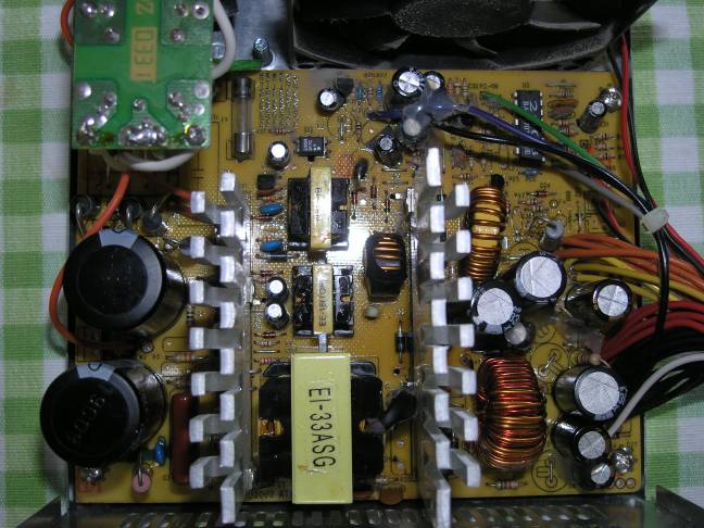

    LC-B400ATX Power Supply
    This morning, I decided to check all of the electrolytic capacitors inside my computer. All of the electrolytics on the boards were good, but there was one bulging in the power supply (C23 - 2200uF 10V, with the brand which appears to be "DON" RK series). I decided to replace this with a 3300uF 10V Rubycon unit, and as a good measure, added C28 and C22 (both 3300uF 10V Rubycon units, which were not originally fitted), as well as replacing C1 and C2 (both 470uF 200V Gincon GR series units) with Nippon Chemi-Con units. C1 and C2 were not bulging, but were replaced with better quality units as a good measure.
    Fortunately, I did this before it was too late!
    Does anyone know about the Gincon brand of electrolytic capacitors?

    Re: LC-B400ATX Power Supply
    Haven't heard of Gincon or DON brands. If that's supposed to be rated at 400W - guessing, based on the model # - I'd be really careful of cooling. Those heatsinks look pretty insubstantial for 400W.
      That's a Deer Power supply.. Given their tendency to selfdestruct, and take the parts attached to them with it, i'd highly recommend replacing it..
        I decided to upgrade all of the electrolytics in this supply (board space permitting), as well replacing the voltage reference device (PJ431) with a better quality TL431 unit.
            C8 is probably the cap-of-death. Just for fun, check the old one (if you still have it) using a meter - if it's crap, it might already have decreased value.
              C8 is the capacitor connected between the cathode and reference pins of the programmable voltage reference device, which affects feedback. I would replace all of the low-value capacitors anyway.
                When I searched for a LC-B400ATX, I found a similar power supply schematic on http://narod.yandex.ru/100.xhtml?ele...Y-B200-ATX.zip
                U1 is an optocoupler (It is a PC817 in mine). The "2003" device seems to be a bit strange, and it is apparantely proprietory to the manufactures of this supply. Good ones have a SMPS controller from a well-known manufacturer (eg. TL494).
                I think I might scrap this apparantely fake power supply (should I? ), and use the SMPS controller in a bench power supply (If I know how to wire it up). Good parts from it would also be salvaged for other projects.
                  Update: Found a very similar one on http://www.eserviceinfo.com/download.../L&C_400W.html
                  The SMPS controller is a DR0813 (another proprietory chip).
                      the chip with the odd number is usually something standard remarked.
                      often a poor job grinding the old number gives it away or you can look at the design and figure out what it is.why do they bother?
                              > When I searched for a LC-B400ATX, I found a similar power supply schematic on http://narod.yandex.ru/100.xhtml?el..._Y-B200-ATX.zip
                              Nicely drawn schematic, but there are some minor errors (no doubt, it is a reverse-engineered
                              schematic). For instance, the polarity of the lower winding of T2.2 is inverted (Q1 needs to be conducting when Q2 is off, and vice-versa, in a push-pull half-bridge topology).
                              In this case, the polarity is not a problem (since the transformer can only be inserted in
                              one orientation physically) - but it would be a problem for capacitors. Please check the schematic against the PCB very carefully before placing too much reliance on it.
