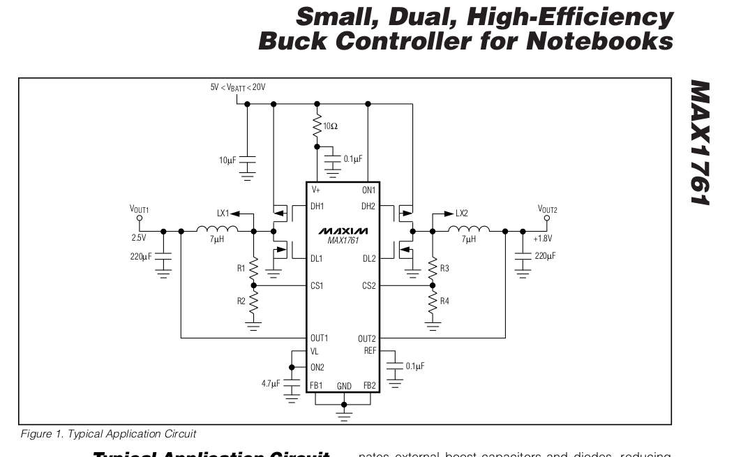

max1761 substitute ?
  • petehall347
    • Jan 2015
    • 4440
    • United Kingdom
    any substitute for this ?
    or where can i buy one for the right price ?

        Order a free sample off the MAXIM (aka Analog) website.
        https://www.maximintegrated.com/en/p...#order-quality

            Hmm. Ok. Analog / Maxim are good people. We, as a company have used very high volumes of Maxim transceivers and now about to start using their latest digital isolators.
            The requested Maxim part is showing in stock @ Mouser. Can you source from them ?
            Try also to check other agents with the FINDCHIPS search engine for parts.

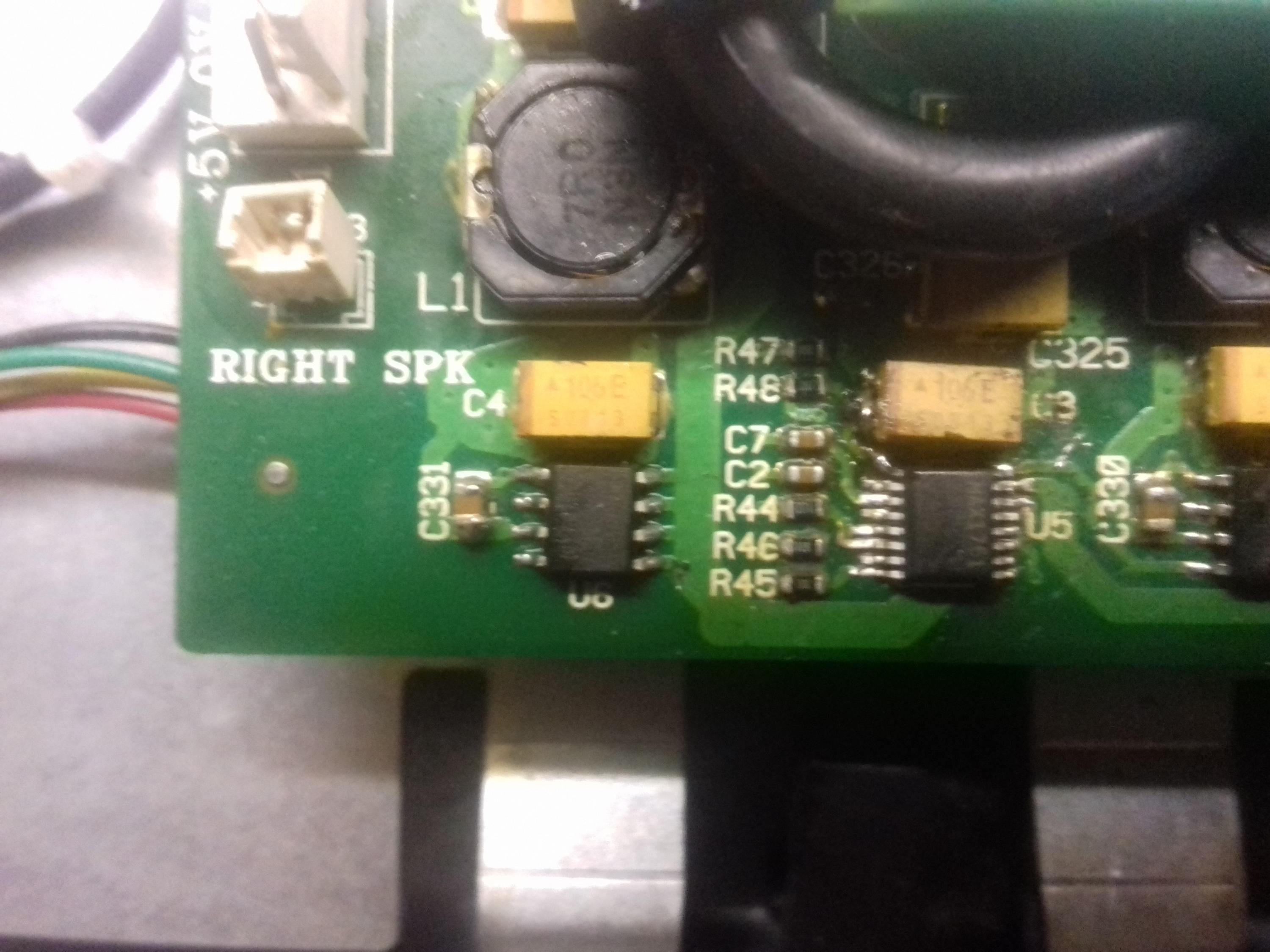

                  having big trouble getting this chip soldered in because of damaged pads on the board plus the big trouble caused by using my solder sucker to remove excess solder .i managed to bend some pins with it recoiling . thinking i might have to find a breakout board and solder wires to the best places on the pcb . they of course don't leave much room between the legs on these chips .its far to easy to short 2 together .

                      its all good because i had a spare chip so decided to just use hot air and to not add any more solder .. its now booting up although crashing after a while then booting up after 30 secs rinse repeat . then i squirted freeze spray in the general area of the processor and it now stays on longer but complains about things not plugged in so next thing is install back in the machine and see what happens ..

                                        looks like i managed to damage it ..in circuit cs1 is dead short to out1 . all i did was try a different 10 uf cap ..
                                        was trying to figure out why the 3.3v was a little high like 3.38v and rising to 3.41v with the unit shutting itself down .
                                        now the out voltage is 4.4v .
