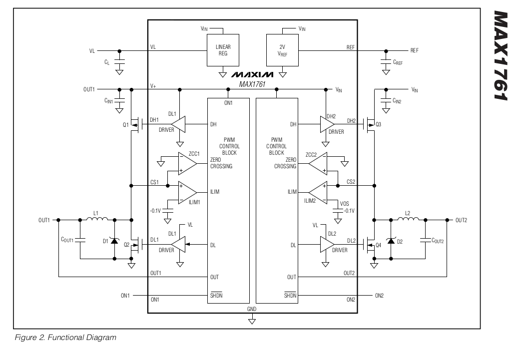

    now i think its using like this circuit as V+ and ON1 are on the same track . which means there might not be a short ..suppose i could lift the inductor to find out .
    ok out2 and cs2 appear shorted so it's more like this circuit ..i haven't noticed any zeners on the board though . there are resistors tied together which i presumed were voltage dividers .
    if anyone can help here it would be much appreciated ..i can post pics no problem .

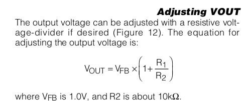

      ok have been doing some measurements ..output is now at 3.44v so better than yesterday somehow .
      i need to get it down to 3.3v but i am crap at working out voltage dividers . i have however got the voltages .
      voltage drops on the divider are ....
      r47 1.03v
      r48 2.42v .
      r48 is same as r1 on above diagram .
      r47 same as r2 .
      r47 marked 10k
      r48 marked 23.7k .
      which one is bad ?
      • petehall347
        • Jan 2015
        • 4440
        • United Kingdom
        Re: max1761 substitute ?
        ok i now have out of circuit readings for r48 r47
        r48 23.6k
        r47 10k .
        so fairly close to spec i guess .
        • petehall347
          • Jan 2015
          • 4440
          • United Kingdom
          ok from this it appears that if i increase r1 it should drop the output voltage .. thing is fb is already at 1.0v .r2 10k if i was to try a higher value then what should i use to try ? or would it not work as i would expect ?
          that equation is something i do not understand
          • petehall347
            • Jan 2015
            • 4440
            • United Kingdom
            ok found i can use my calculator .
            1x(1+23.7÷10)=3.37v . so maybe its fine after all .
