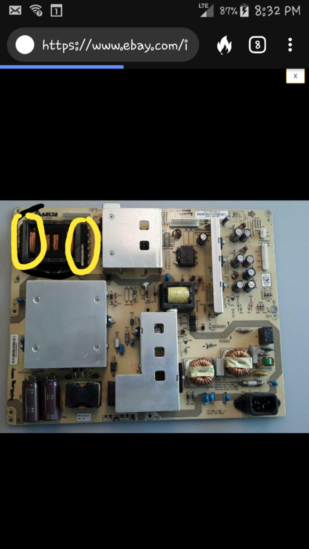

    Hi
    I have a typical lcd tv poeer supply
    I dropped the board snd the magnets on the dc transformer broke off
    Is the board no good now?
    What is purpose of the magnets mounted on both sides of transformer

      Re: LCD tv power supply transformer magnets broke off
      Cant tske a pic
      Here is stock photo
      Pieces in yellow broke off
      Will ps not operate now?
        The power supply will likely still operate, but the transformer will not operate efficiently as the core is broken and its drive circuit will likely fail when the supply is under load.
            You can try fitting the pieces back but they would not be magnetically conductive like when they were originally. If used like that I suspect the transformer could run hot as well. It would be best to replace it if you can find one from another board, maybe one that the board is beyond economical repair but the transformer is good.
                hi JR
                i glued the ferrite back in place as best i czn with super glue
                i did test the ps outside of tv i do get 5v standby so i assume tv ps will porb work but as you said for how long
                i really dont care for how long since the tv is just a project tv..i dont use it
                so tomorrow i will install it in the tv and see what happens
                  Keep us posted what happens.
                  The glued core should work, so long as you didn't increase the gaps too much.
                  If it works, also put some silicone glue to hold the core together. Superglue does not deal that well with heat-cycling and may eventually crack. So to prevent the core from cracking, silicone glue is recommended to hold everything as a "backup".
                    Hi...i did superglue it and tv powered on fine as i expected
                    The unknown is how will it affect long term use...i dont usecthectv so ill never know
                    When you say silicone what area are you referring to?
                    Can i just incase the entire ferrite perimeter in silicone? And is it just 100% pure siliccone caulking or a silicone based heat resistant glue?
                      Awesome, good to hear you got it working!
                      Well, RTV / heat-resistant silicone would be better, but it's not necessary.
                      I've used regular cheap silicone caulking (they type used in bathrooms) with pretty good results so far. Only thing to watch out for is to make sure to get one that is low VOC / low odor. As silicone cures, it may release acetic acid, which can sometimes corrode electrical contacts and metals. The low VOC / low odor stuff, IIRC, releases a little less of that so it's overall safer for electronics.
                      I don't suggest encasing the entire transformer / ferrite with silicone, as that may reduce its cooling ability. But adding a good layer over the areas where the cracks were should work fine.
