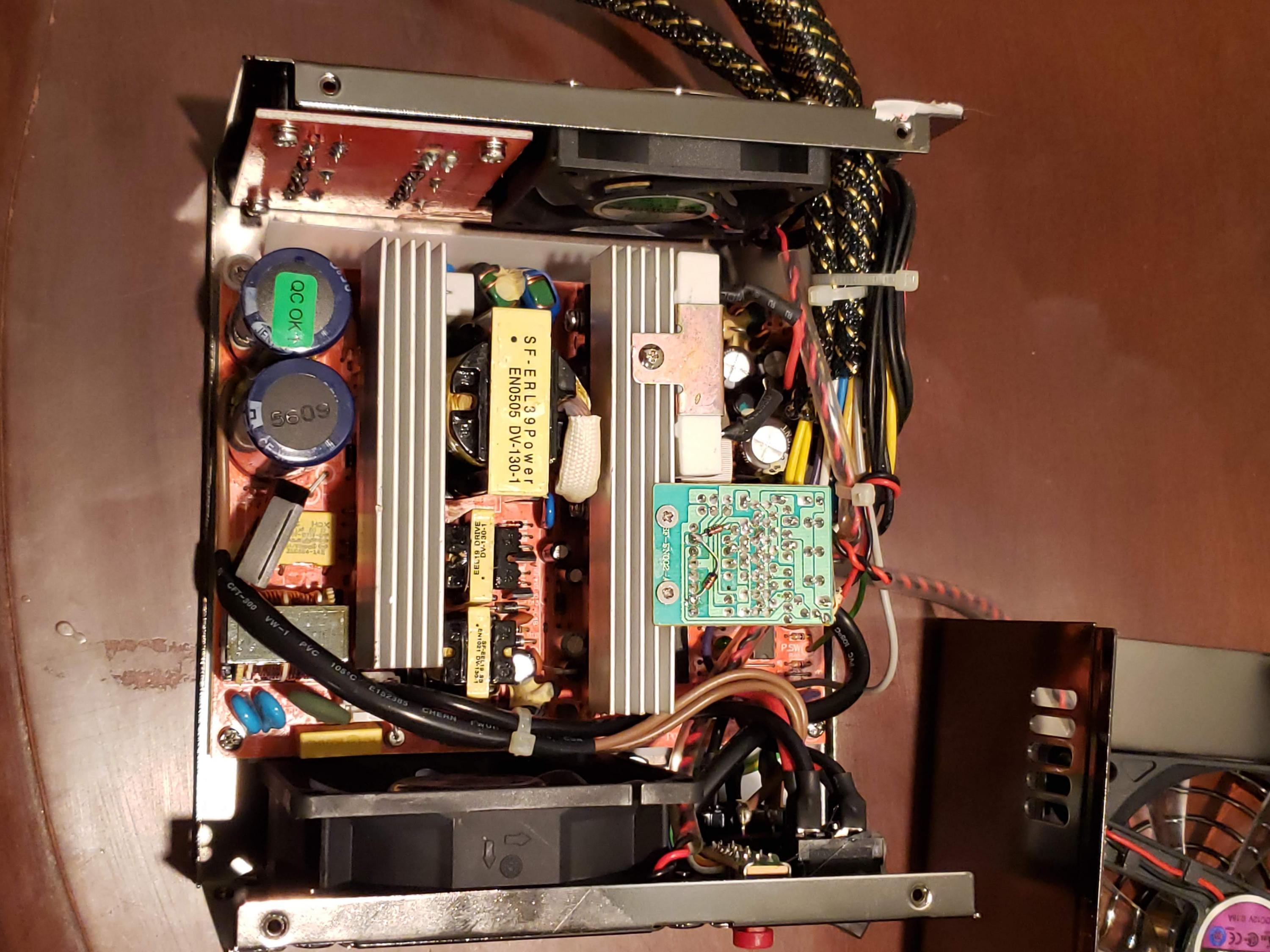

    On the input side, you can see the large Jenpo caps. There are 2 MOVs behind them. I like that the switchers are on the other side of the heatsink as to not get the main caps hot. They are two 2SC3320s. I think I will leave the main caps when I work on it.
    There is a 30A schottky on the 3.3V and 40A on the 5V. Unfortunately, I can't read the 12V output rectifier because the numbers on it are faded. As of now, I also can't tell which rail that 10Ω resistor is on.
    What do you all think of this unit?

      I didn't look inside mine yet however, but this 500W one looks a bit overrated, seems to be fine for 300W or maybe 400W tops, it at least has 1000uF primaries (though would be half since they're in series). Transformer looks tiny however, so not 500W. But it has one heck of a lot of fans, maybe it will work...
      I do think the 1000uF caps wwould help the switchers reach their max potential. The 39 transformer isn't that small and I think Super Flower designs PSUs pretty well. I do know that they've got 500W out of a half bridge unit with an ERL39 transformer before in a Kingwin branded unit. As for this unit, I think you're correct. The heatsinks couldn't handle it, especially with that 10W resistor adding heat and taking away some of the surface/air ratio.
      I'm really curious about the 12V rectifier. Either way, nothing I will put this in will pull more than 150-175W so I think it'd be a great unit for that and even help get rid of some of the chassis air

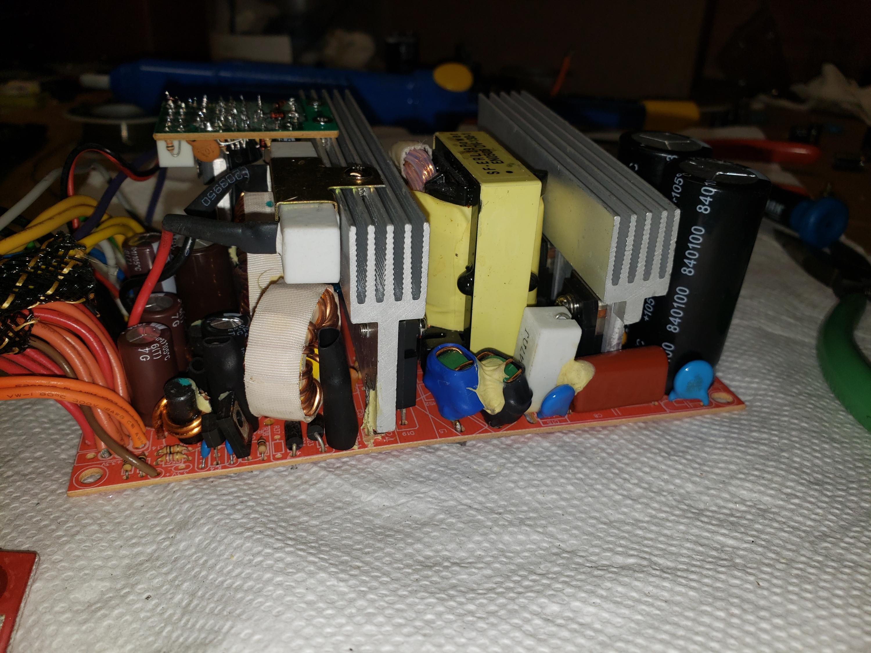

            Looks decently packed with components.
            I can't see the output toroid to tell you more about its capabilities, though.
            If it has ~1" (25 mm) diameter output toroid... output power will probably be capped to around 300-350 Watts. With the next size up (1.3"... or ~33 mm diameter), that can stretch things out to 500-550 Watts.
            Is it in a TO-247 or TO-3P case? If so, it's very likely a 30 Amp part... which for half-bridge topology means you can actually pull the full 30 Amps out of it. So if that's the case, then at least the label for the 12V rail is not a lie.
            Only a matter if the output inductor can handle that kind of current, particularly when cross-loaded with a light 5V-rail load.

            Classic half-bridge design with a cool/funky case. Should do nicely for systems under 200 Watts total. It's got a strong 5V rail, so can also power retro Athlon XP rigs or dual PII/P3 machines as well.
            I think that's only how it looks in the picture, due to the case of the PSU being larger and because the heatsinks and primary caps are also big.
            If the main transformer is a "true" 39-size (meaning, it measures 39 mm across the top, length-wise), then it could / should be able to technically handle 500 Watts... though probably peak power. EE/EI/ERL35 can usually do up to 350 Watts and ~400 Peak. So EE/EI/ERL39 is just a step-up from that, extending to about 400-450 Watts generally.
            The primary heatsink looks big enough to handle that power. The secondary one... maybe! Regular Schottky rectifiers waste a lot of power / heat up a lot, due to forward voltage drop, compared to almost no voltage drop on modern-day synchronous rectification designs (almost anything high-power nowadays.)
            But I think the biggest limit for the output power is the output toroid/inductor. See remark I made above. If it's a small T106-26 core, forget it to do more than 300 Watts. Even a T106-52 will run rather toasty at that power level. For power above 300 Watts (but not more than 500 Watts), usually a T130 core size is needed (preferably a -52 core for lower losses.)
            Yeah, the 1000 uF caps (500 uF total capacitance due to series connection) should be plenty for 500-600 Watts.
            I mean, many modern cheap 500 Watt APFC PSUs have only 270-330 uF on the primary side. Sure the APFC boosts the voltage, so that means higher energy storage despite the lower capacity. So in the case of older PSUs like this with no APFC, the voltage is lower, but the capacity is higher... so energy is somewhat similar.
            A 500 uF cap charged to 340V DC has about 28.9 Joules.
            A 330 uF cap charged to 385V DC has about 24.5 Joules.
              I took some better pictures so you can take a look. It's worth noting that the fan control thermistor was stuck in the middle of the main output toroid.
              5V and 3.3V are TO-247. The 12V is TO-3P. I was finally able to check it... it's a 16A ultra fast This actually severely irritated me, damn it, Super Flower!
              Seriously. In an era of Prescott Pentium 4s and the 89-110W TDP Ahlon 64/FX CPUs, you seriously thought 16A was enough??? Just the CPU alone would use up most of that part under extreme loads. Not even counting fans, motherboard, VRM efficiency, GPU, hard drive(s), DVD drive(s). The other annoying part is I don't know how it will react to a shottky. I only have up to 20A ultra fast parts. I have plenty of brand new 30A schottkys but sometimes half bridge units don't like them. So I have to take apart the stupid thing, put one in and test it. Worst scenario, I will put in a 20A ultra fast and just use it with a lower TDP CPU.
              More than likely, it's *not* the 12V rail (that would equate to 14.4 Watts of power dissipation.) And probably not the 5V rail either... but no guarantees. Usually such low values (20 Ohms and under) are on the 3.3V rail.
              You're probably right, it's most likely on the 3.3V. The leads are oddly separated. I won't be able to tell which rail its on until I take it out and trace it. I would love to just remove it. You think it would go haywire if I fully removed it? I could also just reuse those heatshrunk leads to put in a 50Ω or 100Ω resistor there.
                    https://www.badcaps.net/forum/attach...1&d=1643594884
                    Thanks!
                    Main output toroid doesn't quite seem to reach the height of the secondary heatsink. And the secondary heatsink isn't too tall due to the overhead fan... so I think the output toroid probably uses a T106-26 core. (The "106" specifies the outer diameter - i.e. 1.06", or 25 mm. And -26 is the core material type: powder core up to 50 KHz with average losses. This, you can tell by the color: yellow core with white paint on one side is -26 type. In contrast, light green core with blue paint on one side is -52 type. -52 type cores have very similar specs as -26 cores, but with lower losses at higher frequencies, so they tend to be more efficient.) T106-26 is probably only good for up to about 250 Watt PSUs (maybe 300W peak.) T106-52 core would have been better here and could allow probably 300-350W designs. For anything above that, I usually see manufacturers (the good ones like Delta, HiPro, and LiteOn) jumping to a T130 size core.
                    Oof!
                    Yeah, that's very underwhelming, considering the label claims 30 Amps on the 12V rail.
                    And it's even more of a shame, because the primary side is perfectly adequate for the task: 1000 uF input caps, TO-3P switching BJTs, and ERL-39 transformer.
                    Hey, I've ran a system with an Athlon FX-57 (103W TDP) and a GeForce 6800 XT (~50-60W TDP) on a HiPro PSU rated for 16 Amps on the 12V rail just fine. It did run quite warm, but it has the heatsinks for it (though it probably didn't help that it was a "transfused patient" PSU, using the guts of a HiPro in a case with fan from another PSU that had much worse fan.) That HiPro has only a 20 Amp rectifier on the 12V rail and it's a single-transistor forward config... so the 16 Amp rating really is 100% accurate. I also pushed the same PSU (prior to this setup) with an Athlon 64 3500+ and a ATI Radeon HD3870 video card.
                    So 16 Amps was actually acceptable for a PC back in that era... though kind of mid-range-y. 22-25 Amps would have been what the "high end" PCs back then would need (unless we are talking about GeForce 8800 GTS/GTX/Ultra - those were power monsters! )
                    But then there's the output toroid too - if it really is only a T106-26 part (try to measure its outer diameter), there won't be a point to go with a very highly-rated 12V rectifier, because the toroid will probably overheat way before you reach the limits of the rectifier. I actually ran into that issue with my Inno Power (Macron) MPT-301 when I used it on a very heavy 12V system (Pentium 4 Northwood + GeForce 6800 XT AGP) - the PSU got very very hot. It didn't shut down or die or do anything weird. But I can tell you it wasn't happy running such a 12V-heavy cross-load. I did a similar load test later with a NiCr heating element wire, and both extreme 5V-heavy and 12V-heavy cross-loads got the output inductor very very hot - over 65C!
                    I think that's why they stuck the thermistor in the output toroid of this Mad Dog PSU as well - SF probably knew that output toroid will be one of the hottest-running parts in the PSU at high loads.
                    Of course, if you have a type-K thermocouple and don't mind playing with the PSU a little while under load, you can see if that really is the hottest part or not.

                              So I finally got around to this thing!
                              Hard wired it to 115AC.
                              I decided to keep the 12 rectifier.
                              I removed as much glue as I could, or at least where it could cause a short.
                              I replaced the Jenpo caps even though they tested good on ESR (but one step down in capacitance, they're actually 820uF.) They both read 0.11Ω. Something about them not getting any power for 12 years just bothered me. I may use the Jenpo caps elsewhere, I just don't ever want to take this PSU apart ever again
                              The Jianghai caps actually test 1000uF and are rated for 105C, versus the Jenpo @ 85C
                              I had already invested so much time in this, I didn't end up messing with the minimum load resistors but I put heatshrink on all of them to try and help the caps. Especially with 3 fans, I don't think their heat will cause any problems.

                                Nice work, good to see this retro PSU (electrically) restored the way it should be!
                                I think it will be fine with the original 12V rail rectifier. Maybe just put a sticker on top of the original sticker to indicate the real limit is 16 Amps / 192 Watts... which is not too shabby. Should be OK for a retro P4 rig with a decent retro AGP GPU... or an Athlon XP PC with a high end AGP GPU pulling power from 12V rail if CPU pulls power from the 5V rail (to balance the loads on the PSU.)
                                BTW, any particular reason for removing the voltage selector switch?
                                I prefer to leave it in there or even add it if I have a spare one.
                                In my case, though, I've had to ship PSUs to relatives in Europe... and now that I moved there too, it's nice to just slide the red switch and have the PSU 230V-ready. I do have a bunch of PSUs and other electronics that don't have this switch, though. So I need to either find them a switch or re-wire them for 230V.
