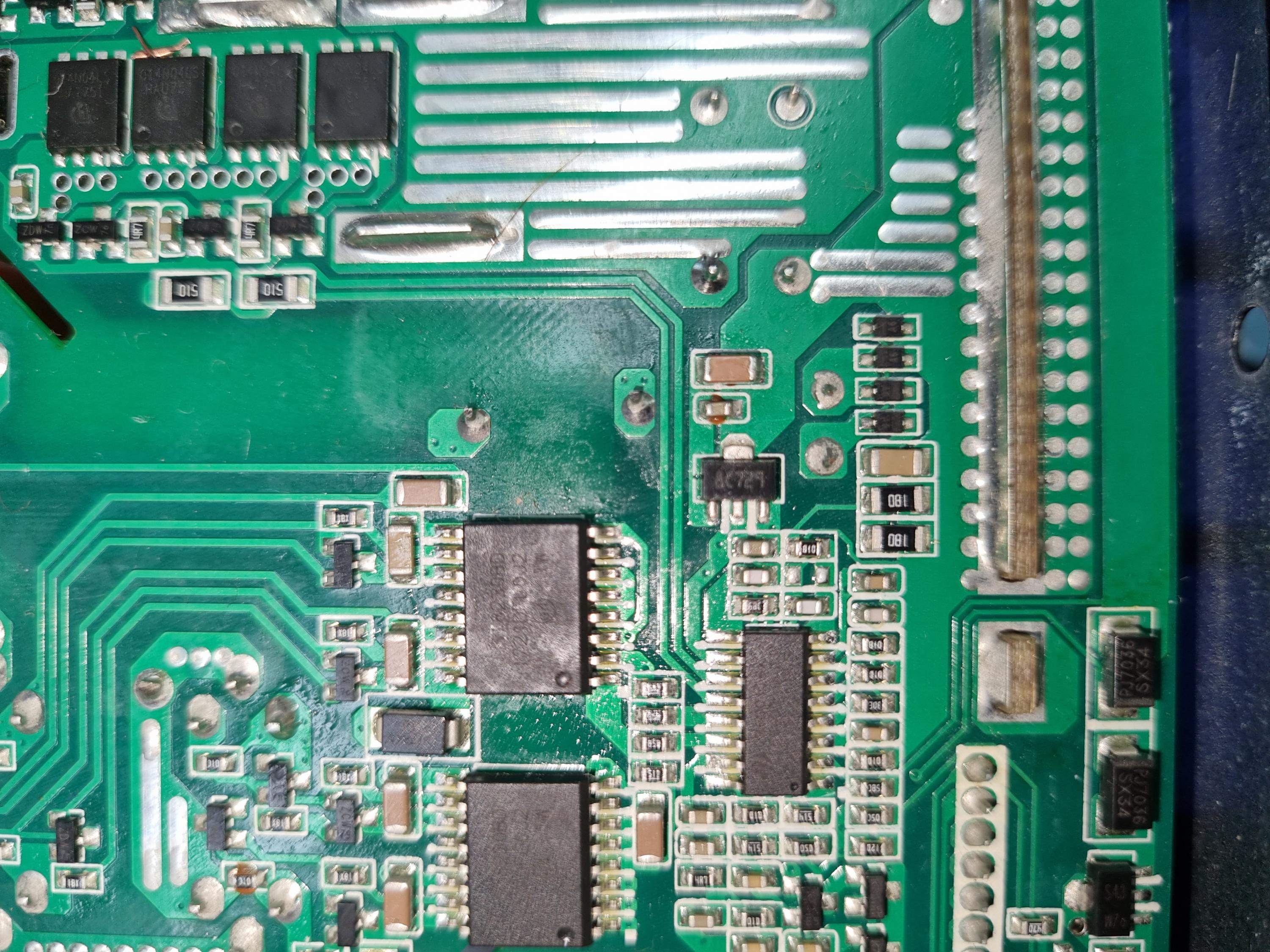

    Hi guys can anyone identify this please
    It's in a 1500W ATX PSU
    Marking looks like BC729 or 8C729 but the B or 8 is a funny symbol with the top ha1lf smaller than the bottom half
    I suspect it is a voltage regulator
    The centre pin/tab goes to ground
    The right pin goes to a CM6902 PWM chip VCC pin and only has 0.5V
    The left pin has 0V but I think it should go to a 16V rail on the 5V STB
    transformer but the PCB is too densely populated to see how it would get there on the other side.
    On this side it only goes to two capacitors in parallel, the other end of the caps goes to ground. These look like they are input caps to me

    It looks more like an A or underlined A to me,but it could be the makers symbol
      • 20745
      Re: can anyone identify this device BC729/8C729?
      Pin 2 counting from the bottom left goes to pin 10 of the 16 pin IC below it. Post the part number of that 16 pin IC, if there`s a datasheet available with a typical application circuit,it might help to ID that part

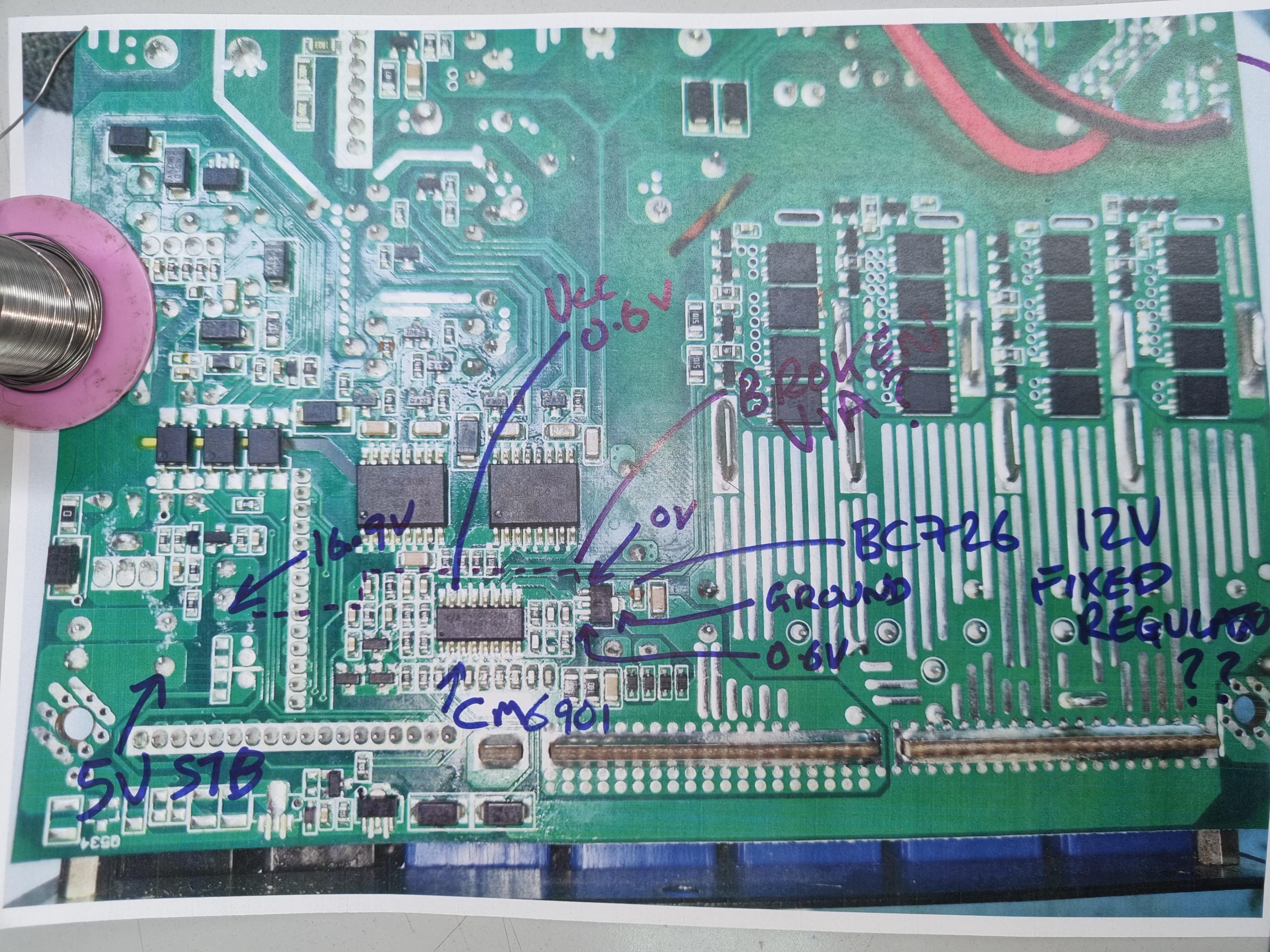

        The PSU is Kolink Continuum 1500W Fully Modular 80 Plus Platinum
        The 16 pin chip is CM6901T (typo in OP) Pin 10 is ground
        https://pdf1.alldatasheet.com/datash...MP/CM6901.html
        The possible output from the regulator goes to pin 15 (Vcc) on the CM6901T
        The middle pin (pin 2) is ground
        The left hand pin which I only see connects to two capacitors (input?) has 0V - and the other side of the caps is ground
        Vcc on CM601T on 15 is 0.5V - it should be 10V-20V according to datasheet
        The 5VSTB generates another rail 16.9V which is present
        I think the mystery component is a 12V fixed regulator and there is a bad via or damage on the other side of the PCB that I can't see which is beraking the connection from input of BC729 to 16V - which also goes two two vias to the component side (visible)
        The PCB is too densely populated to check without removing a lot of components - if it is confirmed input pin on a 12V regulator I will bridge a wire to 16V rail.

          This is what I know and what I am thinking...
          See pic
          I showed 5V STB on the ground end of the capacitors, it is of course on the other end

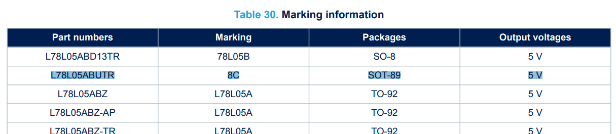

                  8C729 (8Cxxx) - L78L05ABUTR
                  • R_J
                    • Jun 2012
                    • 9535
                    Re: Kolink Continuum KL-C1500PL can anyone identify this device BC729/8C729?
                    lotas beat me to it, but I agree 8C729, and the 8C being a +5 volt regulator, 729 date/mfg code

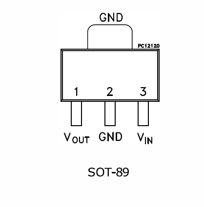

                          The "8Cxxx" has a different pinout, the input voltage is supplied to the right pin, and the output voltage of 5 volts comes out from the left pin.
                          Look for where the voltage comes from, which is applied to the right pin.
