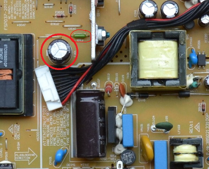

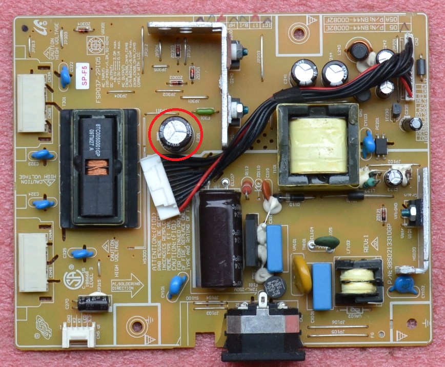

    BN44-00082F no backlight
    Hello to all
    I have a problem with this power board, it does not produce the backlight, I have the power led working but the monitor does not show signs of an image, when it stopped working I found the capacitor highlighted in red exploded but nothing else, I replaced it but the problem persists
  • lotas
    • Jan 2016
    • 4759
    • Russia
    Re: BN44-00082F no backlight

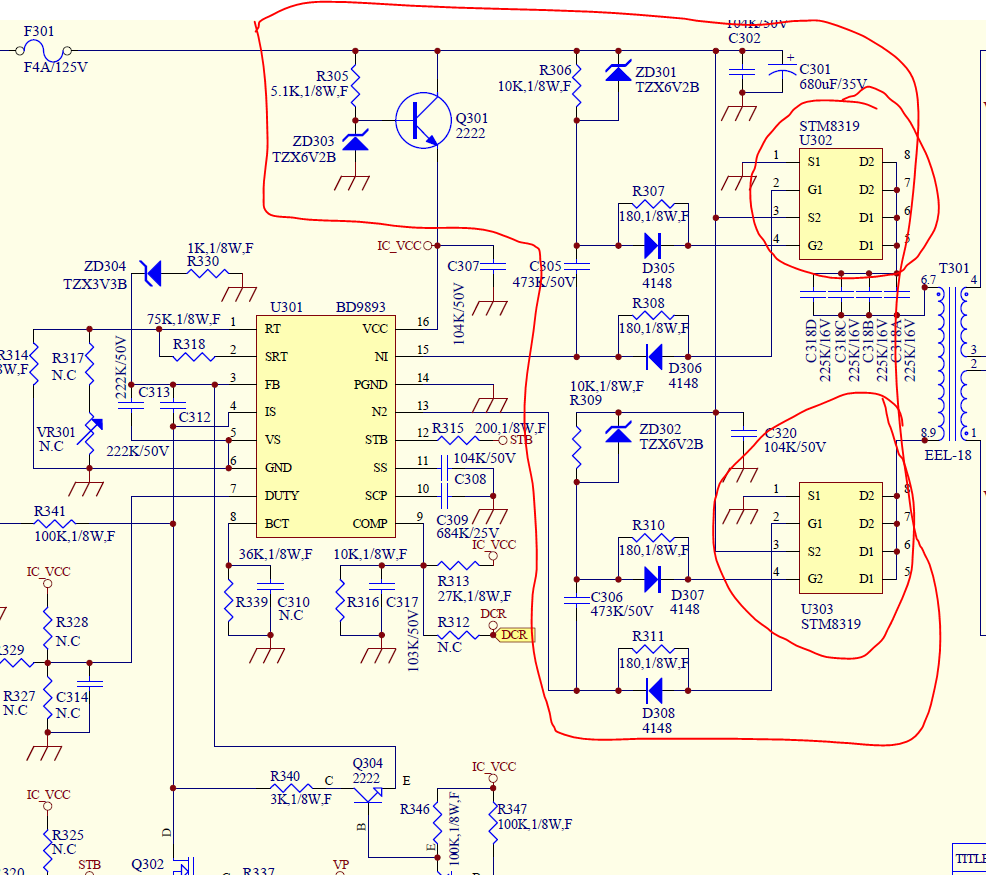

    Check out fuse F301 and here's a diagram to help you figure it out.

          I finally replaced the fuse that I had to order, there is still something wrong the lamps do as if to turn on but they can't, they flash as if it were a stoboscopic light, what could it still be?
          • falcontech
            • Oct 2013
            • 477
            • italy
            I realized that when this event occurs, the power LED also flashes as if there were some exhausted electrolytic but nothing is visible on sight, in addition to replacing the exploded one I also replaced the largest one but the situation has not improved

                        Check the resistance of T301 secondary, this is the transformer that produces the high voltage for the lamps.
                        Is this where the hiss seems to be coming from?
                        In some cases those small blue disc caps have shorted and burned, it may be that one of them is arcing internally causing the hiss.

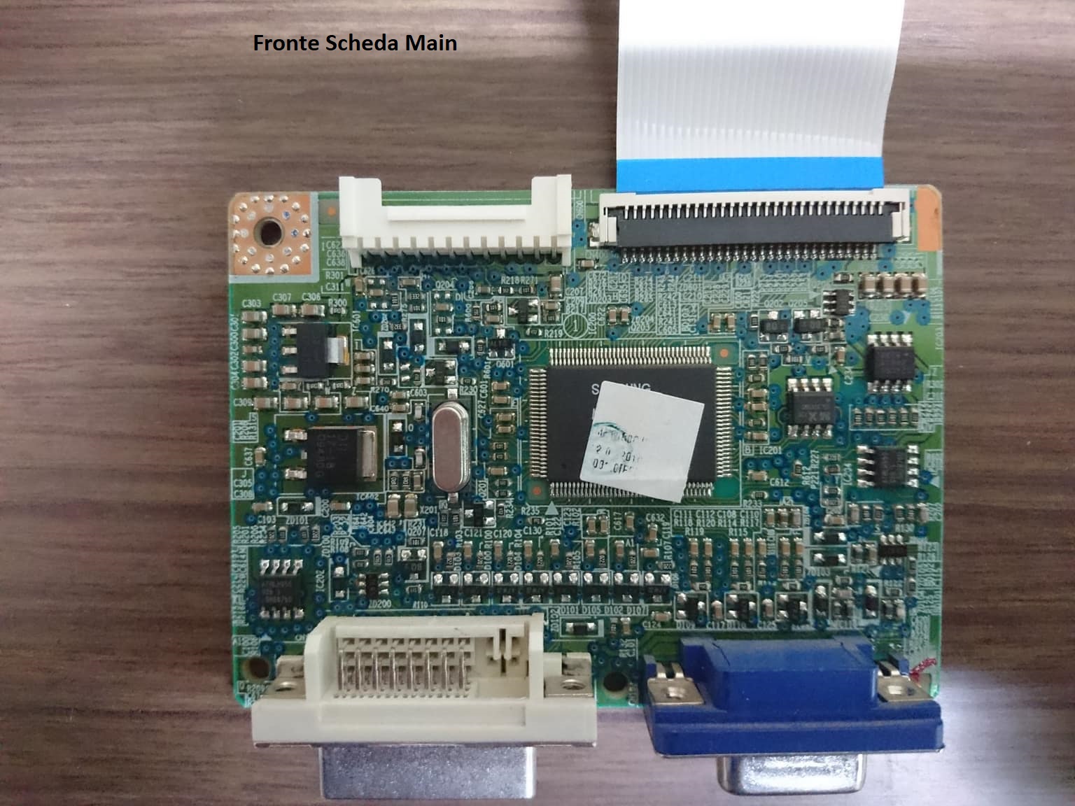

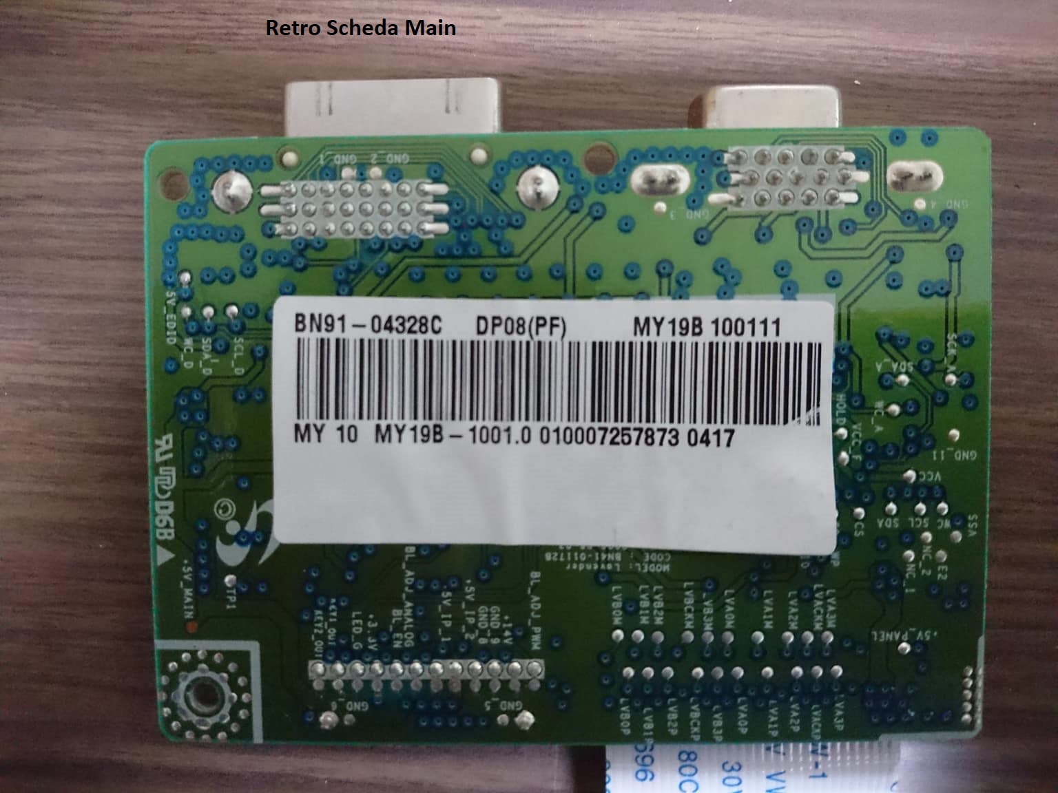

                                  as I said earlier I have already replaced all the electrolytics, the doubt arises that it could be the bd9893f, what should the voltage on the electrolytic be blown? as I told you I measured about 15 volts, its capacity is 680uf 35v
                                  • falcontech
                                    • Oct 2013
                                    • 477
                                    • italy
                                    I replaced the power supply board, but the problem persists, at this point I think it is the board with the video inputs, to exclude the power supply board there is a way to turn on the lamps without the board in the picture in order to understand if the power supply really works, without the video card there is no ignition so I will probably have to short two pins to make the lamps light up, if you need a photo of the pinout I can do it thanks
