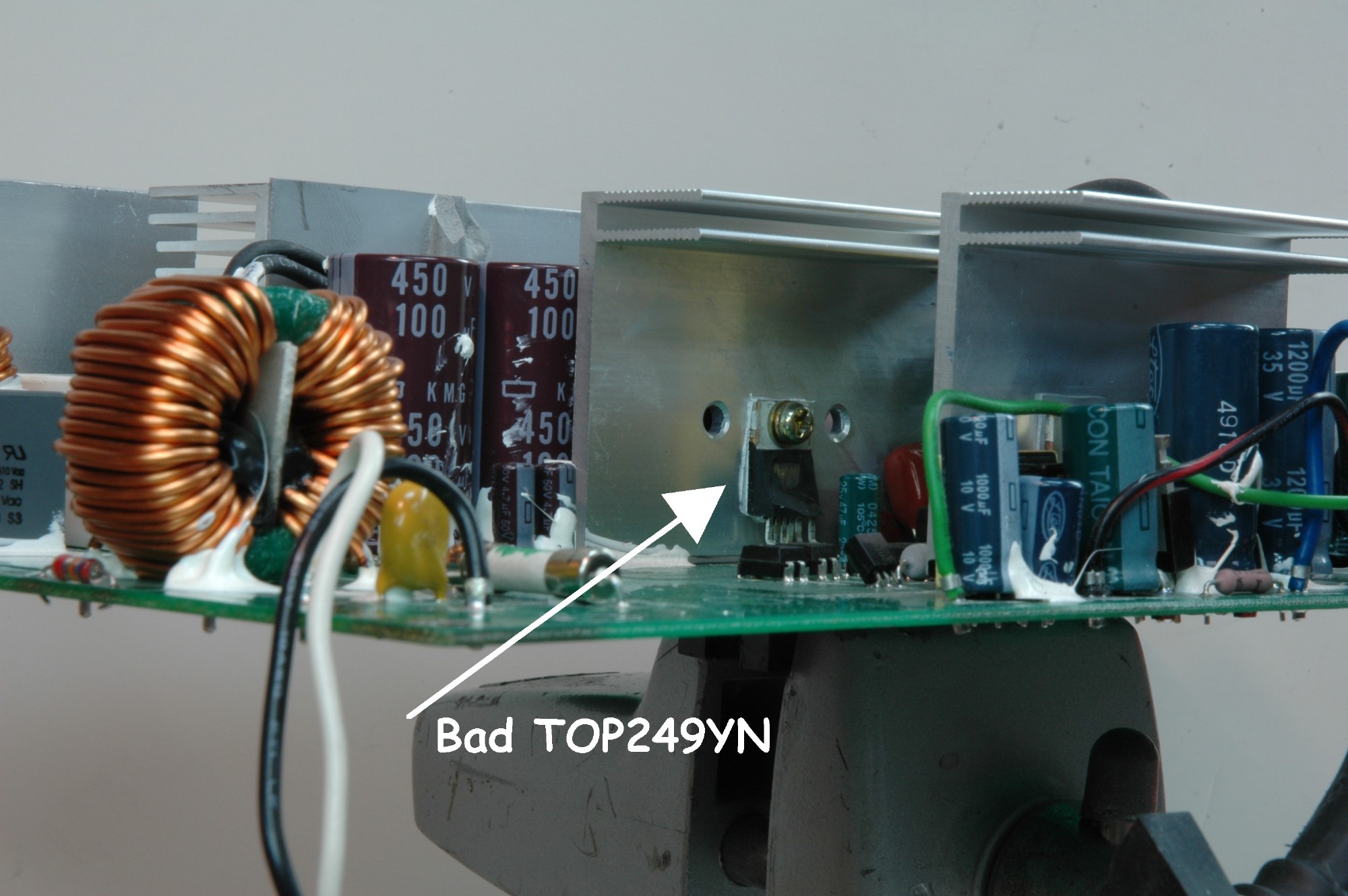

    LiteOn PA-6601-1A (600w) blows its TOP
    Have several 600w power supplies which have taken out a TOP249yn upon power up. Just blew the face right off each one with no other signs of heat or damage. This supply is used in PMG5. Anyone had a similar experience? It's marked U801.
    • 31070
    Re: LiteOn PA-6601-1A (600w) blows its TOP
    topswitch often usees a small electrolytic to start running.
    often 22 or 47uf.
    always replace it, and use a good 105' type.
    if the cap drops in value the top will pulse and you will hear a tick sound.
    if you leave it long enough it will explode.
    i'v had to fix dozens of these in satellite boxes.
        Sorry, it's a PowerMac, Toasty. The Apple part # is 661-2904. I know someone posted on one before but didn't follow through.
        Question for stj -- the topswitch does have a TAICON 47uf/25v cap as you describe. Are chances good just replacing it and the TOP249YN will fix it? Also, I have some which have blown the R302 (100ohm/2w) resistor by the L301 transformer. No signs of heat or burning. Any ideas would be appreciated. Thanks.
          • 31070
          always replace a startup cap when you work on something.
          if the top blew you need to check any diodes & resistros too.
          in the stuff i was fixing, when the top went it took the fuse, a fuseable resistor and sometimes other stuff with it.

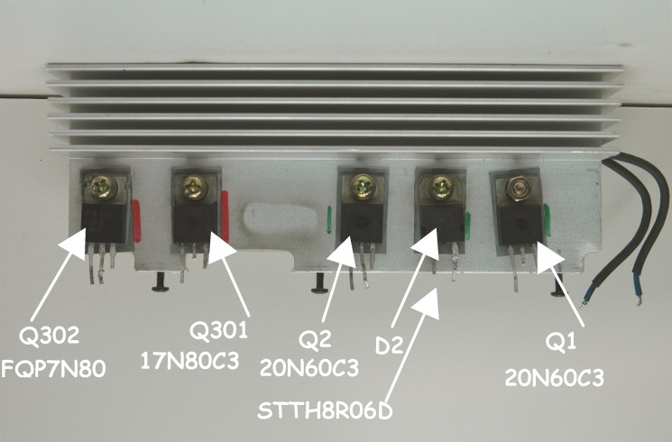

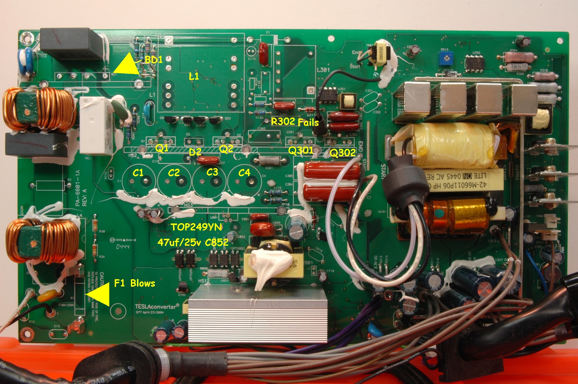

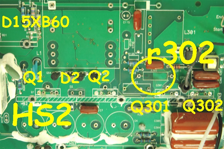

                        Attaching some pixs from supplies I've been working. Two basic problems- on some the F1 and R302 (2w/100ohm) resistor fail; the other U801 a TOP249YN blows the face off and no other apparent damage. I've been looking at HS2 which has two MOSFETs (Q301 & Q302). Q301 is a 17N80C3 and Q302 is a FQP7N80. Q1 and Q2 are 20N60C3s and D2 is a STTH8R06D rectifier. I have to pull from a parts board for replacements so I'm wondering if there's any way to test them on the board. My desoldering equipment leaves something to be desired. Anyway, with a DVM Q301 doesn't appear to turn on/off on boards that blow F1 and 302. Is that the kind of dead short that would take them out? I'm hoping the attached pixs might provide some ideas and direction to look. Any testing techniques also would be appreciated. Biggest issue so far is desoldering stuff without damage.

                              • Quasar
                                • Sep 2010
                                • 132
                                No real way to test it except to see if it's shorted. Better to follow the path R302 is in and see where it leads to. I suspect it is connected to Q301 somehow. That may be the problem device.
                                Take a pic of the back of the board at R302 so we can see what or where it connects to. Something like the 3rd pic from godonr did above, only on the back. Are there any devices mounted on the bottom of this board?

                                  I'm working on 3 of these LiteOn power supplies. Two have F1 blown, R302 burnt and Q301 is bad. Both had a significant amount of dust inside. The third has blown F1 and Q301 and Q302 are bad. The bad MOSFETs show short between the drain and source (pins 2 and 3). I am attempting to locate a suitable substitute for Q301, as the 17N80C3 part seems to be obsolete and is not stocked at mouser or digikey.

                                      I'm in the process of fixing my Liteon PA-6601-1A as well. On my power supply, Q301 was shorted, which caused R302 to burn and F1 to blow. I also found that C301 and C302 were both burned. I was able to find replacements for Q301, C301, and C302 at Digikey, but I'm not quite sure what to replace R302 with. It is marked 100 ohm - 2WJ - 534. I located some 2 Watt 100 ohm resistors with +-5% tolerance. I think the "J" marking reflects 5% tolerance. It appears to be a wire wound resistor, but I'm not certain. Does anyone know if this is a wire wound resistor and if not, what type is it. Furthermore, would it really matter which type I replace it with?
