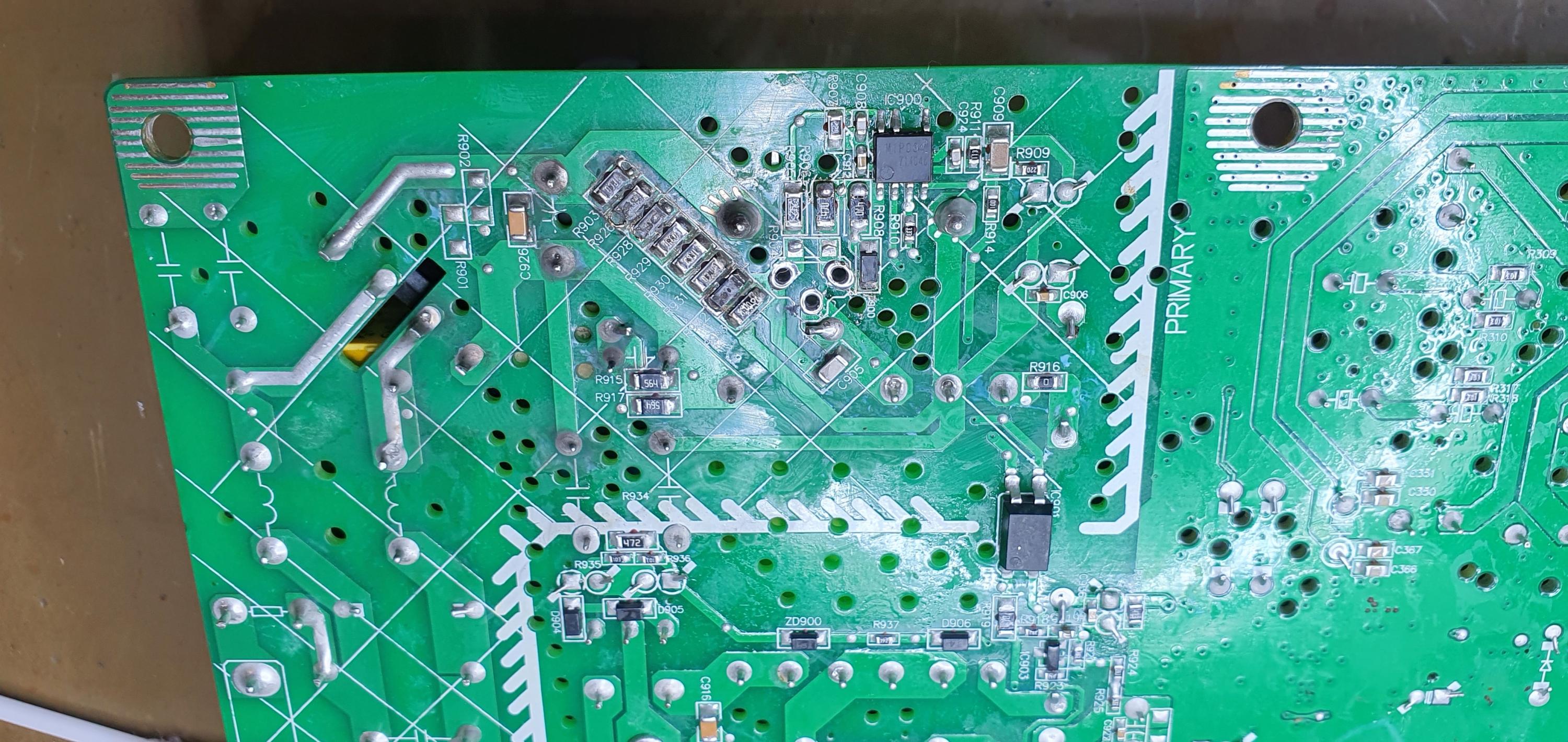

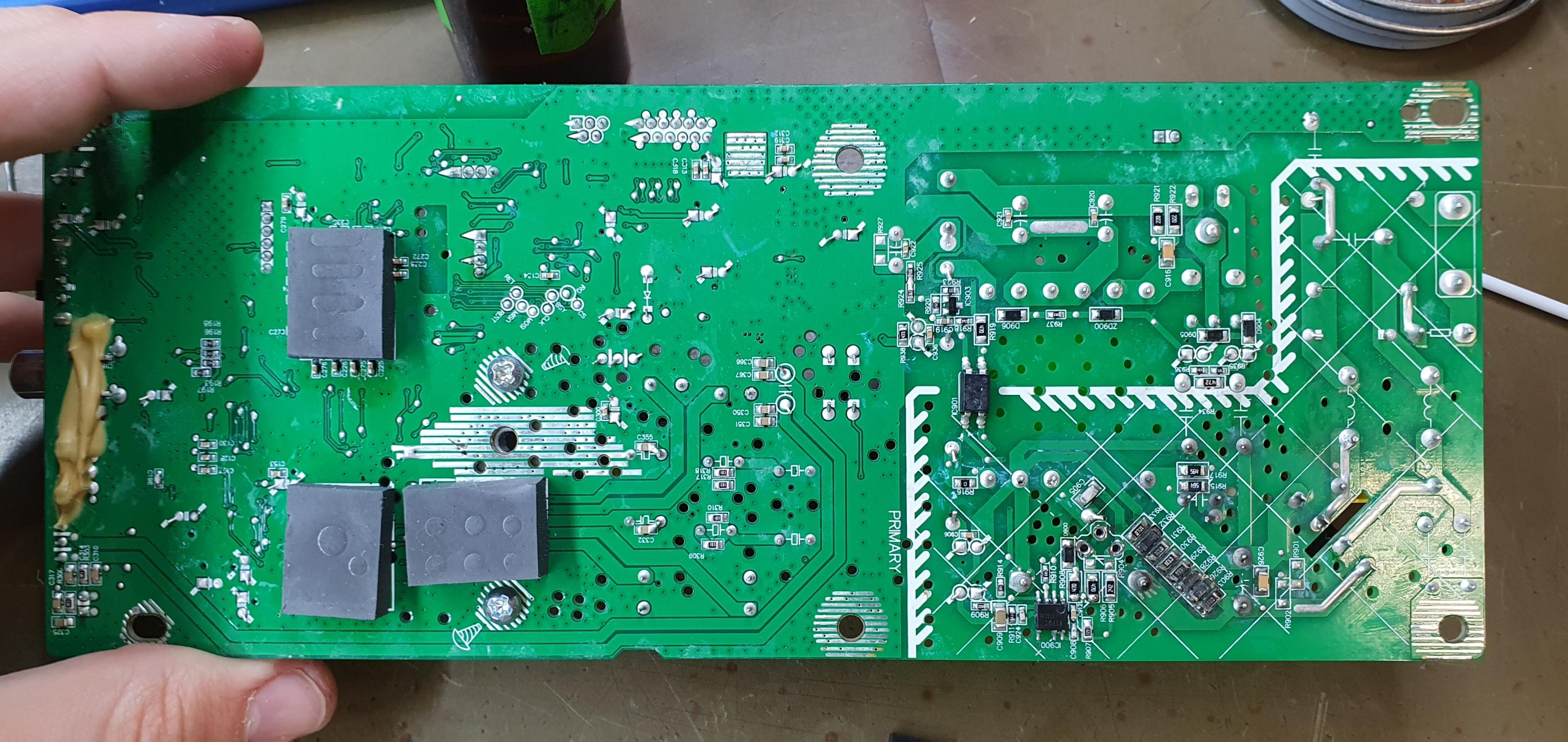

    Good day folks. I had a look at this soundbar from Panasonic today and it seemed like an easy enough fix, but then I got stuck.

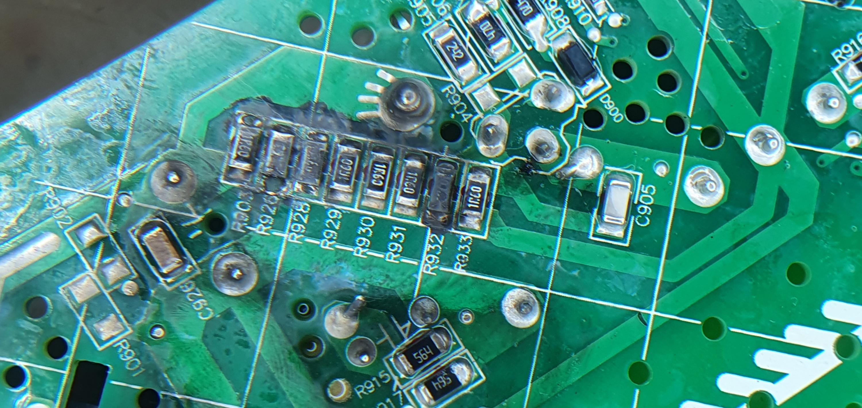

    Have a look at that fried primary. I reckon the transistor popped and took out the current sense resistors with it before the fuse could open to cut the power. I thought I'd have a hard time figuring out what values those are, as it usually happens when SMD resistors go up in smoke, but thankfully I was able to clean them enough to read 1r60 on there, which is 1.6ohms, so that was sorted - we need 8 of those.

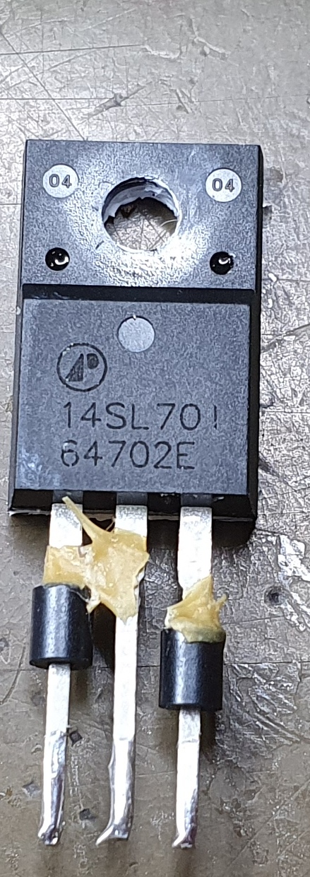

    On to the transistor: it's one of those mystery parts that no one's heard of. 14SL70....what could this be ? Ironically, it has a little logo there too, but all searches come out empty. I tried everything, including sourcing a service manual, but that didn't yield any results either....I'm tempted to just dig through my parts bin and pick one out semi-randomly. I'm hoping the control IC survived, because the small passives around it are fine, so I'm hoping something from the FQPF series will work in place of the original one. It claims to be a 120w amp, in case someone wants to suggest something based on past experience, enough to be in the ballpark. As always, thanks for any help. Cheers.
    Wattevah...

    Regards the F E T , you can probably match up another . By the numbering seems to be rated at 14 amp , 700 volt . I don't recognise the manufacturer logo either .
    I would replace the drive chip also . Doubt it would have survived .

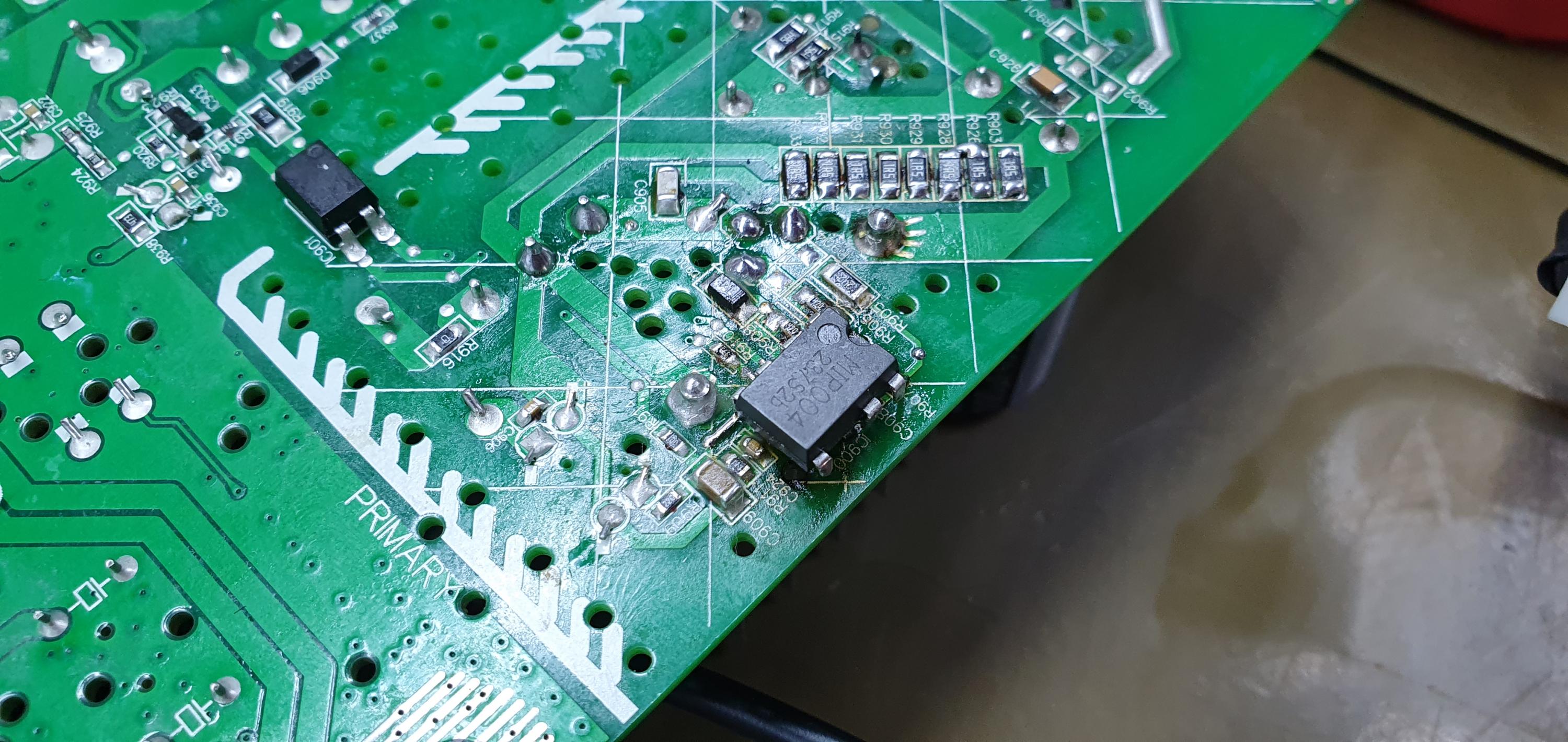

      The driver IC is also tough to find info on. I don't have the board in front of me right now, since it's at the office, but we can just about make out the part number in this pic....
      I'd say it's MIP034c and below 714c4? (C or 0) - we won't know for sure until I look at it up close, but it doesn't matter because I tried every combination and nothing came up - HATE it when manufacturers do this and somehow manage to source the most obscure parts on the planet

                  Ok, I made some more progress on this thing: I actually managed to find the IC: it's a MIP004, when I thought all along the second 0 is a 6, so there IS an official Panasonic datasheet for it here. It's probably dead (Jim ), since the two 47ohm SMD resistors next to it are open-circuit, so I'm not risking firing it up like this.
                  For the FET, I dug through my drawer of transistors and after comparing and contrasting several types, I think I'll go with the P14NK50ZFP.

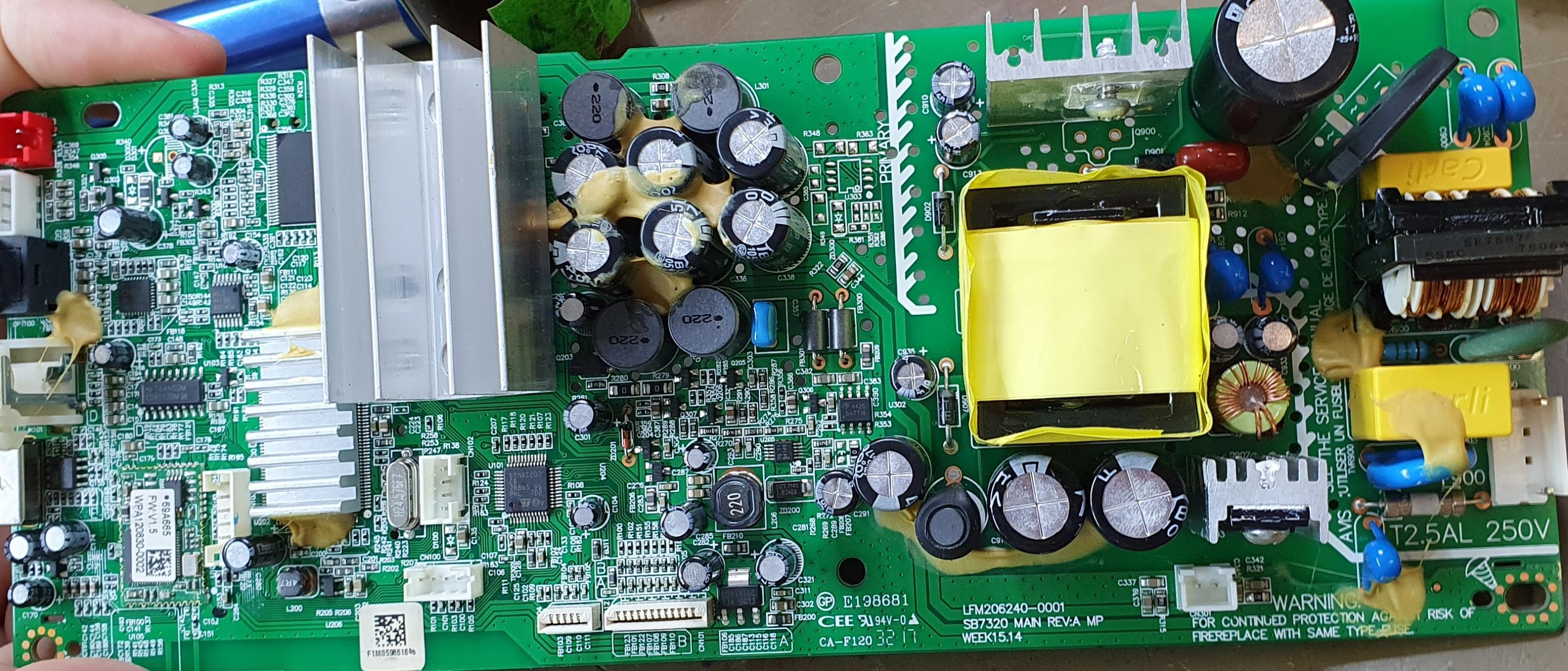

                      Re: Panasonic SU-HTB18 dead power supply (unidentified transistor)
                      Ok guys, believe it or not I got this thing working I wasn't able to find a MIP004 IC in SMD form, so I got the DIP package instead - better than nothing - and botch-soldered it where the original SMD one used to be. I didn't want to use wires and extend the leads, which would've obviously made the job easier, because I was afraid the added resistance/capacitance would cause interference somehow and cause stuff to pop, so I kept everything as short and compact as possible.
                      Amazingly, it works, even in that ghetto state I sure hope it LASTS, especially once the subwoofer is connected which increases the load on the power supply, since I'm not sure what the specs of the original transistor was. I went with a P14NK50ZFP for reference.

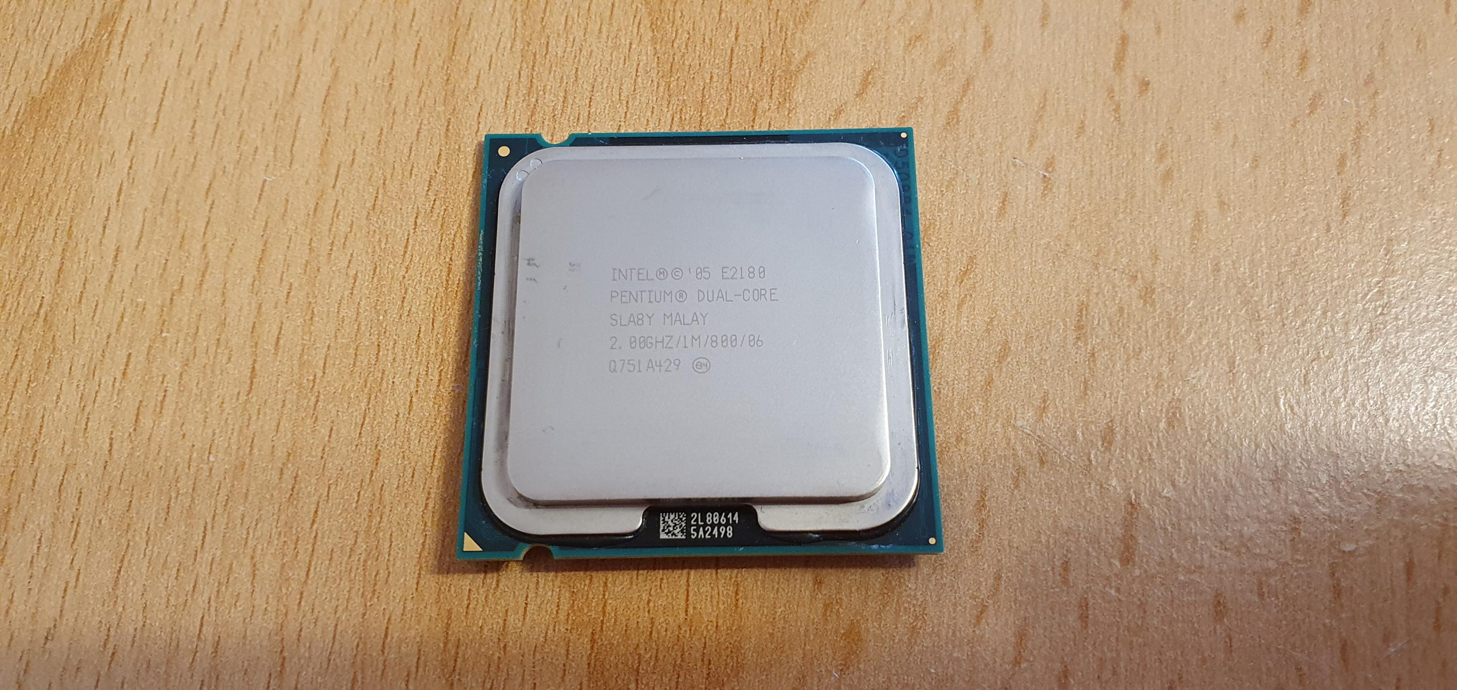

                        Just realized I mistakenly attached a pic of a CPU I was trying to sell too

                            I found that the manufacturer is Advanced Power Electronics Corporation (APEC, not ApECOR - there are two companies with the same name), but I didn't find that part.
                            http://www.a-power.com.tw/index.aspx?lang=eng&fn=index

                                      14SL701
                                      • R_J
                                        • Jun 2012
                                        • 9588
                                        Seems to be AP14SL70I, I did find a datasheet for a AP14SL50I which might help
                                        Their website is Products | A-Power
