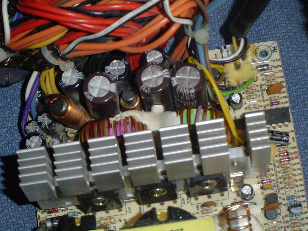

    Dear All,
    refer to this thread ==> https://www.badcaps.net/forum/showthread.php?t=4986
    sometimes, after recaps the power supply output capacitors (on Pi filter) with better quality/lower ESR caps could made filter ability worst than original caps.
    I was saw on my PSUs, they used JPCE-TUL (brown sleeve) in place before Pi filter, and JPCE-TUR (black sleeve) after Pi filter.
    I would like to recaps them with same/near ESR caps but I can't find datasheets of JPCE-TUx caps.
    If anyone has their datasheets, please upload them. or If anyone has those caps and has ESR meter, please measure their ESR for me.
    Thankyou in advance.
    Any suggestion welcome.

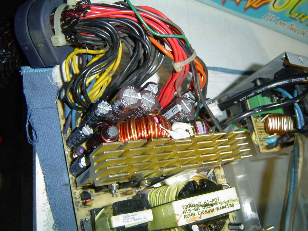

    Enermax EG365P-VE
    3.3V 3300/10V.12.5mm.TUL - L - 2200/10V.10mm.TUR
    5V 3300/10V.12.5mm.TUL - L - 2200/10V.10mm.TUR
    12V 2200/16V.12.5mm.TUL - L - 2200/16V.10mm.TUR
    (This one, I've try recap on 12V rail after Pi filter from
    2200/16V.10mm.TUR -> 1500/16V.Panasonic.FL WORST
    2200/16V.10mm.TUR -> 1500/16V.Chemicon.LXZ FAIR)
    Enermax EG565P-VE
    3.3V 4700/10V.12.5mm.TUL - L - 3300/10V.10mm.TUR
    5V 4700/10V.12.5mm.TUL - L - 3300/10V.10mm.TUR
    12V 3300/16V.12.5mm.TUL - L - 2200/16V.10mm.TUR

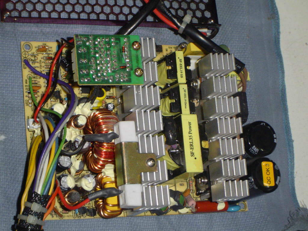

    Super Flower SF-400P12
    3.3V 2200/0.3V.10mm.TUL - L - 1000/10V.10mm.TUR
    5V 2200/10V.10mm.TUL - L - 1000/10V.10mm.TUR
    12V (none) - L - 1000/16V.10mm.TUR

    correct typing
    3.3V 2200/6.3V.10mm.TUL - L - 1000/10V.10mm.TUR

              I simply measure voltage by meter while supply to...
              DFI lanparty NF4-D, Athlon64 3000+, 2x512MB DDR1, 80GB HDD
              measure when system idle and when load more 12V rail by 6.6ohm (~1.8A, ~22W)
              ENERMAX EG365P-VE
              2200/16V.10mm.TUR === idle:~12.20V, load more 22W:~12.19V
              1500/16V.Panasonic.FL (10x20mm, ESR 0.013) WORST === idle:~12.20V, load more 22W:~11.98V
              1500/16V.Chemicon.LXZ (10x30mm. ESR 0.037) FAIR === idle:~12.20V, load more 22W:~12.18V
              >what was esr of those, compared to originals?
              >i presume chemi has higher esr than pana?
              Yes, Chemicon LXZ is 0.037, Pana FL/FJ is 0.013, I don't know original cap's ESR.
